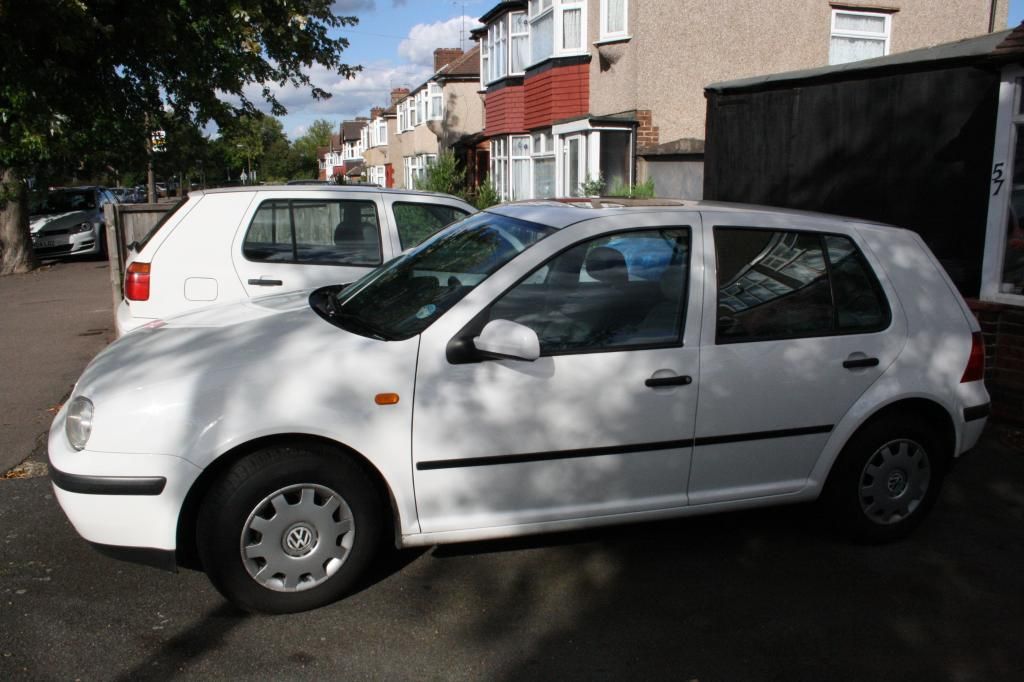

Des Posted September 10, 2014 Posted September 10, 2014 This bit of turd. Has been purchased by my mother to replace a very similar one that she's spent 15 years ratlooking. It's the next model on although only two years younger, I took it for a spin today and Volkswanker hater that I am, I have to admit it isn't that bad a thing to drive, or at least way better than the old one, I noticed the wheels seem bigger, only gone up an inch in rim size and someone has cleverly fitted 80 profile tyres, could it be that simple a fix to make German rubbish fit for purpose?Anyway the clutch bites an inch from rest so I assume the flywheel is kissing the friction plate rivets, has anyone pulled a gearbox from one of these jellymould contraptions and is it feasible to carry out the task retaining a mild and jovial disposition? Last Golf I did would be getting on for 20 years ago, piece of piss other than the deranged inside out and back to front clutch assembly worked by a pushrod through the input shaft. Germans eh? They finally work out the right end of a car to put the engine but just can't help themslves from dicking about with something. Sigmund Fraud, In The Pit, saucedoctor and 1 other 4

Partridge Posted September 10, 2014 Posted September 10, 2014 Thats a MK4 Golf. *edit You were referring to the previously owned Golf, not this one.That's the one I meant, you can see it poking it's arse out of the background.
