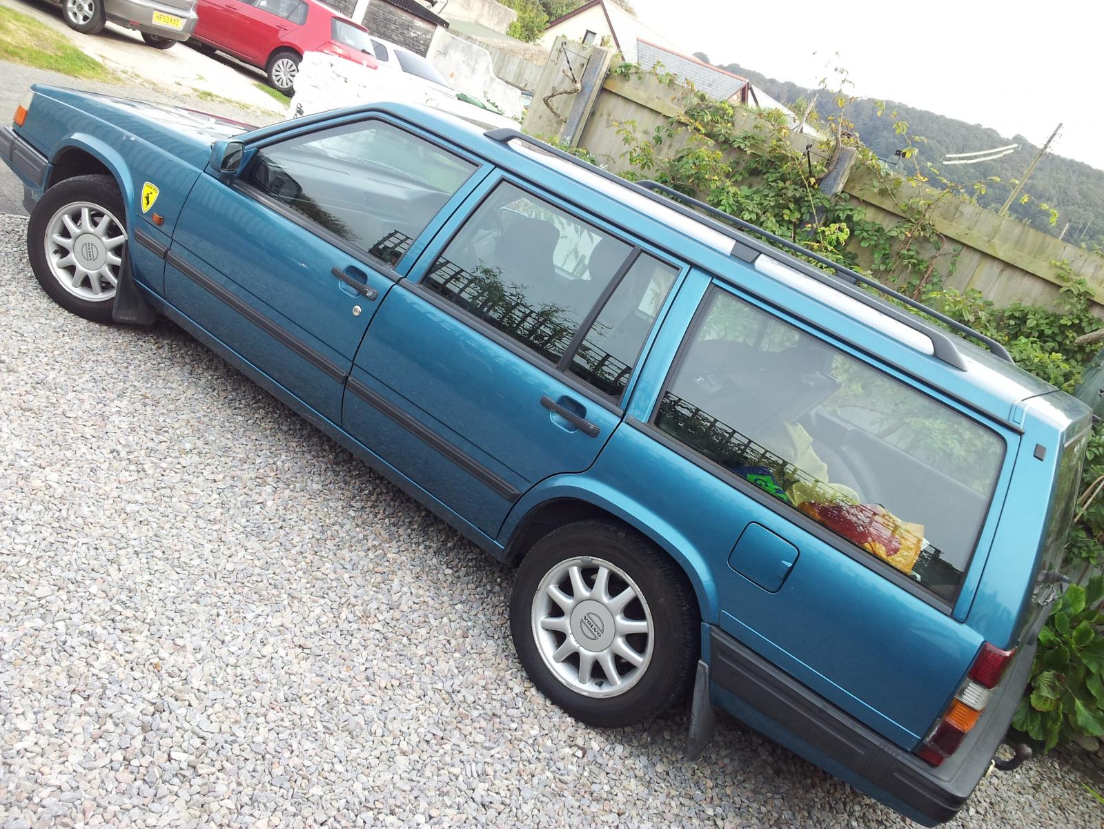

Have some pictures.  Looking much better without the daft stickers (well, the BP and Bosch ones).  It needs a good wash and polish and the interior needs a good scrub in places but it's far from horrible.
There's 0 service history but I've noticed from the pile of old tax discs in the window that it's lived most of its life in East Acton, plus all the belts etc. under the bonnet appear to be proper Volvo bits so I wonder if it's been to a dealer or specialist.  I've found a Volvo dealer 6 miles from East Acton so will give them a ring next week and see if they've got any records of it, I'd like to know when the cambelt was last done.  Are these interference engines?  I'm assuming they are.
I'm in two minds about a stereo swap, the wiring is like nothing I've seen before and some internet research suggests it's a pain to try and put my aftermarket one in, although the tape player it has doesn't seem to be an original one itself.  Anyone tried this before?

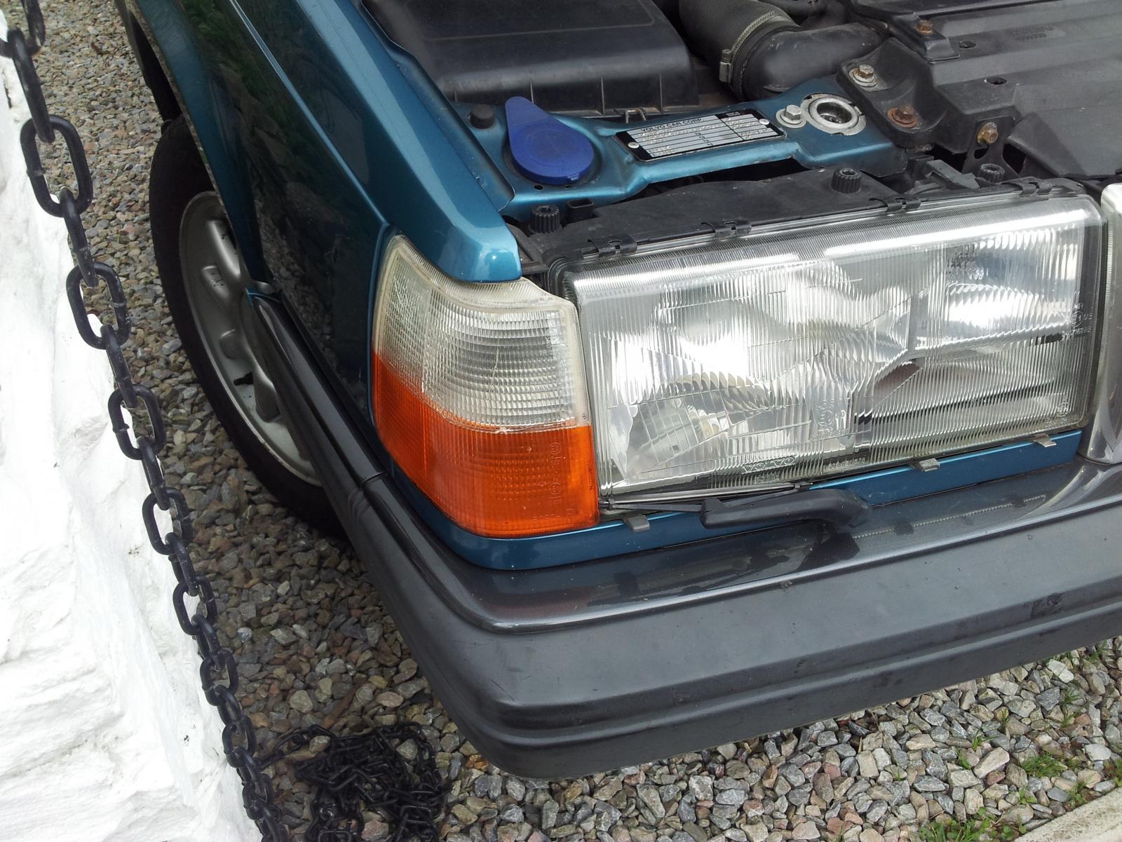

There are some very nice people on this forum.  Look what I got:
Thanks Shep!
The original sidelight/indicator units were chipped around the edges and one had a hole in it so they were both lined with muck inside and looked horrible.  Thanks to some clever design, they were swapped over in a couple of minutes, considerable improvement!
I also fitted a new valve so I now have working headlamp washers, this is very important and makes me very happy.  The rear one still doesn't work though, not worked out why yet.  The pump makes a lot of noise but nothing actually comes out so I'm assuming a pipe's blocked or disconnected somewhere.

Looking good there Phil, sounds like you're enjoying Volvo ownership. Nice colour and wheel combo this one.
Great how easily they pop on and off, isn't it? For the more enthusiastic you can have the entire front of a 940 in bits (including bumper) in about half an hour without breaking a sweat.

Looks good Phil,same colour as mine
Yes, I realised that after your thread came up a while back, the colour was a big turn-off originally but it's grown on me and I quite like it now, it stands out in a car park full of silver moderns.  It'll look better when I eventually get around to sorting the paint and put some actual shine on it.  The only thing stopping it looking 100% then will be the nasty keying damage down both sides which will have to stay as I'm not paying to have the sides resprayed.
It's clear that Volvo really thought about the design, I love how the grill is only held on by two big spring clips and just lifts out in 2 seconds, no screws to rust and snap off.  My neighbour was most amused, I removed the grill to get to the washer pipes and whilst fishing out the relevant pipes had my head inside the huge void in the front of the car which must have looked a bit odd.
