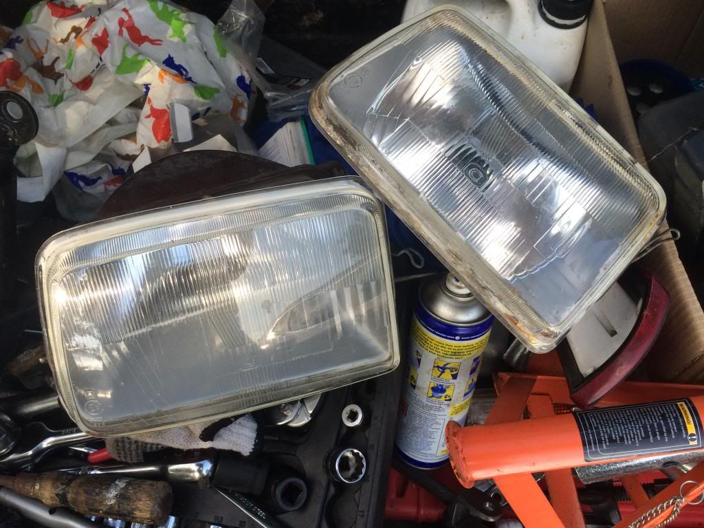

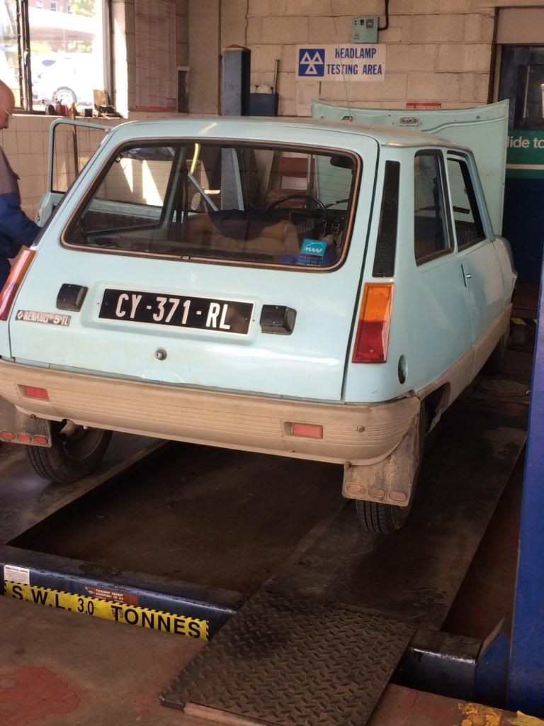

Alexg Posted May 14, 2014 Author Posted May 14, 2014 Right chod heros and moron guiders, MOT tomorrow, where am I sticking my black tape? This is the off-side, now garnished with amber painted bulb

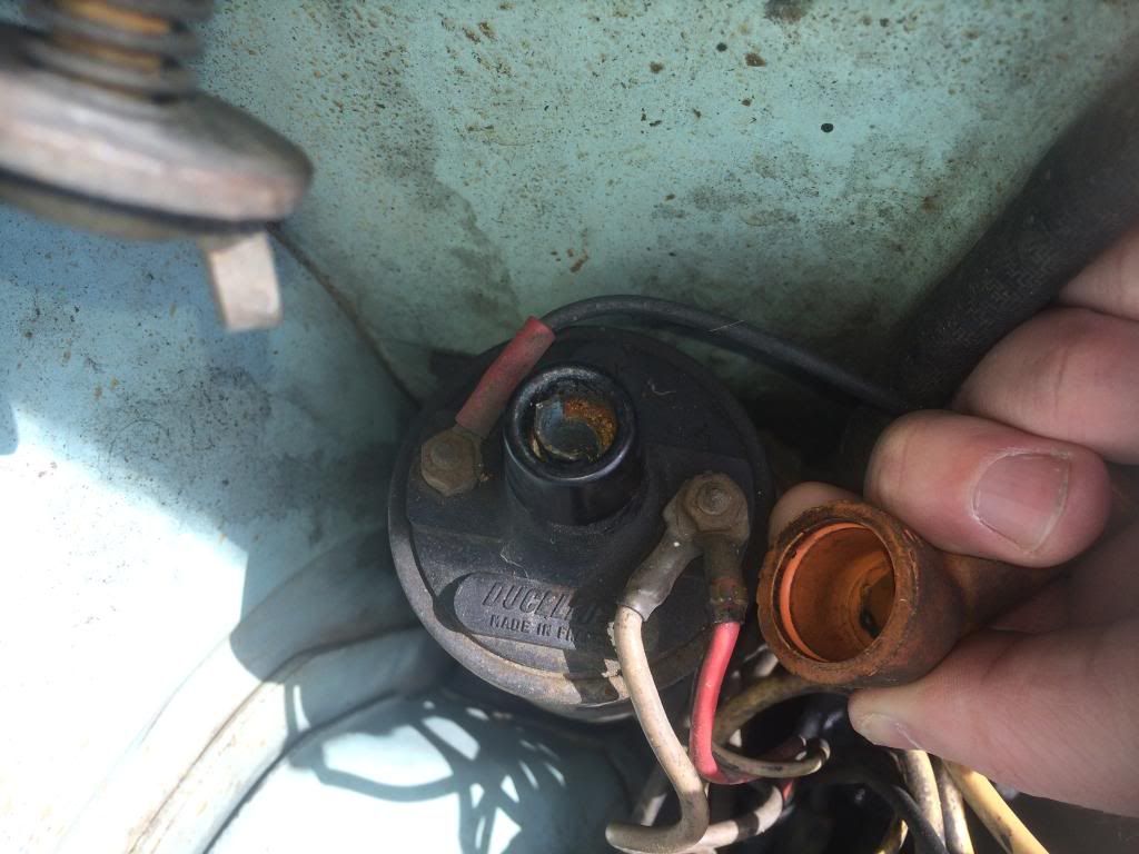

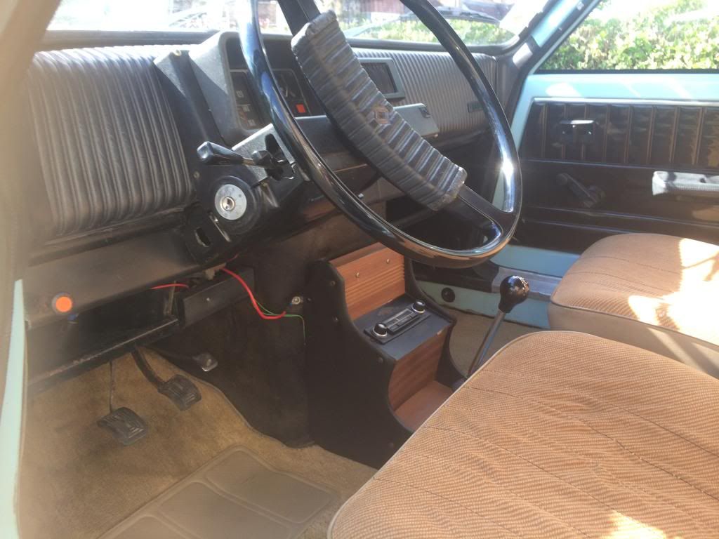

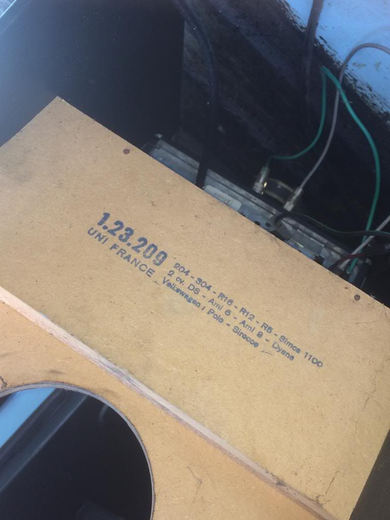

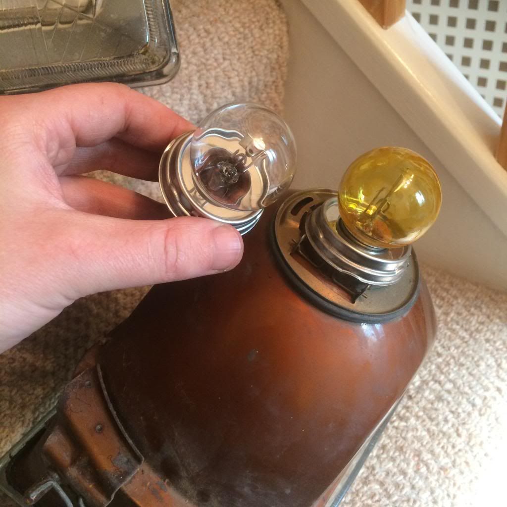

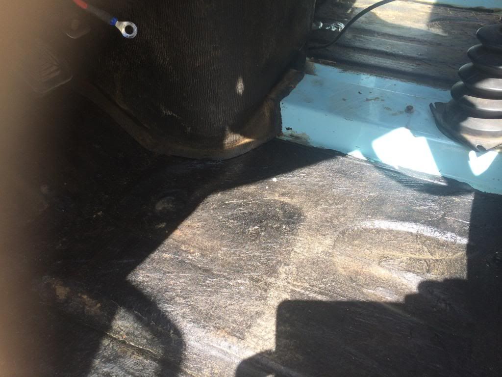

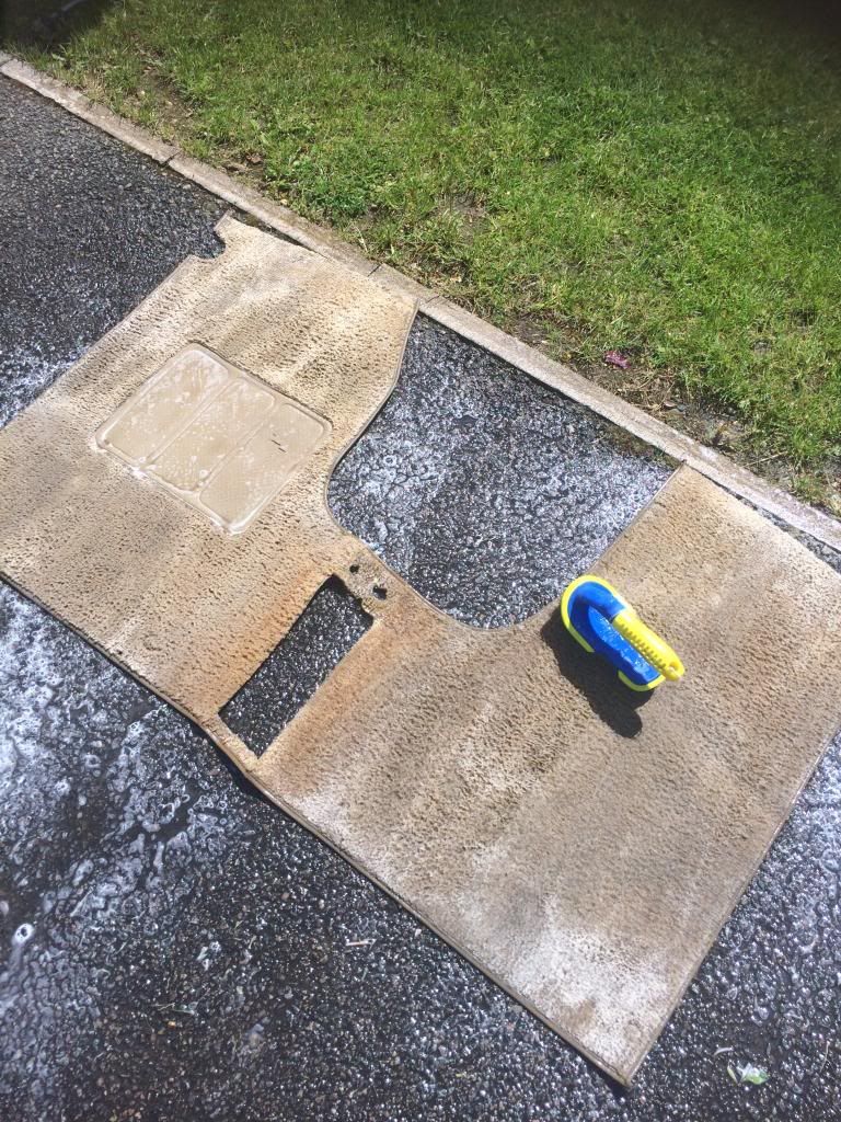

Alexg Posted May 14, 2014 Author Posted May 14, 2014 It's the first time I've had a chance to poke about the R5 and I'm amazed about how solid it is. First job today replace the knackered HT Leads, and not a moment too soon... Ride hight too low at the front, there's a nose dive thing going on... so used the underseat camber adjusters and hey presto. Excellent! Ace! I love some of the details about this car, also discovered this Summer driving: Winter driving: Got the carpet out for a bit of a scrub... ...requiring me to remove the aftermarket radio console, clearly a one size fits all! Floors are remarkably solid... Lastly, ambering up my bulbs.... Interior is looking much cleaner, although camera failed me... Now about those headlamps... ? Mr Lobster, SOUL, mouseflakes and 7 others 10
HillmanImp Posted May 14, 2014 Posted May 14, 2014 You see where the diagonal line is coming up from the right hand corner. You want to block that above the line till you get to the line in the middle. *edited due to stupidity* Junkman and Alexg 2
Ratdat Posted May 14, 2014 Posted May 14, 2014 I'd wait until you're at the test. If you have a decent tester, explain the score and he should let you tape them up there and then so you can actually see the pattern. I would think it'd be something like this though at a guess... Junkman, HillmanImp and Alexg 3
Mr Lobster Posted May 14, 2014 Posted May 14, 2014 Thats looking remarkably nice. I reckon the carpet is a later addition as well, fairly sure it would have been black plastic floor coverings when it was new. Alexg 1
Alexg Posted May 14, 2014 Author Posted May 14, 2014 Yes Lobster, the rear has the black plastic with black vinyl bench, GR6676 for south of France ray-a-thon! Chear Imp and Ratdat, I'll have a chat with my super picky MOT bloke before he rips the shit out of it.

Alexg Posted May 15, 2014 Author Posted May 15, 2014 MOT FAIL, as expected.... N/S/F wheel bearing (I knew about this, I have a replacement)N/S and O/S trackrod ends (replacements now ordered and paid for.. a few hours before realising they are the wrong ones! Early model has different setup, now tracking down early spec')Front indicators white (hadn't noticed this, but obviously an easy fix)N/S/F headlight inoperative (like a champion class doofus I fitted the taped-up lamp this morning without plugging it in!) All in all, not a bad result! My plan was to throw the replacement bearing at the mechanic if, by a bit of luck, this was the only issue. I'll sort the other bits now first. I'm not much of a mechanic, but I can usually figure shit out. Track rods look simple enough so no problem there... not sure if to have a bash of the inner and outer bearings myself whilst at it.... Ratdat, HillmanImp, Lacquer Peel and 5 others 8

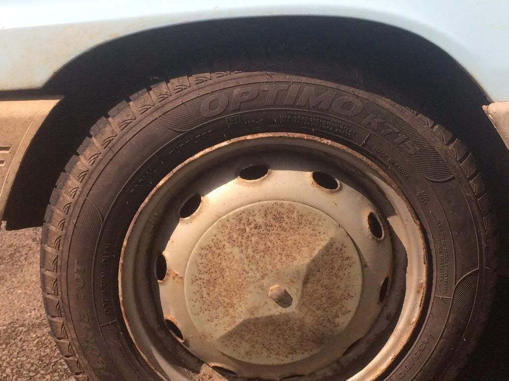

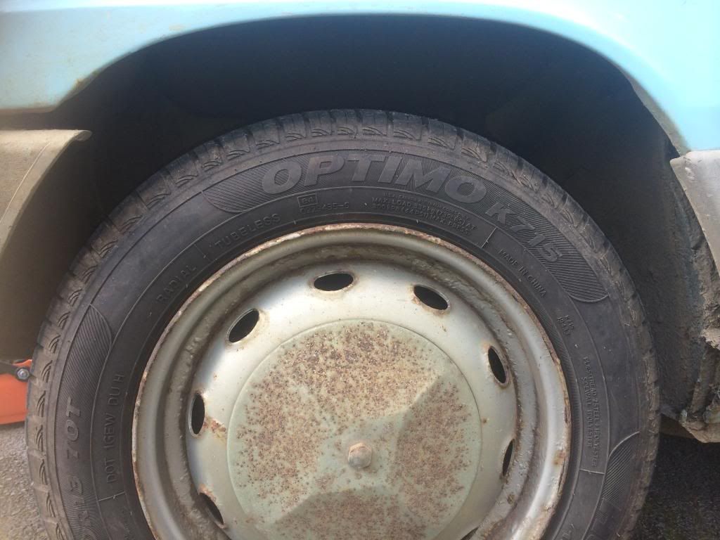

forddeliveryboy Posted May 15, 2014 Posted May 15, 2014 I really, really like the look of your R5. Try to keep everything looking as it does, as much as practical. I know shiny paint protects* cars in the wet BritIsles but love the dusty, pale paint of French chod which has lived in the sunnier parts. Alloy wheels? Pah - those battered rims and stainless hub caps are perfect. It'll go faster, more comfortably on them, too. Invest in a set of decent tyres instead of bling rims. Sudsprint 1

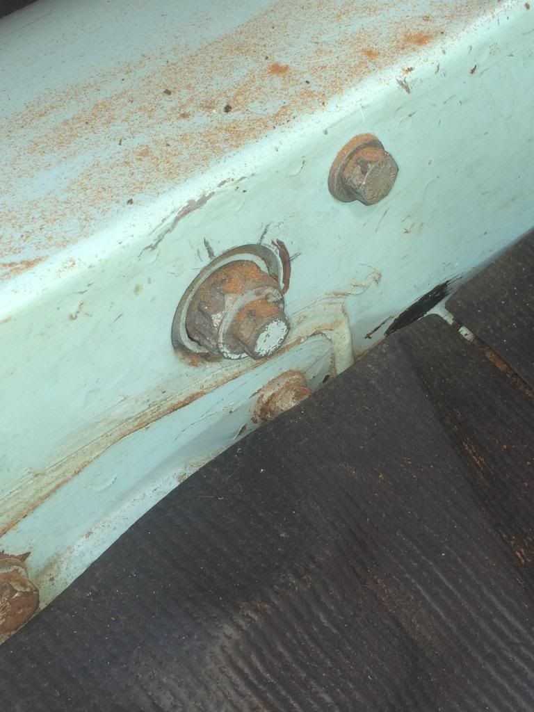

Parky Posted May 16, 2014 Posted May 16, 2014 Alex, You probably already know this but the rear suspension turrets are major rust spots on these. If yours are still sound I would seriously think about getting some POR15 or Dinitrol under there while the weather is good. In fact getting some protection slathered on the whole underneath would be very wise. The MOT result was pretty good, nothing particularly significant or unexpected so that's good!

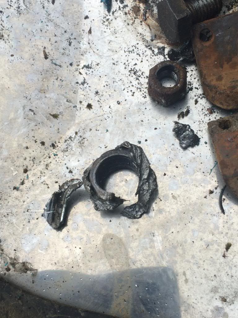

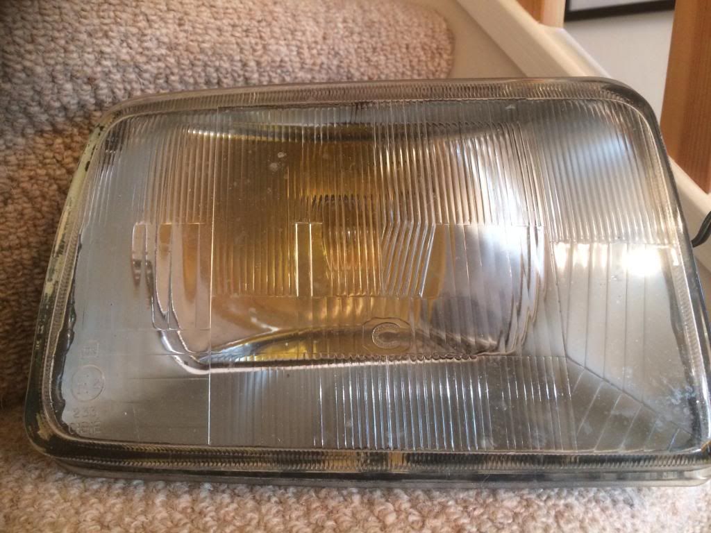

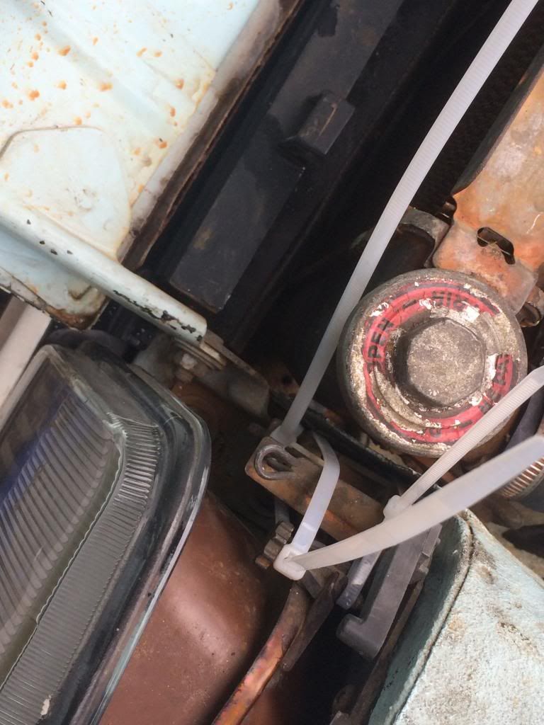

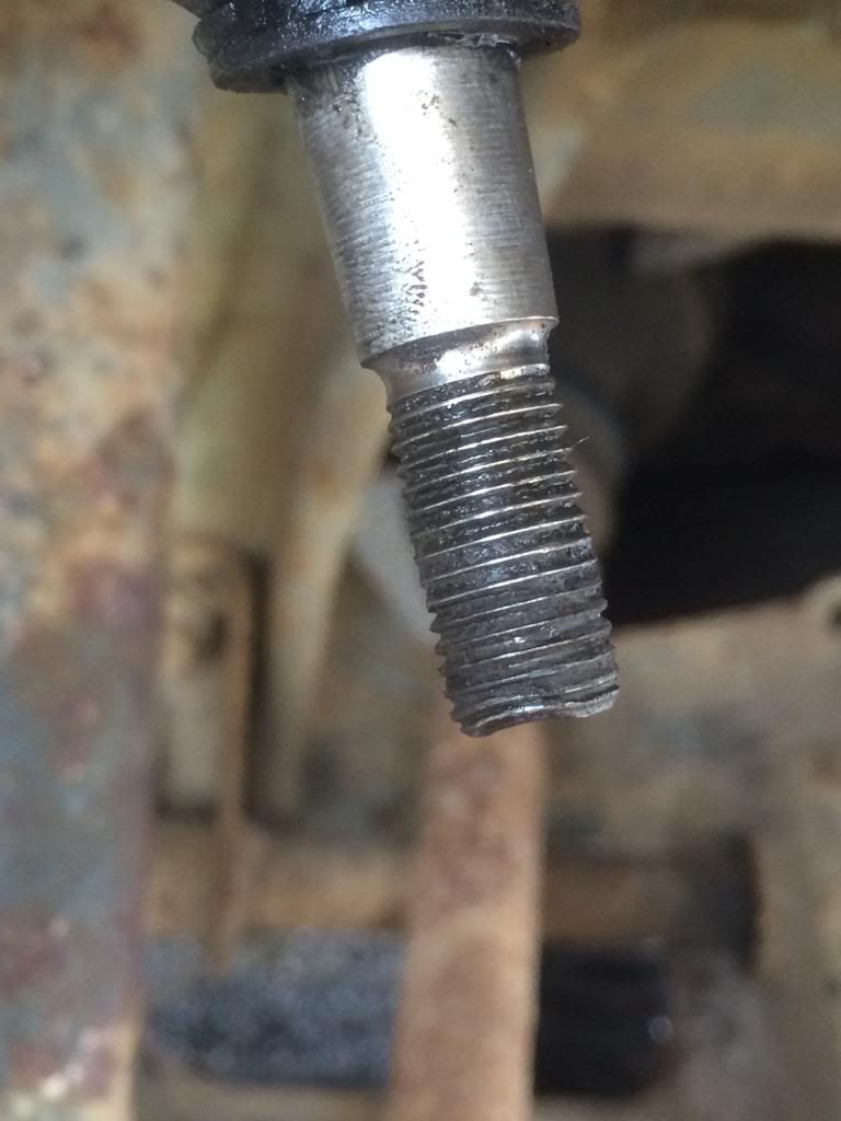

Alexg Posted June 5, 2014 Author Posted June 5, 2014 So I had a bosh at removing and replacing both front tie rods and o/s hub. Simple enough shit and fortunately I work at a Ford main dealer, so managed to get one of the technicians to stick in the replacement bearing for a few bottles of Cobra. Unfortunately when I came to bolt it together when I discovered this on the upper ball joint, looks like I was a bit clumsy and heavy handed with the separator... COCKTITS! With a new part ordered and delivered I created problem number 2 as I over tightened the nut on the new tie-bar ball joint causing the nut to shead its thread and spin freely left and right without actually tightening or loosening. FUCKSTICKS! Assuming the thread on the tie-bar would be OK I carefully hacked-off bits of the nut with a blunt saw I found and ripped off chunks with the piliers. Take that you PRICK!!! Original nut then fitted with no issues.....IN YOUR FACE!!! Final part of the fail sheet (I hadn't mentioned) was the loose headlamp, sorted with tape and cable ties ...of course I had the chance to fit the headlamps RatDat kindly sent me, however there's a slight technical hitch.... ...they're both OFF-SIDE REF!!!! LOL etc So, in for MOT again today and a bad start... "It's gonna fail again, that headlamp's all over the place" The MOT guy has used the adjustment screw to raise the beam, only for this to loosen up the lamp from it's bodged mountings.... I quickly lashed on a couple of extra cable ties as it sat on the ramp "Yeah that'll do - go on!" SWEEEEEEET! STICK THAT ON THE FRIDGE! Right, so now it's DVLA time. Closing down the local offices is a beltingly wank idea, everything has to be done by post and payment is by cheque or postal order only! - WTF what year is this??? I flipping hate filling forms too, but there's not a lot to add as no Type Approval required. I do need to add the engine number though I'm assuming it's this long one?? Next step get this frigger UK plated in time for my planned birthday picnic at the Darling Buds show... 1 month and counting SOUL, HillmanImp, trigger and 3 others 6
