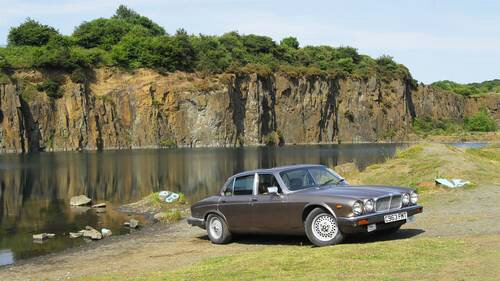

Anyway I recently collected from Dome his rather spectacular XJ6 series 3 in antelope brown. No collection story as Dome lives about 2 miles from Scooters Towers but a huge tanks to Brian and his fine young lady for their hospitality.

It's an XJ6 sovereign 1985 so the same year as the CX. It's in remarkably good fettle having had a recent if not perfect respray. Interior is very nice except it needs a new headlining and the ski slope on the dash is disintegrating with the usual delamination in places on the main dash. Electrics all seem to work pretty well and the car has a sunroof.
Body work
The giffer has welded in new rear arches at some point and done a puss poor job of ensuring the weld was flush and smooth as there is a noticeable join lurking under the paint on close inspection. The tin worm has attacked in a few places and some small bubbles are emerging through the paint. I've noticed the start of some fun and games under the battery tray and the coolant tank as well which will need a dollop of vactan. Also a nasty hole appearing on the door jamb of the off side A pillar in between the hinges. This will need looking at to see what is going on inside the pillar. Chrome is ok with the start of tiny rust patches caused by stone chips. I'll silvo this back to remove the drains and a wee dollop of vactan should kill and seal these for the time being.
Mechanically it seems pretty decent. A slight occasional clunk from the nearside rear so one if the 2,000,000 bushes will need inspecting.
Sadly little history came with the car. There was a huge history file which the family gas promised to send onto Dome but sadly they didn't. It's always tricky beating such out of grieving relatives when they have other things on their mind. It's a shame as these XJ6 s are valued by punters in the amount of history available. The good news is there is a jag service book. The car did have a new engine fitted in 1997 about £20k ago and the engine seems sweet.mught need to look at installing a tappet hold down kit as it can be a bit sewing machiney.
Dome did a great job with rebuilding and refitting the alternator always a total pain in one of these cars.
The belts all squeak horribly when cold and the power steering one in particular so may need a new one there.
Fuel tanks are the usual XJ chaos. Dome did a fine job of fitting a new switch over valve. Both level indicator floats will need replacing. I took the rear lights out to gain access to them and cleaned up the terminals which got a small signal from the port side one but still nothing from starboard. This means the port one will definitely need replaced and I need to test the current on the starboard but I suspect it will also need doing. The vapour trap pipework for the starboard one can play up. Dome had stopped using it due to air lock. The cure is to simply disconnect the vapour trap and have the tank vent to atmosphere. This pipework lurks in the top of the wheel arch so car needs to go on stands to access. I haven't noticed this issue yet but it will happen as it is a common fault. In the meantime I just fill up the port tank to full and reset the trip meter. I keep about 20 lts in the starboard tank for back up and switch over for a bit every now and then to ensure the valve doesn't atrophy. MPGs are always fun with these cars. I haven't really noticed huge MPG pain, this is probably because the CX has been my daily and you only get 25 mpg on a good day in that so the 18 on a mixed cycle on the XJ isn't much worse. The trick is not to use it for short journies. The simple EFI in these essentially dumps gas into the engine until it reaches operating temp so if you are using it for pootling around town you'd be cheaper taking a taxi! On a run its not too bad and as I basically no longer drink it counts as use of fun tokens on the rare occasion I have any.

This picture was taken earlier the same day when Scooter was picking up his Russian friend,to take him for a swim in a quarry.
