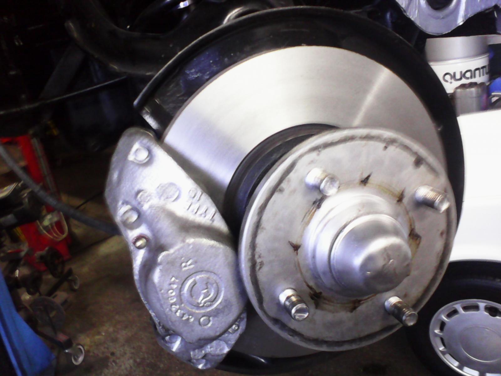

The worst bit about driving it is the brakes. They are awful. I fitted new pads, calipers, flex pipes etc but they're mega shite. They are boosted (I think) but they're not vented and are generally terrifying. I recon the P6, which is 7 years older and probably about a 1/3rd of a ton heavier could stop in about half the distance.
Vented discs will only help with brake fade though, not give you better brakes in the first place which I think you're after. How is the master cylinder? I'm not sure what original Cortina brakes were like, but the standard ones on my Stellar were OK, nothing special but certainly would stop it. A little prone to fade under hard use though.
I upgraded them to vented discs, Austin Princess 4 pot calipers and a Mazda 323 master cylinder, and would say they are now excellent but I'm not sure what made the biggest difference. I got the calipers from a scrapyard car, which tells you how long ago it was! Unfortunately they would probably cost more than £20 now...

The brakes on mine were a bit wayward, despite the previous owner having new discs, pads, calipers and a master cylinder fitted.  They were pretty well glazed up and used to brake unevenly, I spent a morning changing the fluid, cleaning & adjusting the rear drums, skimmed the discs and fitted some Pagid pads from euro car parts.  They now work like new, stop in a straight line and the pedal is right at the top, I even had to slacken the hand brake cable so the lever would reach the first click and there is no bind on the brakes whatsoever.
The standard brakes can be made to work effectively without the need to upgrade them, however I would advise that as your car has a 2 litre engine that you get the 2 litre rear drum set up which increases the drum diameter from 8" to 9".
My Capri (probably) has the same brakes as your Cortina. Non vented disc, two piston caliper, with servo.
Although my Capri has the old two line brake master cylinder. Dunno what your Cortina would have.
The brakes aren't anywhere near modern car standard, but are easily good enough for the car. I would think yours do have something amiss if they are as bad as they sound. Maybe master cylinder or servo could be faulty?
I don't see the need to upgrade mine anyway, since they seem perfectly capable, and I've used them hard on a few occasions over the years. That said my Capri is a 1.6 4 speed so it's not as fast or powerfull as your Cortina. I'd definitely have a look at the servo and it's vacuum hose, and the master cylinder anyway.
That's good to know. i'll add it to the list. It did pass it's mot like this so must be within legal standards. I thought it was just going from a 2 year old C class Mercedes to this that made it feel so bad but the brakes on the P6 are so much better I can't think they should be this bad.
A good upgrade for the brakes is a land rover master cylinder :-)
New pads absolutely transformed the brakes on my Victor from 'a bit wooden' and 'needing a bit of a shove' to having the pedal right at the top and just a light touch now pulls them up sharply like a modern car. They were so crap before I did at one point think the servo might not have been working. Of course, as soon as I sort it out I sell the car!
I've got new discs and pads in the boot, not that they're doing much good there. It didn't fail it's mot on them so I presumed it didn't need them, which by the sounds of it was a mistake.  I only realised recently the 2.0 axle had bigger drums on it.
