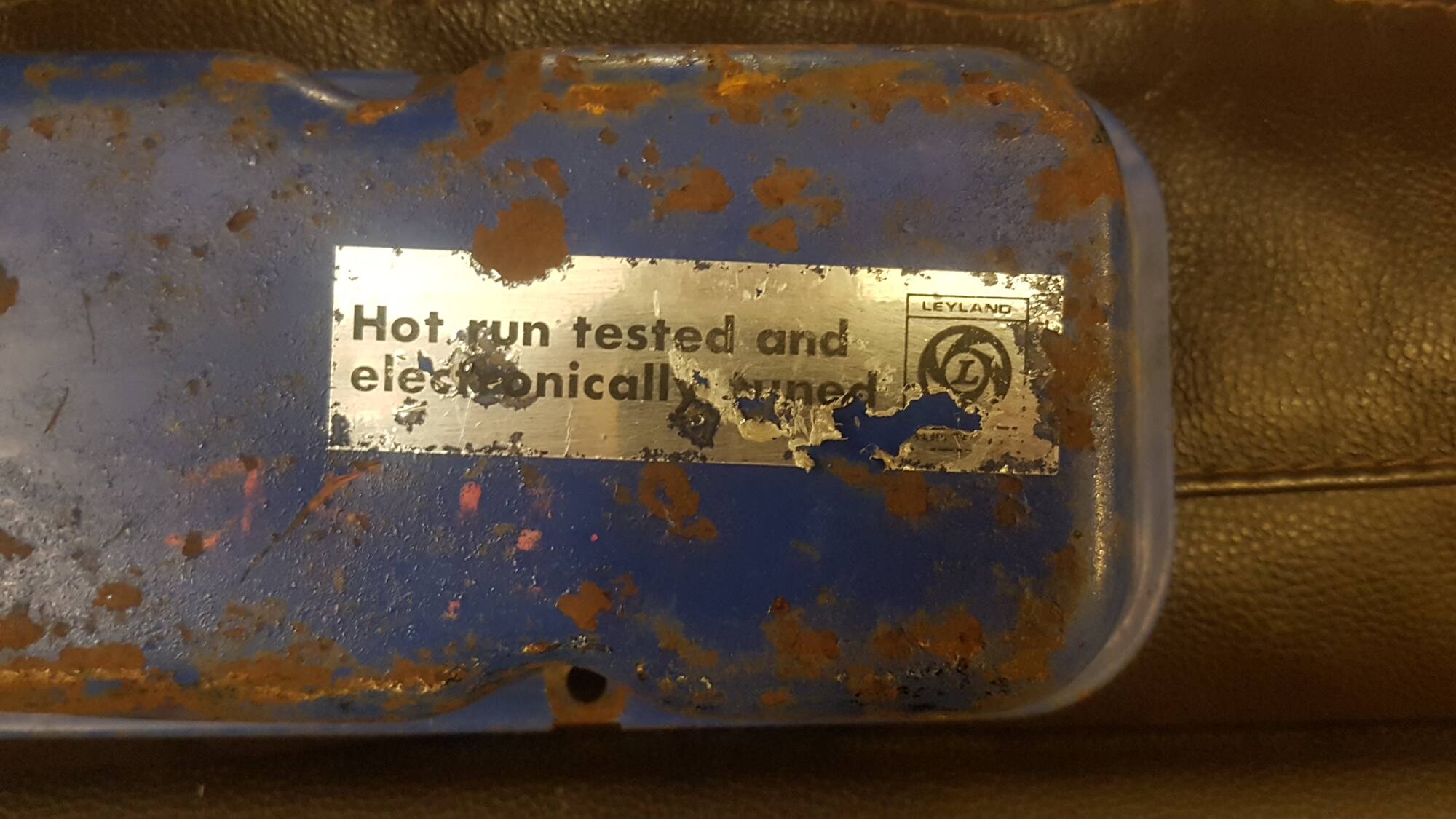

It almost seems a shame to remove this label from my new rocker covers:
"Hot run tested and electronically tuned" it proudly states.
But in true Leyland style, the label wasn't even applied straight!

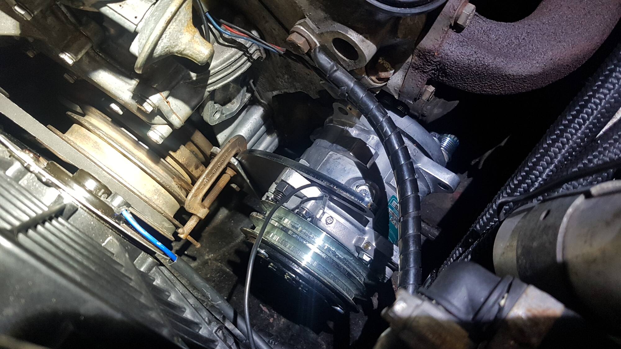

The front compressor mount I want to bolt up to the timing cover, but to get the belt alignment correct I need to set it back by 6mm. Handily, I'm using 6mm plate, so I just need to fasten one plate to the front of the timing cover, and overlap that with the slotted plate the compressor mounts to.
I made this up using an old timing cover as a pattern:
Cutting this out with an angle grinder took a while! But once bolted up I could then overlap with the cut down slotted plate, and temporarily clamp in place with a small G clamp while I checked alignment:
Belt line looks good:
But the question is, have I got enough movement of the compressor to tension the belt, without it fouling?
I'll call that a success :-)

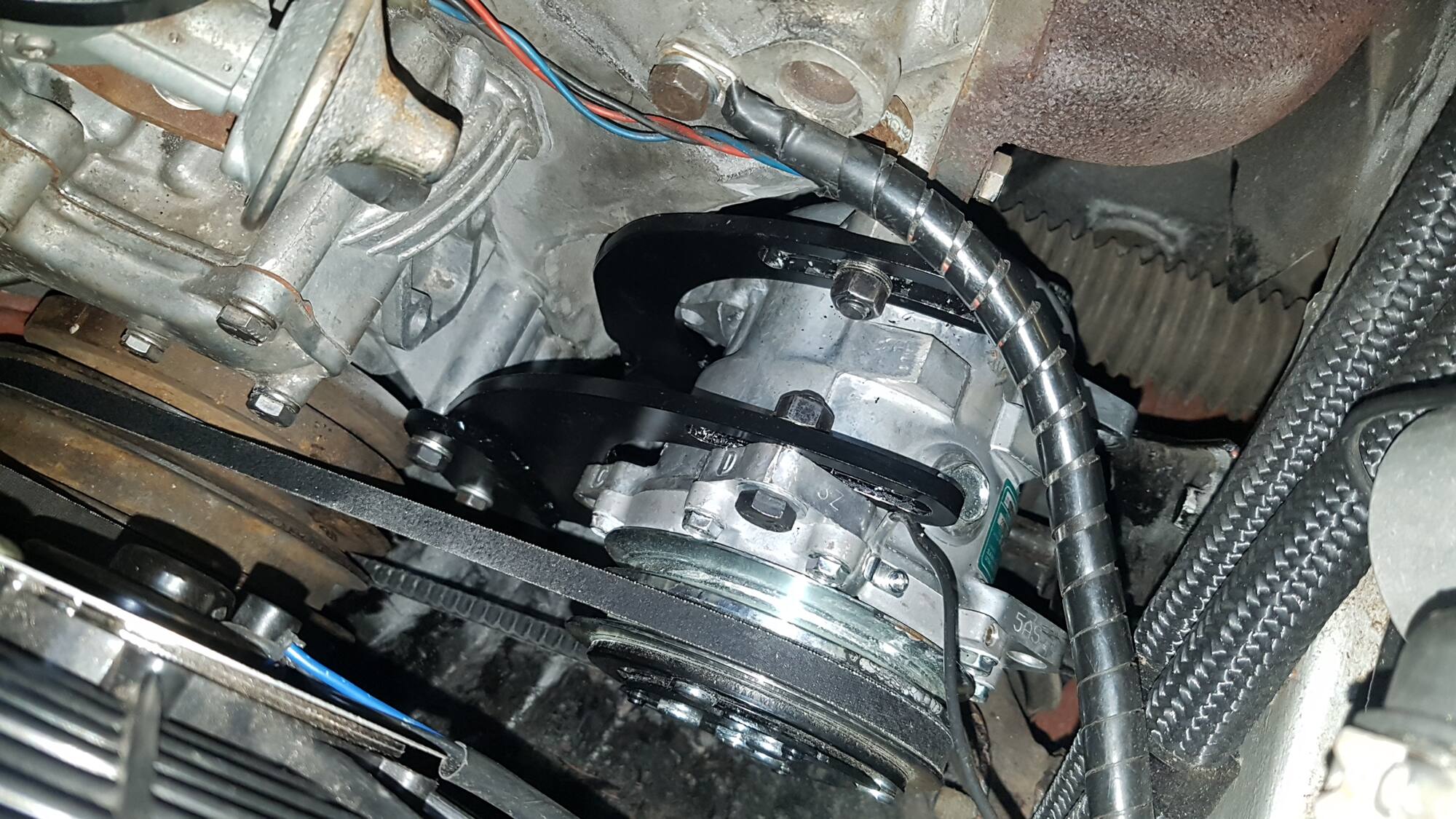

Ok, this picture might not look too different to the ones above, but getting to this stage took a good while!
The problem was, while the compressor was free to move, I hadn't realised it was actually resting on the front anti roll bar! So I zip tied a wooden spacer onto the ARB, and then tried to re-mount the compressor. Bugger. It fouled the engine :-(
But not a particularly important part of the engine, so with a good deal of flap disc action later, I had clearance.
I then cut down an old V belt to the right length, so I can now match that up to the next longest length available (hoping that isn't too long for me to be able to tension it!)

I've now involved the compressor and mounting plates, and mocked up the spacing of the compressor lugs with a couple of bolts.
I could then reinstall the mounts to see where in free space the rear mount was sitting. There are two bosses on the block that I plan to utilise, by welding a plate at right angles to the rear mount. Access is a little tricky, but all I need to do is drill the plate, bolt to the block and tack it to the mount. The proper welding can be done on the bench, assuming it doesn't distort too much on cooling...
Note how much of my block is sitting on top of the sump guard in dust form!
I made up a plate with holes to match the bosses on the block...
...so once that was bolted on I tacked it to the rear mount. Then I could unbolt both, weld up properly, and paint. My welding was a bit splattery and I don't know why, but got good penetration so the joins are strong at least.
Happily there was no noticeable distortion, so the two mounts were still in the right place to fix the compressor between. A 925mm belt was the right length to drive it, so this was the end result.
I'm actually really pleased with this; it's turned out to fit nicely, and I'm *just* able to get the full range of adjustment without fouling anything. Time to see it in action!

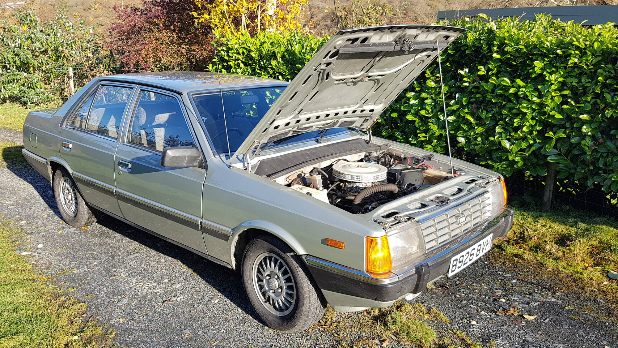

Winter is now well and truly here, so time to take this off the road. But first an opportunity for an arty frost shot this morning!
It normally lives in the garage, but got back late last night so thought I'd leave it outside so I could wash it today. I was also interested to see how well it would start in the cold...
Pretty well as it happened. Although user error on my behalf for pushing the choke in too much!
I then parked it on a slope after a wash, to let the water drain away. Check out that axle articulation!

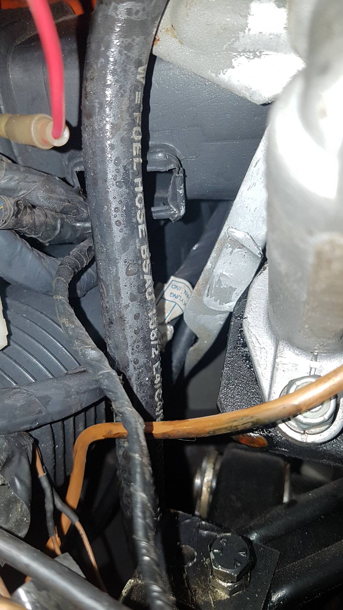

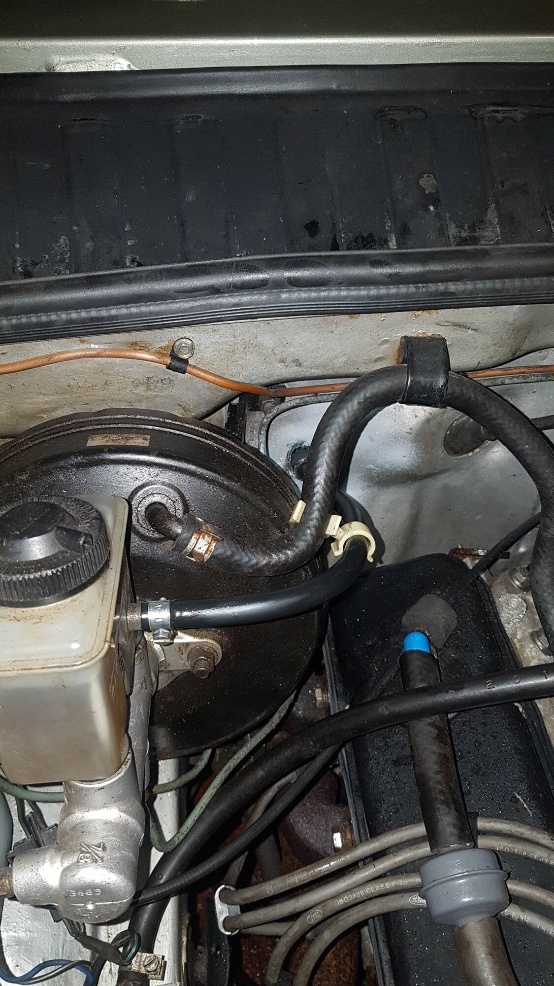

While I ponder that decision I moved I to another job. I've had a very slow loss of brake fluid, which I could never trace! All I could put it down to was possibly being drawn into the inlet manifold through the servo, although there was no smoke to point towards that. Yet the brake pedal was still firm, suggesting no problems with the high pressure side of things either.
Then I happened to see that my hose which fed the clutch master cylinder under the dash was leaking!
Those of you more knowledgeable than I will probably be ahead of me, looking at the last photo...
It turns out fuel hose isn't suitable for carrying brake fluid :oops: So it was actually sweating the fluid through the rubber! This has all been replaced with the proper stuff (EPDM) and bled through.
