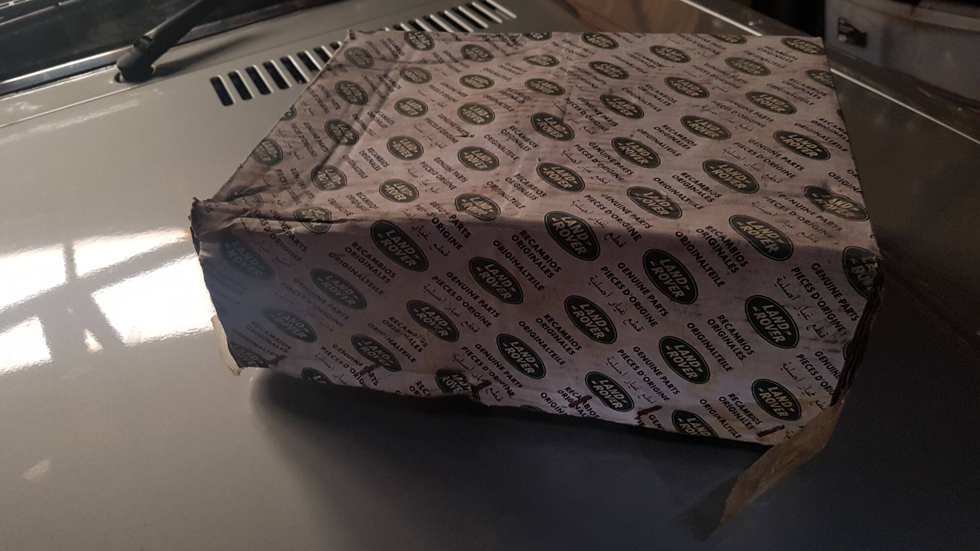

I don't own a Rover 45. I have never owned a Rover 45. I don't ever plan to own a Rover 45. So why do I find myself the proud owner of a Rover 45 condenser?
A: Because it was cheap!  20190812_203119.thumb.jpg.ea4953f714d1a9886e832151c45e2282.jpg
Rimmer Bros sent a clearance catalogue through the post, as they need to make room for more stock. Some crazy prices in there, so I took advantage.
Looks like it should fit too, fortunately. I noticed it came with a frame for mounting cooling fans, which I thought would be a bonus as it's one less thing to worry about.

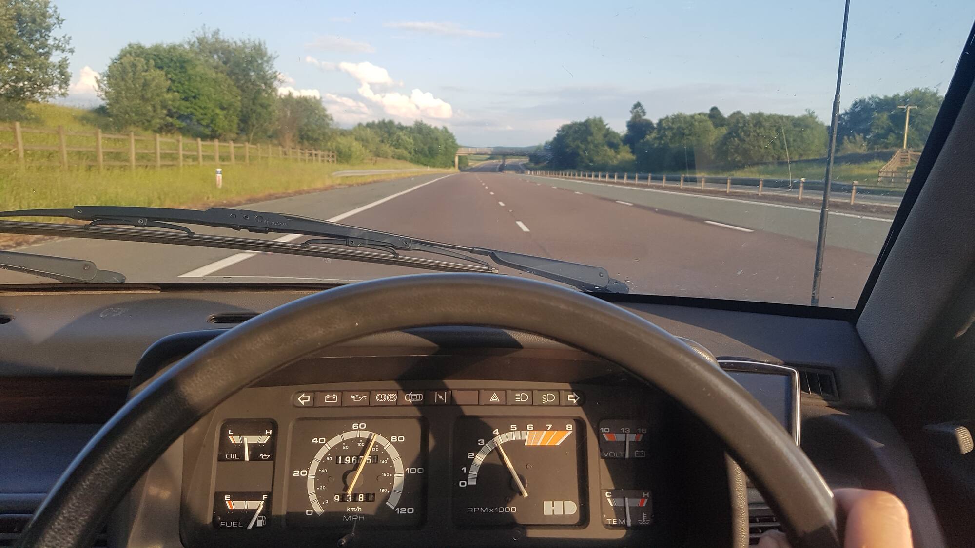

This photo shows something I'd like to improve upon - the engine is revving fairly high for relaxed cruising! I have a rear axle from a 2.3 V6 Cortina, which has a final drive ratio of 3.44:1 but unfortunately is the tallest ratio available for the Cortina. However, the axle is basically the Atlas unit (as fitted to Transits, P100s and Capris) but in a Cortina casing.  So, I reckon that I could swap the crownwheel and pinion from a V6 Capri, which has a 3.09:1 ratio, to make it a bit more long-legged :-)
I've asked the question anyway...

Yep that is revving its tits off! Bet your fuel consumption is dire at any sort of speed above a crawl, but equally, I bet she don't half got some 'pick up'!
An excuse to post this again! When the clutch was slipping under full throttle so couldn't floor it :-(
I need to take another video!
The old Rover V8 might be a bit of a boat anchor nowadays but they do sound just right! :)  By 'boat anchor' I don't mean to be disparaging but compared to 'modern' engines, just so down on power and designed back in the good old days when torque was king! I had a 3.5 in a Dutton Phaeton complete with auto box and that just flew but had the same problem is so much as it ran out of revs early but as it had no windscreen at all, quite welcome! :)
That's pretty much what my C4 is like at 70mph  (and that's the only time I'll compaire my 1.6 C4 to a V8 Stellar!). Even after a year I still reach for that imaginary 6th gear.
