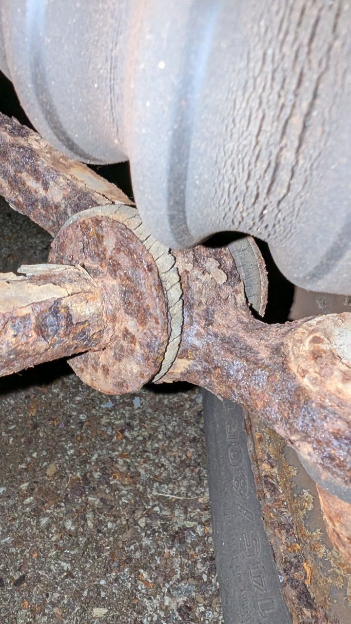

HillmanImp Posted March 15, 2025 Author Posted March 15, 2025 Hola, question for the clever fellas (and fellettes) on here before I spend some money. See these bits here where the anti roll bar meets the control arm: Do you reckon they're these: https://www.ebay.co.uk/itm/316122315897?mkcid=16&mkevt=1&mkrid=711-127632-2357-0&ssspo=yi1ojZncSxy&sssrc=4429486&ssuid=Wdnh7tdPQ7S&var=&widget_ver=artemis&media=COPY N Dentressangle 1
N Dentressangle Posted March 15, 2025 Posted March 15, 2025 Yes, I reckon so. Have a look at the parts drawing here: https://www.vfrenchcarparts.com/shop/bodywork-upper-lateral-rear-parts/085/peugeot-104-citroen-visa-suspension-elastic-link-rondelle-elastique-de-suspension-509304-or-0935045/ HillmanImp 1
HillmanImp Posted March 15, 2025 Author Posted March 15, 2025 Yup, thats number matches up doesn't it. Will order a couple for one side then. Ta very much.
Largactil Posted March 15, 2025 Posted March 15, 2025 2 hours ago, HillmanImp said: Hola, question for the clever fellas (and fellettes) on here before I spend some money. See these bits here where the anti roll bar meets the control arm: Do you reckon they're these: https://www.ebay.co.uk/itm/316122315897?mkcid=16&mkevt=1&mkrid=711-127632-2357-0&ssspo=yi1ojZncSxy&sssrc=4429486&ssuid=Wdnh7tdPQ7S&var=&widget_ver=artemis&media=COPY Ah, sweet memories... HillmanImp and N Dentressangle 2
