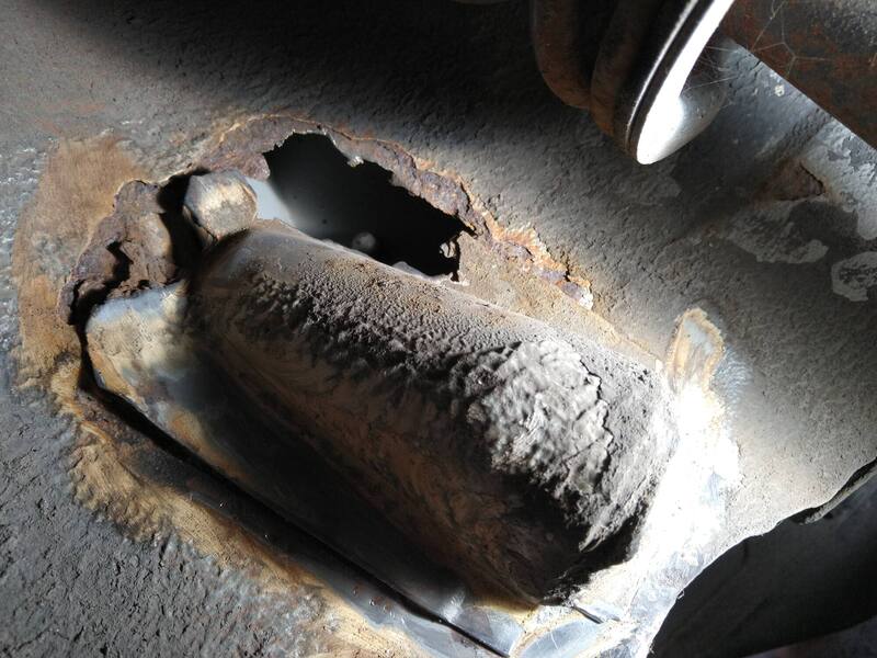

HillmanImp Posted October 30, 2019 Author Posted October 30, 2019 What up mofos. Regular stupid question from mr HillmanImp. Meg needs a tickle in the ns wheelarch behind the bumpstop. How dafuk do I get it off? Someone suggested summink last year before I fudged the other side but I cannae remember what and have had no luck finding the post. theshadow 1
somewhatfoolish Posted October 30, 2019 Posted October 30, 2019 Drilling through the spot welds is probably the way most likely to leave what's left of the bumpstop intact and ready to be pigeon pooed back in place. It is fun* trying to find them all though. HillmanImp 1
HillmanImp Posted October 30, 2019 Author Posted October 30, 2019 4 hours ago, somewhatfoolish said: Drilling through the spot welds is probably the way most likely to leave what's left of the bumpstop intact and ready to be pigeon pooed back in place. It is fun* trying to find them all though. Yeah, I haven't a clue how to find them. I was hoping they'd just show. Will have a crack tomorrow or just fudge it like I did last time. Ta.
Mrs6C Posted October 30, 2019 Posted October 30, 2019 A technique I have used is to use 'wet or dry' sandpaper to rub down the paint on spotwelded flanges until the bright metal is achieved. The spotwelds can then be seen, forming circular patterns coloured in a grey-blueish hue. You can drill them out or use a sharp, flat chisel and a decent hammer to drive between flange and underlying metal. Either the spotweld itself will give to the chisel blade or the flange metal surrounding the spot weld will; if the latter then straighten out any deformities in the metal with hammer and dolly or between the jaws of a decent metalworking vice and dress the edges of the holes with a round file. This will give you ready-to-use plug weld holes to put the flanged item back on the good metal you have used to create the panel repair underneath. If the spotwelds gave in to the chisel, use an angle grinder or file to grind the spot weld remnants back to flat and drill or punch out holes in the flanged piece for the plug welds. somewhatfoolish, Coprolalia, The Moog and 3 others 6
Mrs6C Posted October 31, 2019 Posted October 31, 2019 Also, before you remove the bumpstop bracket, I'd suggest you clean the metal around the area to be repaired with a stiff brush to get rid of surface dirt, then use a permanent marker pen to mark out its footprint, extending the lines as needed with a straight edge, to mark reference points and dimensions for its extremities. When you have removed rusted metal and made the repair, you will then have reference marks to be able to replace the bumpstop bracket in the correct location on the new metal. HillmanImp, Skizzer and Coprolalia 3
HillmanImp Posted October 31, 2019 Author Posted October 31, 2019 Done it. Couldn't get the bump stop off so just cut it out and replaced all the metal behind. Due to what must've been a defective tapemeasure, I had to ads in an extra strip of metal at the top. I know, I know, measure twice, cut once.... Just tac welded the bump stop back on in 10 places after rebuilding it on one side. Forgot to take photos of it finished and painted before I dropped the car off the jack. Hopefully will be an mot pass though now. My back is now killing me after doing that. Will medicate with some beer. theshadow, The Moog, strangeangel and 6 others 9
