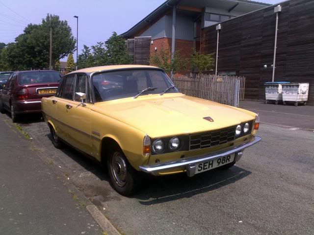

Rover p6- classic shite progress. or not. anyone want it?
I've now got this running and mot'd, but theres plenty to be getting on with,
Note the crappy late '70s spotlights. I like them
Interior is buckskin leather, I reckon cleaning and feeding should bring it back ok. everything works.
back door is dented and rotten. luckily I have one in stock.
nasty scrape on back wing, rust damage to scuttle panel. again, I have these panels in stock
it has grommits in the front wings where mirrors should be.looks crap. I think theres a nice pair of chrome wingards around somewhere if i can find them.
It drives better than I expected, feels at least as quick as my 20 years newer volvo 240. comical amount of body roll when cornering. it has quite a farty exhaust note so everyone stares at it.
That's a brilliant car, and I envy your ability to fix it up.
What he said.
Still haven't managed to score a P6 yet despite years of admiring them. Is it true that all the panels are bolt on, Oman?
Shepfact: I am a huge fan of the Rover P6 (possibly due to nearly being born in a Cameron Green 3500S - long story) and almost bought one in 2003, but practical considerations meant that I ended up with The Volvo instead. I'd love to own one at some point in the future, though, ideally a 2200TC in Lunar Grey or Paprika with box-pleat fabric seats ;)
Billy - it's true. They're like a Citroen DS with a steel frame to which all the panels bolt. The frame can rot horribly, hidden by lovely panels. I've had two P6s and they both cost me an absolute fortune! Great cars though. Incredibly well engineered.

That's lovely, that is.  Another car I one day hope to own.
Great car. I Ã¢â„¢Â¥ P6s, and triply so when they have the lovely strip speedo instead of those hideous clocks they later forced into the dash.
e: and no boot mounted spare!
Thanks for your kind comments! yes everything unbolts, even the roof. panel changes are a doddle, but it means any rot in the base unit is covered up. I had this one up on a 4 post ramp before buying it to make sure it was sound, it seems a good honest example.
re.boot mounted spare...I think I'm going to get one of those, I prefer the p6 with.
I'm just using this locally at the moment as a kind of shake down, its been off the road for 3 years and there are bound to be things wrong. so far the clutch seems to drag which suggests master cylinder fault, and the cooling system seems to pressurise despite no evidence of head gasket trouble.
still, I bought it as something to tinker with on rest days (I find it therapeutic) so it should keep me amused.
