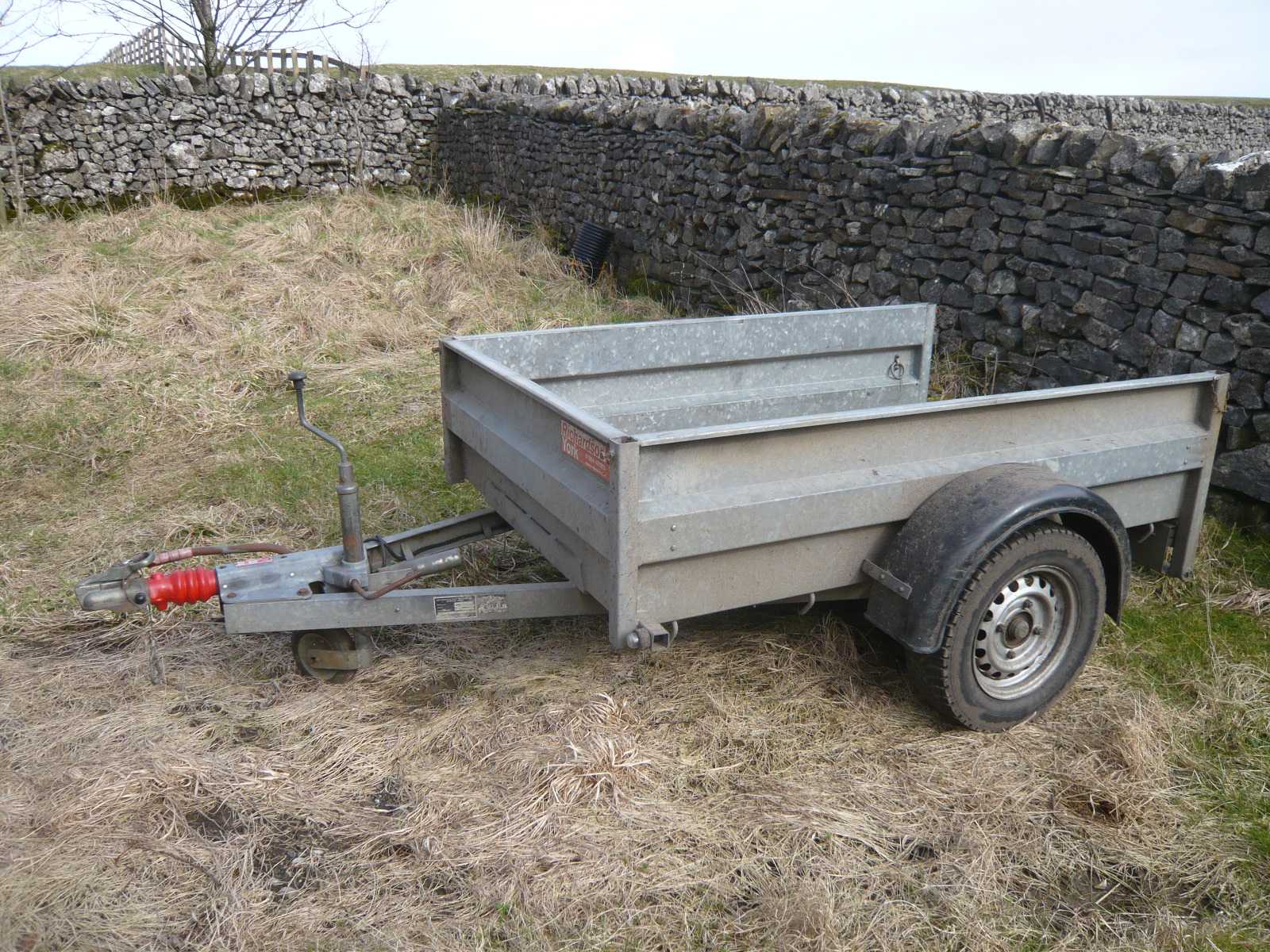

KruJoe Posted March 8, 2015 Posted March 8, 2015 It's 161cm wide at the sills. Length is about 170 to that cut around the gear lever, which could be removed and cut shorter. We have a choice of trailers you could borrow, but that would be a pain returning it. Or do you want me to ask Will if fancies doing a veg-powered delivery for £beer? We're at BD23.
Mr_Bo11ox Posted March 8, 2015 Author Posted March 8, 2015 Hey Kruj!!!! If there is any resonable way for Will to veg it down to me that would be amazing cos i am gonna have to borrow a trailer from someone and lose a day coming to get it and I'm not sure when I'm gonna have time to do that. Obv I would pay for such a service. I'm at DE6 (home) and/or CW5 (workshop)
