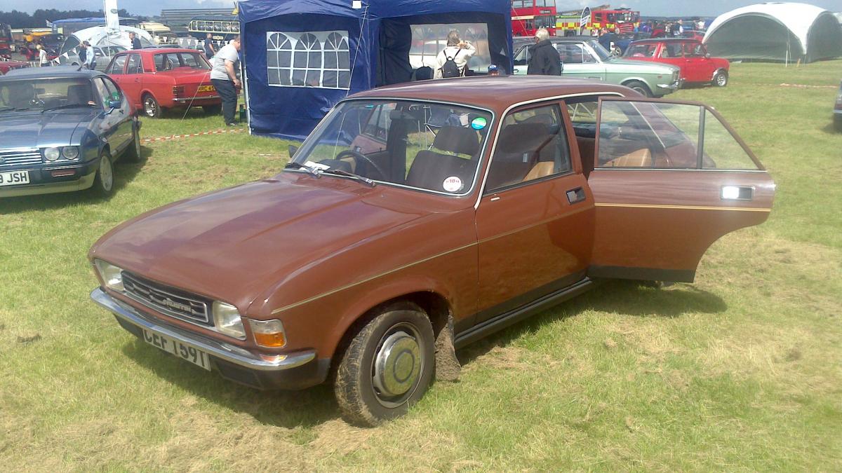

My russet brown allegro
The allegro has some issues I knew about..
bottom of passenger door..
and a couple of things the mot man found.
Some pics were taken for me when it was up on the ramp.
Overall impressions were good
The hubs and swing arms look crusty to me. I would like to dismantle and clean them up but I'm used to land rover axles and this looks more complicated. Can these gas suspension jobs be meddled with?
He didn't get a good picture of the rusty sill but it feels soft. The rot is a small area behind the lip and difficult to see without having my face under the car. Fortunately it's not close to seat belt mounts or the suspension. Looks like I'm going to have practise my thin metal welding.
The starter motor is a bit lazy and needs a couple of hits to bring it to life. Would this be the solenoid or brushes and is it worth trying to fix?

What's he best advice for the wing bubbles and door rot?
If you want to get rid of the rot, it's paint-off time. I reckon when you strip the paint off that wing there's going to at least be some heavy pitting and possibly some holes, but it may be on the edge of saving without welding if you're lucky. As I understand it, the suspension is the same as that on the Princess. It's not really that complicated compared to the more conventional set up of springs and shocks when you look into it, the main problem is it being a pressurised system. I reckon as with any job, take your time, do your research and be prepared for everything to break and you should be okay. I still think Russet Brown looks a lot like milk chocolate.

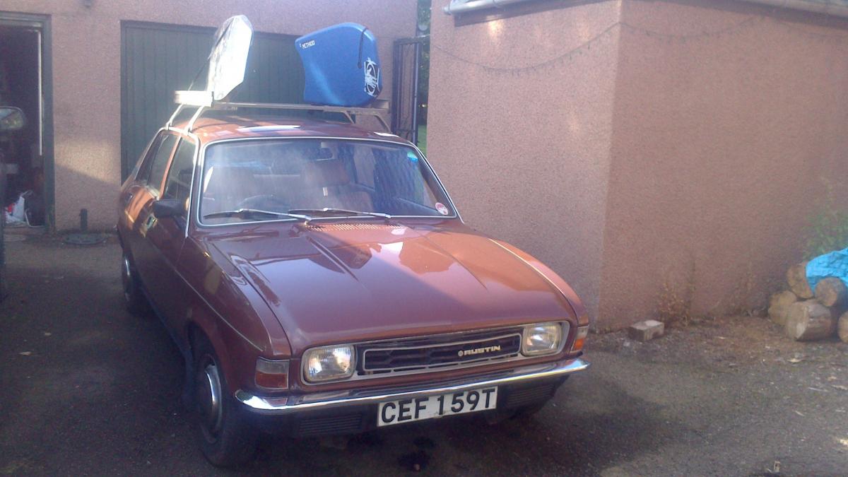

Rustin allegro update-
Whilst at the tayside classic car show the allegro attracted many a snigger. One lady admirer lingered longer than the normal reminiscer and eventually introduced herself as a representative of Allegro Club International. A rather surreal conversation followed during which, amongst other things, she offered to sell me some alloys for the brown one. I haven't joined yet.
The allegro has been pressed into service for the school run much to the embarrassment of my son who hides on the back seat. Two incidents, each of which nearly resulted in the end of the allegro, have dissuaded me from such regular usage. The first was when a cooncil worker in a mini road sweeper pulled across the road in front of me causing me to lay down two black lines of rubber and almost sending my unbelted boy through the windscreen. Stupid me.
The second incident almost ended in a ball of flames when a split fuel line between pump and carb spewed petrol all over the hot fannymould. Another lucky escape.
For a Father's Day treat, I took my dad out for a drive. He commented on the bounciness of the ride. Later he was admitted to hospital with what was eventually diagnosed as labrynthitis. I'm sure it was a coincidence.
On a happier note, I dug out my old pioneer 1020 from a box in a cupboard in the back of my garage and wired it up. It still had a C90 in it with a bad recording of led zep. Sound system sorted.

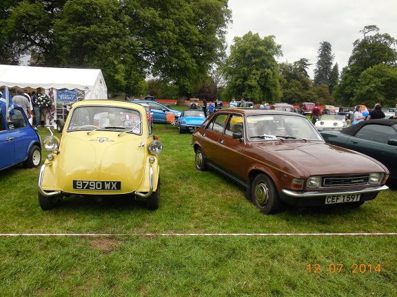

The allegro has mostly been posing at car shows this summer.
The wee turd polishes up well.
Everyone* looks in the window hoping to see a quartic steering wheel.
