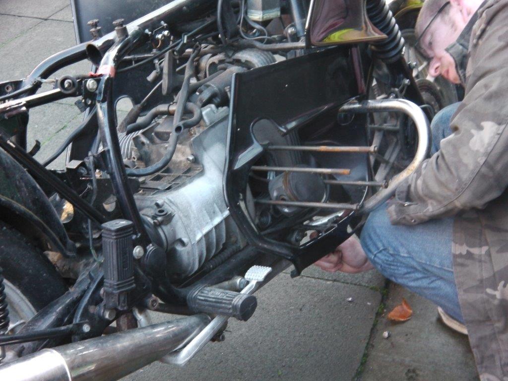

Been here before with a certain BMW R80/ Another shiter on here had thrown lots of money towards people to fix it and got to the end of his tether, Got it up here in bits and turns out it had a used R65 pot, -very worn barrel with the piston slapping around like a  (enter own description here)... That took a bit of figuring out what was going on.
Turned out nice, after a LOT of work, then I found I really didn't like riding it. Has an R1100RS before and loved it, but very different.

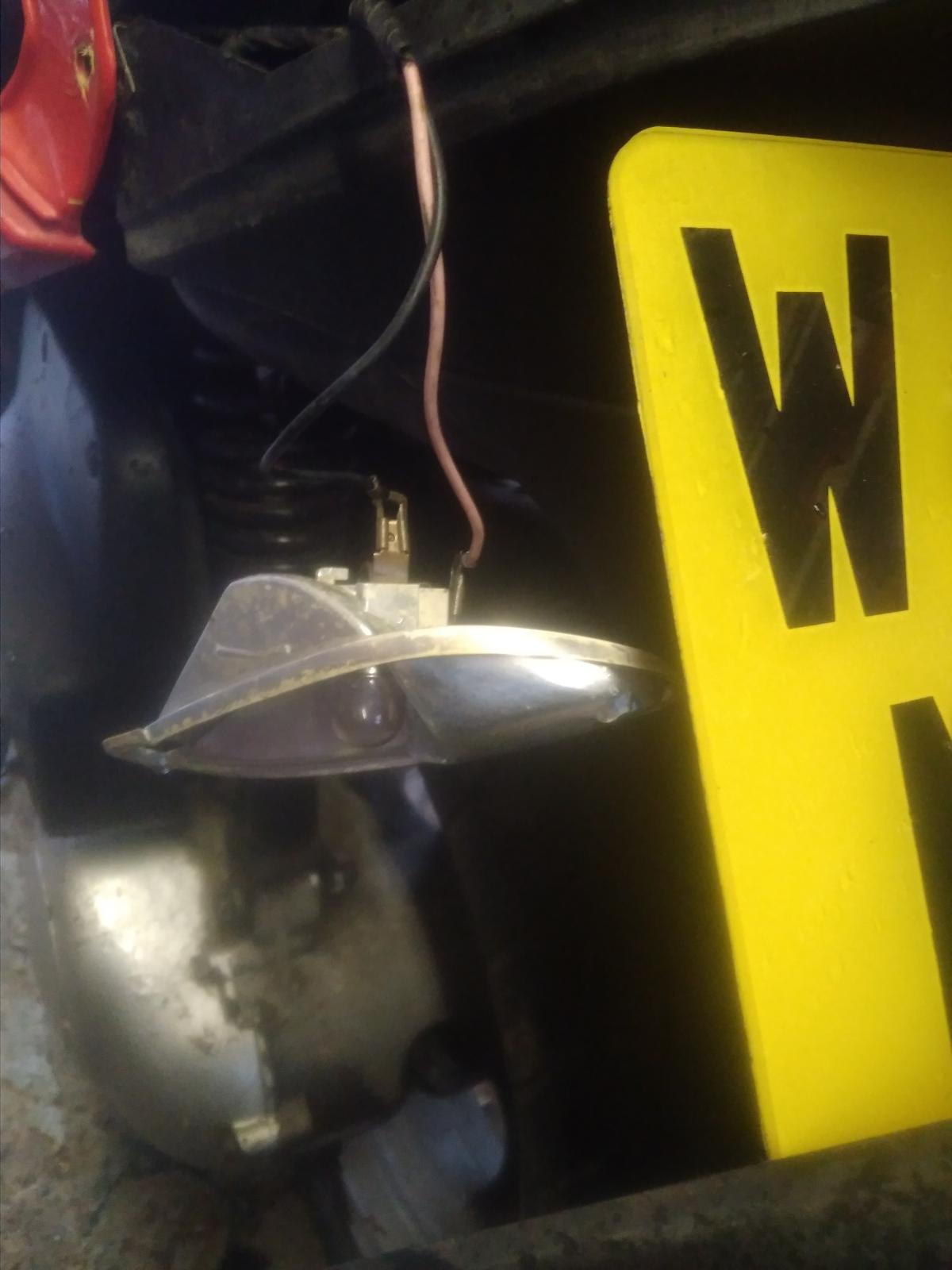

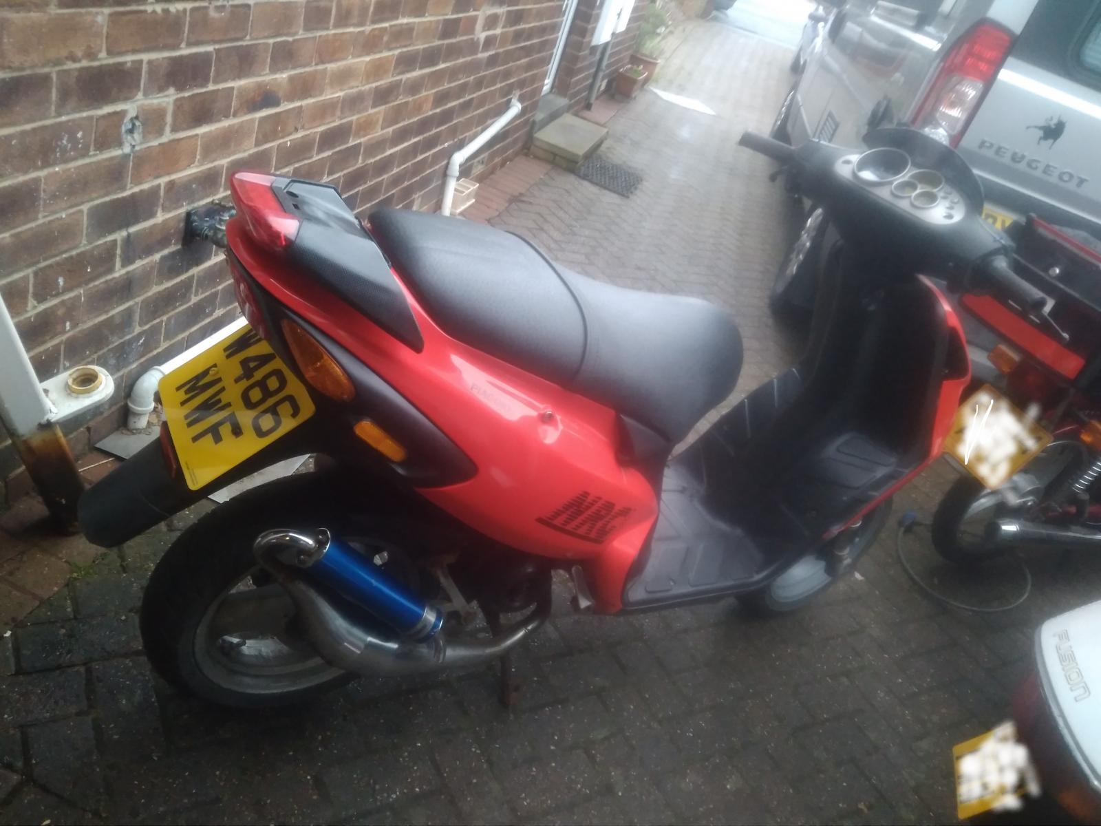

Hopefully my last day's labours on the NRG... it's funny how all the lights worked when I took it apart, but on reassembly they mysteriously didn't. It must have been the disturbing of the green stuff on the contacts that caused it. Lots of emery paper and contact cleaner was deployed in getting the indicators back into business:

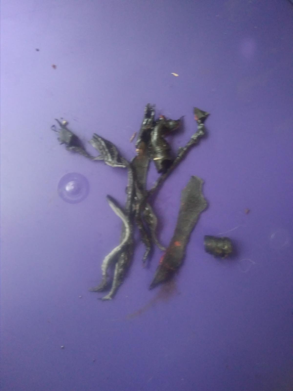

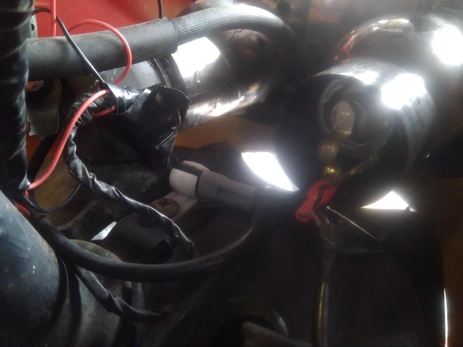

And then the manky twin headlight. A couple of the contacts simply fell off when I touched them... where's the crimping tool?

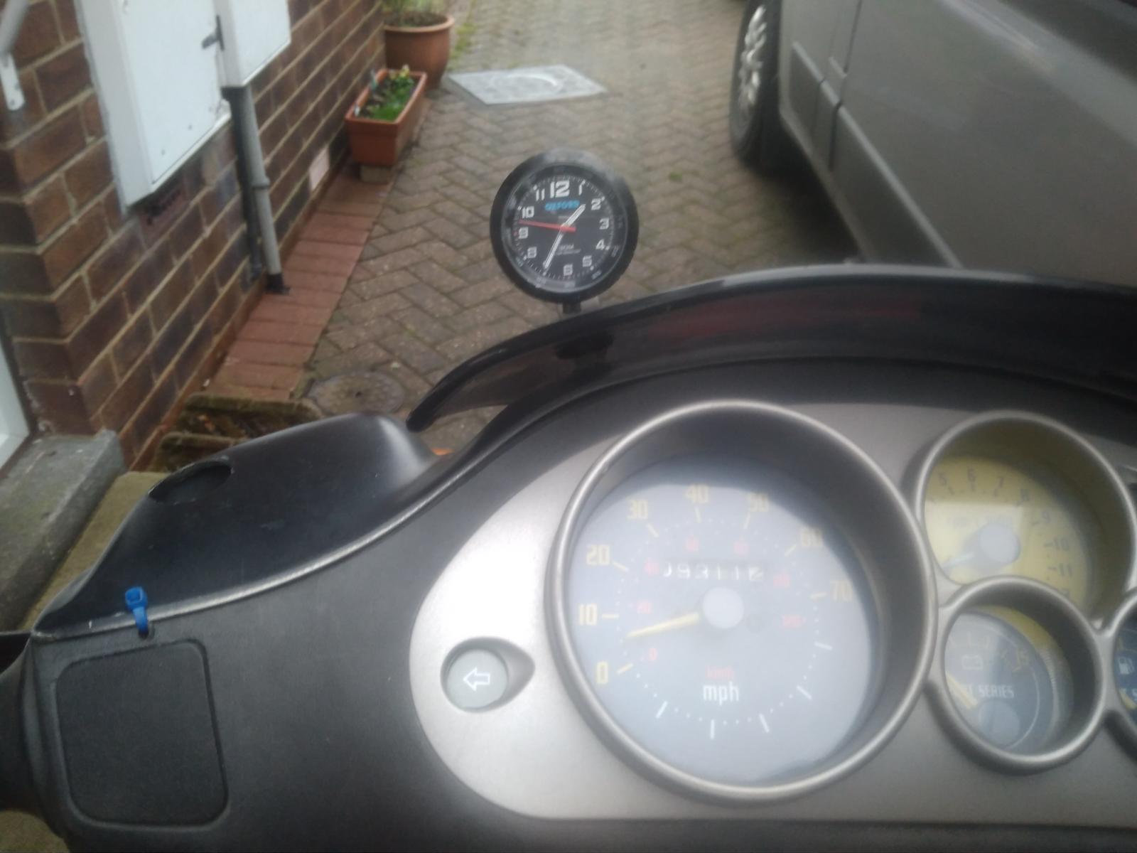

Not a problem as such, but just look at this quality* accessory - wank even by Oxford's low standards. And, no, it doesn't work.

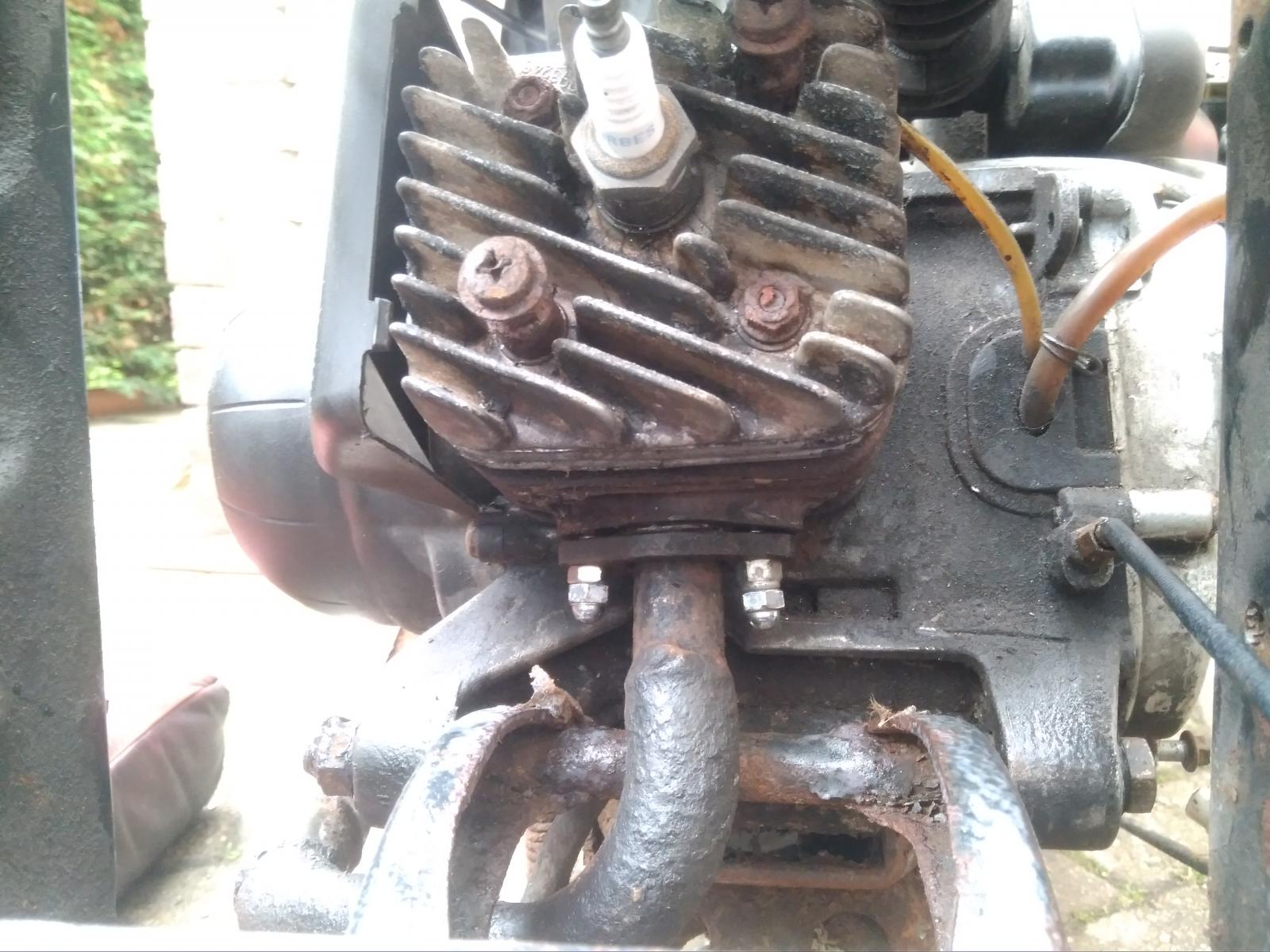

Finally all the electricals were looking shipshape again (I also chucked in a new plug cap as the one on it was loose and wobbly), but the ungrateful little sod wouldn't run properly when I fired it up. It would rev freely on the stand, but with my considerable bulk on board it simply bogged down. I had the carb off, but it was as clean as a whistle. While in there however, I noticed that the inlet manifold was slathered in black silicone. I took that and the reed valve thing off and cleaned them of the foul black shit...
then used a razor to get rid of the remaining residue before re-assembling with a good smear of Blue Hylomar. It pulled like a train!
It's not looking too bad now, definitely ready to face the man from the ministry next weekend. Here's hoping it serves its new owner well!
