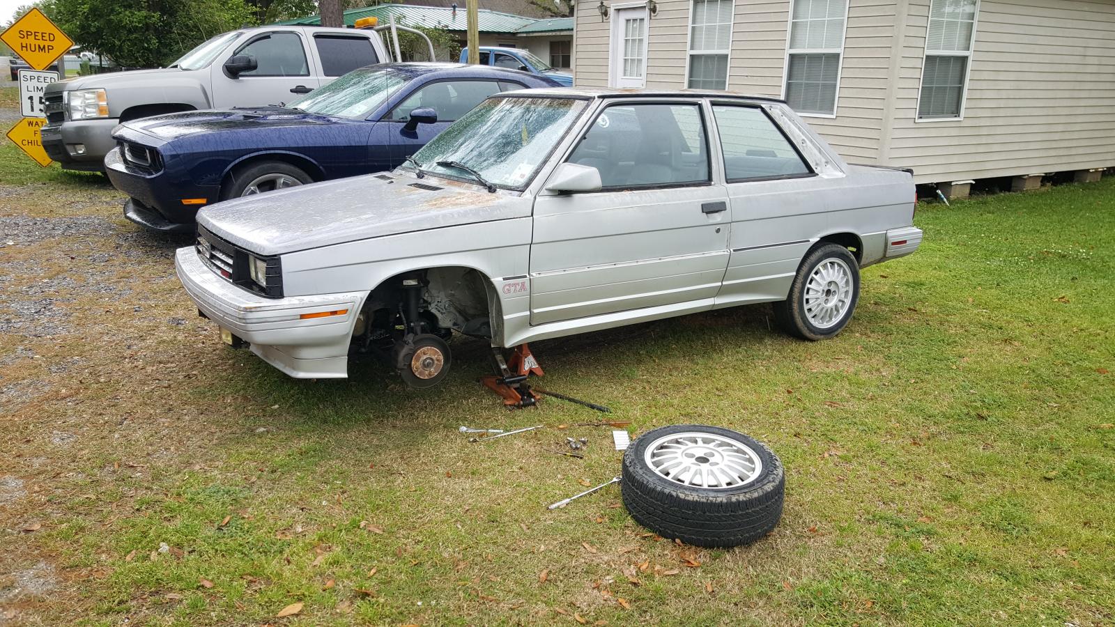

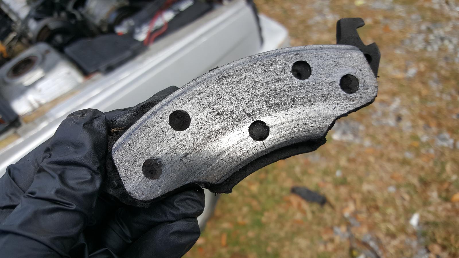

Stuck new front pads in. Both front outer CV boots have split, despite being new. Front passenger side damper has barfed all its oil and no longer damps much. Took it out for a run and the front brakes decided to bind.
Old pads were just a little bit glazed...

Well, bonus thing. Turns out the brakes only get sticky when they're hot, so it's time for a thorough clean and some copperslip. I didn't do a great job because it was raining.
Phil
Read the above as I got annoyed that the CV boots had both split so just put the pads in and did everything back up again.
Even without bedding in well, the brakes are sharp now.
