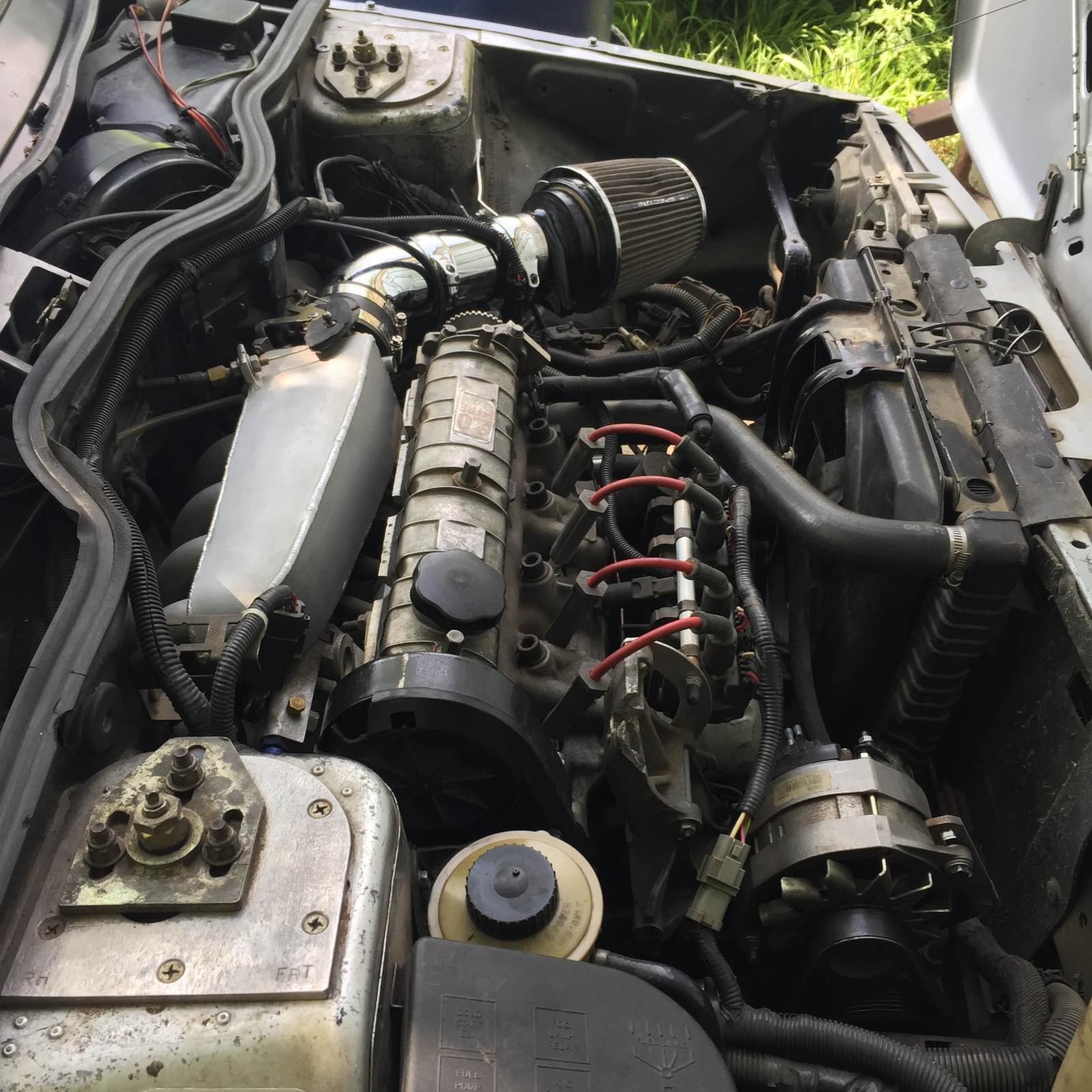

Most recent issue. Got the car stripped down, manifolds off because to get at it from underneath would have meant steering rack off, exhaust off, starter motor off.. that fell into "screw that" territory so opted for access via the top instead.
20151001_183418.jpg?m=1443747825
All unbolted and removed (4+ hours trying to remember the order in which it was meant to come off)
20151001_183428.jpg?m=1443747853
Old plugs looking a bit worse for wear. When hit with a hammer, the result wasn't so good.
20151002_184955.jpg?m=1443833647
Fought with the damn things, pain in the behind that was, with the access available to swing a hammer..
20151001_190545.jpg?m=1443747883
Core plugs I bought turned out to be the wrong size. Found out the holes were 1.5" big.
20151002_164628.jpg?m=1443833549
Managed to get all 3 out in the end. The holes themselves were in very good shape. Fished all the lose crap out of the gallery with Magnet On A Stick, which wins an award for useful tool award.
20151003_110932.jpg?m=1443889312
Bit of RTV, a suitably sized impact socket and hammer-time and we are in business.
20151003_111343.jpg?m=1443889506
The old ones were pretty ropey.
20151003_111604.jpg?m=1443889686
Filled it back up and bled the radiator, checked it out for overheats and leaks.. think we are good
20151003_133156.jpg?m=1443903606
20151003_133607.jpg?m=1443903739
20151003_133344.jpg?m=1443903673
All together and running where it should.
--Phil
