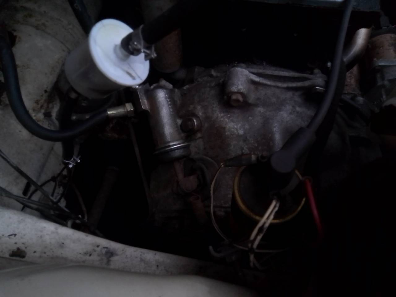

vulgalour Posted October 28, 2024 Author Posted October 28, 2024 Shall we have some photos with this update? I think that'd be nice. First up, the alternator. oooh, shiny. Got a friend to help me tension the belt fully and I'm happy to report charging is normal... mostly. It puts out a reliable 14.2volts with no load from various devices, dropping as you'd expect as various things are turned on and the load increased. Happy days. However, I noticed recently the mystery stumble has reappeared, a thing the car has done all throughout my ownership and I've never pinned down. With the multimeter on the battery I could see that when the stumble happens, the voltage drops significantly sometimes as low as 5v which is bit odd. Worse when the car is cold, it goes away once everything is warmed up. I checked the rotor arm and cap, they both had slightly dirty contacts so I cleaned those up which improved matters a bit but didn't solve the issue. Plug leads and connections are all clean, don't appear to have any damage, aren't brittle, etc. Coil seems to be doing coil things and the electronic ignition seems to be operating normally. I didn't pull the spark plugs, haven't had the energy to go that far just yet, so I'm wondering if it's perhaps a fouled plug causing the issue and as things get hot, whatever is fouling the plug gets burned off and that's why the problem goes away. Another electrical gremlin is my headlight switch is being recalcitrant. Some days it works just fine, other days it refuses to latch in the fully on position. I do have a replacement switch and a new headlight wiring loom with relays and correct configuration for twin lights, it's just another job I haven't yet had the energy to do. It'll get done soon-ish. The most recent malady had been the clutch slave cylinder just splurging its guts out. Fortunately even though this is a rare part there was one available on eBay when I needed it so I scooped that up and aside from it taking a little while to fully bleed, I can report that's fixed the problem. Or at least it's fixed the problem where I couldn't select gears properly. The rotational squeak persists. Since I can't find any signs of the cause at all, there's nothing on show with the brakes, wheel, front axle, bearing, CV joint, etc. and it's not related to any sort of input from the clutch or brake pedal, I'm at a total loss as to what it might be. I have noticed since doing the clutch slave cylinder the volume of the squeak is much reduced so the only thing I can think is, given the condition of that clutch arm boot (I've never been able to find a replacement for it) is that maybe some of the clutch fluid has got in and contaminated the clutch a little bit in one spot. I'm not experiencing a slipping clutch so I don't think it's done any harm if that is the case, I just can't think what else it could be at all and nobody that has looked at the car can find the cause of it either, all we can agree on is it's something on the driver's front corner. When we next have some dry weather I'm going to have another go at that rear axle mount bracket. I didn't have the strength to do it last time, perhaps in a few days I will. It's only two bolts I'm struggling with so once I've got those cracked off I can quite easily replace the part and then maybe, just maybe, I can book the people in for doing the suspension regas. I've also chased Pilkingtons again for where my windscreen that I ordered in June has got to. I'm pretty disappointed at how long it's taken, especially considering how much it cost me. Sunny Jim, danthecapriman, Dyslexic Viking and 6 others 9
