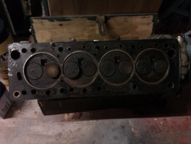

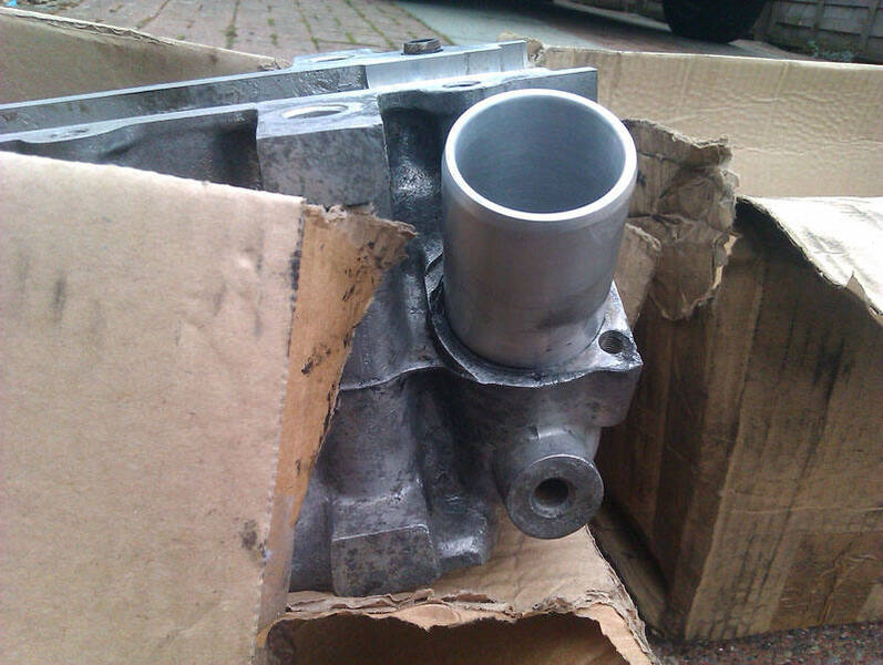

I finally picked up the head today.  I'd been given so many different conflicting stories about where the pipe had come from that I really didn't believe it was sorted, and while I did get a sincere apology for the owner of the shop losing his rag at me for putting too much pressure on... well.  Let's just say it's a shop I shan't be using again.  I'm not going to name-and-shame either, I don't believe that's necessary in this particular instance.  I got the head back, I got the job done, and while it has been frustrating it's just one of those things.  Everyone is human and honestly, I think I've run afoul here of someone whose personal life is causing problems with his professional life.  The sincere apology was enough to convince me that he knew he crossed a line, professionally, and there's no need to go any further with that.  We're only human, after all, and I can certainly empathise with where he seemed to be, I just hope he gets it all straightened out.
All that said, I'm not entirely happy with the work done.  I paid for the pipe that was made, that's only fair, but the pipe has no flange on it.  The pipe itself is a custom turned piece and fitted to the head with weld-seal, I think that's what he called it, much like Porsche do with their coolant pipes.  The lack of flange doesn't worry me too much as the radiator hose we temporarily repaired likewise has no flanges and hasn't leaked or fired off so I'm moderately certain just double-jubileeing the hose to the pipe will be sufficient.  If it isn't, well, we'll have to figure out what to do about it I suppose.  It was £45 for this and, honestly, I'm not sure how to feel about that.  The job is technically done and £45 isn't a lot of money BUT it was a war to get it done and that's left a bit of a sour taste over the whole experience.
Still, at least I can move on with this now.  The next challenge is finding time when my friend over in Lincolnshire is off at the same time as I am so we can rebuild the head properly.  I picked up an oil filter today - local motorfactor had one on the shelf, which was really useful - and I'll be getting some fresh oil, coolant, and a flush to make sure everything is nice and clean when it's all put back together.  The Princess will ride again soon.

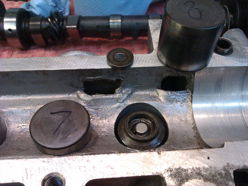

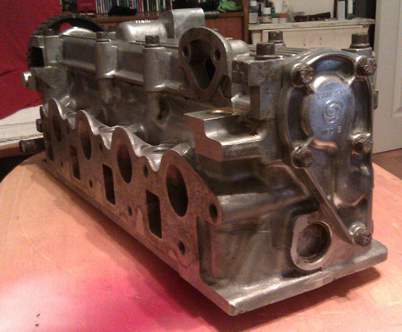

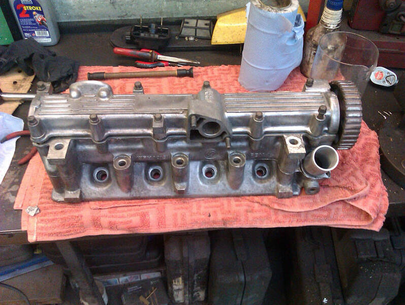

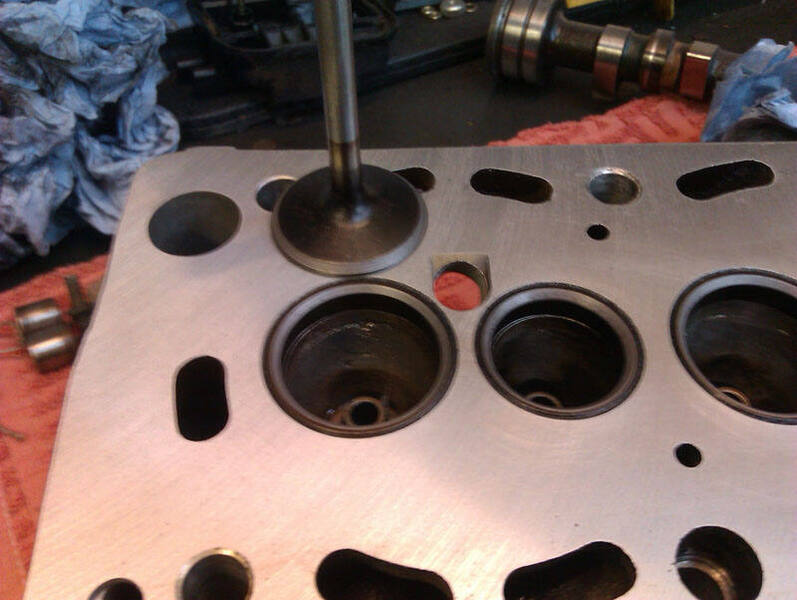

On the engine front, it was the tedious job of valve lapping mostly.  They didn't need a huge amount of work at least and Mike had already cleaned off the deposits on the stem side for me so I didn't have to faff with that, so it was just a fairly straightforward process of twiddly stick and grinding paste followed by plenty of cleaning.
Once they were nice and matchy-cleany again it was time to reassemble.  It's a bit awkward to do but not really difficult.  New valve stem seals on the  valves that needed it, as per the book.
Once all the valves and springs were in, it was time to refit the shims and buckets.  Again, this is straightforward.  There's no noticeable wear (to the naked eye) on the components, or on the camshaft, so I suspect that when we check all this on the weekend we'll change nothing and just button it all down.

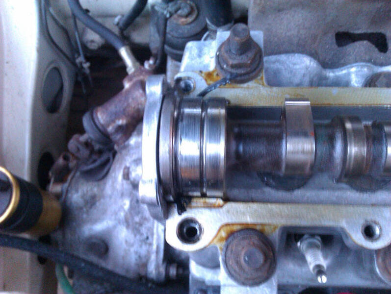

I replaced both camshaft seals, tightening the camshaft pulley to torque as per the book after replacing the big seal.  Then I loosely bolted the cam box top half down so nothing comes out of place and popped the whole thing in its box ready for the weekend.
I can't wait to get this back on the car, it looks so nice already!

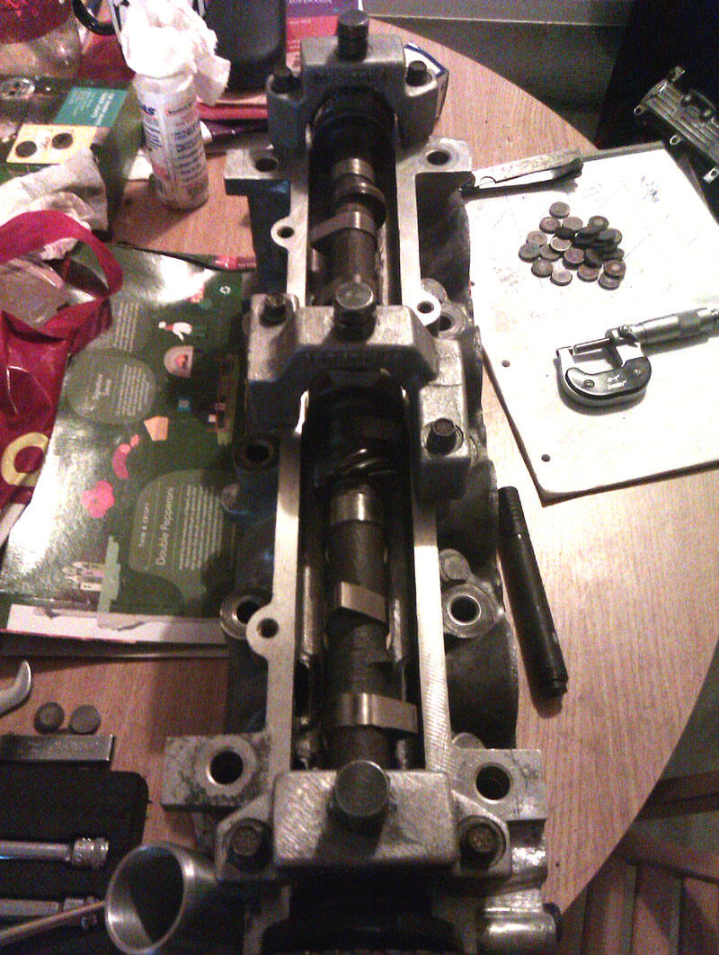

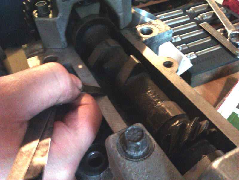

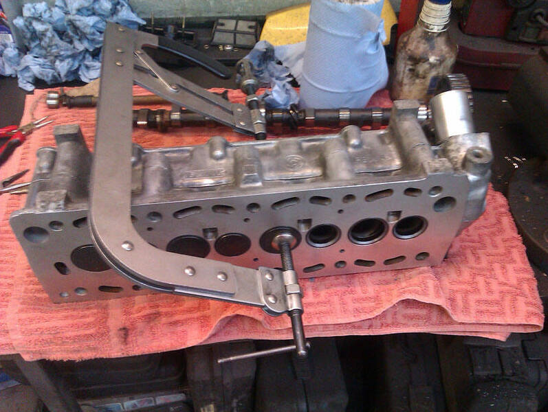

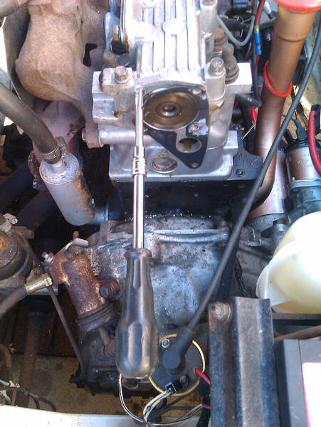

To measure the clearances you need a feeler gauge and something to clamp the camshaft down with.  Fortunately, my friend had the special O-series tool for the job which is essentially three blocks of alloy that bolt down over the bearings and have little nylon blocks that screw down to clamp everything in place.  This means you can get in at the gap between camshaft lobe and bucket with the feeler gauge and find out what the gap actually is.  He also had a wide array of shims on hand so we'd hopefully have enough to sort the clearances properly.
After a lot of maths, and a few rounds of removing the special clamps and camshaft, lifting buckets to replace the shims, clamping everything down and remeasuring, all of the tolerances were brought up to a much more acceptable and even measurement across the board, as close to 12 thou as we could get.  This was all done after I'd already lapped the valves in properly which, of course, affects your clearances since material is being removed.  What I had thought was a machined circle on one side of the old shims was actually wear.  In this next image you can see the special clamps and, to the right, the micrometer for measuring the shims.  I'd go into more detail about the facts and figures and how we actually did all this but I've forgotten, which is why I normally do the write ups immediately.

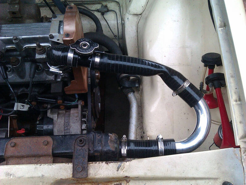

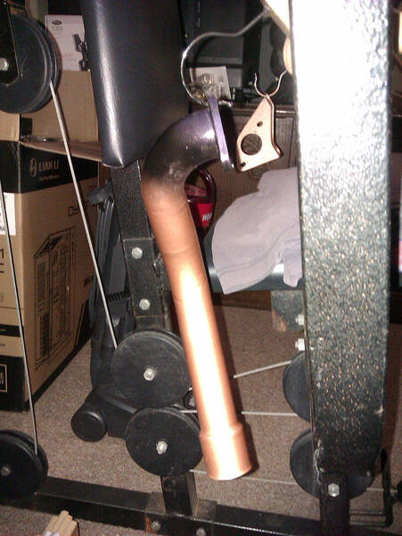

Another item I ordered was an in-line radiator top hose filler, it took me a while to find a UK supplier for this and what turned up is really very nice (no picture, you'll see it later no doubt).  I made a measuring mistake and bought one that takes a smaller cap than the one on the car, but I've found that the pressure rating of the car's coolant system is close enough to MX-5 systems that I should be able to use a cap from one of those with no bother.  The bonus here is that MX-5 components are plentiful, and affordable, so should I need another cap for any reason, it should be easy to replace.  The new hoses and clamps I need have also been easy to source since Mike has left over stuff from other projects that are suitable.  I have everything lined up ready to do the head and fluids swap, the only thing holding me up now is this wretched virus or whatever it is I've contracted, so as soon as I'm well again, I'll get this job done.

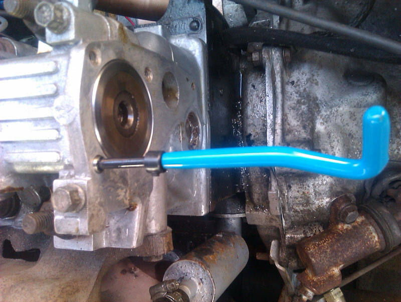

Then, finally, something went wrong.  The temperature sender in the head needed to come out, I hadn't bought a replacement because it hadn't crossed my mind.  Since it's a soft brass thing I didn't want to apply to much force so used an appropriately sized ring spanner and gently applied pressure.  PING.  That'll be the head of the sender firing off somewhere, propelled by the spring inside.  Great.  That means I can't put coolant in the engine when the new head goes on because I've nothing to go in the hole on the new head so I'll get one of those ordered. At least they're cheap and easy to acquire, normally.  I've never had one of these shear before, so it was quite surprising.

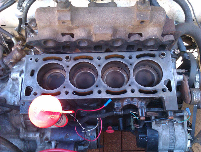

Moving on, I got the head off without too much bother, it didn't put up much of a fight happily.  It's quite black inside, I suspect it's been running rich, except for one valve which is very clean compared to the others.  There's no obvious failure on the gasket apart from it not sitting entirely flush on the same side as the one comparatively pale looking valve.  I'm not sure what the issue would be there, I'm not an expert, but I imagine it's related to the problem and possibly related to me trying to chase down just why the engine wouldn't run quite right.  There's not a huge build up of carbon etc, but it's also not the nicest looking combustion zones I've seen.  I'll be glad to get the new head on there.  The block side, as it happens, looks infinitely better, with nice clean piston crowns and cylinder walls.  I don't remember what I did to this head when I pulled it from the '79 car it came off and fitted it to this one, I don't believe it was as in depth as I've been on this round.
By the time I got the head off it was too dark to see what I was doing and I didn't have suitable lighting to help out.  I can't get the car into the garage because of still being mid-house-move so it's still full of boxes and furniture (urgh, another saga that's going on too long) otherwise that's just what I would have done to get things finished.  So at the end of play today this is where we're at, and the only reason you can see this so well is the camera flash, I couldn't actually see this anywhere near so well in person.

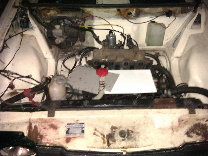

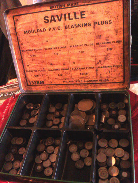

Rather than plonking either head back on there before I've cleaned the block surfaces properly, I plopped some cardboard down to keep stuff out of the block until tomorrow.
I'll attack this tomorrow. Annoyingly, I shan't have the car running tomorrow because of that temperature sender but I'm going to make hay and take the opportunity to de-purple the engine bay while I wait on the parts arriving.  Oh and yes, the Princess does have a bit of a lean on.  It's partly the drive, partly the driver's front displacer, so I need to send the front pair away to get regassed to sort that and when they're away, I'll take the opportunity to fit the new bumpstops I got for the front end that it's never had in all the years I've owned the car.

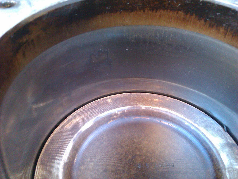

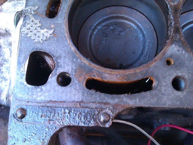

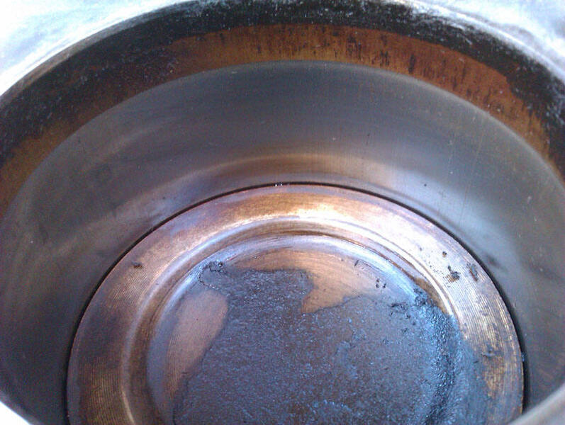

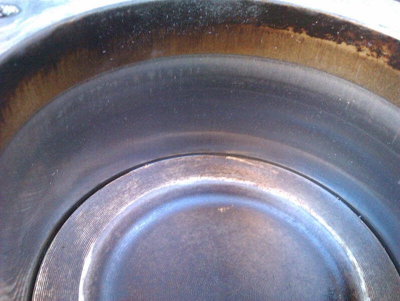

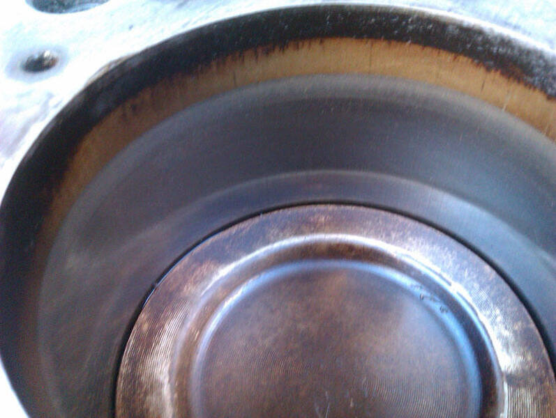

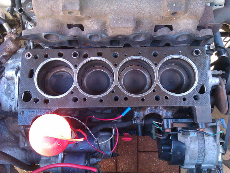

With some better light today I could get a better look at the block face and, it turns out, find the point that the head gasket had failed.  There was a brown oily-rusty stain on that cylinder with the paler valve, while everything else was in good shape.  No idea why it blew here, or how, but it did.
I then went over the whole block face and cleaned it up, as well as cleaning up the cylinders and piston crowns as much as I could for a general health inspection.  The vertical lines in the shot couldn't be felt with a fingernail and if you moved slightly the light wouldn't catch them and they weren't visible, so I'm assuming that's just normal wear rather than anything to worry about.  No ridge at the top of the cylinders that I could feel, just the transition from the dirtier oily bit at the top and the shinier clean bit below.  Apart from the cylinder that was next to the blown part of the gasket, the cylinder crowns all looked very clean.  A little oily, but nothing a very quick wipe with a tissue couldn't solve so maybe the piston rings are a little worn which might explain why the car consumes a little bit of oil on a longer run.  I'm not tipping gallons of oil in every week even in regular use so I'm certainly not worrying about it for now.  I bought a set of piston rings anyway, because I found they were surprisingly plentiful and affordable, so that will hopefully help in the future should I want to rebuild the bottom end of the engine.
The block face cleaned up very nicely, I went over the whole thing with a Stanley blade to get rid of the old gasket material that was stuck, and then some fine wet and dry sandpaper on a block before wiping it all down.  No signs of pitting or corrosion, or any build up of nasty stuff in the waterways, so I tapped the locating dowels home and plonked the new head gasket on.

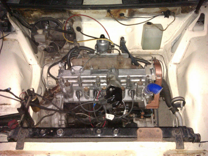

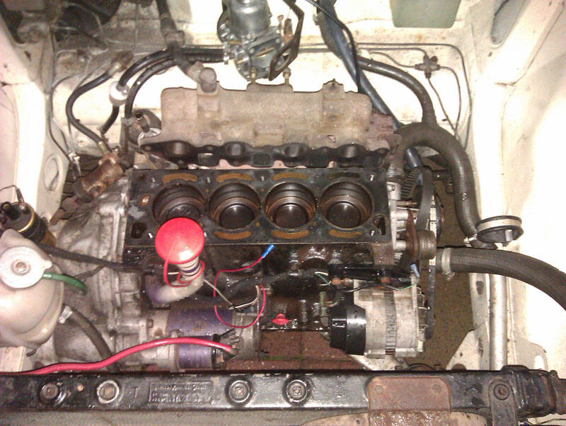

Then I plonked the head on and started bolting bits to it.  First up was the exhaust manifold since it's the biggest chunk of thing to do.  I line it up, feed the gasket through the gap between manifold and head, and then put a bolt through at each end to hold it in place.  It's a bit fiddly, but saves me splitting that downpipe join.  Once those two bolts have got a few threads in I add the rest and tighten everything down evenly.  I've found making a couple of passes across all the bolts seems to make the best seal rather than dogging each one up in turn, so that's what I did.

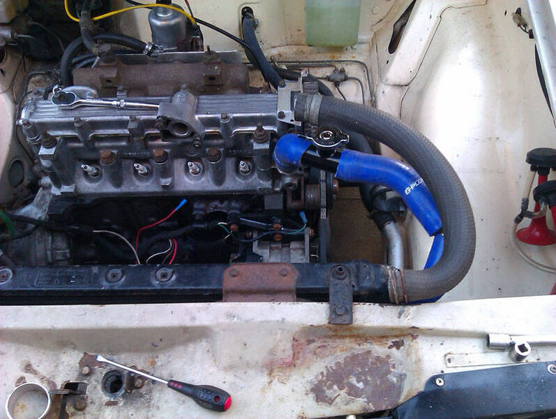

Then I needed to find what in the bag of spare hoses fit.  Annoyingly, only the hideous blue silicone hose was the correct diameter and, perhaps fortunately, didn't have quite the right shapes I needed for the application.  Served well for mock-up.  In a way it's good I'm doing this because the old top hose - which is slightly too small a diameter and also not quite the right shape - has started to perish so is definitely due to be replaced.  I'll have to order some new bends, in black, of the appropriate dimensions so that I can get this all together.  The new parts will take pretty much exactly the same route as the old ones, so this has turned out to be a fairly elegant solution.  The only difficulty has been working out exactly how the in-pipe thermostat works, but after some trial and error I figured that out.  The filler point will be slightly higher than the top of the engine, which I understand is pretty much ideal, and the thermostat can really go in anywhere on that length between the filler and the radiator itself, you just push it into the hose far enough that you've enough hose past it to clamp to the pipe outlets, so I'll likely put it in the pipe right next to the filler, or right next to the radiator.  A jubilee around the thermostat then holds it in place on the pipe.  It's not the most attractive solution, but it's cost effective and sensible for this application.  The split in the hose where I've put the thermostat for mock up is not where the thermostat will be, nor will  that hose be split there.  I have a theory that less joins in the hose is better in part because it means less points it can leak, and in part because it's probably just better somehow.
Before fitting the timing belt, I noticed the camshaft had moved ever so slightly off the point it needed to be, so I tried to move it.  No joy.  It was jammed, which was very strange because off the car it rotated quite nicely and I had used assembly lube to prevent just this.  Rather than panic, I pulled the cambox off and found that the O-ring seal that looked like it should go at one end of the camshaft had just torn and jammed everything.  I'm glad I spotted this now and not when I tried to start the car.  Now, this seal is a bit of an odd one because it doesn't really need to be there.  The end plate on the  head allows oil to circulate anyway and the camshaft doesn't need that O-ring to support it since the bearing does that, there's also nothing that needs the oil to be kept on one side or the other of it... so I removed it and didn't fit another one.  This was in part because I didn't have another one to fit but also because I'm pretty sure another O-ring would do exactly the same thing.  With that sorted, I fitted the timing belt and everything turned freely.  I gave the engine a couple of rotations to work the assembly lube about a bit better and just check things felt right and they do, there's nothing amiss that I'm aware of now.
With that done I was aware that it was getting colder and darker and I'd not yet done the de-purpling I meant to, so I quickly popped the oil filler tube, starter motor, and starter motor bracket off and got them painted before it got too cold to do it.  Then quickly stuffed them in the house where it was warm so the paint didn't go all weird.  I was going to use more black, but I didn't have much, so used copper instead which matches the timing belt cover I did a while ago.  Should look fine once reinstalled.  Oil pick-up tube got a black fade at the bottom, which was unintentional at first since it was the last of my black paint but I rolled with it since the block is black so it now sort of fades into the copper.  For the starter motor it's just the middle casings that are done in copper, the rest of the bare alloy is kept just like that, which should look smart enough. Neither of these paint jobs will last, it's not exactly the right paint for the job, but it'll do for now and looks more cohesive than the mismatch I had before.
Then it was time to pack up and wait for the parts I need to arrive later this week. We're all ready to go, but until I've got the new hoses and temperature sender I can't really go any further just yet.  Oh, and the expansion bottle went in the dishwasher because, and I quote "it's due a cleaning cycle so we might as well", or at least that's what Mike tells me.
looking at your noo filling solution i would maybe have the elbow from the head turned moar straighterer and utilise the mahoosive space over wheel arch for a nice gentle curve to the pipeage
p.s the "rad" cap for a Hunda Spaceship is black if the silver jars your OCD ?
You'd think that, but I can't actually swing the elbow join that way because it'll foul on the timing belt cover.  I've ordered the various pieces I need to make the new hose and, for what I'm getting, I didn't think it was too bad price wise.  90 bend from the head to the filler, straight hose from the filler to a metal 135 degree elbow, and then a reducer hose from that to the radiator since the radiator outlet is a smaller diameter than the rest.  The insert in the head should have been the same size as the radiator outlet but that's another thing that was done wrong on that so it's actually marginally bigger than everything else.  Fortunately, it's not such a big size increase that the hose won't fit onto it but still, it's another mark against that particular item.
I don't mind the silver cap, it matches the one on the expansion bottle.  Speaking of, that's come out of the machine looking much cleaner and, as Mike put it "the colour of an old person's eye", which it is.  Lovely.
Maybe a good idea to get the thermostat closer to the head though? Otherwise it could be a bit late getting the message to open
There might be space to put it in the elbow pipe before the filler section, if not it has to go after the filler neck.  That's pretty close to the head and not far off where the old waxstat lived so it should be fine I'd think.  Not really sure how I'd get it any closer tbh.
just a thought- you can't pop an thremostat in your new spigot can you? (ooh err missus)?
just seen there is an inline filter housing VAG use on TFSi engines clicky
Well, that's pretty much what I was looking for before going the R5 route, so that's a nuisance.  Oh well, I'm committed to this now.  Annoyingly the thermostat I've got is just a tiny bit too big to go in the pipe in the head and there's not enough material on either item to shave down to make things fit.
well on the up side at least there is a Plan B if Plan A goes all french on you ?

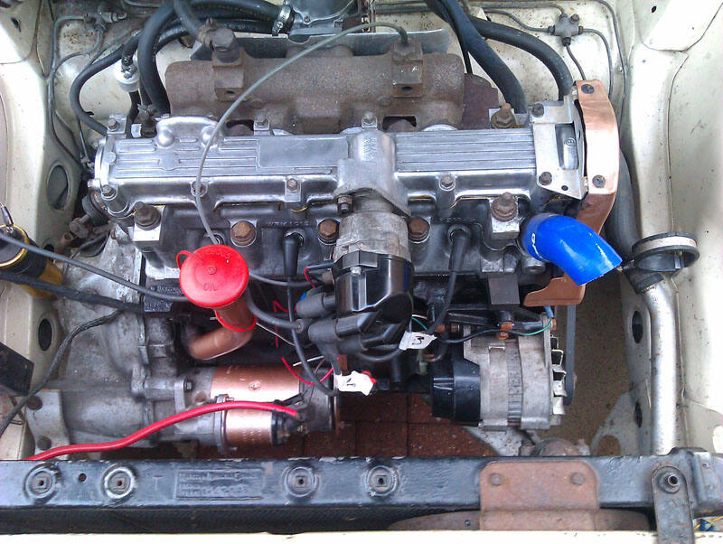

Things have been progressing, though it feels very much like two steps forward and one back. For some reason I don't understand, the number plate system used by parts suppliers is bringing this car up as a 2.2, which it isn't, so trying to find the relevant part and part number is proving difficult. The supplier that did have one told me it was broken and could they have my reg to try and find an alternative stock. This was fine until my details didn't match up with their details and then they wanted a list of details as long as my arm, including things like which are the driven wheels and what the VIN number is. I've done this dance before. Basically they don't have the part and they'll take loads of details to in the end tell me they can't get it. The reason for ordering another sender was my own stupidity when I managed to order a pair of 2.2 senders that look the same as the 1.7/2.0 sender, but are much larger. But seriously, try putting GBT563W into a parts site and you'll see it comes up with the 2.2 engine, which mine has never been, it comes up as a hatchback instead of a saloon a lot too, and I've had that result in a supplier refusing to supply a part.

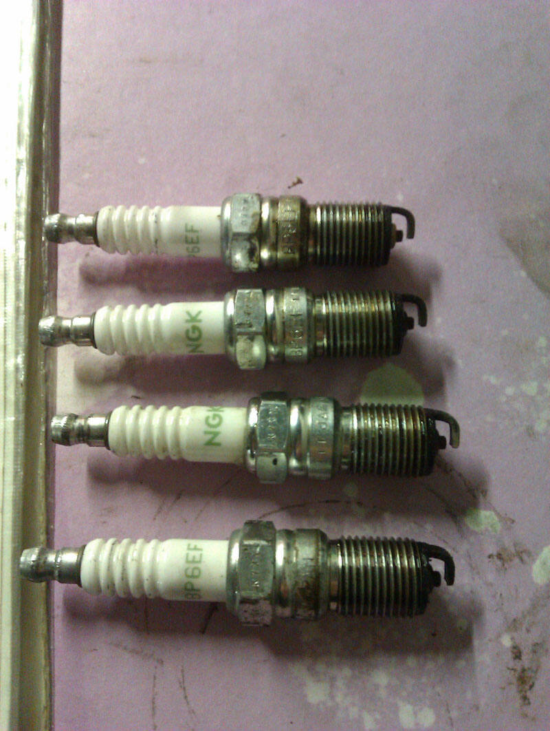

Fun times. Anyway, the one thing that was correct that did arrive was the new Beru spark plugs. I spent a bit more, I didn't really need to, I just wanted to go with something that should be that little bit nicer than the usual NGK stuff I put in (which is perfectly fine too) to try and iron out any running niggles I might have. I'm not sure they'll make any difference at all in reality and I've kept the old NGKs I took out because there's nothing inherently wrong with them and it's good to have emergency spares just in case.

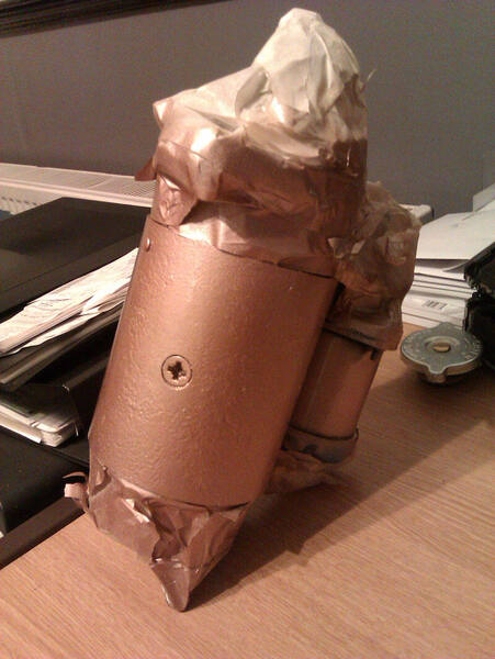

I then reinstalled the starter motor, it's bracket, and the oil fill tube. I think they look much nicer now they're painted to match everything else.
Now I just have to wait on the hoses arriving to finish that, a new sump plug washer since it turns out I don't have one the correct size in stock, and a new temperature sender that's actually correct. It's all a bit frustrating at the moment.

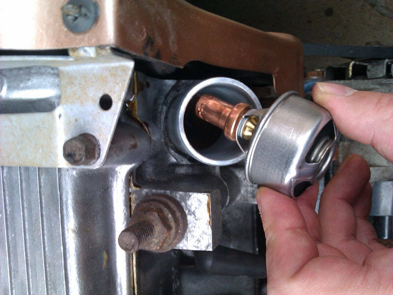

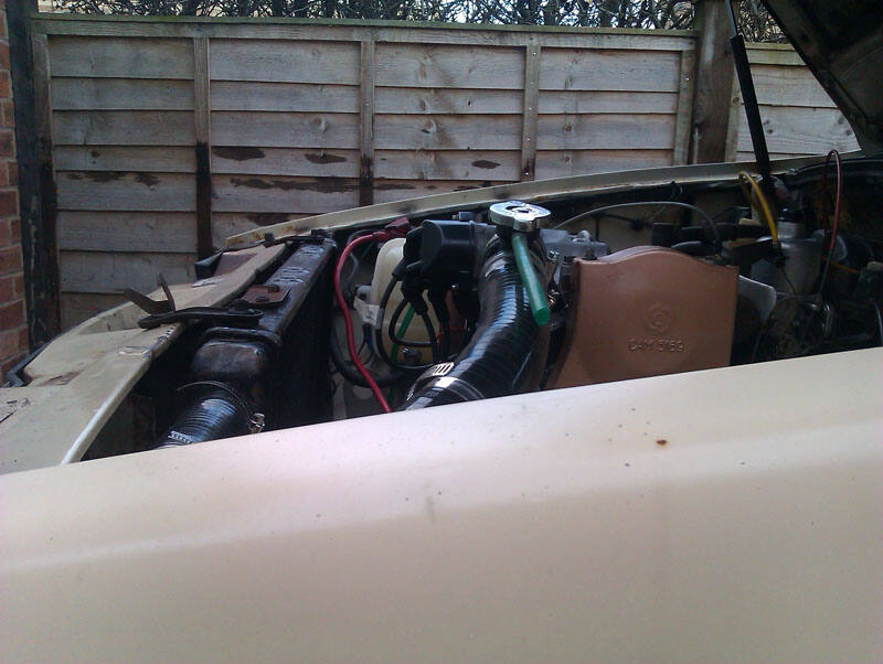

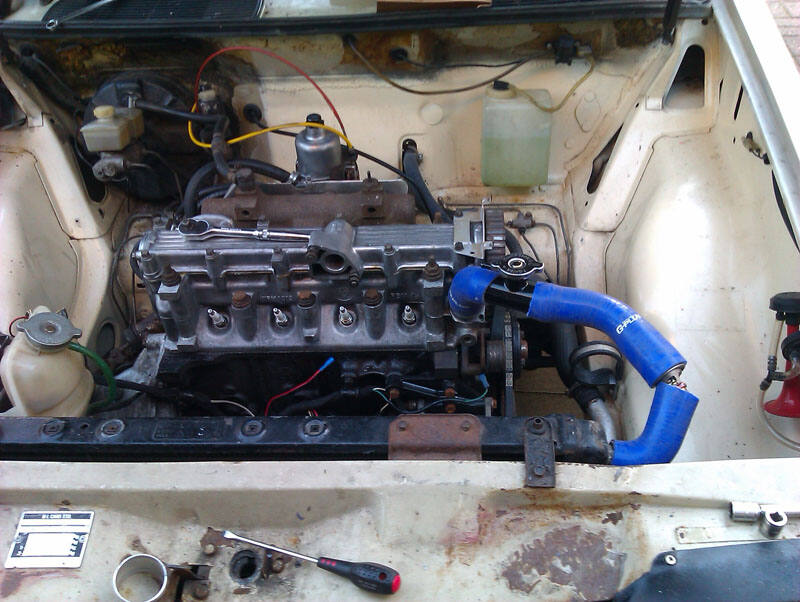

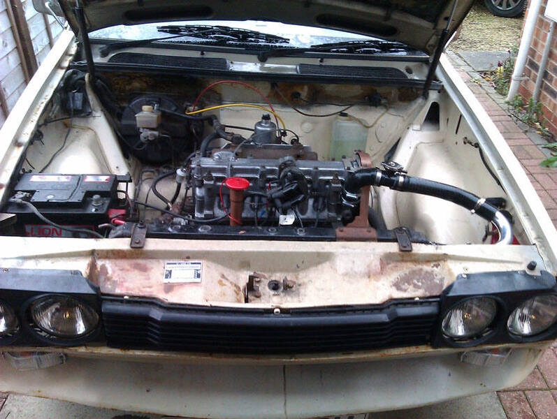

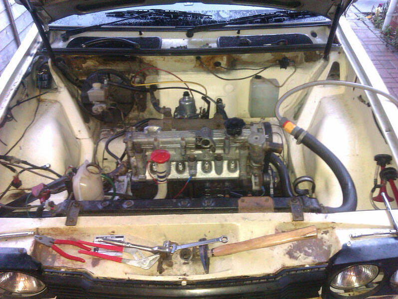

Parts delivery!  We're getting the windows done today so I was glad of the pipes arriving so I had something to do.  Stealing a bit of time while workmen are on lunch, then I have to turn the computer off because noise, mess, etc. in the same room as the computer.  I digress.  With all the lovely new pipes I could set to installing.  For the thermostat, I'm sticking it as close to the head as I can, temperature pick up in pretty much the same place as it was on the original waxstat.

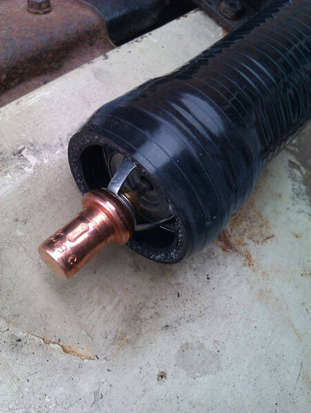

Soak the end of the hose in a bit of hot water in a mug so it goes over that rolled edge of the thermostat and then push it into place by pushing down against that custom pipe that was installed in place of the old waxstat housing.
Then remove it and trim the elbow down shorter because it was too tall.  You also have to put the jubilee in before the hose because there isn't enough clearance to thread the clamp on after the hose because of the casing around one of the cambox bolts.  It is a very tight fit.
After that, go through and install the various bits of pipe and clamps in the relevant places and you're looking somewhat close to sorted.  The filler cap *just* clears the bonnet, and on the first fit I had a kink in the long straight I didn't like.

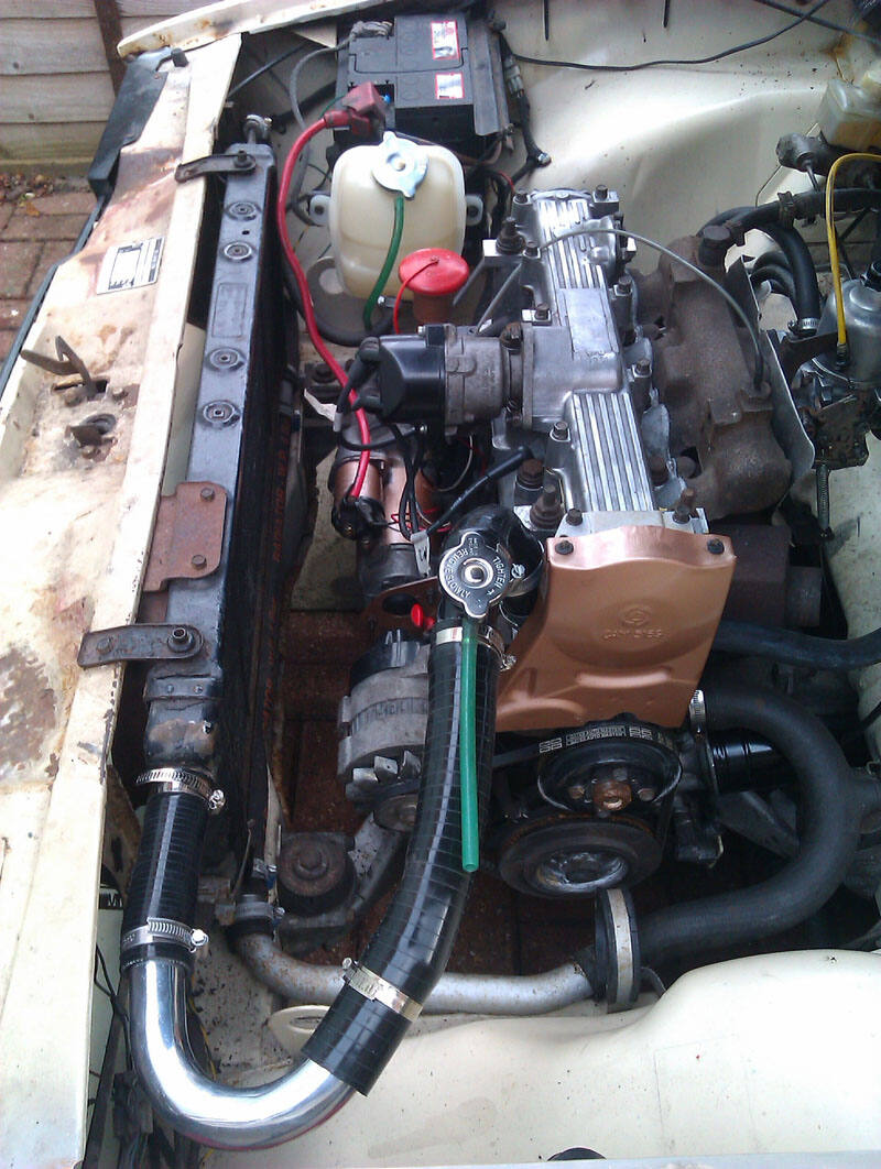

Moving the metal elbow out a bit solved that.
It's not quite as elegant as I'd hope for a solution.  It should work satisfactorily and doesn't look really any worse than the factory arrangement.  Now I'm just waiting on the sump plug washers and another temperature sender to arrive so I can get fluids in and try and start the car.

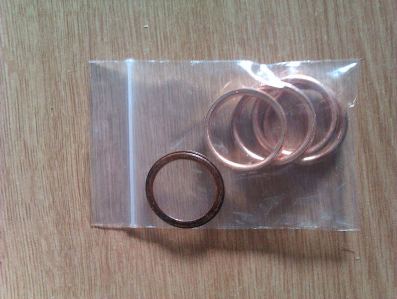

We are slowly winning, today the new sump plug washers arrived.  I've used copper compression washers since that's what was on the sump plug and while these are marginally larger, I've not had any oil fall out yet.  The new washer is a slightly larger inner diameter than the sump plug thread, and a slightly smaller outer diameter than the sump plug flange, so I expect that will be adequate.  Certainly since dumping the relevant quantity of oil into the car, none of it has fallen out, so we should be good.

The last thing I wanted to show that wasn't as clear in the other pictures is just how far down the radiator drops from the head and highlight another reason for the new hose taking the route it does.

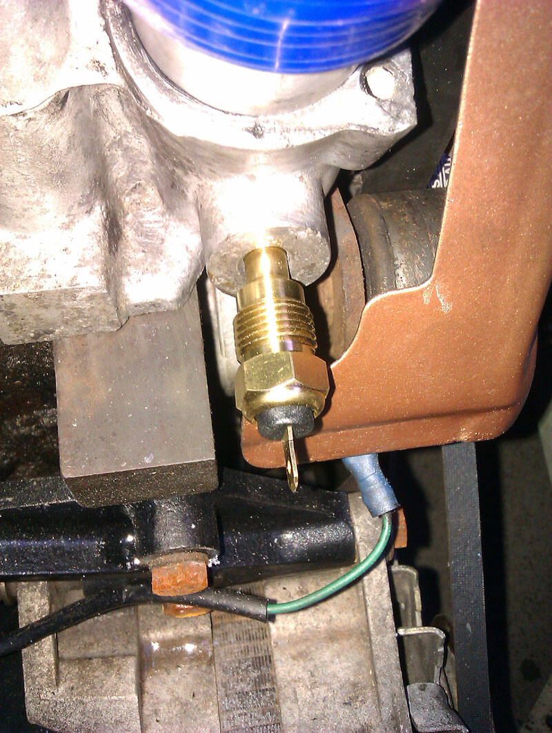

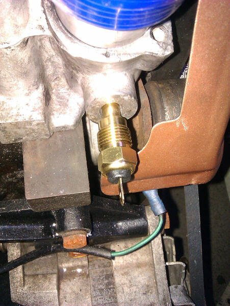

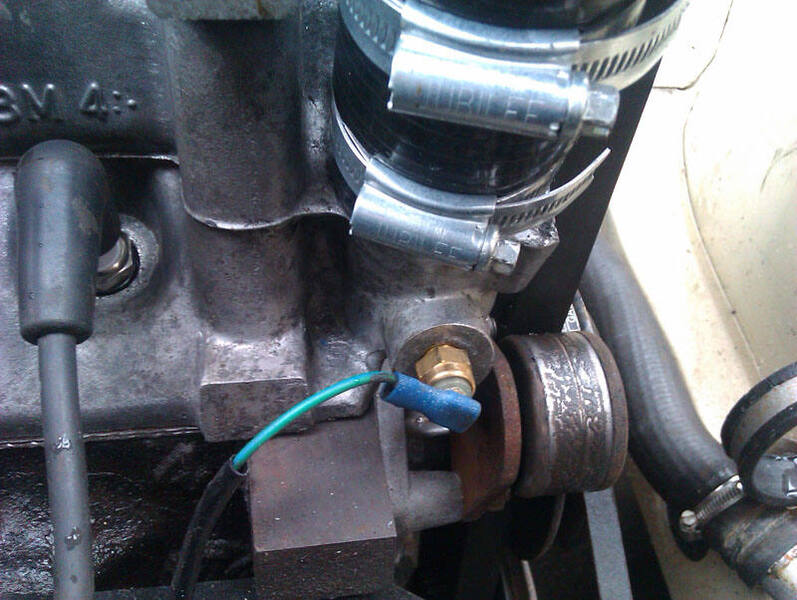

I'm just waiting on the new temperature sender to arrive so that I can get coolant in, or rather plain water and Forté biodegreaser, and then coolant after that and any contaminants are flushed out.  So very nearly ready to fire it up again now.
The temperature sender arrived and fits!  I had to snip a slot into the plastic cover on the spade connector so it could slide onto the weird top-hat fitting on the sender, it's otherwise no bother and now I can fit either type of sender should I need to in the future.

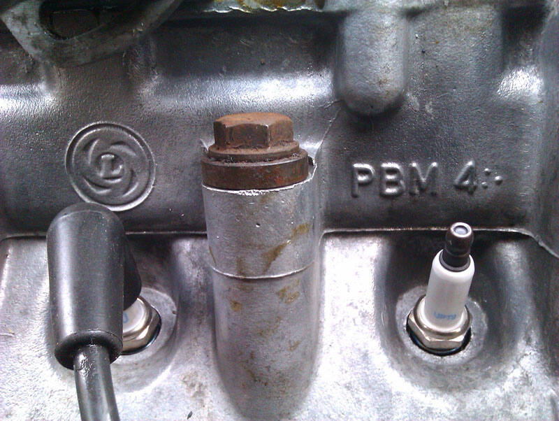

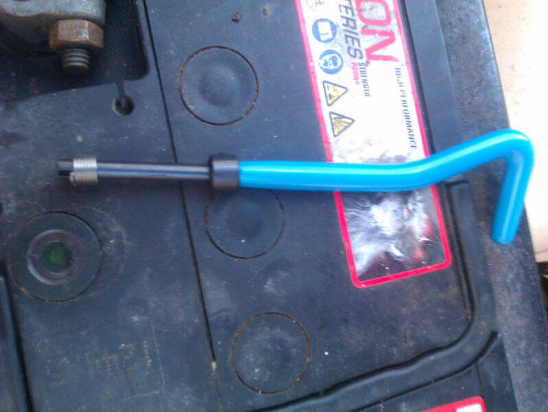

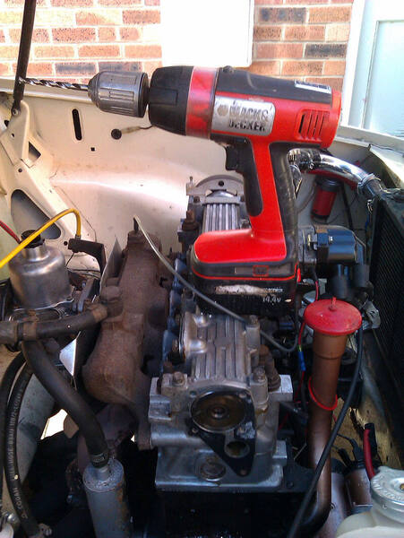

Helicoil kit ordered since I haven't got one, and Mike has one but doesn't have an insert this size.  At least access to put the insert in is really good and it should be straightforward.  So close!
Let us start with the good news, then I shall get on to the not so good news.  As requested, here follows instructions on how to helicoil or thread repair a stripped thread.  First, you need to find out what thread type you need to put back in, you can get little thread measuring comb things for this.  Once you know the thread type, you can order the relevant kit, I got mine online because real world shops don't stock anything any more, and I went by Silverline from a reputable seller (if their eBay feedback is anything to go by), it arrived promptly.
There are instructions included, and very clear they are too.  Included in the kit is a drill bit to clear out the old thread from the hole, a tap to make the new thread for the helicoils to bite into, and a couple of tools, one of which is for inserting the helicoil.  Carefully drill out the hole first, a variable speed drill is good for this as you want to go steady, especially on soft material like aluminium.

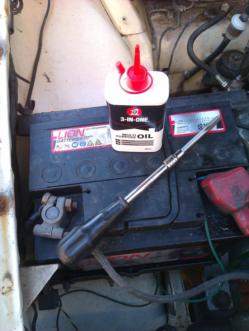

The kit doesn't include a holder for the tap, I found a 6mm hex socket worked quite well.  Use a little oil as well so that the tool doesn't bind.  When you make the new thread, take your time.  It will cut really quite quickly in aluminium and it's best to make a few turns until it starts to offer resistance and then back the tool out a bit to get the swarf out. Be sure to check the depth you're going to on a blind hole, straight through holes aren't an issue in this regard.
With the hole tapped with the new thread, flush it out with something like WD40 and clear as much swarf away as you can.  Then insert the new helicoil with the tool provided.  Find the first one doesn't want to go in, the second one pings off never to be seen again, and the third is the charm going in with no bother.  You should be able to wind it all the way in, I couldn't, for some reason this third helicoil decided it didn't want to go all the way in and needed the end trimming off.  Before redrilling the hole, tested it with a bolt and it was fine and does the job so it'll do.

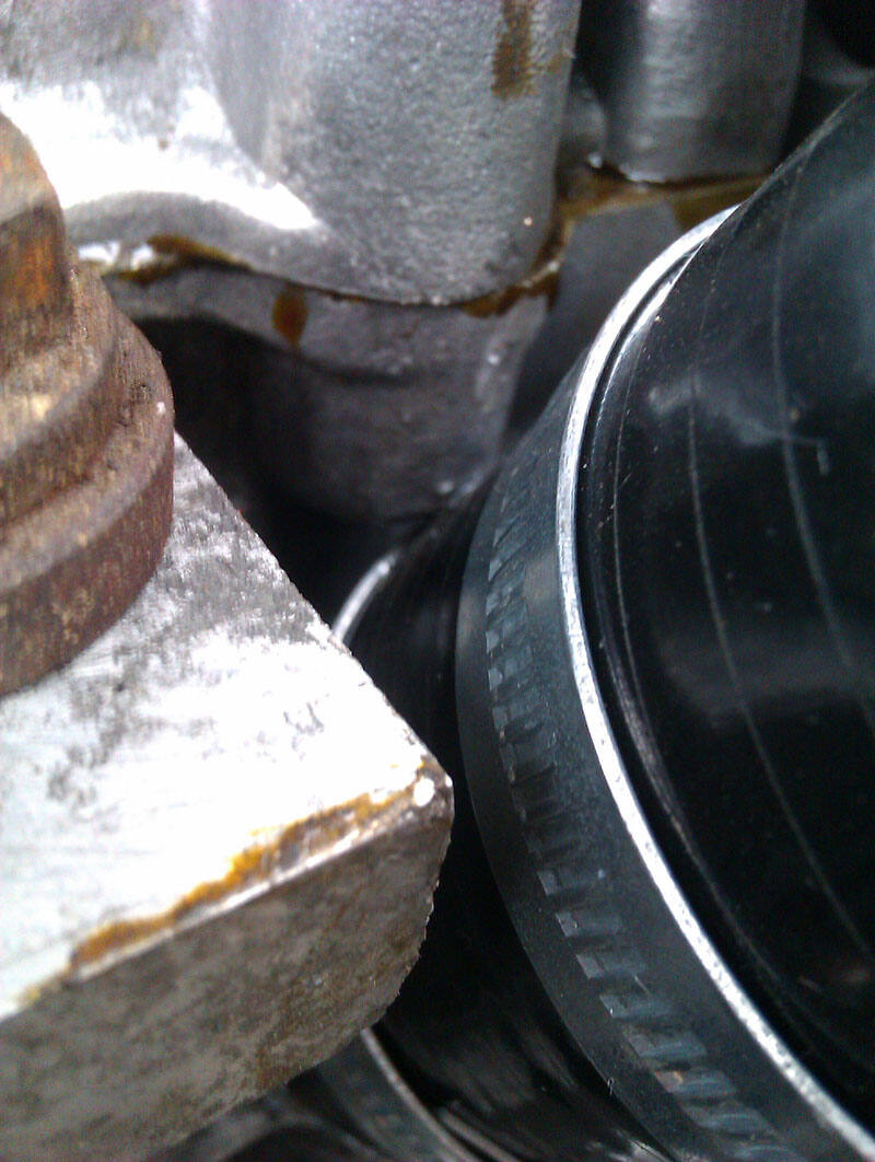

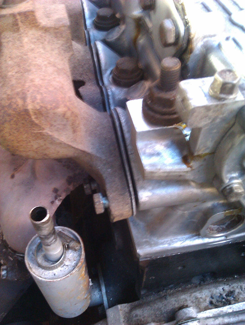

Easy peasy, really.  The paper gasket had got a split in it from where the oil had pushed out so I reinstalled the plate without it, choosing to use sealant instead.  This was a mistake.
What I didn't know is that the paper gasket at that goes between the head and the end plate actually serves not only to stop the oil escaping but also to space it out a tiny bit from the end of the camshaft.  So when I tried to start the car to leak test and do all the other good stuff, it wouldn't.  The starter was making a very peculiar noise and while the engine was turning and not making any unusual noises, something was amiss.  Then I made it worse.  Checked that fuel and spark was being delivered, which it was in good quantity, checked that the timing was where it should be and that was when I noticed the static timing was ninety degrees out.
That got me worried.  So I tried to turn the crankshaft in the usual way with a socket on it and it would not budge.  This was confusing because clearly the starter motor could do it without getting hot.  Off with the timing belt - no point trying to set it to top dead centre, since that couldn't be done - the distributor and then the top of the cam box.  My initial thought was something had got jammed on the cam somehow, I just couldn't figure out how.  With the top of the cam box off I could see the camshaft hadn't budged at all, normally it would begin to lift as the valve springs underneath push everything about.  Nothing was obviously jamming the camshaft so I tried to lift it out from the sprocket end and then discovered it was stuck against the inside of the end plate.  Fully unbolted the end plate (you only need to remove the top two bolts to get the top of the cam box off) and the two pieces parted company.
I gave everything as much of an inspection as I could and there were no signs of anything being damaged, at least to the naked eye.  That's when I decided to put the paper gasket back in and bolt it all together to see if that really was the cause.  Sure enough, with the paper gasket back between head and end plate, the camshaft could rotate freely.  At this point I still hadn't figured out it might be something more serious so went to the trouble of resetting the timing and putting everything back in.  I tested it by hand and everything turned freely, a little too freely in fact, but I wasn't sure why that would be as I'd not encountered this issue before.
A crank of the key and now the starter motor sounded normal - probably because it wasn't having to try anywhere near as hard - but no joy.  Still plentiful spark and fuel and that's when it dawned on me that I had no compression.  Like, no compression AT ALL.  Where you'd expect resistance on the compression stroke there isn't anything and, turning the engine slowly by hand there's the twang of a spring and you can feel something clicking through the ratchet so something important in the head has broken.
If I'm really lucky, I've snapped some springs and nothing more.  If not, I could have bent valves and all sorts.  The only way I'll find out is by pulling the head off and that's not happening today.  I will do it but this was such a kick in the motivation that I don't know when I'll come back to this.  I'm too close to potentially moving house to be pulling the engine apart for a rebuilt and - providing the house move doesn't go wrong yet again - my plan is to pull off the head to inspect it, then put it all back together to keep the parts in one place and just transport the car to the new house.  I'm not fixing it this year.  I'm not spending any more money, or time, or effort, on this car this year.  I will sort this when I'm in a better place to sort it, financially, mentally, and physically.
Obviously, I'm pretty narked about the whole thing and feel monumentally daft for not knowing that a paper gasket had to be a paper gasket for engineering purposes.
