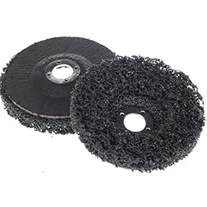

michael1703 Posted June 27, 2015 Posted June 27, 2015 The biggest challenge now is definitely removing the really bad respray, the paint clogs the flap wheel, doesn't seem to be affected by paintstripper and only really comes off when you apply heat enough to soften it and can then peel it off in sheets. Nasty, nasty stuff to remove.
