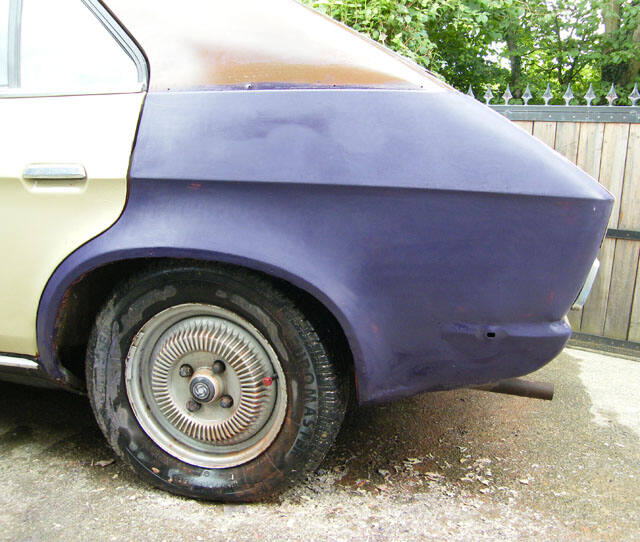

There will be a full update soon, I've got to work through photos of today's work and, more importantly, of the work that's been undone.
The panel did get all the paint removed with a flap wheel eventually, there would have been pictures of this but my camera ate them. The flap wheel took off the paint, the very thick underneath coats and the surface rust without warping, denting or gouging the metal. All of the respray needs to be redone, I can't stress this enough, because the paint is lifting off on its own and there's clearly moisture getting underneath it and causing rust which is far more deadly than a bit of badly applied purple paint. I'm actually worried about the old paint and just how many places new blisters are appearing each week, flatting it back and putting new paint on top isn't an option as where I have done that (in beige, I might add) the blistering is reappearing as the reaction is in the base coats somewhere, necessitating removal of all the paint. After everything was cleaned up, Kurust was used to eliminate any rust I might have missed and after that, as little filler as possible was used to get the shape back on the crash damaged area. This alone should extend the life of the panel.
I'm going to disregard opinions on the shade of the purple, it's a colour I love more than the beige, it's a proper BL colour and it's right for the car. Yes, rebeiging is the easy option, yes giving the car to a pro to respray it is the easy option, I am not disputing that. Nor will I dispute that quite a few folks here prefer the beige, that's okay, beige is good but given the chance to change it, I think I always would. I am not going to disregard the OMG SHIT FINISH remarks because I agree, the finish was appalling. I was wanting to highlight more the colour, than the finish, as I was happy and excited about the 70sness of the purple as I thought others would be. More fool me.
Finally, I'm going to carry on and put the hard work in to make this right again and in fact I have today as you will see when I make the update in full. It's only paint, I haven't consigned the Princess to the scrapheap, anything I do I can pay someone else to undo, if I want to.

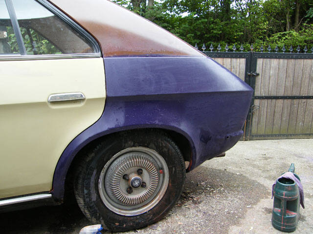

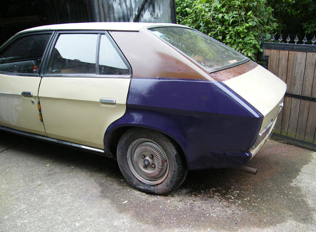

Update time for everyone on the paint.

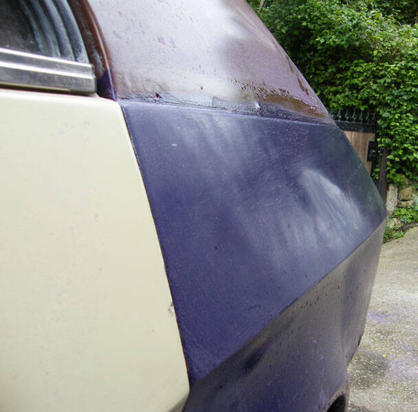

After a few hours of wet sanding, that shockingly poor quality coat of paint has been saved. Here's a snap part way through.
It's actually not that bad going once you get into the swing of it. There were a few spots that the paint was thin on, and some trouble from the roller incident, but overall it's not bad. There's even a bit of a shine there and this is only the keying back for new paint stage so it's a promising result here.
Several hours later, the whole panel had been flatted back to a finish that was comparably smooth to the beige while still keeping a good amount of coverage on the panel. Just as well I like sanding.
We let the paint dry off, went over one or two smaller areas that needed it and took a break to make sure it was all properly dry before going on to the next stage.
I learned that the paint is actually a little thicker than it ought to be, so I'll be getting some appropriate thinners to let it down a bit. The paint settles out smooth nicely, but it's drying too quickly or not settling out fast enough to go as smooth as it ought to. The thickness of the paint being a little off is why the panel looks a bit bobbly with this new coat, but that won't be the final finish, there's more sanding and polishing to be done to get it where it needs to be.
All of the shut lines will get done as I work around the car, as will the insides of the boot and engine bay. I'm planning to do a proper job on this and not cut corners which will definitely be time consuming but, as this is my hobby, that's okay. The big advantage for me doing the paint in this way is that I can find and remedy problems as I encounter them without having to take the car off the road. The next step is working out how much paint and thinners I'll need, make an estimate on paint removal materials and then do the costs so I can save up for everything. I'm budgeting about £100-200 for materials alone and many thousands of hours labour to get the finish I want. I may yet do the interior bits myself and get someone else to do the bulk of the paint application on the exterior to save on time, for now I wanted to just repair this panel and try out a colour idea.
So there you have it, not a total disaster.

New brushes are already on the list of materials I need to buy. Finding a good brush and what is advertised as a good brush (but often sheds like crazy) is a different matter. I've spent literally pounds on supposedly good quality brushes only to have them shed on fresh paint (not always on cars, I might add) like a white cat on a black jumper.

I'm not going to pass judgement, it is your car after all, but can I ask - is that purple a metallic?
If it is, then you will never, ever ever get an even finish without spraying it.
Even metallic rattle cans are hopeless for a large area because of the way the metal flakes lay as the paint is applied.
The flakes have to lay perfectly evenly and in the same direction, with a rattle can you can get somewhere near this by applying the last coat as a light dust from a distance and without moving the can around to much but with a brush, not a chance.
If it is not metallic - then disregard all of the above and invest in trade size packs of wet and dry and a big can of deep heat.
Good luck whatever you decide, no one could dispute the amount of work going into this project.
I believe that Aconite is a solid colour :)
It is indeed a flat colour. I'd toyed with metallic, but I would NEVER attempt to brush or roller metallic paint on. Even being super careful with rattle can I've noticed metallic paint has a habit of 'clumping' which is a right bitch to get out again. Metallic paint on large areas is definitely in the get someone in territory for me.
