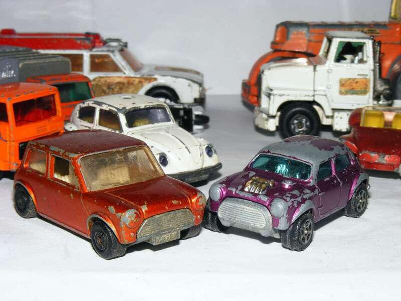

All the Team Corgi Minis have been thrashed and trashed.
A few windows and bumpers are broke.
There' a gang of 1/36 Metros. Again some have really been through the ringer.
One has lost the bottom half of the rear hatch.
A smaller gang of the smaller scale Metros.
Lots of wear and repainting.

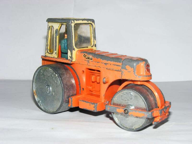

Dinky Road Roller with faded paint.

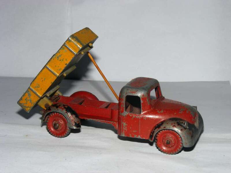

And finally we have this vintage piece
The tipper needs a cocktail stick to hold it up.
It is not any particular type of truck.
It was made by Charbens. This is model number 8 and was made from 1947 to 1960. Most of the paint is original including the stuff on the wheels.

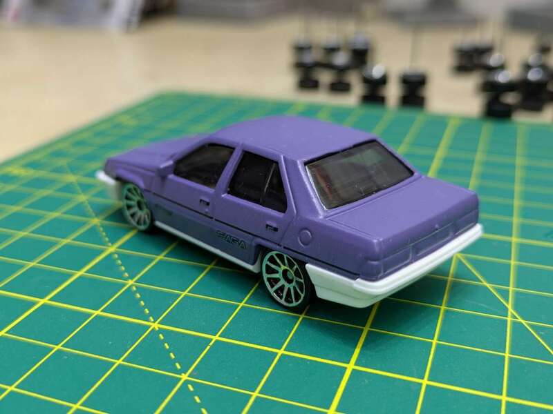

Bought a spare white Proton to try the dying method on. Quite a matt finish on this one which may help
I also heated the dye up this time as that's what the destructions advise for clothes. This is after about 10-15 minutes - and is supposed to be dark blue!
I've stuck it back in there to see if it'll go a bit darker

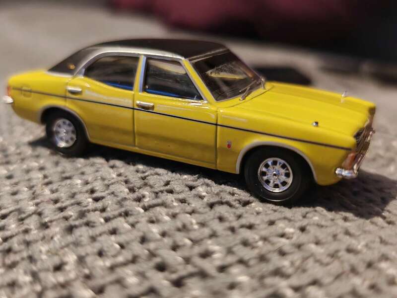

Been waiting for this for a few weeks, but it's here. It started with the conversation on here about the el-cheapo Corgi Motoring Memories Mk3 Cortina GXL. Which reminded me that I too had the yellow one of those, and that lattely, Corgi did a Vanguards GXL in yellow as well.
I admit to being a bit pissed off with Corgi at the time, because it was originally announced as a Daytona yellow 2000 GT. Which is the Mk3 variant I've always wanted them to make, ever since reading about the prototype that was made for a planned Atlas partwork series, that got shitcanned,
In the end though, it ended up being released as yet another GXL, and the GT release ended up being in the fairly uninspiring Marine blue.
But I do like a Daytona yellow Ford, I always wanted one as a kid, and I eventually ended up owning one in the mid '90s.

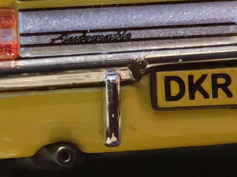

This one hasn't got away too badly, the mirrors are gone obviously, there is a bit of paint rash here and there (which makes it look like an authentic Mk3 from about the mid '80s...) but the main fault was that something seems to have landed on the top of the windscreen which has cracked it at the top and caused some hazing on the screen, and removed some of the silver paint on the top of the surround.
So some silver Sharpie has restored the top of the surround, and I've just added a black sunstrip type effort to the screen to try and hide the damage for now. Amazingly the notoriously fragile Vanguards wipers have at least survived!
Bumpers, grille and plate all intact,
All good at the back, love the little 'Automatic' script on the rear panel,
So yeah, I think it might survive as a model in it's own right, rather than a spares donor, (will just have to keep an eye on the paint rash!).

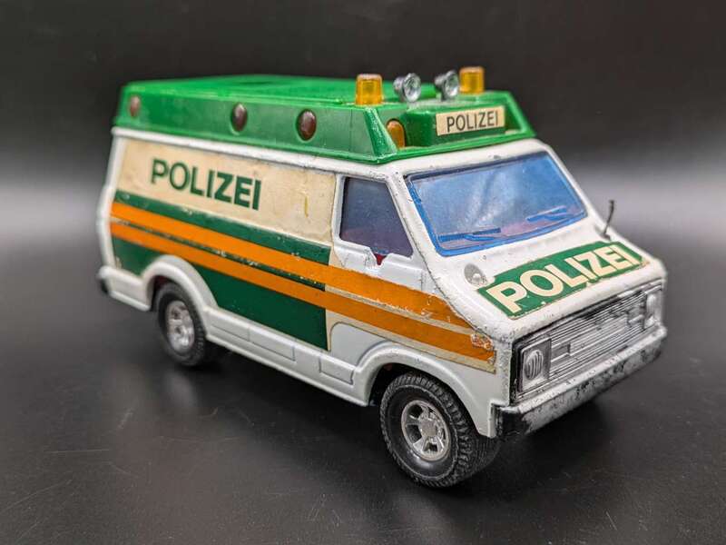

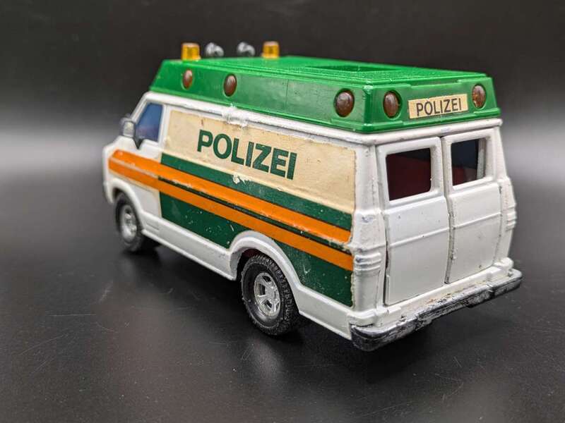

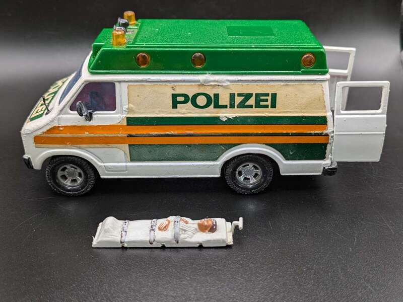

Matchbox Super Kings Dodge Van in Polizei livery
Came with a passenger that I'm pretty sure doesn't belong in there!
Done some miles, going by the tyres

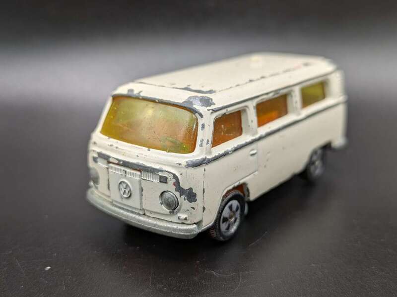

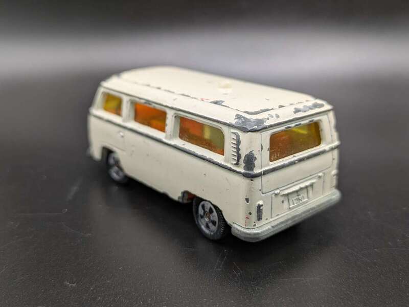

This one's pretty special, Siku VW T2...
Looks fairly normal?
Oh yes, radar control vehicle
Still looks good from the back

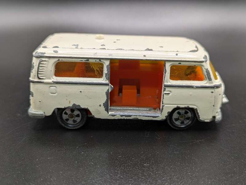

However it's missing the sliding door, and the interior looks like there's something missing
I do have one I could sacrifice I suppose
Siku 1331 VW T2 Kleinbus
