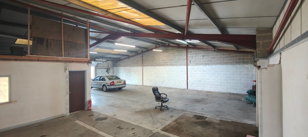

Best of luck with the new venture, very envious of that space!
If possible I'd look to get a 2nd lift in there, perhaps a 4 poster or at least another 2 poster. Each one gains you a parking space, and having a car blocking a ramp whilst waiting for parts gets old quickly!
And put in twice as many lights as you think you need!
I could put in another in the corner occupied by the Demio, it would be nice (the first will be going in the opposite corner near the fire escape). I'll have to see how my remaining budget looks once it's kitted out with one lift. Since I'll be working on classics, I anticipate the works needed will often take longer (ie, welding, bodywork, engine rebuilds) than your typical modern car repairs will, so parts delivery will be less urgent, and the need to get cars in and out a lot won't be there. I'm going to try not to create too much of a backlog of customers as well, as a solo mechanic. I'm playing it a bit by ear though, so you may turn out to be completely right.
I agree on the lighting, although it is already very good. Having the skylights redone will bring in tons of natural light too.

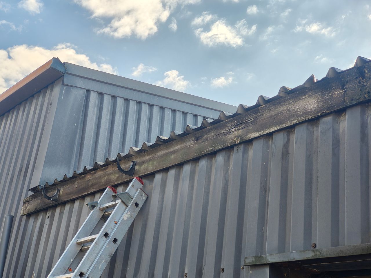

As you can see from the supplies on the table, its first use was in the replacement of my guttering. This is what I started with:
IMG20260909163831.jpg.d14e60f2d909cb1a067463411a32ee51.jpgIMG20260909163907.jpg.6f21ef211e9537df06a9fe34a2cb5f37.jpg
The guttering was attached before I took it down, and then decided to take a picture, but it may as well not have been. The people who put up the previous guttering neglected to consider gravity in the work, insofar as, if you don't slope the guttering towards the drainpipe, the water won't actually run towards it. Funny that. Because of this, large amounts of water was pooling in various sections of the gutter, causing the plastic to sag, and, eventually, the water to run over the side, down the building, and rendering the guttering basically useless. Indeed, when I took the old gutter down, it drenched my arm with a litre of dirty water that hadn't drained. You can also see that the fascia boards supporting the gutter were even more rotten than some of my cars. Fortunately new timber was only about £50 from a local builders merchant. My helpful neighbours also leant me a ladder (I think they were as fed up of the old guttering as I was). I've never done this sort of thing, or indeed any kind of construction, but it didn't turn out to be too difficult to put the new boards up. The new guttering was a little more involved, as you need to mount the brackets for each section, making sure they are a gentle slope to the drainpipe as mentioned previously, then fit the actual gutter. My method turned out to be eyeballing the brackets, fitting the gutter, then tipping some water into the gutter to make sure it flowed away correctly, and when it didn't, repositioning the offending brackets. After a couple of hours, I ended up with this:
IMG20260910140605.jpg.7b2f0e0372ac6af773f805403b4c48a6.jpgIMG20260910140642.jpg.b5f3cdc9c96ea38f564b187133b96fec.jpg
Much better. The eagle-eyed amongst you will have noticed that the guttering in the right picture doesn't go all the way to the end. There is a very good reason for this; I didn't order enough gutter 🙃. Fortunately Screwfix has sections of this particular gutter type in stock, so finishing it will be easy. The door on that side of the building is covered now, at least.
