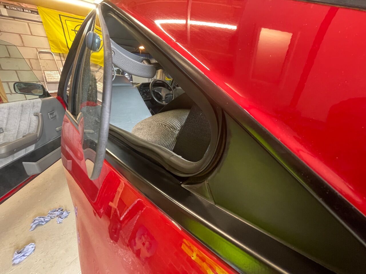

I’ve started the cleaning process.
The rear quarter windows were stuck solid to the seals but eventually came free with some gentle persuasion. glass cleaned and seals cleaned lightly with silicone spray

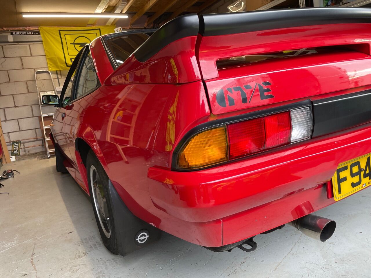

here. Have a quarter shot.
there are a couple of paint blemishes. They look to be stone chips that have been touched up. And a scratch in one door that’s been painted in. otherwise, very good condition

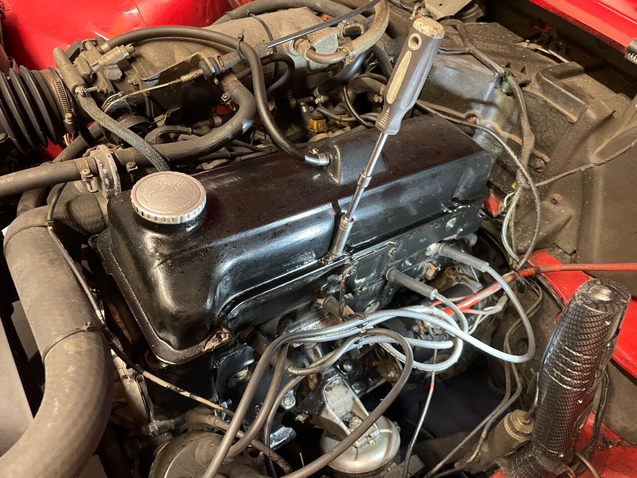

Rocker cover gasket leaking. I had a go at cleaning the side of the engine, but like everything in this day and age, I make a mountain out of a mole hill.
despite this rocker cover being repainted a few times, I still felt bad breaking the paint off

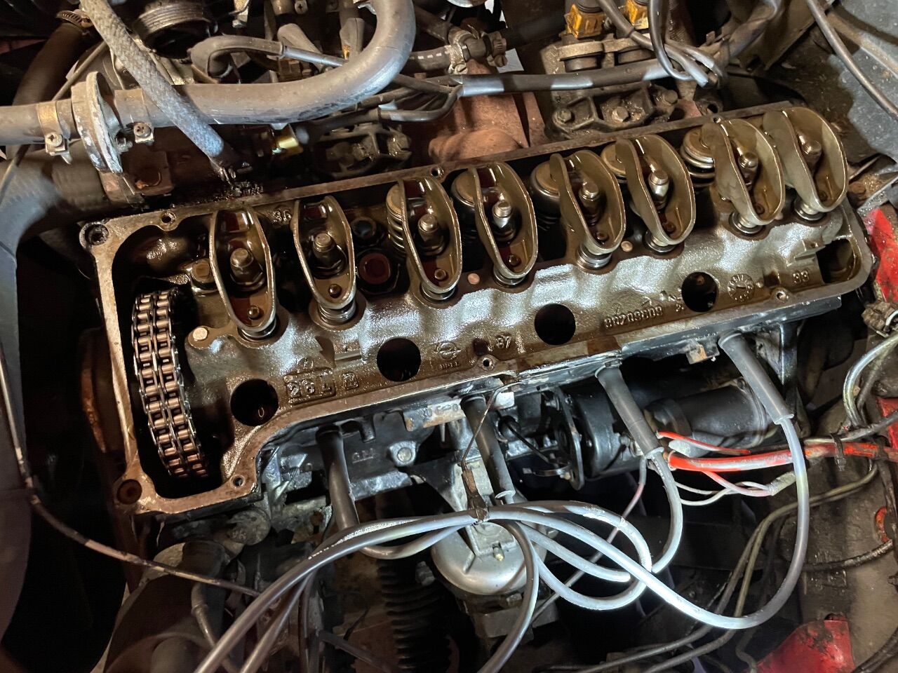

nice and clean inside!
never seen a CIH breather so clean

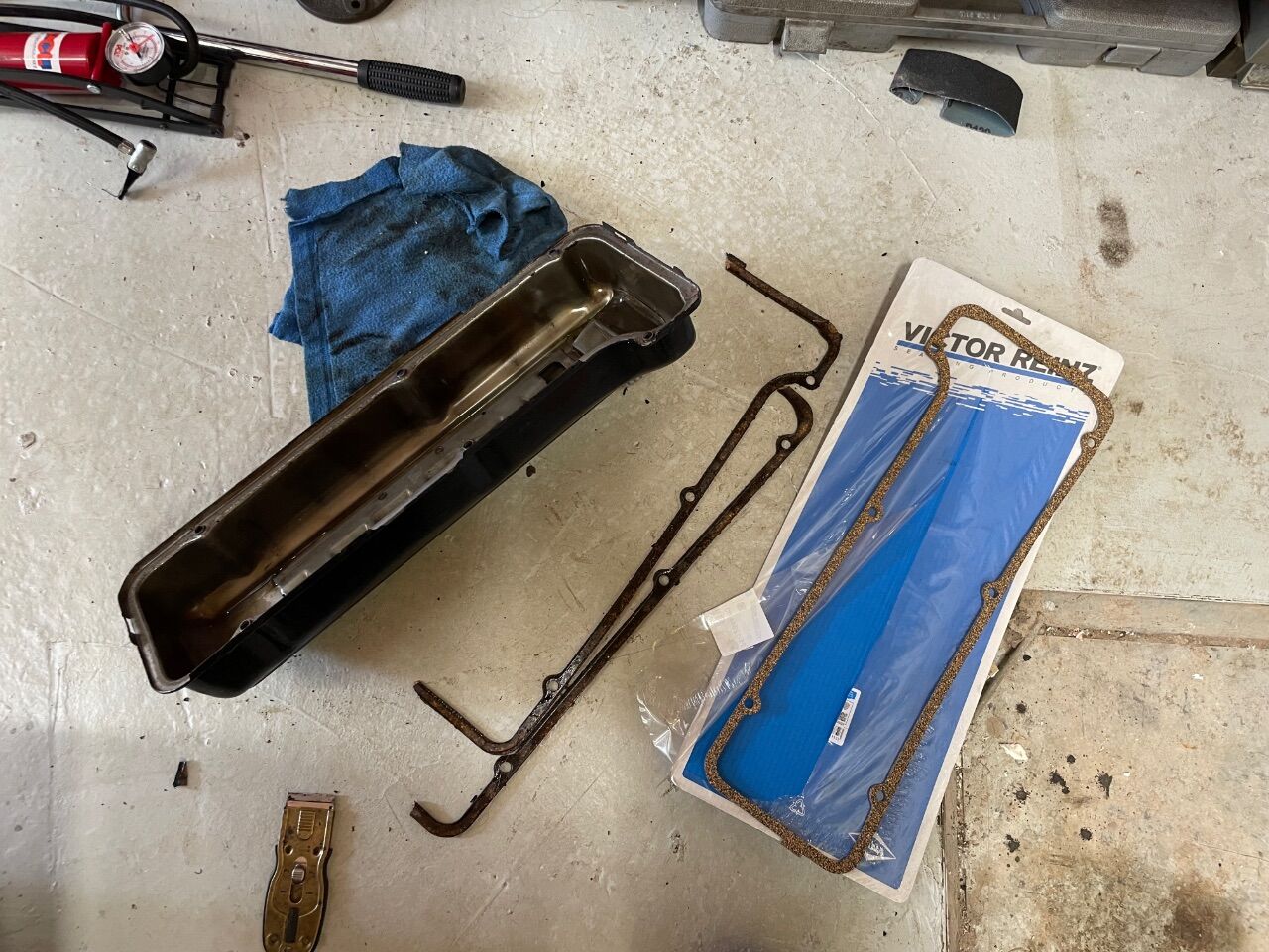

old gasket removed, new installed
once back together, another quick clean. There’s a lot of road dirt stuck to wax and oil, it’s quite hard to clean off!

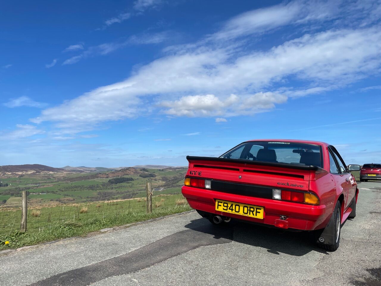

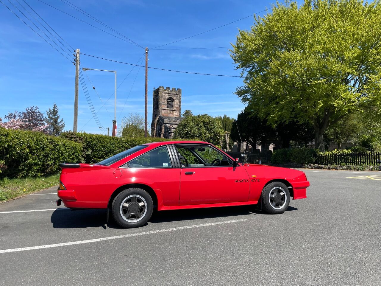

Compulsory new car pictures were achieved today. From this spot at Thorncliffe, you can see the Wrekin, joderal bank, elmsmere port and the Welsh mountains. Such a nice place to be.
jobs going forward.
1. she’s not happy. I think the fuel filter is blocked. Lack of power intermittently after idling in traffic, eventually pops back into life.
2. very slight pull to the left on braking. Possibly needs the front brakes stripping and cleaning or they might just come back around after some use.

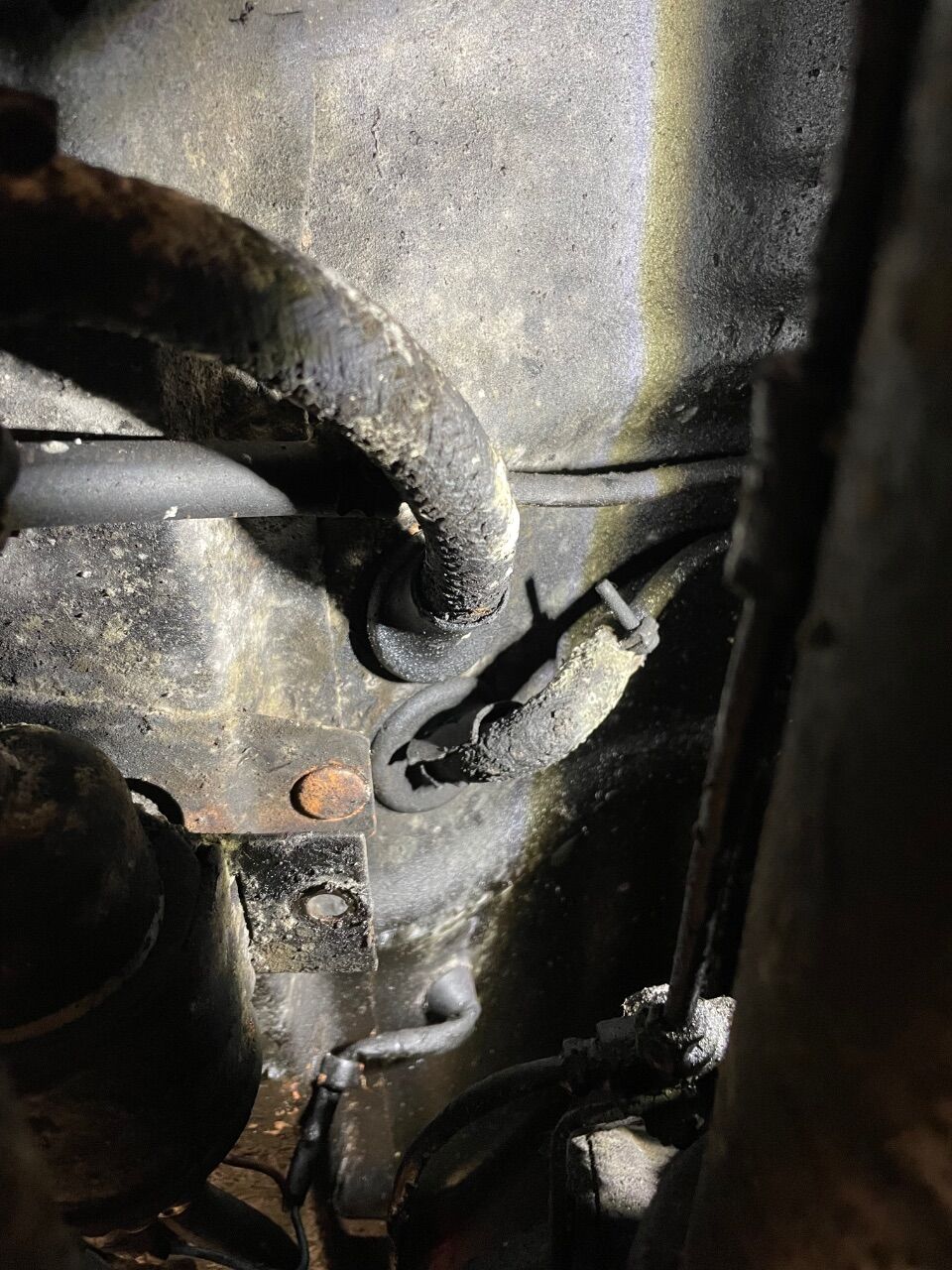

The whole underside of this car is THICK in layers of underseal, road dust, underseal, road dust, underseal, road dust…. I bet it would be 50kg lighter if I got rig of it all.

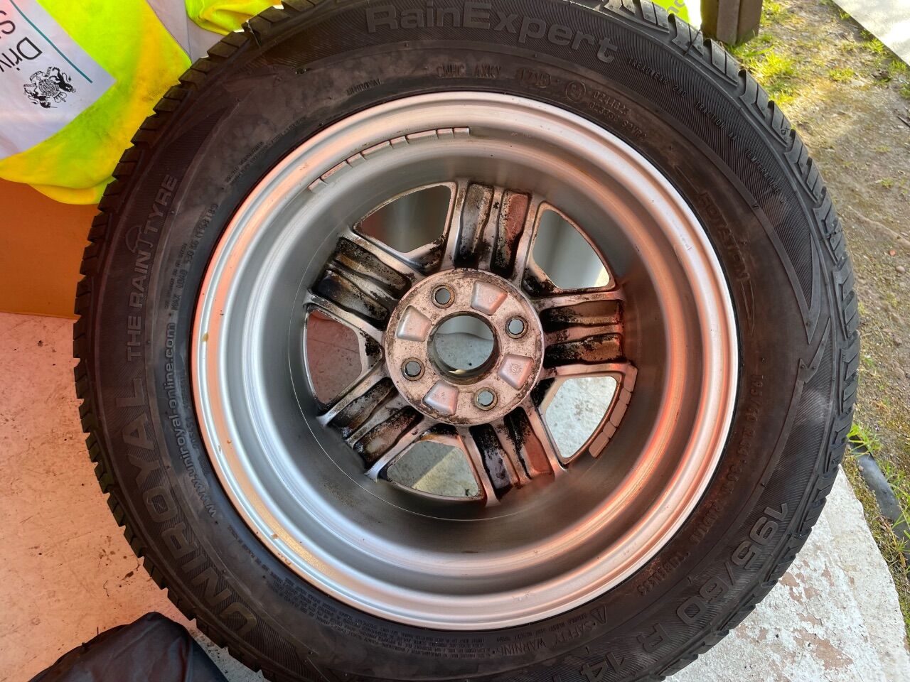

I’ve had an hour spare after work today to start the clean up. I’m not going to remove it all, as it’s doing a pretty good job of keeping the car cancer at bay.

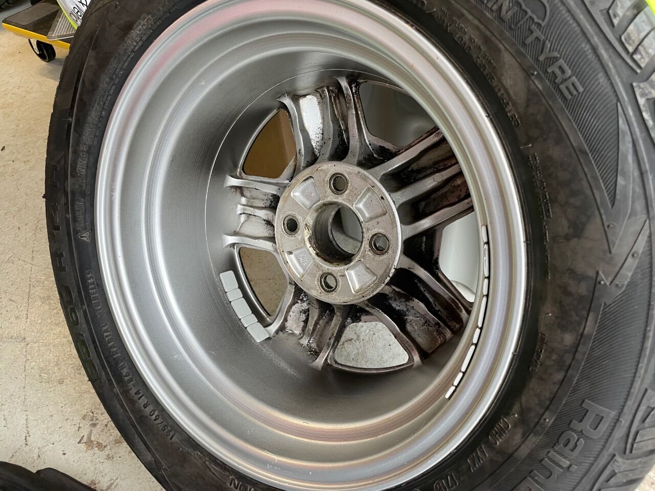

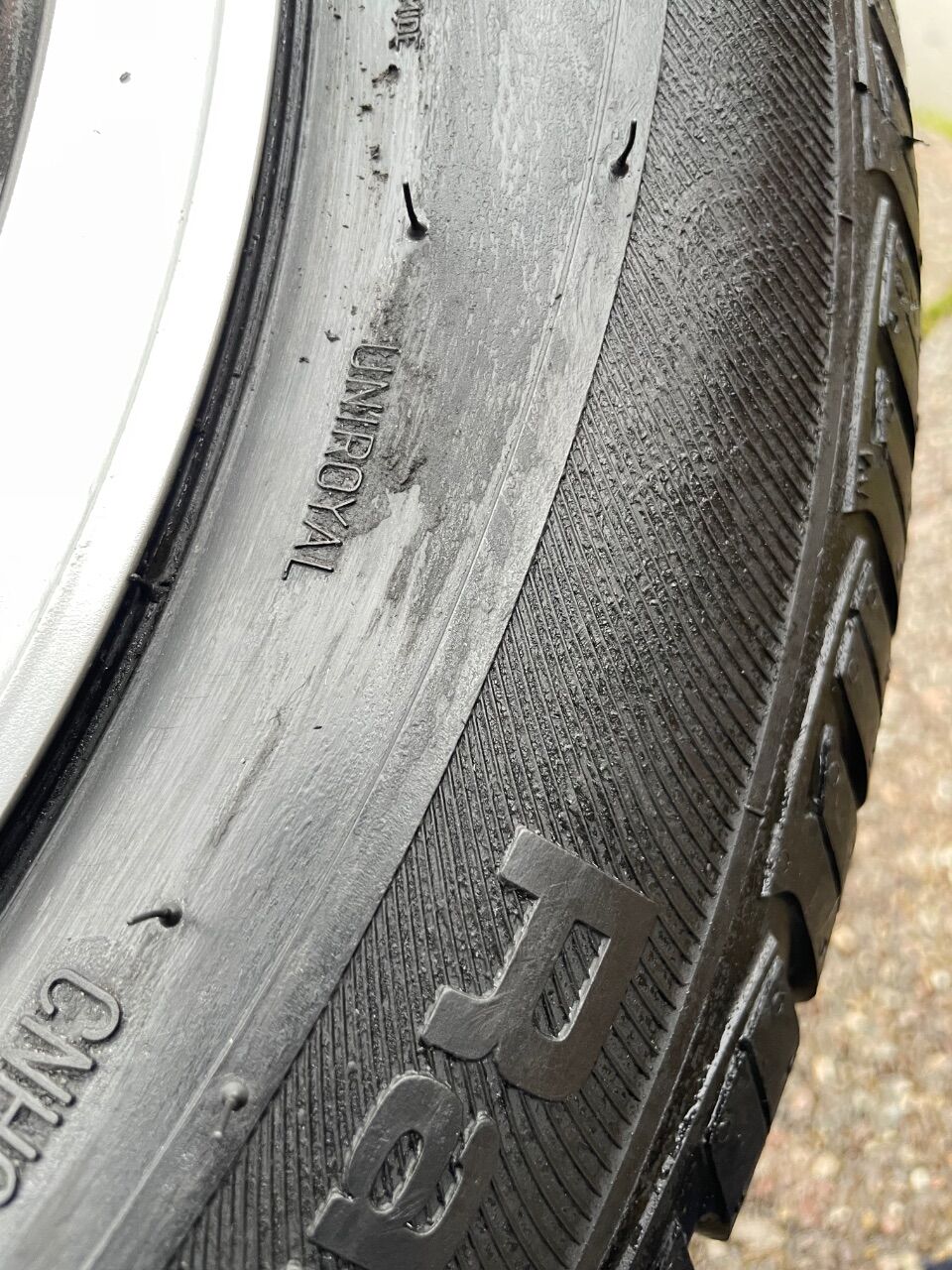

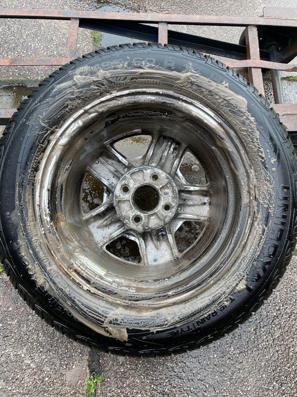

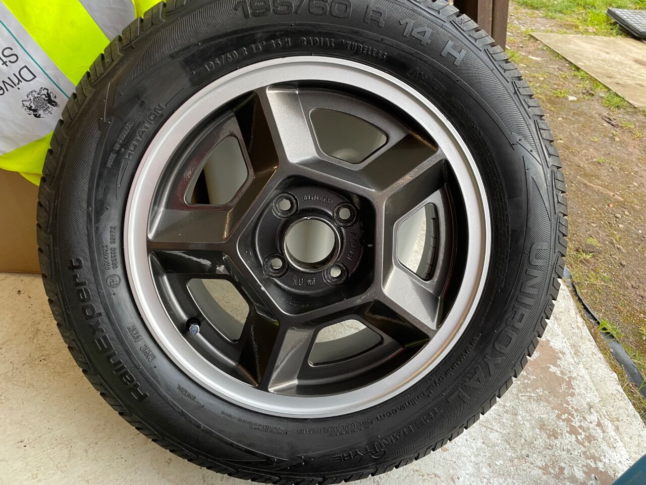

the wheels are THICK with it too. TFR and wheel cleaner along with the jet wash just weren’t cutting it.
the tyres have been coated in some sort of gunk too, not just your normal tyre shine, oh no, this stuff is like tar. And also hasn’t come off with all the cleaning products I have.
Eventually I’ve given in, and got the brake cleaner out which is better at shifting it with the help of some good ole fashioned elbow grease!
and I’ve given the wheel a layer of Murr polish.
apart from a gouge in the alloy where someone’s raunched at the centre cap, it’s in A1 condition.

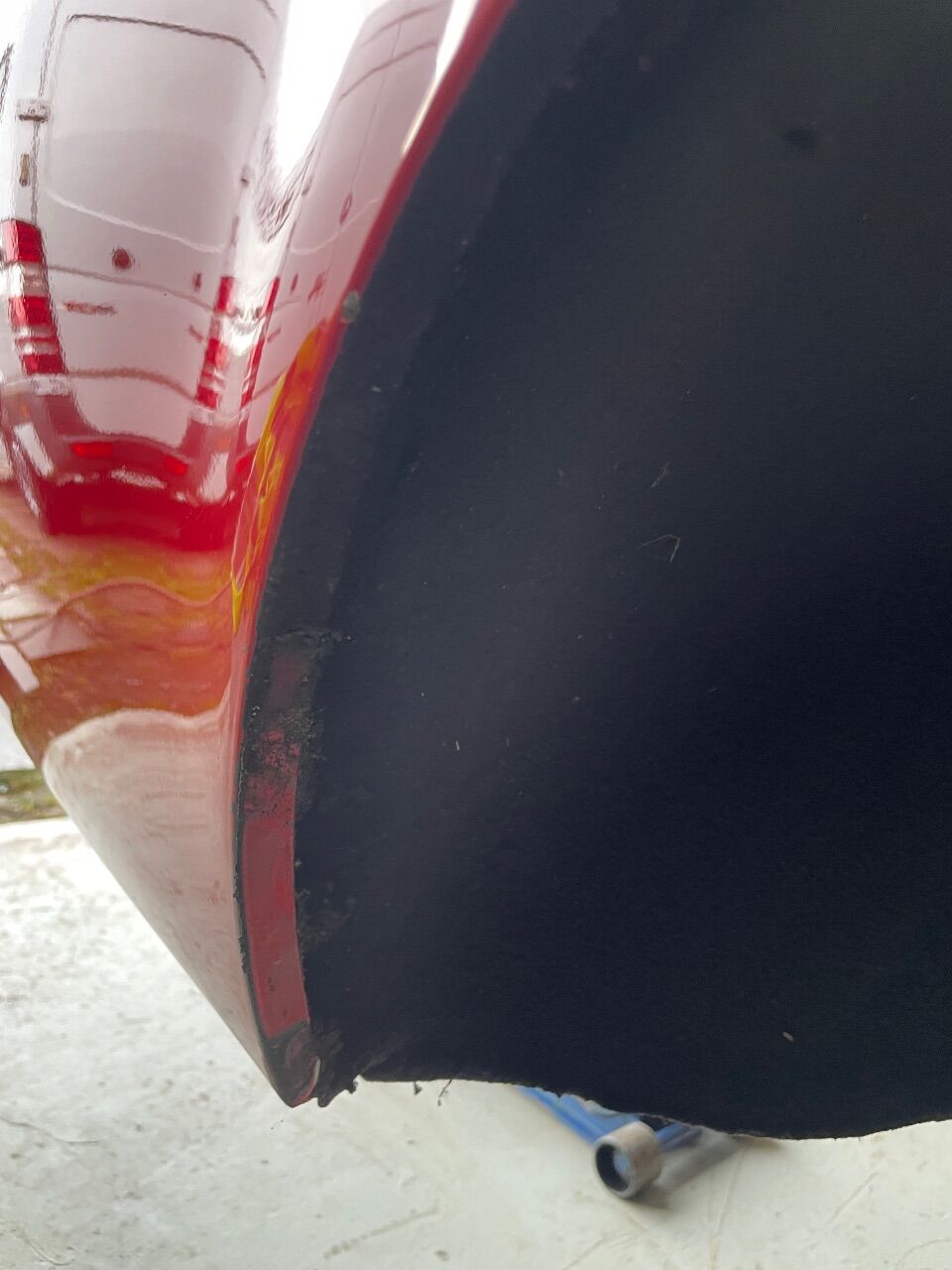

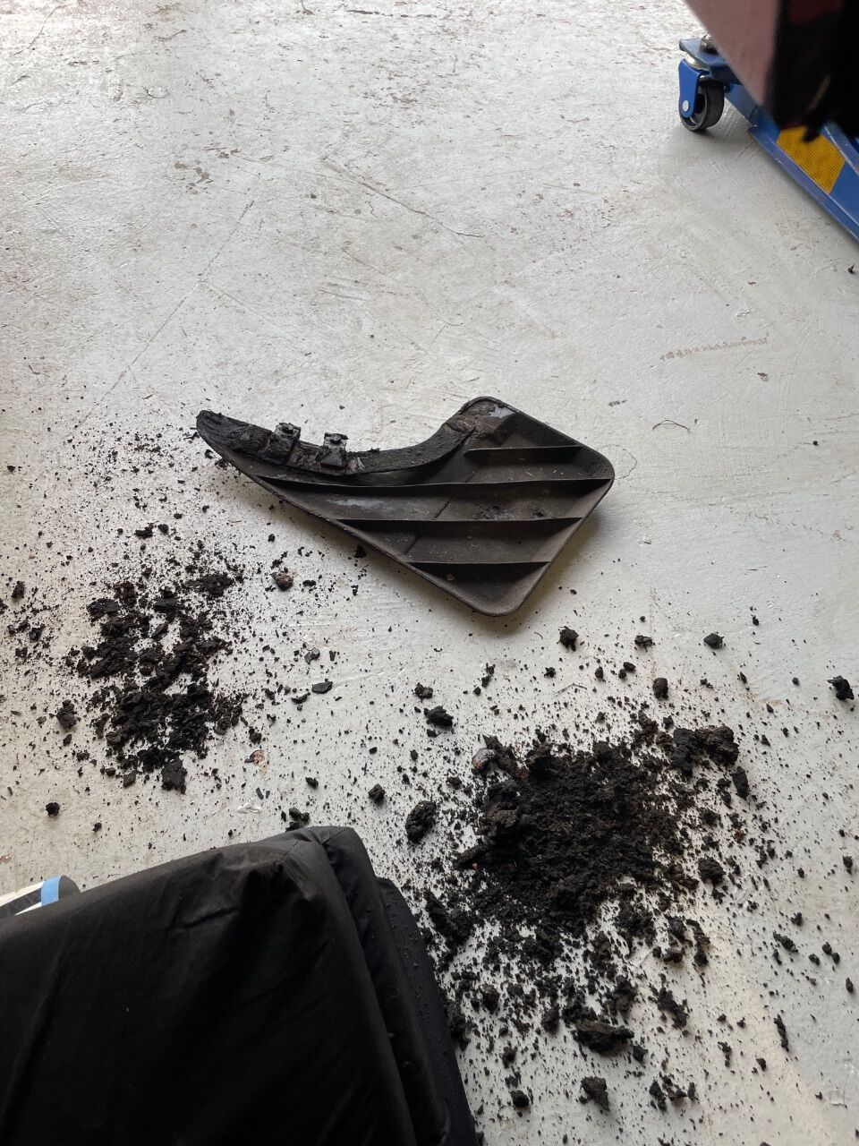

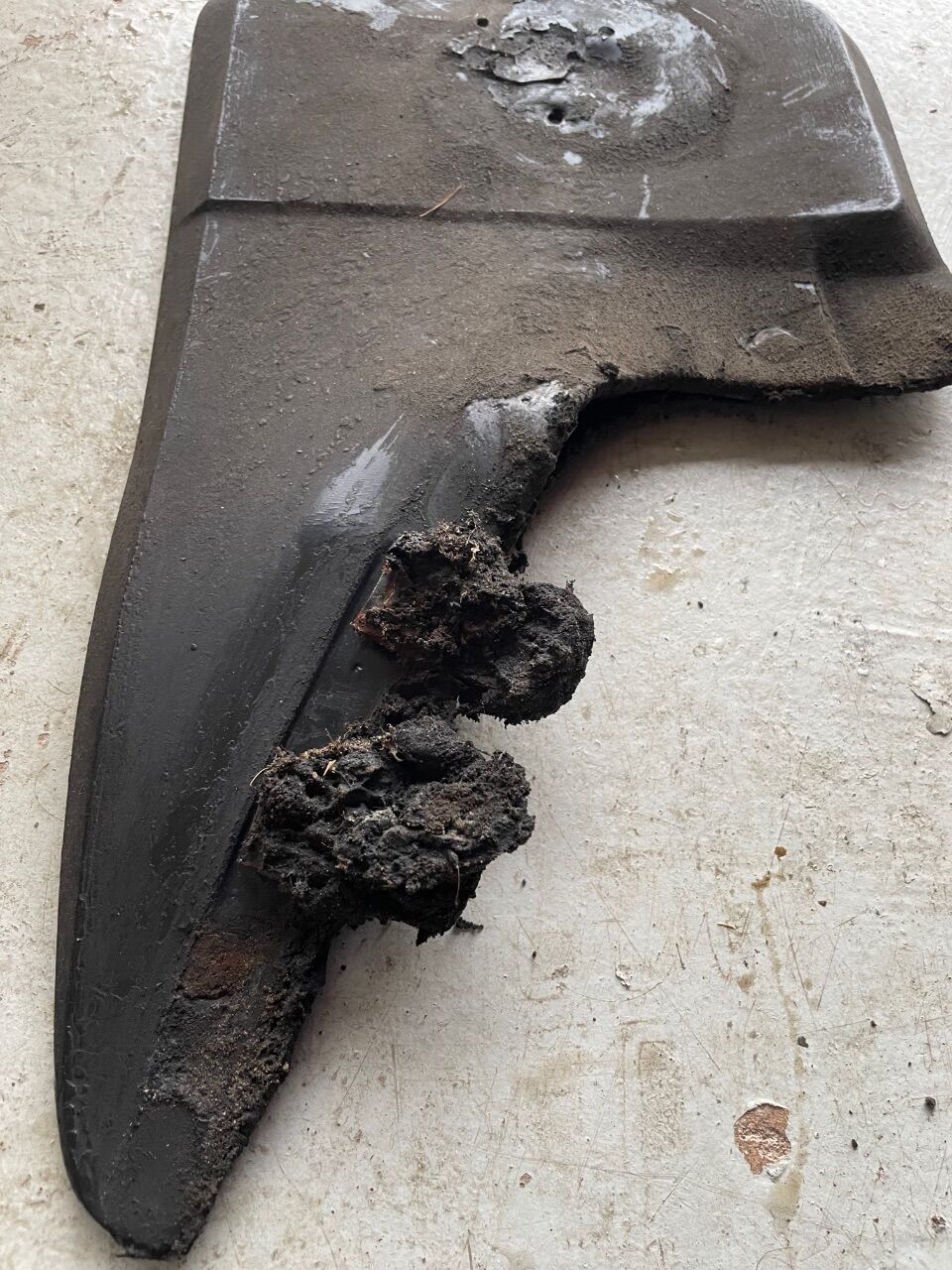

now. The mud flap is next. Bear in mind, I need to do this on each corner.
this is the retaining bolts. Behind them was thick with crud. Good crud, you know, the stuff that just falls off onto the floor.
like this.
that  flap really was a mess
and the gap it’s left.
all the dark bits are “rust stop”. The paint underneath is like new.
Join me next time when I rebuild the mud flap!
I wonder if it may have had wax rust protection first and then applied something like Fluidfilm as that creates a sticky goo that is difficult to get off as the oil/film treatment dissolves the wax and also attracts dirt. I've had a few cars like that and it's a nightmare.
The best thing would be, in my experience, get the car up in the air if possible and to have the underside thoroughly pressure washed. And if necessary, use a rotating high-pressure nozzle or a hot water pressure washer if possible.
I recently washed the undeside of an old Yaris that had been waxed and then Fluidfilm treated. I'm not exaggerating when I say I removed a few kg of mud etc from the underside of it. I used a pressure washer with a rotating nozzle which got it off effectively the only thing is that it can be damaging to paint so I was a bit unlucky and took off some paint on one of the wheel arches.

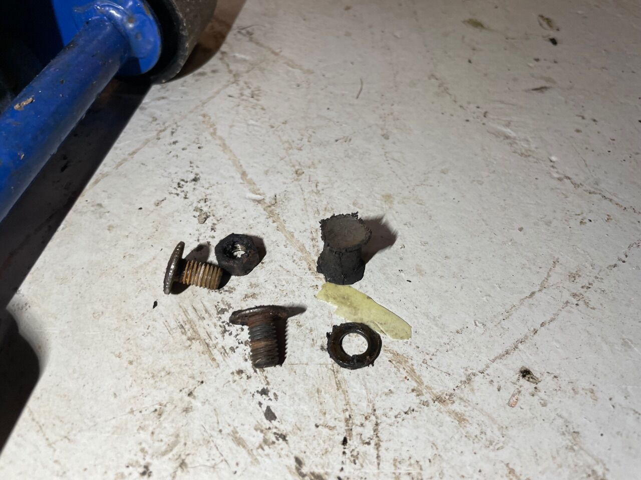

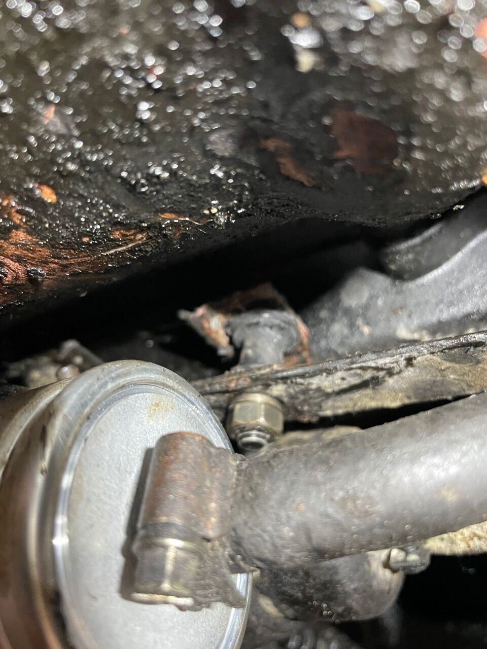

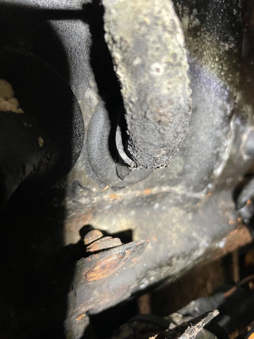

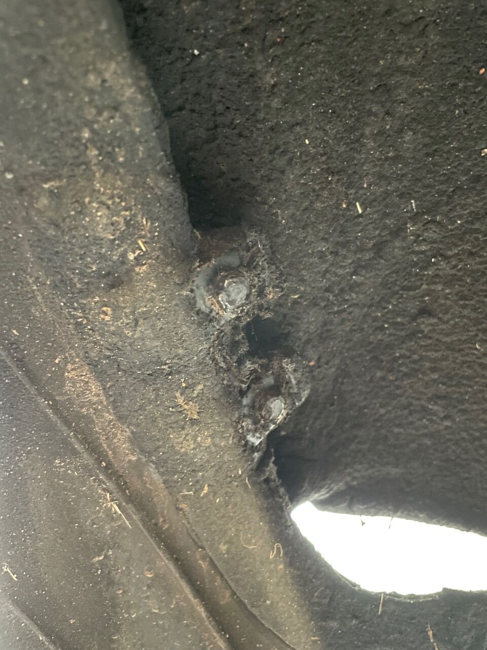

Work continues to secure the fuel pump.
You see that little brown dome looking object? That’s the remains of a little rubber mount that is screwed into a captive nut, that’s welded to the chassis. Fuck.
the only thing I could do was try and attach some small vice grips and undo
much swearing and rolling around in waxoil later….
as much as waxoil saves cars, there’s waaaaaay too much on this one. It’s everywhere. All over my arms, clothes, floor, floor mat, EVERYTHING.
These were the little blighters
the old ones
when I said it was thick, I meant it
sorry for the “down under” picture
There is so much gooey waxoil under there that even trying to clean it off would be a major problem at home.  I'm not sure that commercial car pressure washing or steam cleaning businesses would gladly take it on either.  It's a superb example that you've bought, so I suppose having a black mess as a problem is far more preferable than rampant corrosion everywhere.  If your passport is due for renewal, do it before cleaning the underside (to avoid embarrassing questions on ethnicity when presenting new photos 🫠).

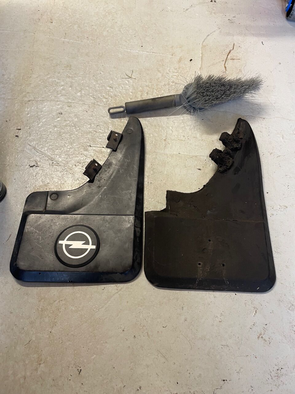

Doing small jobs.
bought a new right hand mudflap off eBay for 4 quid.
the one on the right is original and is covered in gunk. It’s probably ok, but it’s a bit swollen and the badge is missing.

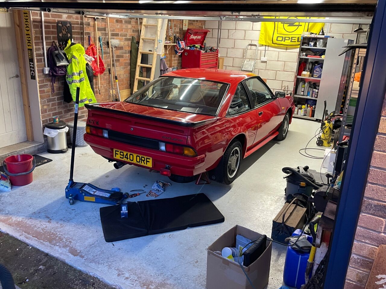

When people ask if it’s for sale, I suppose you could simply refer them to do as the reg says  and F ORF!
Was just going to post similar! When someone asks a dumb question like that, just point lazily to the plate 🤣. Brilliant.
