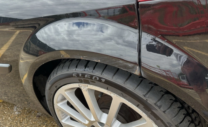

The rear arch has been like this for the last 3 years at least that I know of.
