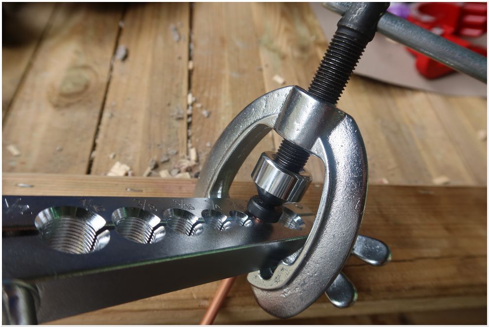

I bought some pipe and a very generic flaring tool for not much money.
Pipe clamped, flare-former inserted...
MASSIVE FORCE applied with the medieval torture device...
...and the pipe end is squidged into this shape.

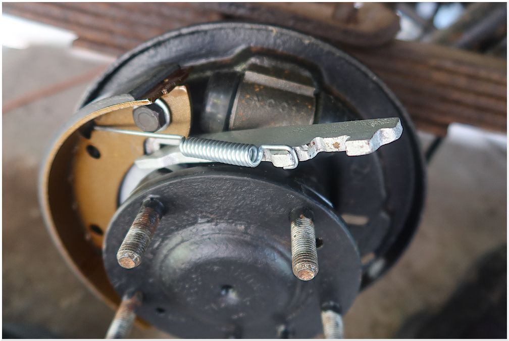

Here's how the self-adjusters are fitted to one of the old brake shoes:
And here's me, fitting shiny new adjusters to my shiny new brake shoes (but using the original pivot pins and washers, because it seems these bits aren't available new).
I was rather concerned to see that the adjuster was directly in line with a weld, so as it pushed against the brake shoe it would be bearing on the weld, not the side of the brake shoe. But the old one was like that too (although, interestingly, the welds on the old shoe are much smaller), so I suppose it's OK.
Now the unfeasibly strong spring goes on...
I had huge difficulty pushing the adjuster spring down far enough to get the washer and circlip onto the pin. The pin itself would simply drop out of the brake shoe as I pushed at the spring. In the photo above you can see I tried to stick the pin in place with gaffa tape. That didn't work, so I made a handy jig...
The shoe could then sit on the wooden block, with the pin braced against it as I pushed the spring into place.
The spring needed some persuasion to stay down. It always tried to spring up again...
But finally the (old) washers and (new) clips went on. That little circlip on the spring is holding down a ridiculously large amount of tension.

When I left off the rear brake overhaul, I'd basically done everything except for putting that one spring in its correct hole on the offside brake, and making sure the adjuster had correctly slotted into place behind the shoe on the nearside brake. So on my next Sherpa wrangling session I took everything apart again...
...and put it all back together, with the right bits in the right 'oles. I even managed to click the brake adjusters into their zero positions, something I was very pleased about after having no joy with this supposedly simple adjustment earlier. The secret, I discovered, is to ignore everything in the Haynes manual and lever the adjusters down, rather than just pushing them in.
The final assembly was much quicker and easier now that I had initiated myself into the mysteries of Sherpa brakes, but all the same I'm very glad the job is now done, and I won't have to take the brakes apart for another 40 years. Of course, now that I've said that, I'll be taking them apart again next week.
Here's the mystery stud, an odd little component which later Sherpas have on the rear hubs. It seems it's only there to make sure the brake drums go on in a certain way, so the fixing screw holes line up. But you can line up the screw holes quite easily by eye, so I can't fathom why the stud is necessary. There seems to be no reason for it to be so long that it also pokes through the wheel - but it does, and that means the rear wheels need an extra hole to accommodate it, which is something to think about if you're sourcing Sherpa wheels. Not all Sherpa wheels are the same, and not all of them fit the back end. Nobody tells you this stuff when you buy a Sherpa. You have to discover it all by yourself!
Next thing to do is to put my shiny new brake drums on...

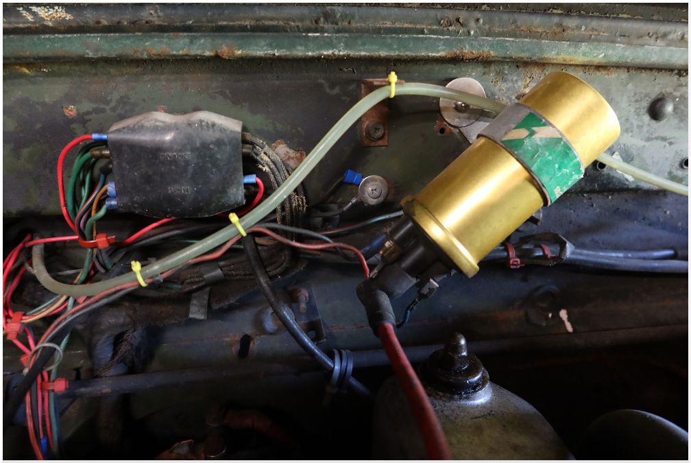

The two items I hadn't looked at were the distributor and the coil. But it occurred to me that if the coil was on its way out, that might explain the uneven idle which seems to be a characteristic of the engine, always present to a certain extent no matter how I adjust the carb. I don't know why that didn't occur to me before, but having belatedly had the idea I thought fitting a new coil would be a good move.
Now things get interesting, because my Sherpa is a one model year variant, only produced during 1985/86, and is different to every other Sherpa made before and after.
Older Sherpas have a standard points distributor and a ballasted coil, which supplies a lower voltage to the distributor during normal running and only delivers the full 12 volts on start-up, to avoid burning the points. To be strictly accurate, there's no actual ballast on the Sherpa set-up: according to the manual a 'resistor wire' was used, which does the same job. This stuff was common on petrol engines for years. Here's a more detailed explanation from Mini guru Keith Calver.
Early Sherpas, with the B Series engine, use the Lucas 45D4 distributor, a very common type which turned up on all sorts of 4 cylinder engines. My Land Rover and Mini both have one. From 1978, when the O Series engine came in, the Sherpa got the Lucas 48D4.
From the 1987 model year (so beginning in late '86) Sherpas had a programmed ignition system controlled by an ECU, triggered by a reluctor ring on the flywheel - all very much standard nowadays, but futuristic stuff in the mid-1980s, especially on a commercial vehicle which in many ways was a very old school design.
The 1987-on O Series engine was substantially reworked with a completely different cylinder head, and became the O2. The distributor on these engines is the Lucas 65DM4, and it uses a no-ballast coil which delivers the full 12 volts all the time.
I hope you're writing all this down in your Book Of Sherpa Facts. There'll be a quiz later.
Sherpas like mine, produced for that one year in the middle, have a 'constant energy' or 'breakerless' (those two terms seem to be used interchangeably) ignition system, featuring an electronic distributor but no other fancy kit.
On the face of it, this should be simple enough. These days it's common to replace points distributors with electronic versions. I did this on my Land Rover, and it was a great improvement, instantly fixing the wandering timing and never-quite-as-good-as-it-should-be engine performance. But trying to find out the exact spec of Freight Rover's factory fitted one-year-only electronic set-up is ridiculously difficult. The Haynes manual (you may not be astonished to learn) is no help, just giving some fairly general info. The specific types of distributor and coil are not identified.
Here's the distributor. Is that a 48D4, or a 65DM4?
The box on the side with two wires coming out is the amplifier, which increases the small pulses generated by the distributor into something hefty enough for the coil to recognise, and MUST NOT BE TAMPERED WITH because it contains Beryllium and is radioactive. I kid you not - it's a nuclear-powered distributor!
The description in the Haynes manual of how the distributor works - "rotation of a toothed wheel in a magnetic field" - doesn't seem to match modern electronic distributors, which have a Hall Effect sensor and definitely no radioactive material, and the only thing which rotates is the standard rotor arm.
If you take the cap off a modern electronic distributor, it all looks much the same as a points distributor. The only difference is the Hall Effect sensor (basically a little box) sitting on the baseplate where the points would otherwise be.
If you take the cap off the 1985-vintage electronic distributor on my Sherpa, you see....
...well, nothing. It's a sealed unit.
Apparently it can be dismantled if you really, really want to, but the Haynes manual, in a startling burst of candour, says "No specific dismantling instructions are available."  Right, then, I won't be touching that thing!
Although the big advantage of an electronic distributor is that there's nothing much to wear out and it's supposedly maintenance-free, I thought I'd better look into the possibility of getting hold of a spare - just in case. After all, I'm sure when Lucas designed their maintenance-free electronic distributors back in the 1980s they never envisaged them staying maintenance-free for 40 years.
The 48D4 distributor seems to be unobtainum these days, which is odd, because every other Lucas distributor (including the 45D4, which is almost identical) is available. If I want a points 48D4, as fitted to the early O Series engine, it seems I'll have to buy a NOS example, at a price of...
...HOW MUCH?
The electronic distributor on my Sherpa has a part number on it - 54403817. A search for this number turned up one second-hand example on eBay.
Apparently the same distributor was fitted to the Metro - who knew? Unfortunately, while the part number is the same, the Metro version won't fit the Sherpa because it's designed to be driven off the A Series camshaft, very different to the O Series.
It's just as well I don't actually need a new distributor, because it looks as if finding one will be difficult. Remind me again how the Sherpa is just one big parts bin special, and rubbish old BL never changed anything in all the years it was in production, and spares are easy-peasy....
Now let's look at the coil. This really is going to be easy-peasy, because any full-fat no-ballast 12v coil will work with electronic ignition, right?
My Land Rover has a Lucas Sport coil, and it's been absolutely fine, working with the electronic version of the Lucas 45D4. Here it is. The wiring is not particularly neat (although it's better than it was when I first bought the Land Rover) but it all works. The black thing is the fuse box, containing two (count 'em, two) fuses:
Now let's look at the way this stuff was done in Freight Rover land.
The Sherpa's coil is tucked away in the bowels of the engine bay, pointing straight down at the road. This strikes me as a less than ideal place, because the connections get splattered with dirt. But as far as I can tell this is the original position, as decided by the boffins at the Freight Rover factory. The coil has a Unipart sticker on it, which reads "USE ONLY WITH BREAKERLESS IGNITION" - presumably because it throws out too much juice for points to handle.
That sticker also suggests the coil is fairly ancient, because Unipart's car components arm went bust in 2014 (it's made a comeback since then). My guess is the coil is older than that: probably fitted in the BT workshops in the 1990s, when the Sherpa was still getting regular maintenance. If so, it's probably about time for a new one.
Weirdly, the coil has a condenser connected to it - the little round thing on the left. A condenser can fulfil the same function as a ballast or a resistor wire. It damps down the voltage thrown out by the coil while the engine is running, thus avoiding burnt points misery. But an electronic distributor has no points, so why is that condenser there?
The other reason for fitting a condenser is to supress interference with the radio, so maybe that's the reason my Sherpa's coil has one: the BT guys didn't want any crackling noises interrupting the lunchtime chart run-down on Wonderful Radio One, The Nation's Number One For Fun.
Here's the coil, disconnected. It turns out that although it carries a Unipart sticker it's actually made by Bosch. I've never seen a coil with a cover over the end before...
I removed the cover (and also managed to shear off one of the connector studs - the nut was seized, and when I tried to get the nut off the whole thing twisted and snapped).
This revealed several mysterious numbers, and that odd circular thing in the recess, which again I've never seen on a coil before. What is it? It's definitely a separate component. The numbers on it are 3.1 and 80 - what's that? Impedance?
The part number is on the cover: 1 220 522 011. A swift search of the internet brought up several second-hand coils of this type offered for sale, at fairly hefty prices. Apparently these coils were fitted to various Volkswagen, Audi, and Volvo models. Nobody mentions Freight Rover.
The fact that these coils are being sold as used parts tells me that you can't get a brand new version any more, but they're a specific type which some ignition set-ups require - other coils won't work. That creates a second-hand demand, which is unusual in itself. Coils are service items: they have a limited lifespan and then they're replaced.
Nobody buys a second-hand coil....unless they have to.
Hmmmm. Are you getting a bad feeling about this? I'm definitely getting a bad feeling about this!
Well, I will try to ignore my bad feeling and connect up a new Lucas Sport coil, after first researching which sort of Lucas Sport coil I need for electronic ignition.
In a complete contrast with the old Bosch coil, modern coils seem to have no identifying marks, part numbers, or specification info on them at all. Aside from the plus and minus signs, coils themselves are blank now. The only identification you get is the sticker, and that's on the bracket, not the coil. I suspect this is because all coils come out of the same factory in China these days, and they're just bought in and branded by various suppliers. But I think I've got the right one here. I think.
I fitted the new coil, and...
Nothing happened. The engine didn't even try to fire up.
I tried the old spark-plug-in-the-king-lead trick, so I could see what (if anything) was happening...
The spark plug emitted one small, weak spark on my first turn of the ignition key. After that, as the engine turned over - nothing.
I checked the wiring, to make sure I'd got everything the right way round (yes, I had).
I tried a different coil. This one is a Viper coil, intended for use with ballasted ignition, so the wrong type for my electronic set-up. Then again, since the right coil didn't work, here goes nothing....
...and, sure enough, I got nothing. One spark on the initial turn of they key, then no sparks. I tried putting the condenser back on. Same result: no result.
The one thing I couldn't do was put the old Bosch coil back, because I had sheared off that connection stud. If I want to try the original type of coil, I'm going to have to buy one of the second-hand ones off the internet. That does seem like a silly thing to do - I mean, it's a coil, they're service items. But if the distributor will only work with a Bosch 1 220 522 011 and nothing else, that's what I'll have to give it, one way or another.
Then again, there's this - the only coil I can find which specifically says it's for a Freight Rover with electronic ignition. Should I buy it? Do I feel lucky?
Maybe I'm looking at the wrong end. Maybe I put the distributor cap on wonky, or something. But then, I would expect to see sparks at the king lead. Nothing is coming through, so it must be a coil problem.
Well, anyway: that's where I've ended up with the Sherpa. It's an immobile garage ornament - again. And it was working until I tried to fix it!

I've got the old Bosch coil in front of me, I've just put a multimeter on it, and the resistance seems to be between 0.9 and 1.4 ohms, depending on which bits of the terminals I put the probes on.
It tends to go back to 0.9 after briefly showing a higher reading. I assume the fluctuation is caused by dirt or rust randomly creating extra resistance. But I think we can say that the Bosch 1 220 522 011 is a low-resistance coil.
This is a fairly terrible photo, but it's not easy holding the probes on the coil and holding the camera at the same time...
The interesting thing is, the coil had a condenser fitted, which on the face of it would not be necessary on an electronic distributor. A condenser would increase resistance, knock the voltage down a bit,  and save the points on a mechanical distributor from burning out - and even then a ballast resistor or a resistance wire would have been the more usual method. But that's not a concern if the distributor has no points. So what was the condenser for? I guessed it was to stop radio interference, but that's only my guess. If my Sherpa ever had a radio fitted it's long gone now.
I'm not at my garage right now, so I can't test the Lucas Sport Coil which I bought to replace the old Bosch coil, but the internet tells me they have a resistance of 3 ohms. That type of coil is also commonly used with electronic distributors - I've had exactly that set-up (electronic distributor + Lucas Sport coil) on my Land Rover for years, and it's been fine. So why isn't that same set-up fine on the Sherpa?
I think the answer is that my Sherpa's 1985-vintage, factory-fitted electronic distributor is not the same as the Hall effect distributors normally used for electronic conversions these days.
As I found out when I took the cap off, the internals are completely different to any distributor I've ever seen. The Sherpa's distributor must have a particular spec which requires a low-resistance coil, so the usual choice of a Lucas Sport coil or anything similar won't work.
As Sherlock Holmes said, when you have eliminated all the impossibilities, that which remains, no matter how improbable, must be the truth!
Well, it seems I need a 1 ohm-ish coil.
Still don't know if, or why, the coil might need a condenser, though....
 <<More internet research>>
Ah. Here's why my Lucas Sport coil doesn't work on the Sherpa....
There are two different types of Lucas Sport Coil: the DLB 105 (3 ohms) and the DLB 110 (around 1.3 ohms). I've got the wrong one on the Sherpa.
On the face of it, that's a schoolboy error, but in my defence there's nothing on the coils themselves to identify which type they are, and anyway the higher resistance version is usually the one that's used with electronic distributors. That's what the internet will tell you, if you ask what sort of coil resistance you'll need for electronic ignition. But usually isn't always.
Well, I suppose that's the way forward: stick a low resistance coil on the Sherpa, and see what happens...

All it took was the correct coil. It was as simple as that, although finding out which coil was the correct coil was more of a performance, since this is one of many matters over which the Haynes manual likes to draw a discreet veil.
After I'd discovered by a process of trial and error (mostly error) that the Sherpa's factory-fitted electronic ignition requires a low resistance coil (the opposite state of affairs to the familiar electronic conversions offered by the likes of Powerspark), I went on the internet and bought yet more stuff, including what is apparently the third from last new old stock electronic distributor of the type used on mid-80s O Series engines.
I didn't actually need a new distributor - the problem was with the coil, not anything else - but I thought it wouldn't hurt to have a spare distributor, especially as it seems there are no more NOS ones available once the last two are sold. If you have a vehicle with one of the later O Series engines with all that new-fangled electronic stuff, I'd say get in there now before it's too late.

And then - the coil. This is the only coil I could find on the internet which was actually advertised as being for Freight Rover electronic ignition. Well, OK, then, I thought, challenge accepted! We shall see if it works. The coil itself is unbranded and came in a plain box, so who made it is a mystery. It does look properly new, not new old stock...
The original coil was fitted with connections pointing down, for easy splattering with road dirt. I decided to fit the new coil with connections up. Condenser not fitted.
And.....the engine fired up first time and ran with impressive smoothness. There was much rejoicing in the Sherpa Shed.
