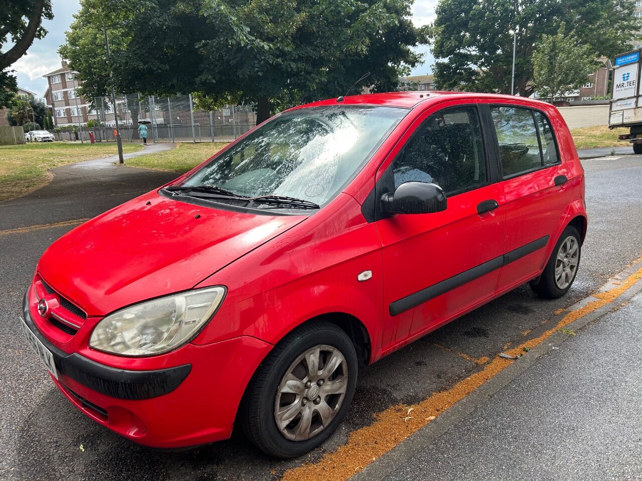

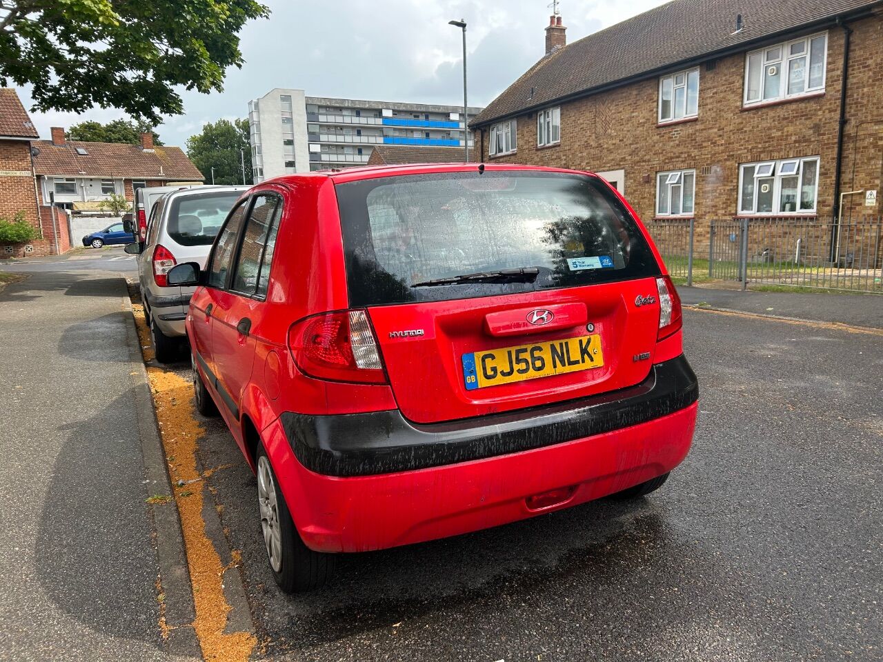

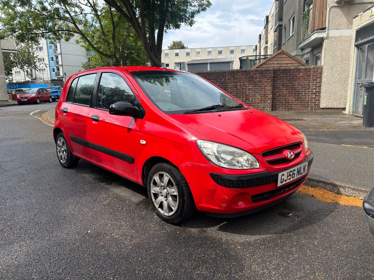

Some of you may have seen I purchased the little red Getz off @EightMegs for a very good price. It got me 50 miles home back to Portsmouth without issue and on £10 worth of petrol. The plan with it is to get the little issues sorted out and let the Mrs learn to drive in it.
Firstly I gave the outside a wash, cleans up nice for a sub £150 car.

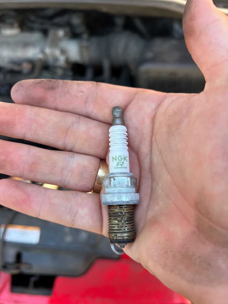

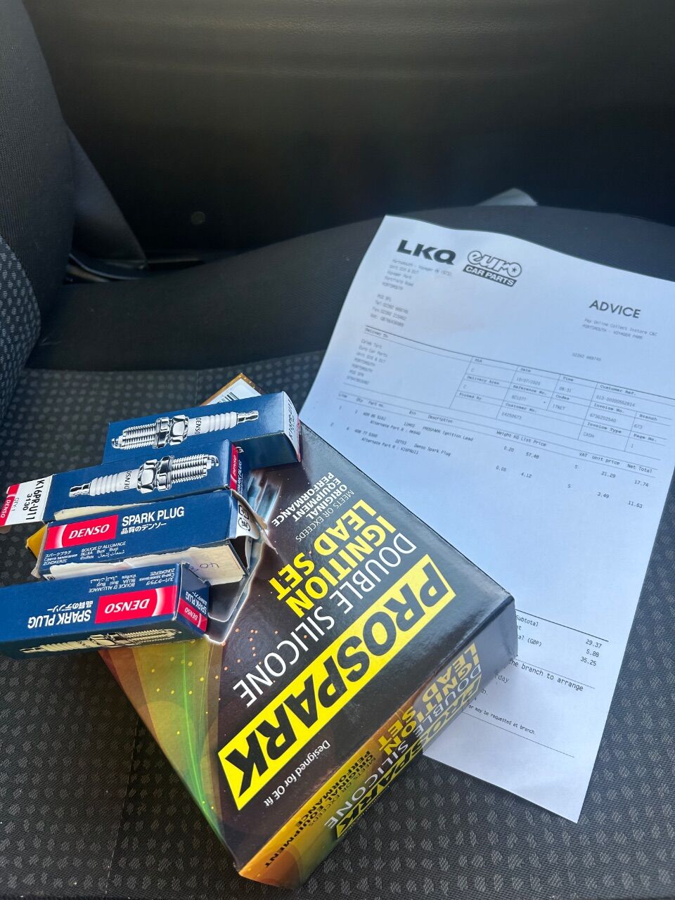

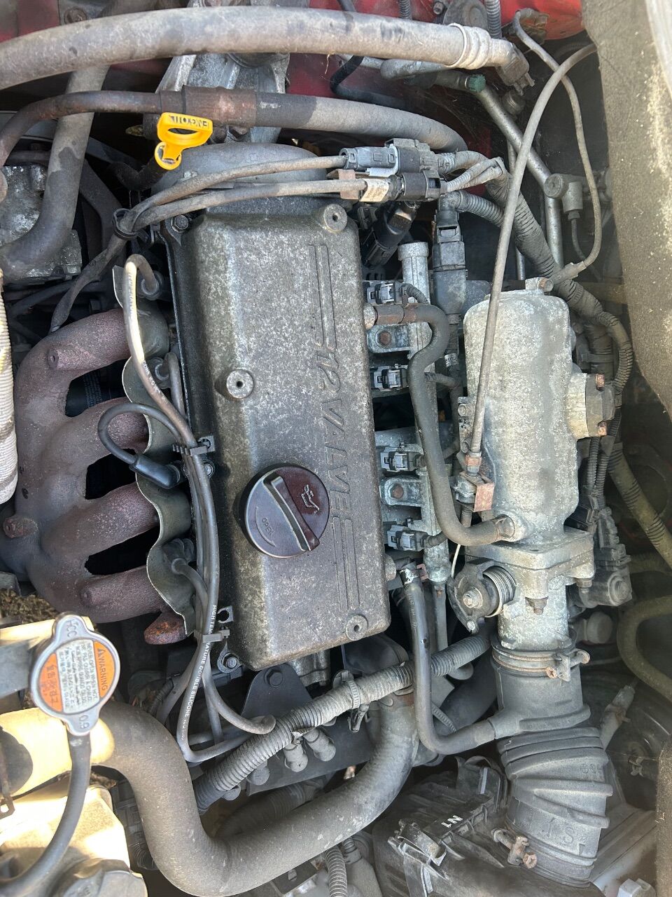

After a trip to work and back, I’m pretty sure it’s got a slight misfire so I’m going to order new set of leads/plugs along with a new air filter and throttle position sensor as there is a slight “lag” when getting on the throttle.
Had a few mins to myself before work so I thought I’d change the plugs and the leads. Now I’ve changed them it runs a whole lot better, still could do with a new throttle position sensor. I’ve never used Denso plugs before so wonder how long they’ll last

New TPS arrived today so that’ll be fitted on Saturday! Rocker cover gasket next

There is a misfire, also the throttle response is non existent, pulling away from junctions it wants to stall out. I’ve replaced every sensor, changed plugs and leads, checked for codes with an OBD2 scanner and it brings up nothing.
