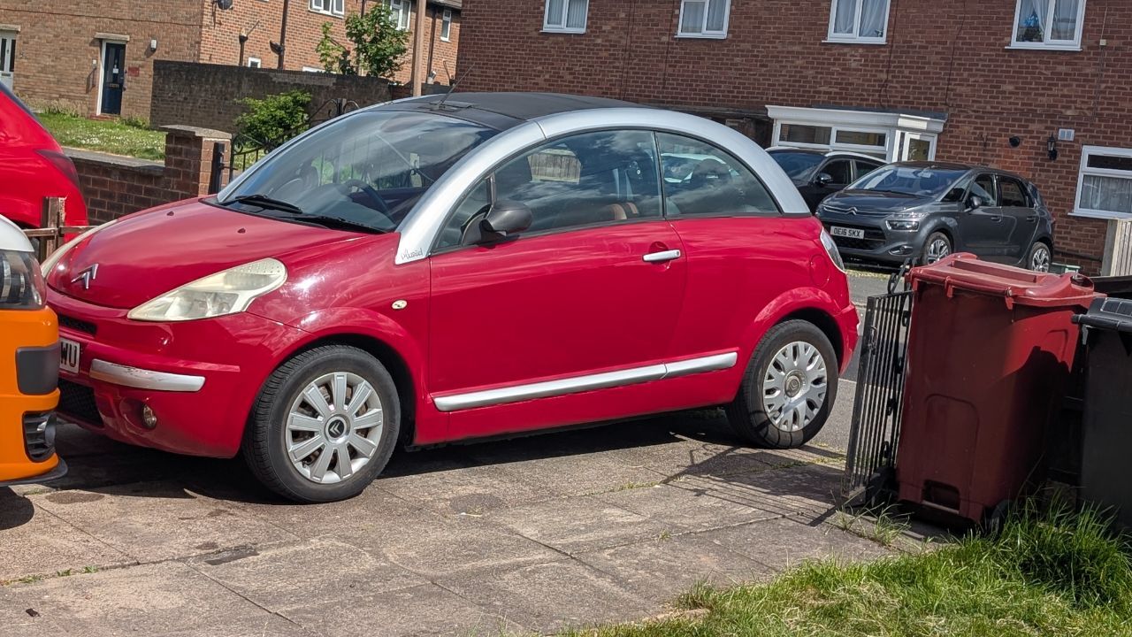

autopaul Posted May 15, 2025 Posted May 15, 2025 Right, I figured I'd do a little write up on the £250 c3 pluriel I purr chased on Wednesday via marshal. Gotta say, Paul at the tower citroen was a gent. Anyway after a 12 hour night shift and a school run, I bundled the copilot into the car and made our was 20 miles to pic of the french soft top, pick up, folding roofed beast. Quickly handed over some pound notes and taxed it ready for the off. Paul had already told me the nsf spring has snapped in half. Mainly boring drive due to the radio not working, and me not wanting to press to many switches incase of breaking something. Along with the snapped spring, the nsf rumbles if cock off. Not checked this yet but I can only assume the wheel bearing. I'll be swapping the strut and knuckle over the weekend if I get time/space. See above photo on the space situation. So far on the to do list Nsf shock, spring, top mount and knuckle/bearing Radio doesn't work Central locking doesn't work Roof opens about a foot before making some rather crunchy coggy noises. Both rear lights lenses have fucked off somewhere. I did find 1 in the car in 2 bits. 3 different style wheel trims Boot struts are rather tired Luckily it has cambelts history, hurrah. Done 25k ago in 2016. So not due for another year. A couple of quick pics after it had a bath So priorities are the nsf issues then the lack of being able to lock the thing, which I suspect may be linked to the radio fault. 500tops, Lanciaman, paulscavalier and 19 others 19 3

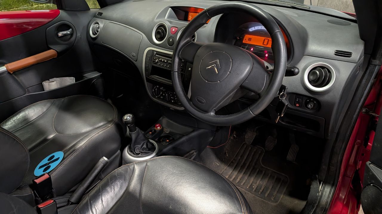

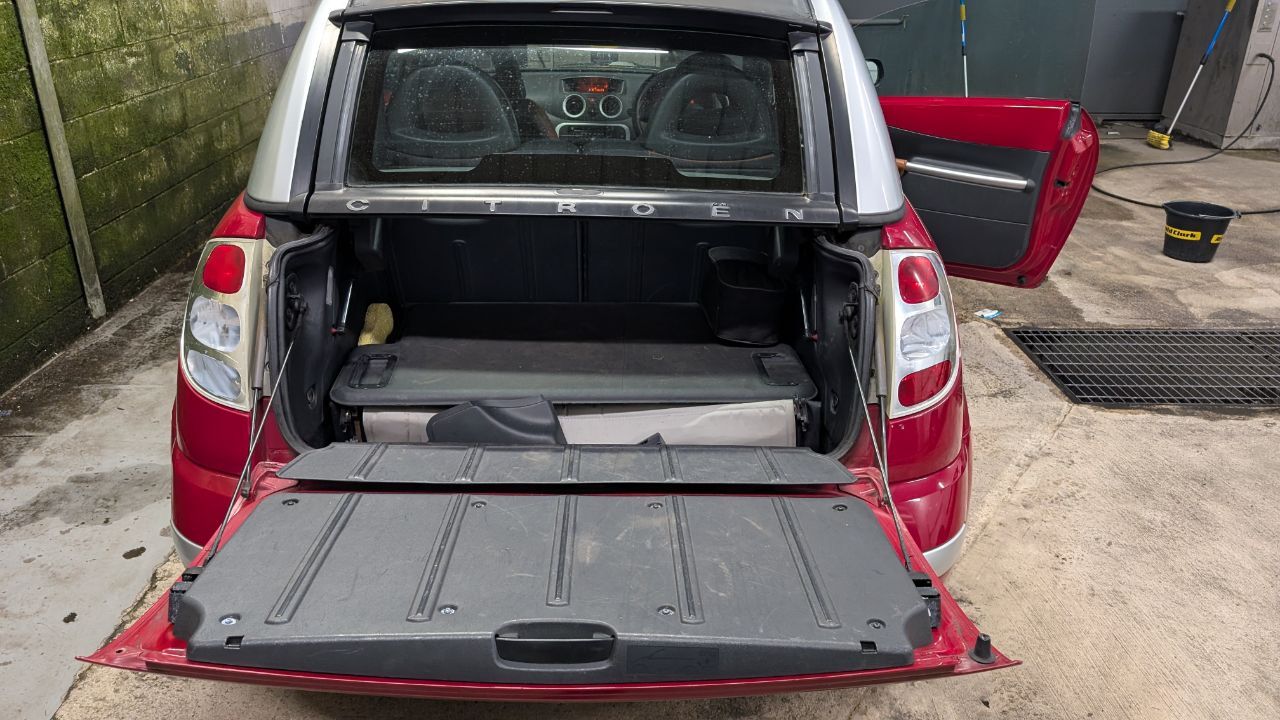

autopaul Posted May 16, 2025 Author Posted May 16, 2025 Central locking fixed, but... Boot now doesn't open Radio still doesn't work Gotta love french cars. But as suspected the radio wiring is the issue for all the above. lesapandre, privatewire and Matty 3

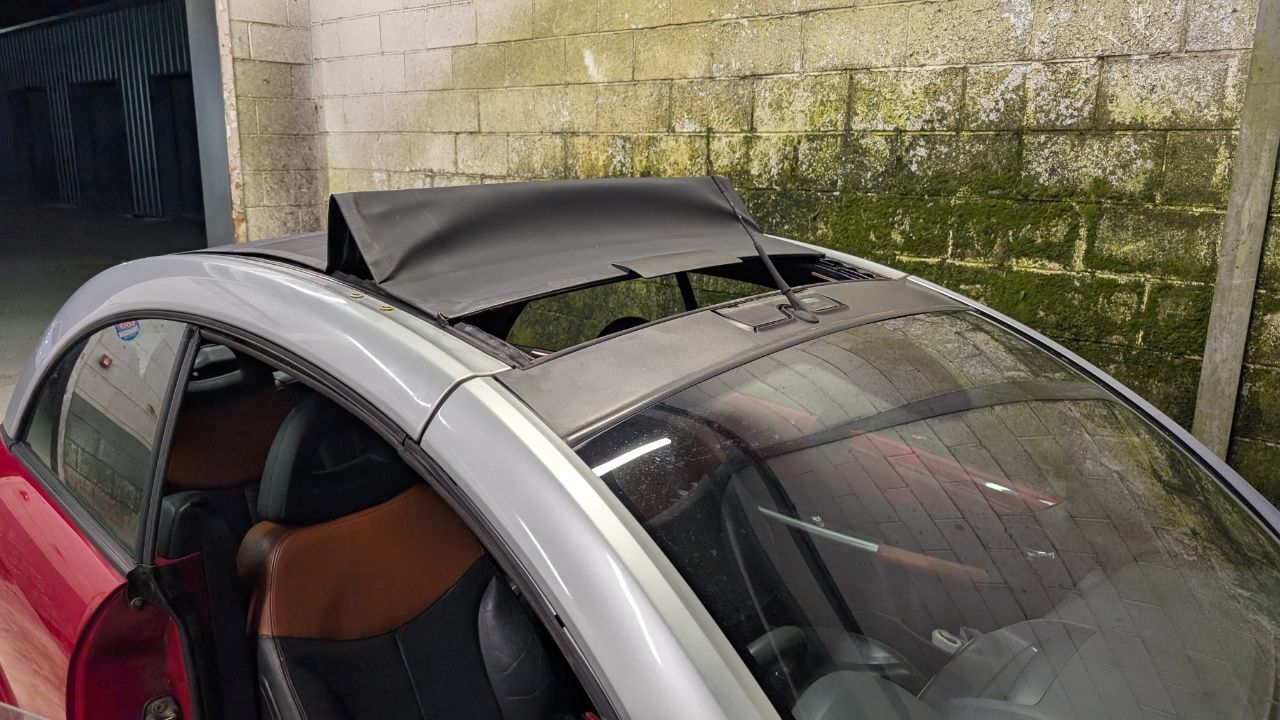

autopaul Posted May 16, 2025 Author Posted May 16, 2025 27 minutes ago, richardmorris said: Yes, that you annoyingly can't store in the car. That's the one. I do want to try and get the roof off it this weekend, to see it in all it's topless beauty. Just worries me that it won't go back on and close 🫣 lesapandre 1

autopaul Posted May 26, 2025 Author Posted May 26, 2025 Drop link swapped, boot latch stopped working, as the roof doesn't know where it is, so I've wanted a relay in there to bypass that for now. It's pissing id down, the roof does leak, as expected, right on to the drivers seat. Gonna Wang it in for a MOT and see where we stand. Hopefully it ain't too bad. The tyres are nearly shot though. Fat_Pirate, mk2_craig, FakeConcern and 1 other 4
