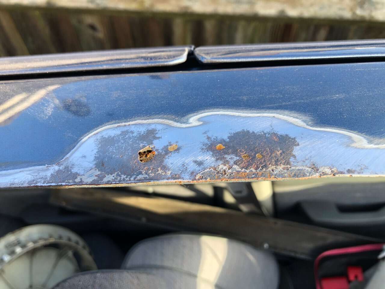

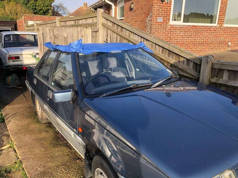

Rust Collector Posted February 27, 2025 Posted February 27, 2025 Remove the headliner, get an assistant to spray the roof with a hose, sit inside the car and observe where water enters. Easier said than done, I know, but this is what I was doing on the proton at the weekend. Once you know where the water gets in, I’d then make my decision from there. I found it was water leaking between the roof skin and the sunroof frame on my car, which is probably the worst case scenario. I’ve taken it all apart, and ground back the roof skin surrounding the aperture to bare metal - annoyingly it will need welding in places. I agree with you that sun roofs are absolute gopping wank. I’ve left my car looking like it’s having a day out at the beach whilst I find some time to repair the roof and then refit the sunroof. I’m wondering if some clear silicone between the outer frame and the roof skin wouldn’t be a bad idea when it’s refitted. danthecapriman, comfortablynumb and eddyramrod 1 1 1
danthecapriman Posted February 27, 2025 Author Posted February 27, 2025 3 minutes ago, Rust Collector said: Remove the headliner, get an assistant to spray the roof with a hose, sit inside the car and observe where water enters. Easier said than done, I know, but this is what I was doing on the proton at the weekend. Once you know where the water gets in, I’d then make my decision from there. I found it was water leaking between the roof skin and the sunroof frame on my car, which is probably the worst case scenario. I’ve taken it all apart, and ground back the roof skin surrounding the aperture to bare metal - annoyingly it will need welding in places. I agree with you that sun roofs are absolute gopping wank. I’ve left my car looking like it’s having a day out at the beach whilst I find some time to repair the roof and then refit the sunroof. I’m wondering if some clear silicone between the outer frame and the roof skin wouldn’t be a bad idea when it’s refitted. Glad I’m not alone! Sunroof’s are absolutely shit. Why any twat thought cutting a hole in the roof of a car was ever a good plan wants their testicles crushed in a vice! See also - convertibles. If you live in the Mohave desert then, maybe. But still no. In the wettest shit hole country on the plane like ours - absolutely no. You cunt. Im wondering actually now you’ve posted that, if there is a little rust hole or something that’s letting water past the frame? I’ll have a look tomorrow if I dare open the sunroof! Asimo 1

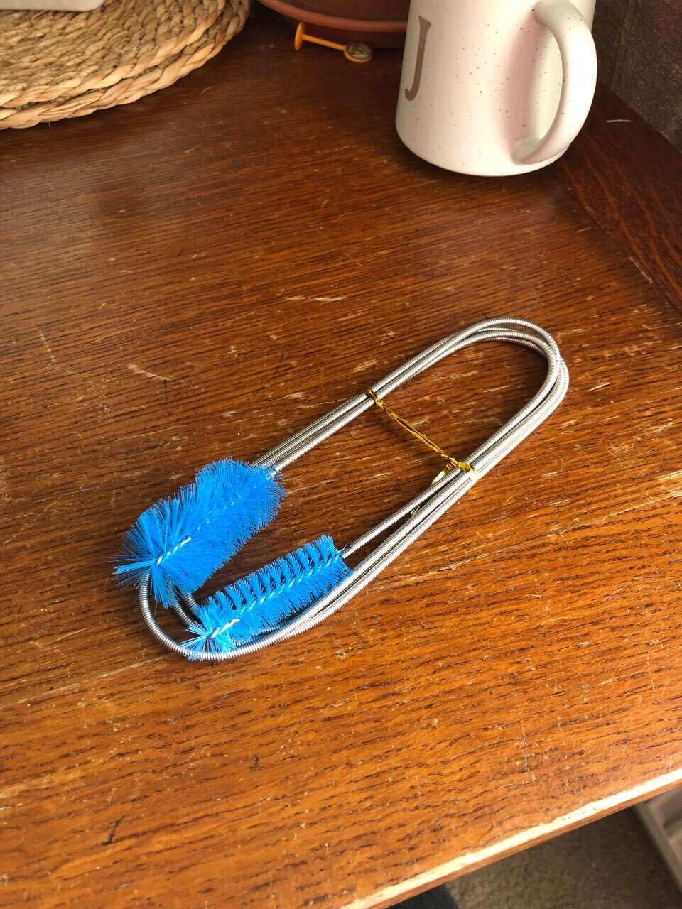

Rust Collector Posted February 27, 2025 Posted February 27, 2025 I cleaned the drain tubes out on our Clio, I used one of these: I think it was advertised as a trombone cleaner or something on eBay. The drains were draining, but slowly. After running that brush through, water drains out nearly as fast as I can pour it into the sunroof tray from a bottle. The Clio still leaks, so the sunroof is coming out of that soon too - I believe it needs some sort of inner foam seal replacing. Did I mention that sunroofs are fucking shit? danthecapriman 1

danthecapriman Posted February 27, 2025 Author Posted February 27, 2025 14 minutes ago, Rust Collector said: I cleaned the drain tubes out on our Clio, I used one of these: I think it was advertised as a trombone cleaner or something on eBay. The drains were draining, but slowly. After running that brush through, water drains out nearly as fast as I can pour it into the sunroof tray from a bottle. The Clio still leaks, so the sunroof is coming out of that soon too - I believe it needs some sort of inner foam seal replacing. Did I mention that sunroofs are fucking shit? That’s similar to what I use for cleaning the drains out. It usually does get some bits of crud out but not anything excessive that’d block it. 25 minutes ago, captain_70s said: Perhaps the drains have re-plugged? If the seal is disintegrating it could be filling the channels with bits of crumbling rubber? I don't see why sealing it with Tiger Seal or something wouldn't work. Although I've been trying to rectify my 740's leaky windscreen using such method to no positive effect! I wonder if some generic profile seal could be found to work for the sunroof panel. I think it is just a U shape... It’s possible I suppose if the seal breaking up has blocked something. I’ll open it tomorrow and have a look. Im sure the 700 seal is like two U shaped sections, one upside down to hook onto the lip on the sunroof lid. It doesn’t look like anything ridiculous so there must be something somewhere that’d fit. I have looked at new sunroof seals for other cars (like Capri ones) but I’m not sure they’d work. There’s got to be something out there though.

Rust Collector Posted February 27, 2025 Posted February 27, 2025 2 hours ago, danthecapriman said: That’s similar to what I use for cleaning the drains out. It usually does get some bits of crud out but not anything excessive that’d block it. Mine were pretty blocked at the ‘one way’ valves at the end - I had to shove it in like I meant it to break through the crap. I was surprised at the amount of shite that fell out. The other suggestion I’ve heard is fire compressed air down them, but I’ve had shit luck with that on windscreen washer pipes so didn’t even attempt it on the sunroof drains. Question to the world in general - has anyone ever used that captain tolleys creeping crack cure (or whatever it’s called 😂) around a sunroof aperture? I hear folks rate it for sealing caravan windows back up, which I feel is a similar sort of problem. danthecapriman 1

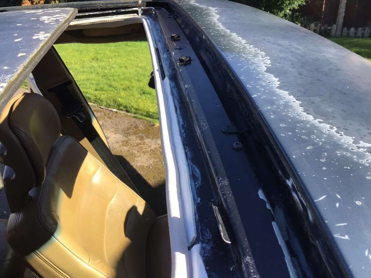

danthecapriman Posted February 28, 2025 Author Posted February 28, 2025 Had a look this morning and opened the sunroof. It looks ok in there really! Theres very little dirt etc in the drain channel and I’ve poured a jug of water directly into the channel and all four drain tubes are working fine. I have absolutely no clue how it’s leaking. The felted seal around the sunroof lid isn’t in great condition, but as said, it’s more to stop wind noise than be completely water tight. Yet somehow it’s managing to fill up and overflow into the car. The headlining is dry on the drivers side but soaking on the passenger side though, so it seems to be getting in that side. Ive found some rubber T shaped seal on eBay which has self adhesive bits under the top section, so I’ll try that first. Hopefully that will essentially form a watertight bridge over the gap between roof and sunroof. Of course you won’t be able to open the sunroof but who cares!
