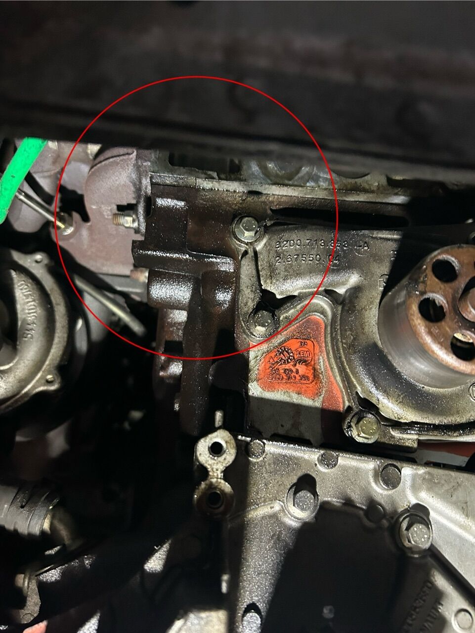

We finally found the mystery oil leak on my k9k powered cumquat….
that is the rear corner of the cylinder head where it has managed to blow oil to atmosphere (not come across that failure before).
This failure manifested as sudden massive oil loss, only while driving, never while idling and apparently this can be a thing with the K9k engines and I can confirm that oil loss is generally sudden, fairly extreme and likes to leak out from the lower corner of the timing cover.
When it starts to leak it is the automotive replica of a hippopotamus taking a dump 😆
Now shopping for a replacement engine as it’s cheaper than dealing with omghgf. Surprisingly very snug in the engine bay and awkward to do major jobs in situ.
