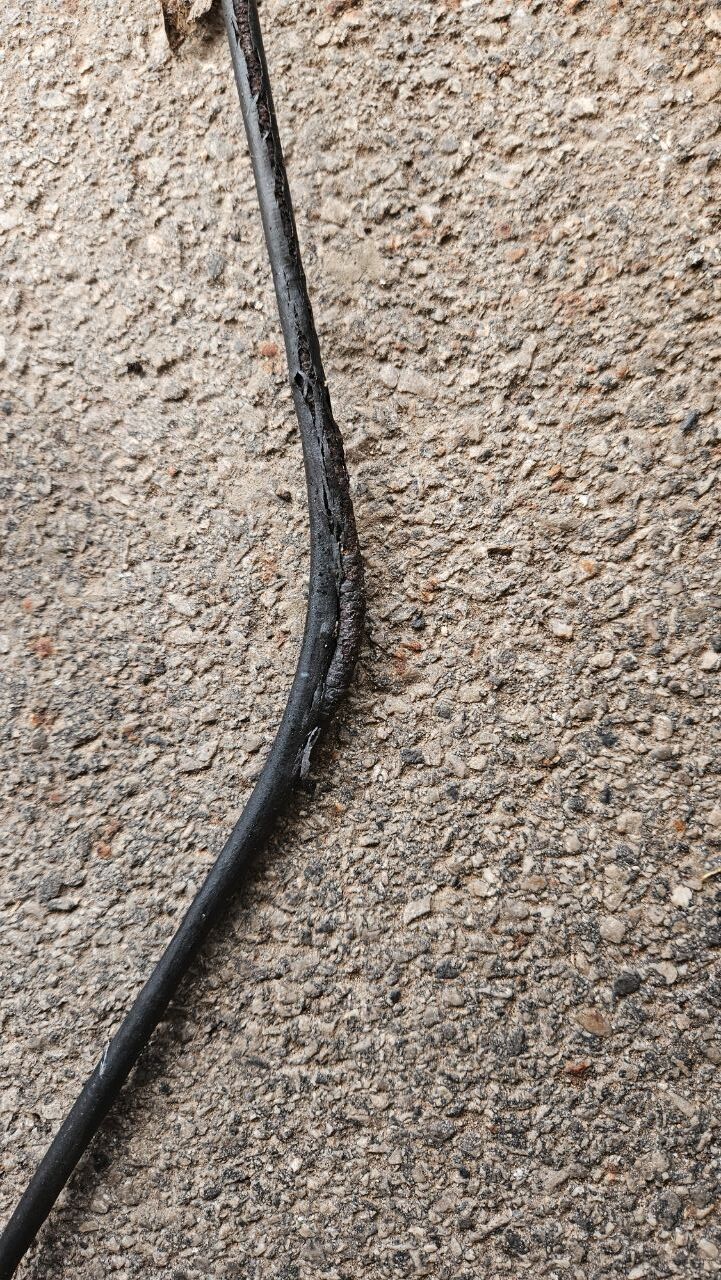

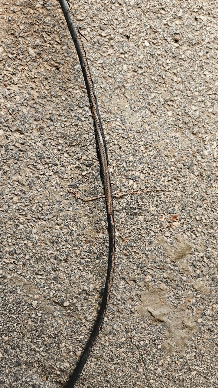

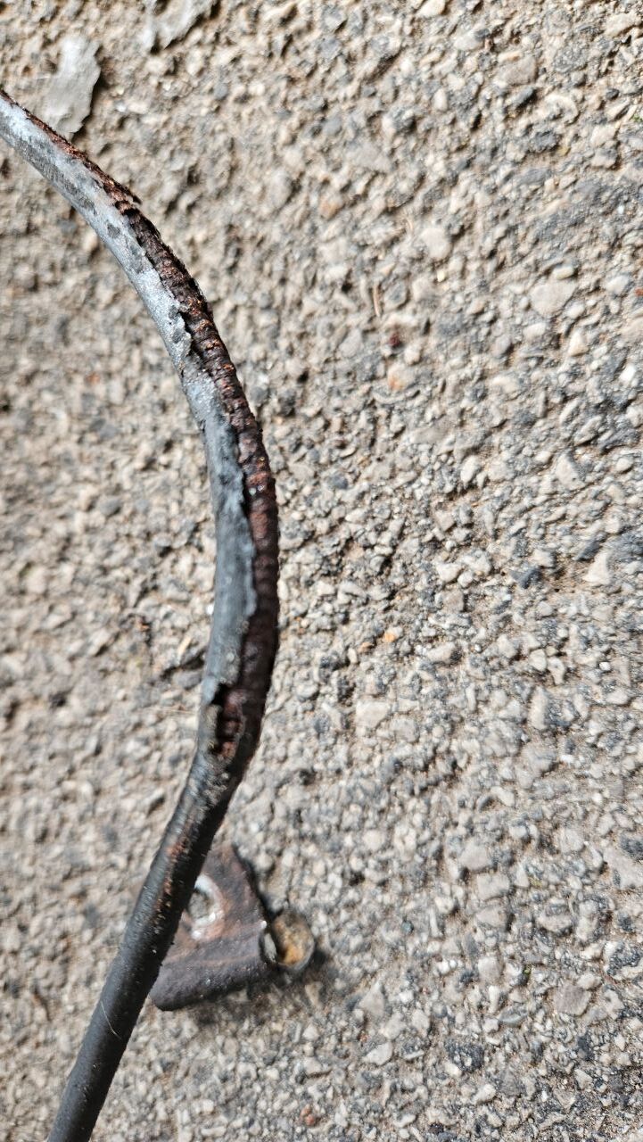

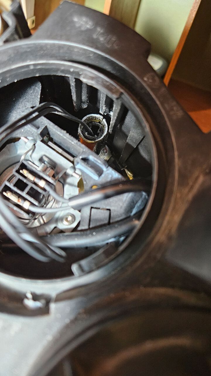

in the meantime, have some photos of the good condition* bonnet release cable I removed, and of the tiny hole I had to get into to cut with a hacksaw to get the sidelight out!
You can just about see the hacksaw marks on that top sidelight holder, it was not fun!

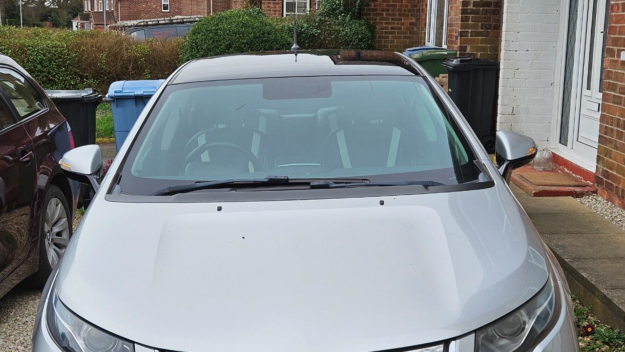

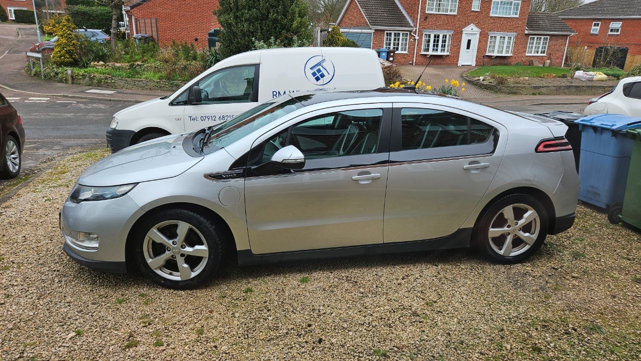

As you may have seen from the collection thread, there is a new car in the Robt100 household...
we now have the ex @Jazoli and @Dan_ZTT Chevrolet Volt.

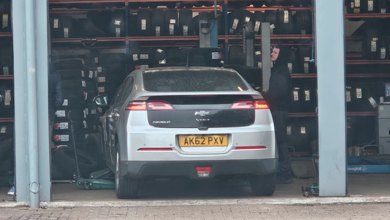

After going to view a few weeks back and agreeing the purchase, Dan took it for an MOT. At this point the car realised it was being sold and threw a hissy fit! MOT failed on unobtanium/expensive mirror indicators, engine light on, and the dreaded "service high voltage charge system" error. But with the car suiting our needs to a tee, we went ahead and it'll be a short project whilst the BMW is still about. So picked it up yesterday and here it is at the tyre place getting 2 new fronts (also MOT faliures) before the 120mile trip home (hooray for range extenders!).
Went to collect the car from the tyre place after going to lunch, and the guy says "ive got good news and bad news", just what you want to hear when picking up a car. "tyres are on ok, but the stud on the O/S hub snapped off trying to remove the locking nut" 🤐 another job for the list! It managed the journey home on 4 bolts ok, so there is that.
And here it is with the 3 other AS bought cars (5 from here so far I think).

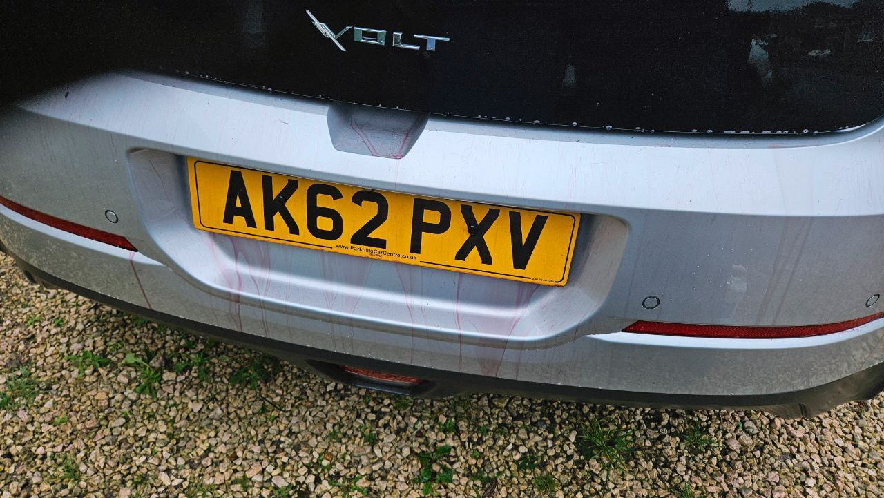

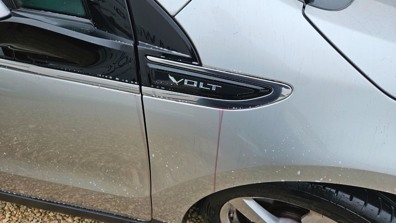

This mornings job, give it a clean. Having been a family car, and sat for a while since being replaced with the new one, the car has grown a little bit of an ecosystem on the outside. So gave it a brief clean up this morning.
Rinse down with the hosepipe, a brush with the WFP window cleaning gear, and then onto iron fallout remover....
20260308_112741.jpg.05f5005f0071c6f146a0d64060f84e86.jpg20260308_112754.jpg.8a45ee1ffd1e2d15840b21c6f1feabea.jpg20260308_112859.jpg.a644e0ba9b782534a688dbc85f49bdf8.jpg
looks like it needed that!
And a quick rinse over and towel dry....
Much better! Still needs a proper decontamination, polish and sealant, but this'll do till it passes the MOT.

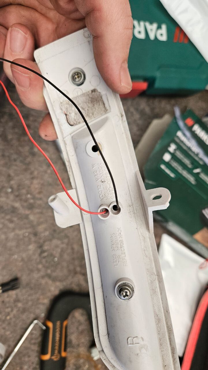

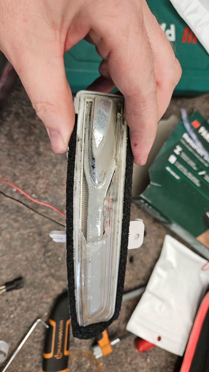

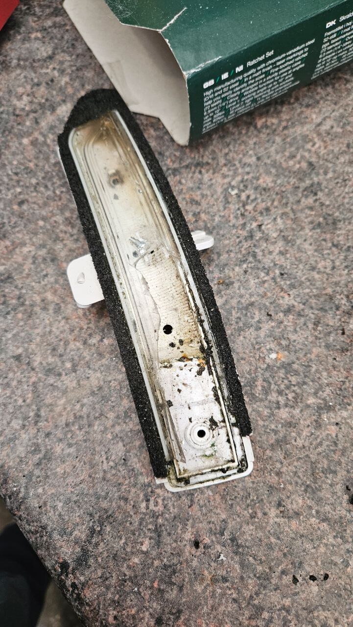

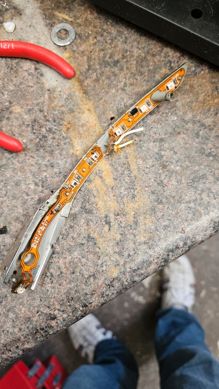

Next up, had a go at getting the indicator bodged/fixed temporarily to pass an MOT. Taking all the wing mirror apart to get to it was simple enough, then the fun started. The indicator unit is a 3-piece part, the backing plate, the centre LED holder, and the clear cover over the top. Good news is the LED plate is held in by 2 screws so can be easily disconnected (apart from having to cut the plug off the end!) from the rest of the unit. The bad news is, its stuck behind the clear cover on the top which has been glued in with the strongest substance known to man so you cant actually remove it 🙄. So, time to get a bit angry with a grinder, screwdriver and pokey stick!
And its free!
Now, why was only one LED working on the indicator (Apart from the copper in the plug being tarnished as anything)
Yep, I reckon that'd be the problem!
New LED strip fitted, though sadly the sticky-backing on the strip doesn't stick, so may need to get it apart and hot glue it at some point. But all back together and the wires posted through the two holes in the back ready for soldering to the plug.
Put it back in the wing mirror and time to give it a test.......
Looks pretty good to me, and my wonderful new sellotape clear cover makes it look better than the still damaged passenger side indicator. Just missing lighting the bottom part of the indicator easily as the LEDs have come away from the backing where they were originally stuck.
