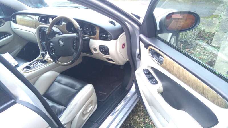

Finally on the right, the ex @DirtyDaily XJR, which is still on the to-do list to get an MOT on almost 12months after I bought it😬 currently stuck on a rounded bolt on the ABS sensor, and a slight exhaust blow which might be manifold based causing a rich running emissions fail. Aim is to get this running in the next 8 weeks so I can use it for a relative's wedding!

Also gave the Jag a quick visual once over to check its all ok, hoping to get it off to get sorted for the MOT imminently. Still love how this thing looks inside:

Well, the XJR has been sent off to @Jikovron to work his magic.
The good news for the trip there, the ABS fault seems to have fixed itself! Well, I say fixed itself, whilst under there last I cleaned up the ABS ring, that seems to have sorted it but might as well change the sensor whilst we are sorting out the rounded bolt. Other good news, it drove nicely and returned 23mpg on a gentle drive.
The not so good news, the engine light is still on with restricted performance. And the car is doing its usual 'pick a fault' trick whilst driving, this time it was the dreaded "Air suspension fault" I blame @eddyramrod for selling his and leaving me with the only XJR on AS to pick up all the faults 😅. Then to top it off the right hand side repeater bulb gave up half way through the journey leaving me with a fast indicator and ANOTHER error warning on the dash...... got a nasty feeling this car may be the end of me. But it is rather nice to drive 😇

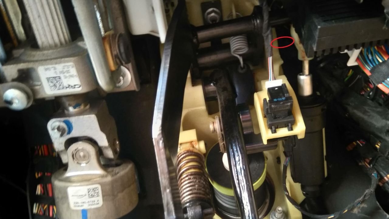

Todays job: The clutch pin!
@bramz7 had mentioned the car was a pig to start as it wouldn't sense that the clutch was depressed. Can confirm, it was a total pain! Initally thought it'd be a faulty hall sensor as that seems a common problem.
The lever also was very loose, could wobble it about 1 inch laterally by the end of the pedal. 😬 At that point it started to suggest the clutch pin had failed, sure enough, once the bottom dash panel was off and I managed to squeeze my hand up to the top of the pedal, the pin was probably only in by about 5-10mm! Managed to manually push it back most of the way, but it never clicked back in place and still wobbled... sorted the poor starting problem though!
That was until the pin worked its way loose again 2 days later 🙈
So, onto trying to fix it...
The only video I had seen and instructions I could find suggested needing to take out the whole pedal assembly, including brake pedal, to be able to remove and refit the pin. I could understand why too, I have circled its location in the image below:
Yup, somewhere up in that void is the pedal pin that I had to keep reaching up to push in! The circle is actually highlighting the brake pin, the clutch pin is a further 3 inches up, but I couldn't get the camera angle on it😅
So, I disconnected the clutch cylinder from the pedal, and the brake from the piston too. At this point the clutch pedal felt very loose, and on the off chance I took a risk and pulled the old pin out to see if it could clear the space available....
Success!! So the whole pedal box didn't need to come out, just the ability to fold your hands in half whilst doing the limbo facing the wrong way in the footwell...
Well, seems obvious what may be the problem with the old one:
When fumbling around trying to put the new one in, the missing 'teeth' fired out the far side of the pedal housing, so must have just snapped due to fatigue. Have added a bit of grease to the new pin (which made it even more fun to try and handle and push into the correct place!) to hopefully slow down any wear. Took it for a test drive and all is good, no more pedal wobble and first time starting!
