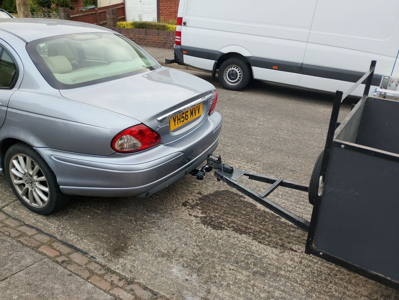

Fitted it with a towbar today so the lad can tow the Combi Camp trailer tent.Bought a complete Tow Trust kit from PF Jones,which had arrived very quickly.Didn't go quite as planned.Found out it had had one fitted in the past as the bumper had been cut and the wiring cut out.Couldn't get the bumper off due to rusted up fixings,but managed to ease it on by bending the plastic out the way.Cost 175 quid which is over a third of the cost of the car.Bet the original one is languishing in the original owners garage in Cleckheaton or somewhere,waiting for him to die and his family to ask what the silly old fool saved it for,before putting it out for the scrap man!IMG_20250518_193432.jpg.f50b58fe6f66615ee935b5896c7dcf44.jpg

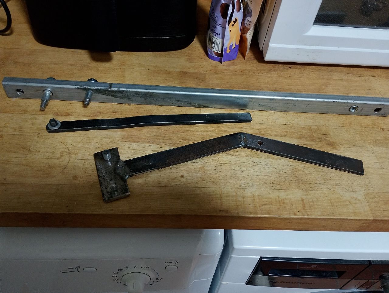

IIMG_20251217_165227.jpg.d834643d464188fe52f6600d31eb26ca.jpgDue to a change in son's circumstances,the poor thing has languished on our front since August.He's working in Berlin for A couple of years.If he comes home for work,Rolls Royce hire a car for him,so he's not needed it,but he'll need it over Christmas.Before he left ,the rear discs and pads plus the fluid were changed along with the oil and filter.New front discs and pads were left in the boot when time ran out.We'd noticed the auxiliary belt was past it's best too.Thought I'd better take a look at it.First job was to get it started.Battery was well flat and difficult to charge.Ended up buying a new Yuasa from GSF.Got the belt off and changed the crank pulley as well.Putting it all back was a challenge and ended up making three special tools.The top one is to lock the pulley while the bolts are tightened.The middle one is to undo the tensioner mounting pivot enough to slip the belt behind.The bottom one to take the tension off the tensioner whilst fitting the belt,which was fecking tight and caused much swearing.Why didn't they put the engine the proper way round?Fitted the pads and discs and a new battery in the key,inflated the tyres and hopefully it's ready to go.Sounds better now.Still well aware it's an old school diesel though.He's coming home on the 21st and will need it to go over to his girlfriend in Shropshire for Christmas.
