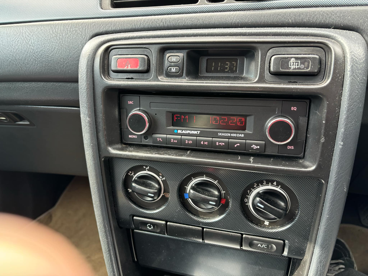

Sadly, looking at all the scratches around the frame and the state of the cage on the old stereo, paired with the fact I could remove it with a flathead screwdriver (you can take the boy out of Birmingham, etc) suggests the old radio had been forced in rather than placed properly. On a genuinely unrelated note I’ve got a centre console from a Civic Aerodeck on the way here so I can have electric rear window switches, so I’ll likely make a hybrid of the best parts of the two and that should clean up nicely thankfully.
@Captain Slow and I have a plan involving steering wheel controls, so while I was on the hunt for electrics, I found out my car is prewired for heated seats:

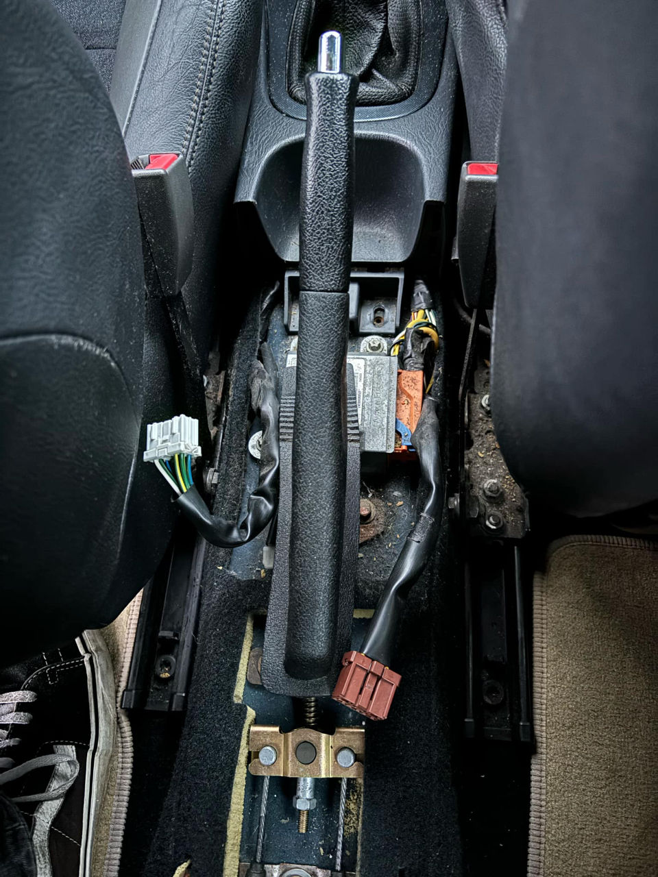

And pre wired for electric rear windows (plug behind the right bolt on the handbrake adjuster):
I’ve decided to just add them as the work required is minimal. Be fun to strip it down and spec it up anyway. I’ll do electric windows first as I’m no upholsterer and I can’t imagine I’d be any good at fitting seat heater pads into my seats. I’ll do everything except that first.

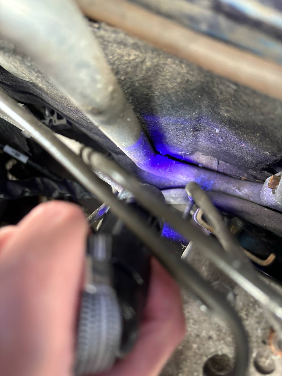

Managed to get the A/C gassed up on the ZS, let me tell you, you don’t realise how much you miss air conditioning until you no longer have it. It never worked on my 318d, so I went over a year without any.

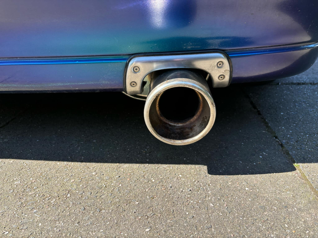

Also since I’ve owned the MG, I thought it made a lovely pop/burble when I lifted off throttle. Turns out it was the exhaust smashing off the bumper and exhaust tunnel, so I had that rehung today. Sadly the backbox is so big it still sticks out slightly… Next up is an actual interesting update people might be interested in when I wire in a full hidden phone system to make it look OEM. But that’s not been finished yet and wiring is still being made. As soon as it’s done I’ll share that one as I’m impressed with it. For now have a photo of a centred exhaust that’s not resting on the bumper…

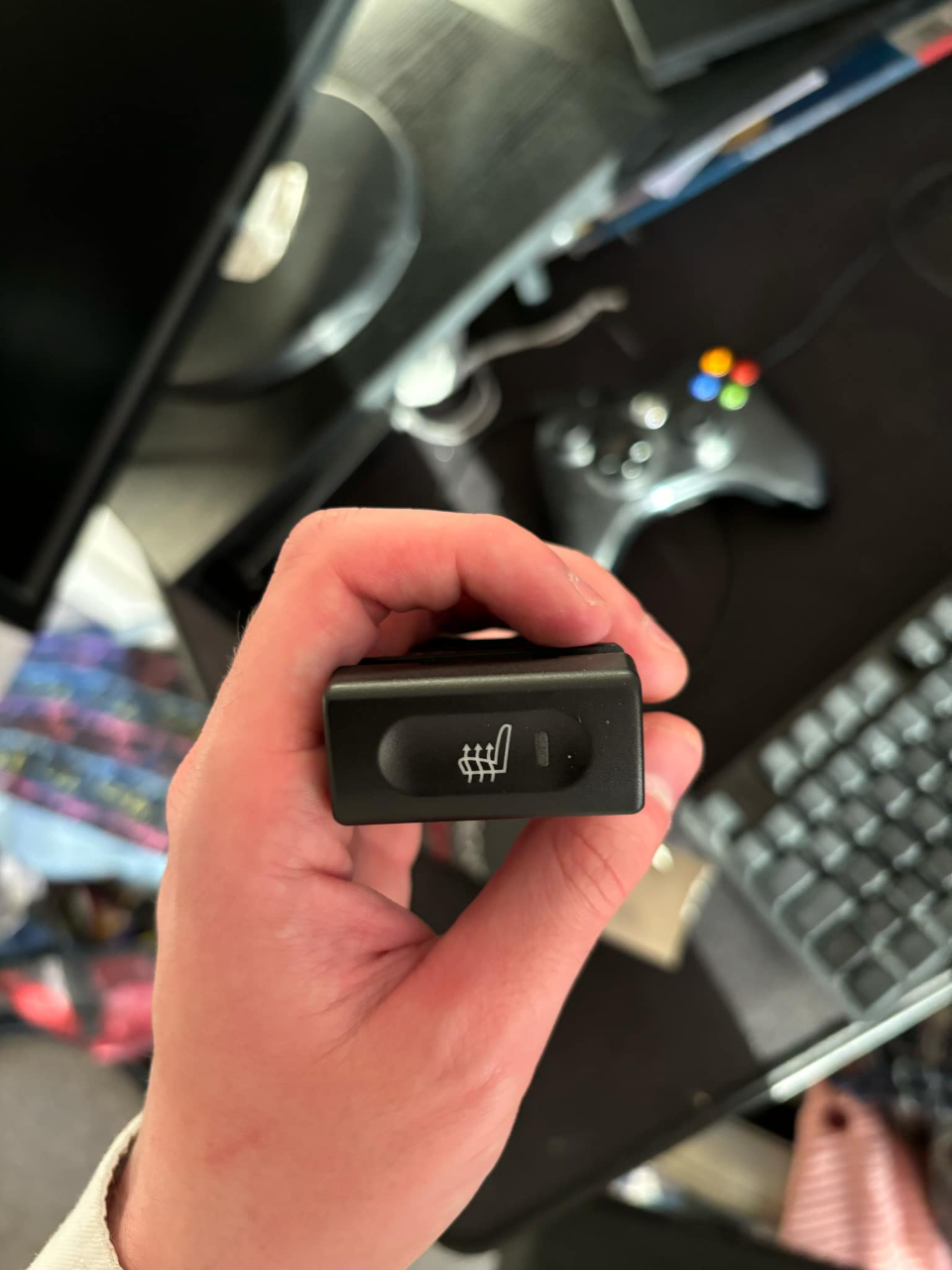

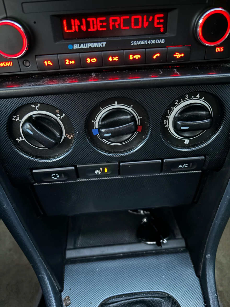

Wanted to test a theory today with wiring so I got a very cheap heated seat button to see if all the wiring was there:
To fit these buttons, apparently you need to pull the centre console forwards, yeah, no. I’m small with small hands and I have a hook tool, so instead of doing that I just blindly pushed on the wiring and got it around the hook and pulled it forwards to pull the connector through. I am not pulling a centre console for a connector. Sadly all the sound proofing behind the dash disintegrated and it stinks too (you can see a bit near the gearstick) so now the car needs cleaning out AGAIN, however I can happily report my theory is correct, all the wiring and relays are present for the heated seats, so all I need are seat pads and a button for the driver side:

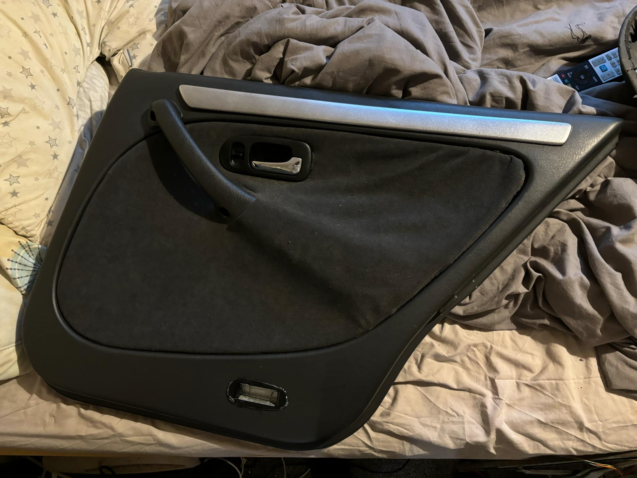

Anyway, onto the rear electric windows. This was a fucking saga, mostly because of my own lack of ability.
First, I’ve decided to use the original door cards with the window winder hole in. I got the door cards with the window motors and looms but sadly it’s had lights cut into it and I’m not a fan of that, so I’ve decided I’ll just get the original door cards reupholstered to hide away the extra part where the winder hole was, as I think that’ll be easier than it would be to restore these door cards:
So, to removing the door card. Christ, what a pain that was. The actual removal of the door card itself wasn’t hard but getting the retaining clip off the window winder was. My trim tool ended up shattering the little chrome ring around the winder unfortunately, so that’s gone.
Then there was the forbidden string cheese:
Anyway, managed to get all of the old manual gubbins and wiring out and tried to fit the electric one in. This is where I hit a really daft stumbling block. In my haste to get the parts for an electric rear window conversion, I’ve forgotten the rear window lift relay. I found this out the hard way as when I plugged the window motor in to shift the regulator to meet with the window, nothing happened. After a 25 minute phone call, some ranting about how much I hate cars, and then some more ranting, I finally found a fuse diagram that makes sense and shown me where I needed to be looking for the window lift relay. So temporarily I swapped the front relay into the slot for the rear, crossed my fingers and… Nothing happened. Shit. Must be missing more parts, but I’d come too far. I was at the stage where I was going to attach the motor to the battery to move it up and down. But I thought I’d better try the door handle switch first. As this wasn’t plugged in, I went back to the back of the car and plugged it in.
Then I noticed I hadn’t plugged the window motor in. I mean that’ll do it. So I plugged it in and lo and behold, worked fine. By this stage it was nearly dark and I was annoyed so I called it a day. I now have a car with 3 electric windows, only 2 of which function, and one keep fit window. So I now have less window functionality, and more door card holes. Progress?
It’ll be progress once I get a window lift regulator for the rear and get the other side fitted anyway, aiming to sum up the courage to do that on Saturday…

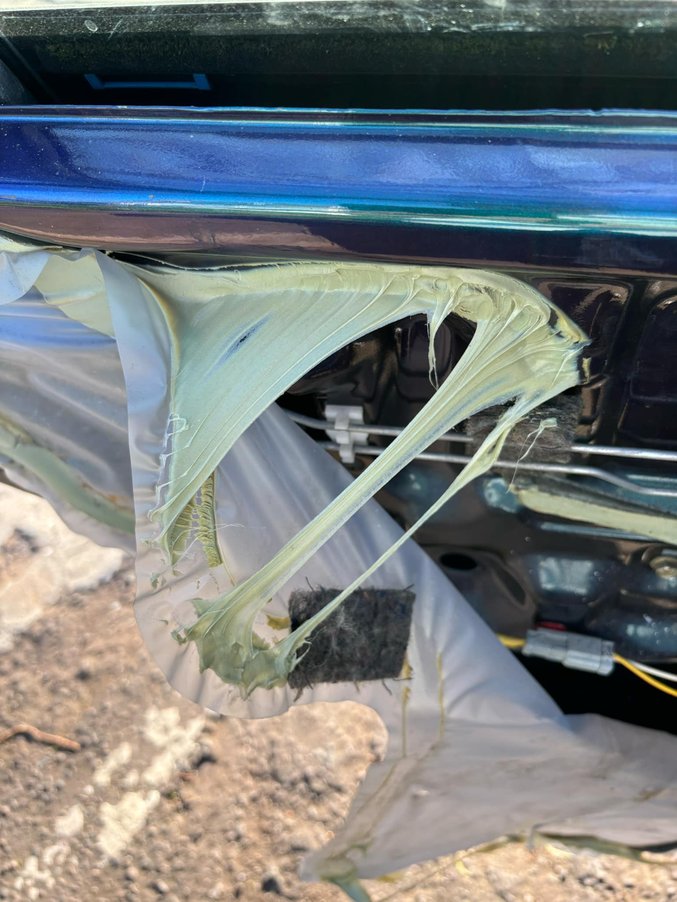

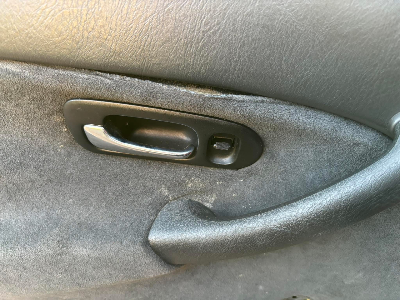

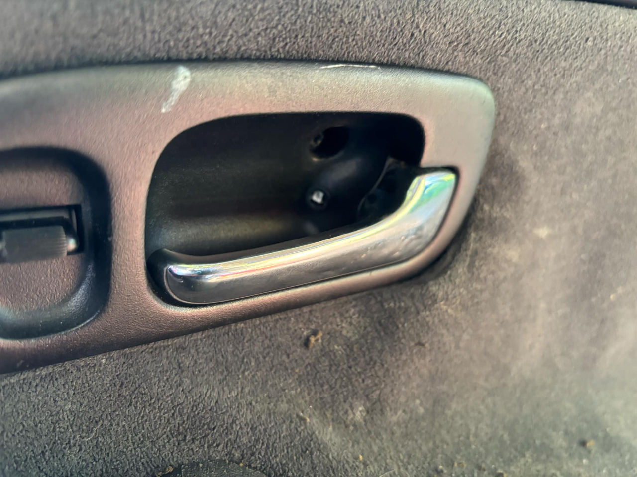

Got bored this evening and did the other side too. Figured while I was still covered in grease (because 2 showers wasn’t enough to clean it off apparently… need to buy shares in Swarfega I think)

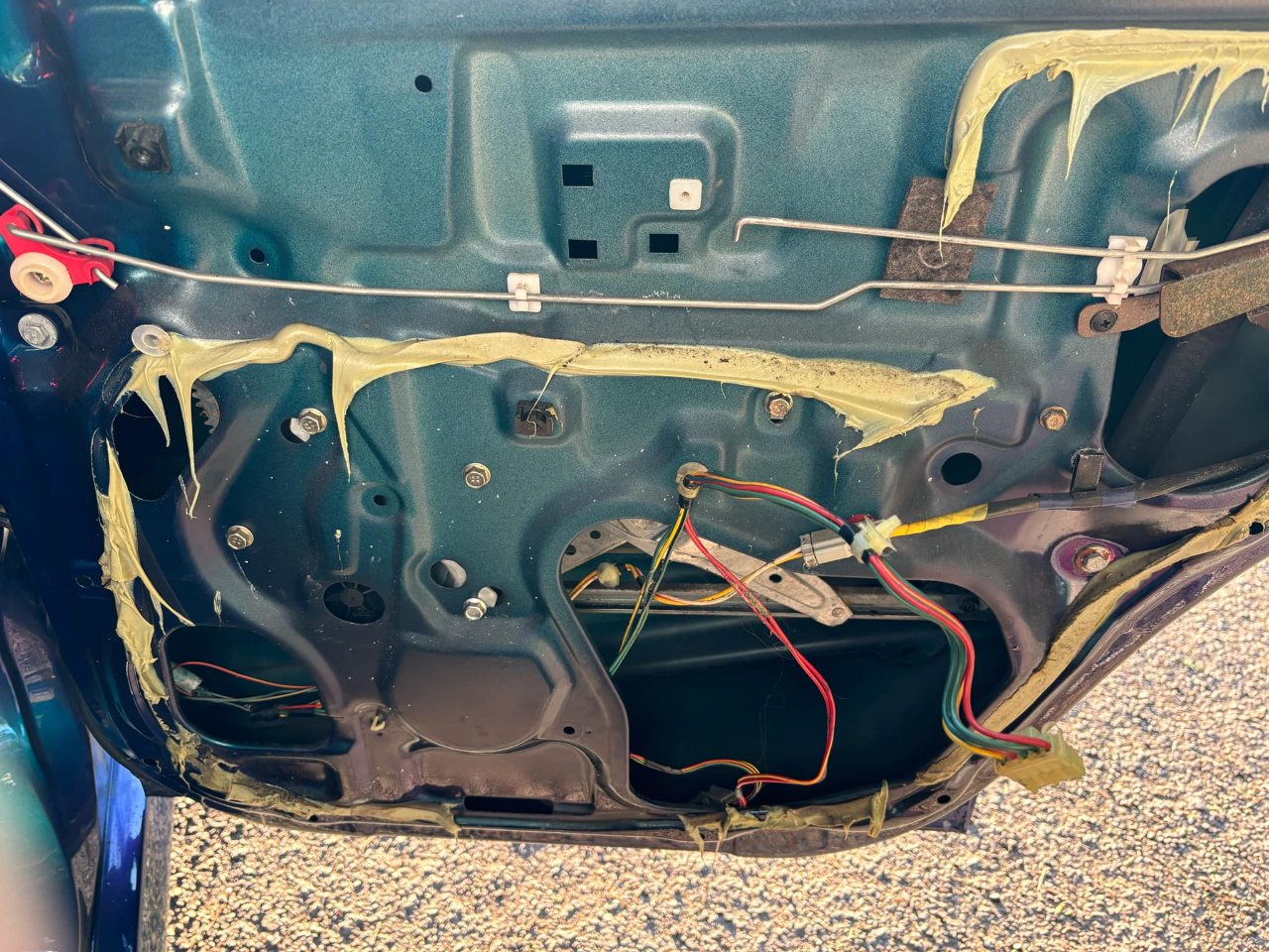

At least I took photos this time. First off, whip old door card off. That glue that holds that sheet on it disgusting by the way.
Pulled that out and pulled the regulator and wiring out of the door, ready for the new stuff. Ignore the extra wires, whoever owned the breaker car had fitted LED lights into the doors (more on this shortly):
Then I had to move the regulator right down, easier to just plug it into the car and do this outside of the door…
All fitted and back in, didn’t take too long this.

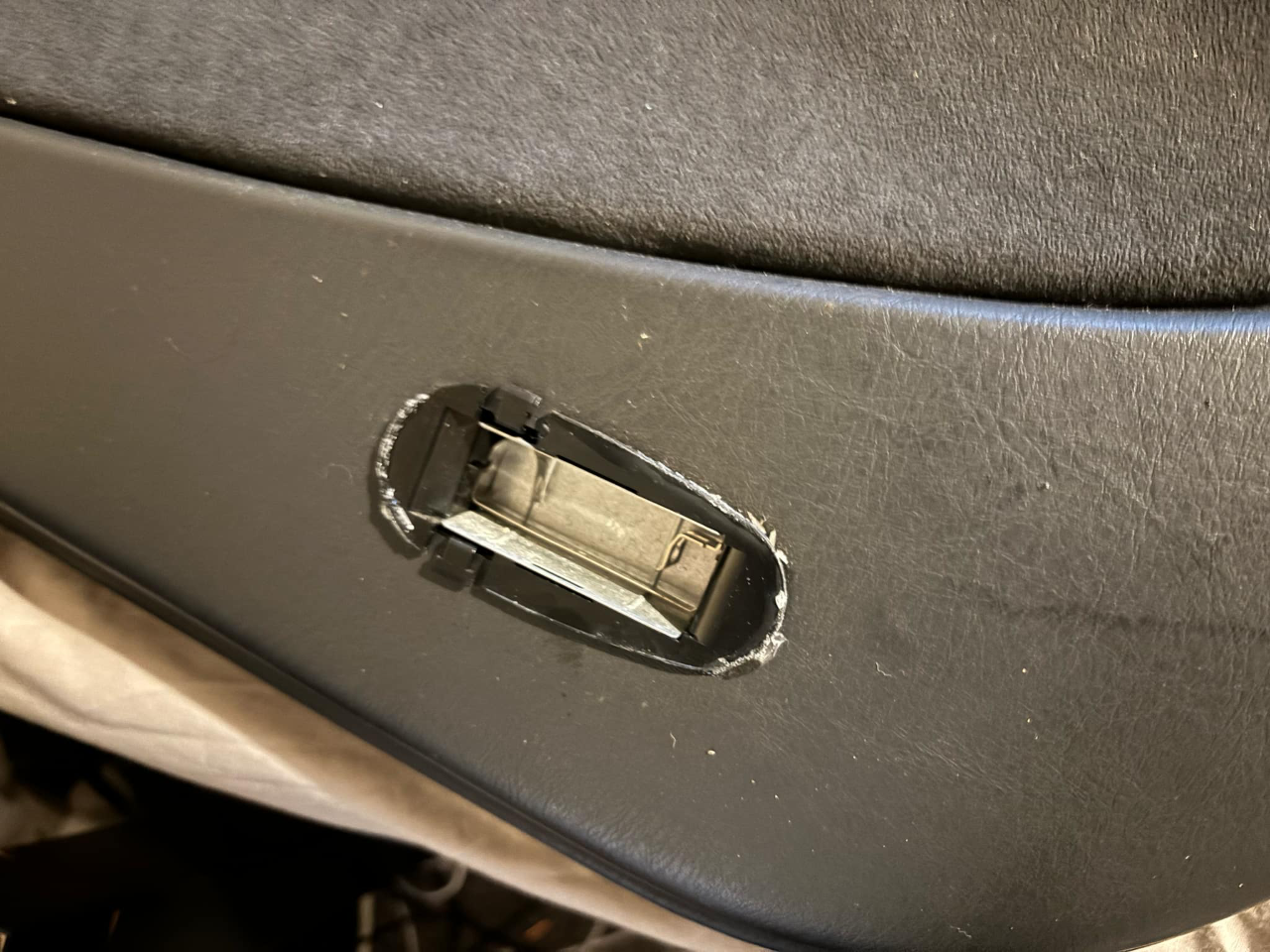

Door card back on with new door handle with switch!
I am very aware there’s a hole where the winder used to be. I have 3 sets of door cards. I’ll use the 3 sets to make one good set eventually… Sadly, the handle also has an LED in it. I’m not a huge fan of that, albeit hidden well. Wouldn’t mind if the entire car had them but it doesn’t, so I’ll leave that unplugged for now…
Just need a window lift relay now and it’s all good!
Some cars used to just put a circular blanking plate over the hole for the winder. Saved money on production costs using the same card I'd imagine.  Measure the hole diameter and have an Internet session,  you might get lucky.
That may be the solution for the time being just to neaten it up a little, however as the material is hanging off the door card anyway, I’ll be having them redone at some stage!

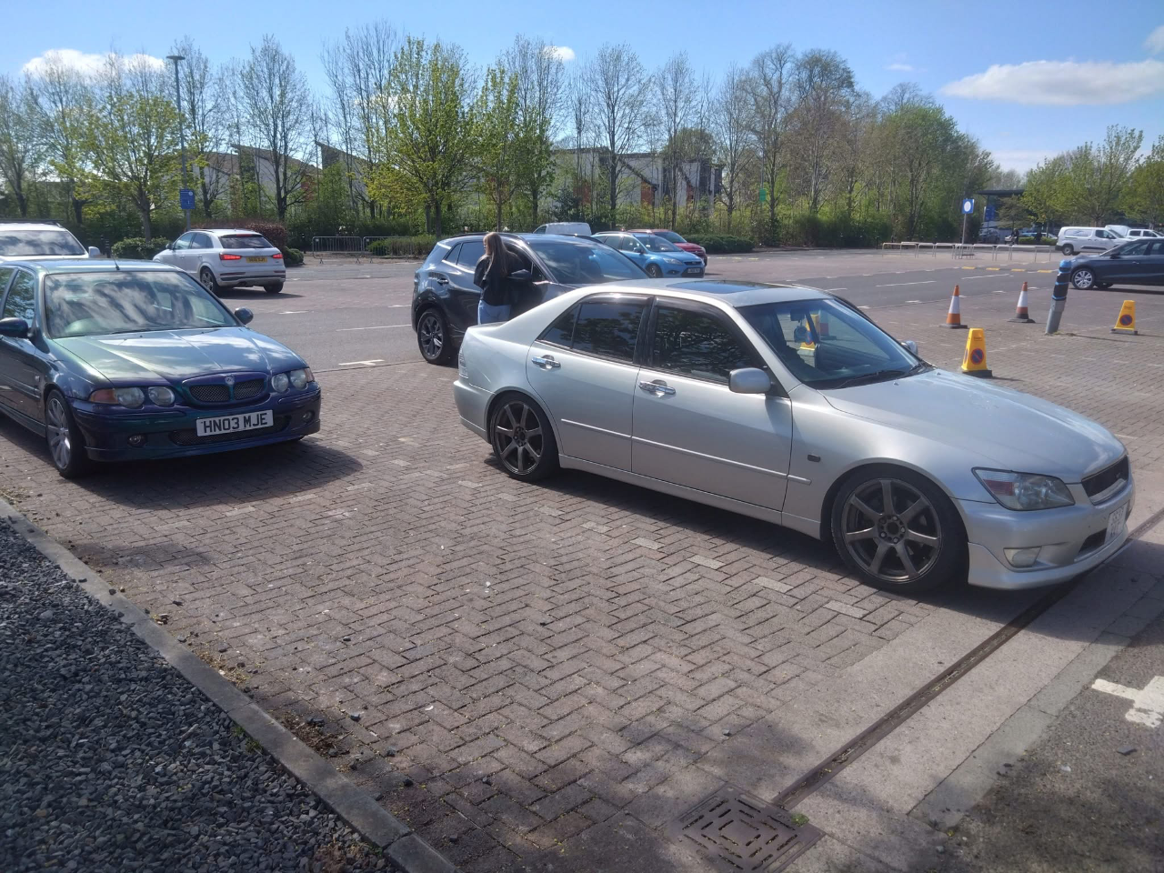

Also met up with @JMotor and had a go in the Altezza. Very yes.

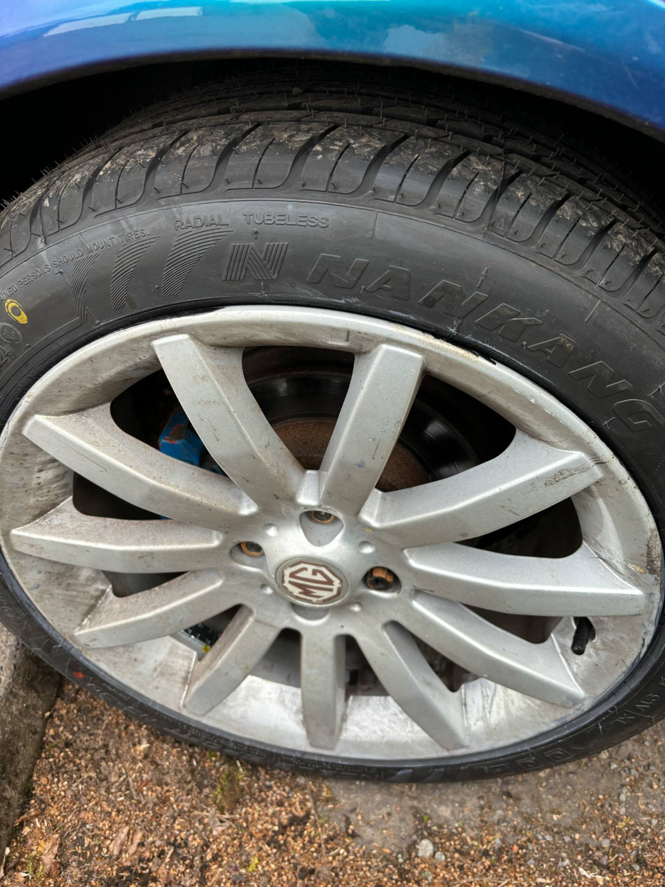

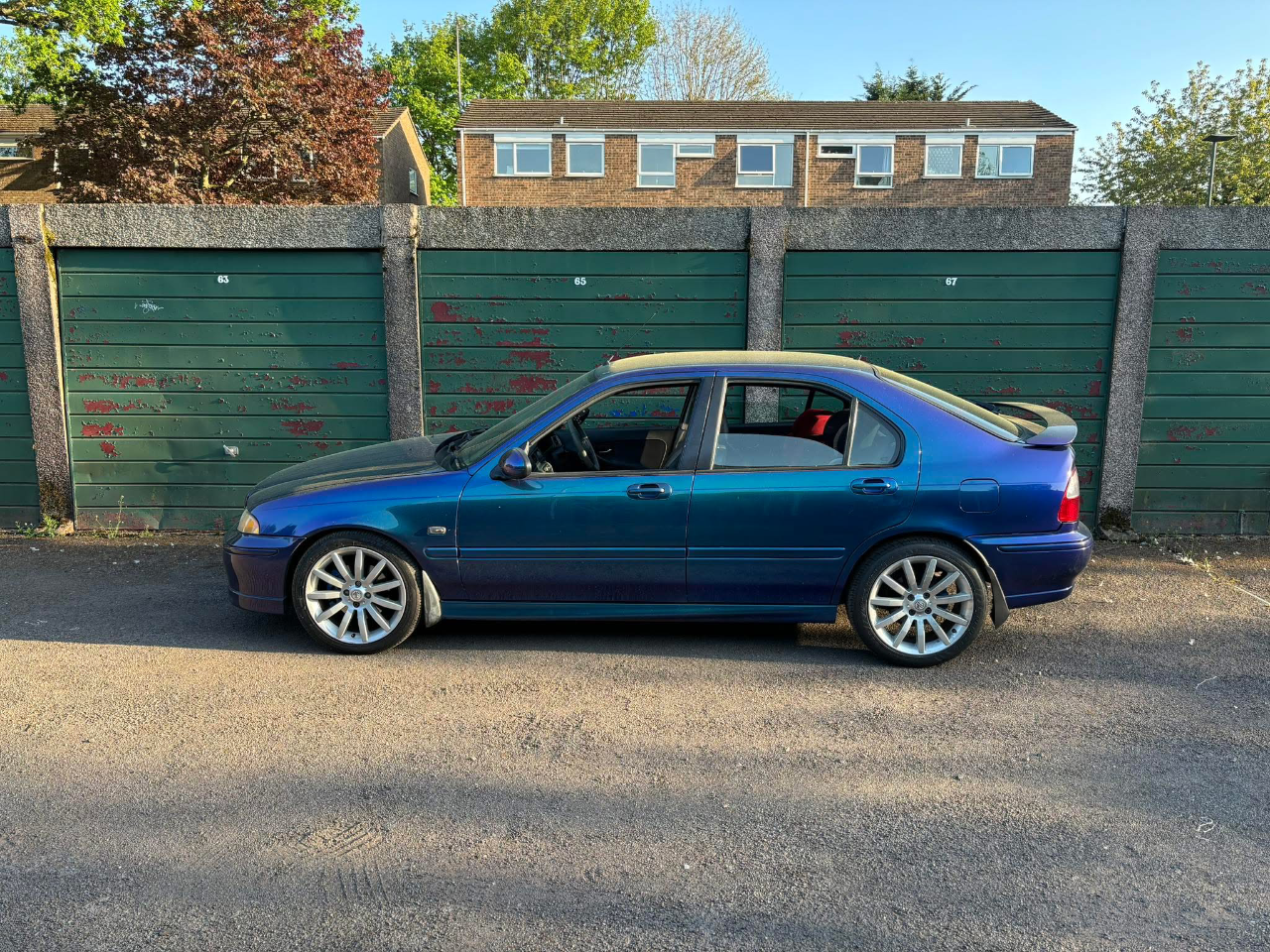

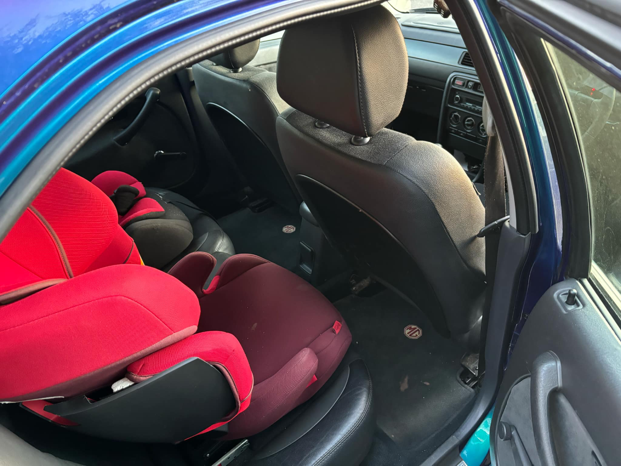

Car is mostly holding up okay to say it’s a fragile 22 year old MG Rover product. The rear tyres were horrible in the wet though (apparently they were less than £35 per side fitted, so that’ll explain that), so I went to my local tyre place for something I recognised the brand name on, and got some Nankangs for £50 a side. Shout out to the tyre place for the price to be honest because the same tyres on Blackcircles are nearly £30 a side more! Only seems right to share the receipt with their details on in case any Birmingham based shiters need tyres…
These have vastly improved the car. Much quieter on the road too and the back end of the car feels less loose. Never have had a shit Nankang to be honest. I prefer Yokohamas but this is what they had. And before someone says it yes I know the tyres are 215/45/17 rather than the 205/45/17 they should be. I’ll remedy this when all four have worn out.
Spent time with it yesterday sorting the bodywork, I haven’t got any before (or after) photos but a lot of the small scratches have been polished out, the car has had clay bar treatment and a good polish and wax all over, so now the Typhoon paint looks glorious in the sun and the paint feels like glass. 😎

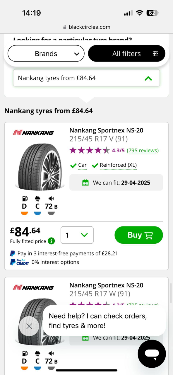

Was gonna ask who the tyre company was but that's who I use already!  That's a great price for Nankangs which are one of the few budgets tyres that are any good
I’d not use anywhere else in truth. Have to wait a while to be seen to but certainly worth it for the price!
I will get some more premium tyres once the Nankangs and the Avons on the front wear out, but I’d rather get 4x premiums in the right tyre size all at once, but those budgets HAD to go.
Glad you enjoyed the Altezza.
Weird to be a passenger in my own car 😆.
Was really impressed with the ZS. Amazed at how lovely that KV6 is!
Hopefully you can get the clutch sorted out. It didn't feel too bad. But something felt odd at the same time.
I feel it could be a long(ish) term car for you as it does AN car well then can switch to being a fun car to throw about while that engine sings. Well it seems to me it's a good car that with a little effort could be a great car.
Scary being a passenger in your own car. "Please be gentle". "The lever doesn't self centre y'know. Be careful not to get 1st by mistake". "That's enough revs for now". And so on 😂

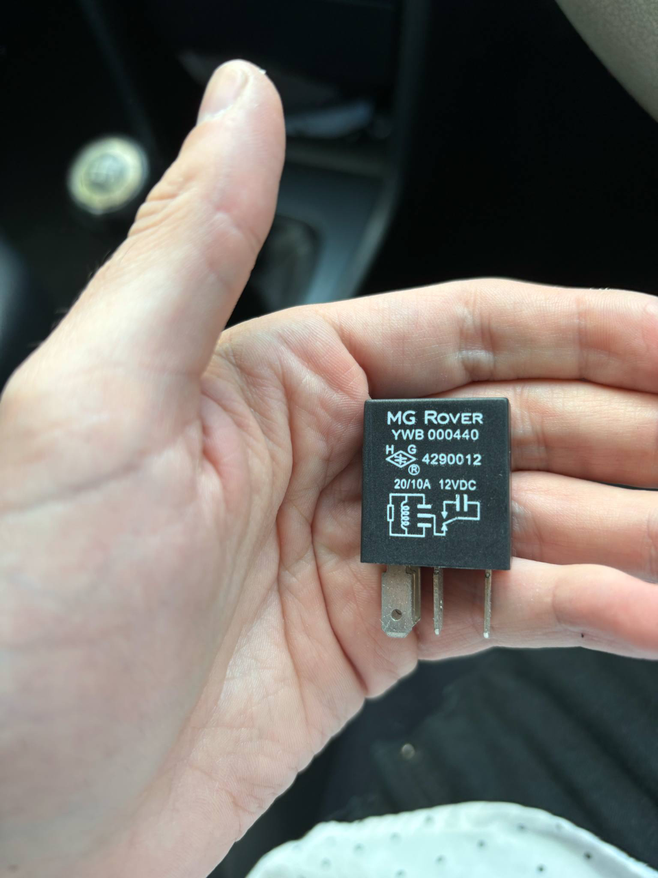

Bonus* update! The £6 relay that cost me £6 to have posted to me (so £12 for those that struggle with year 1 maths) has arrived. This means all the windows now work! Aww yis.

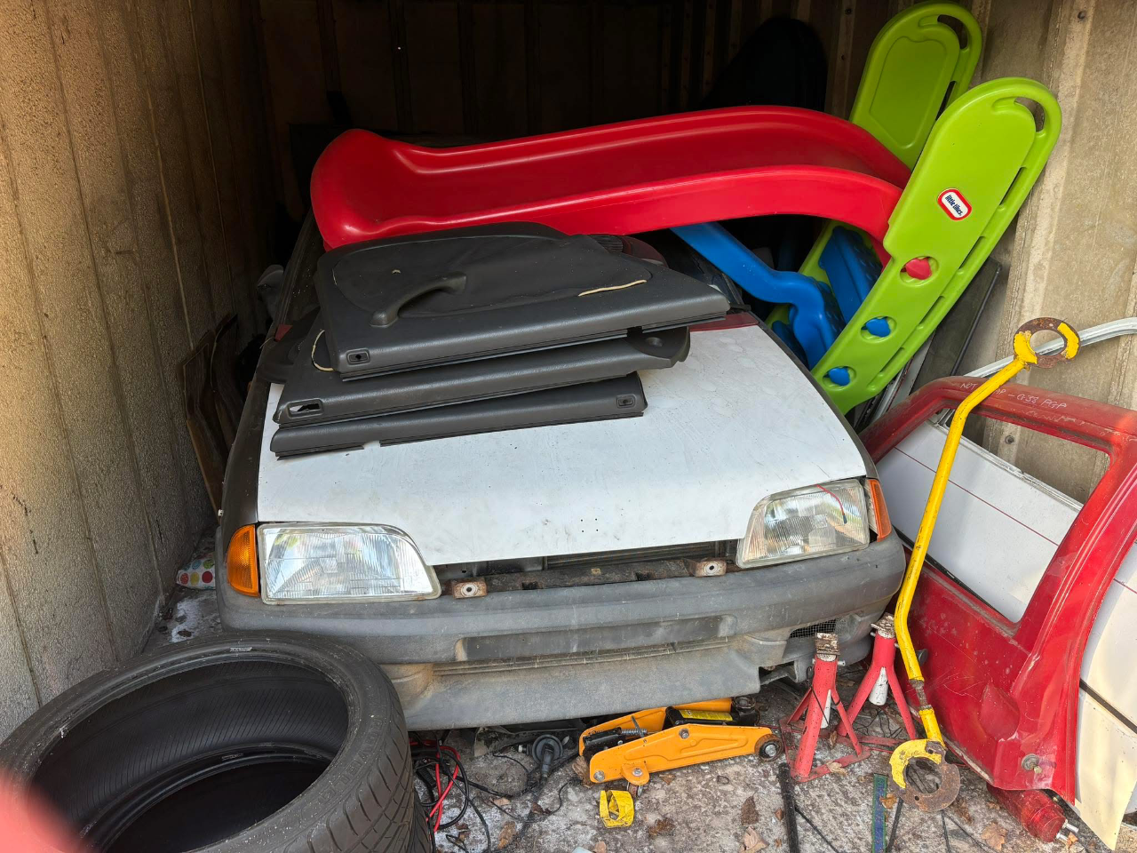

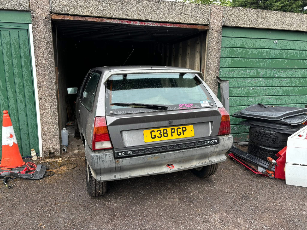

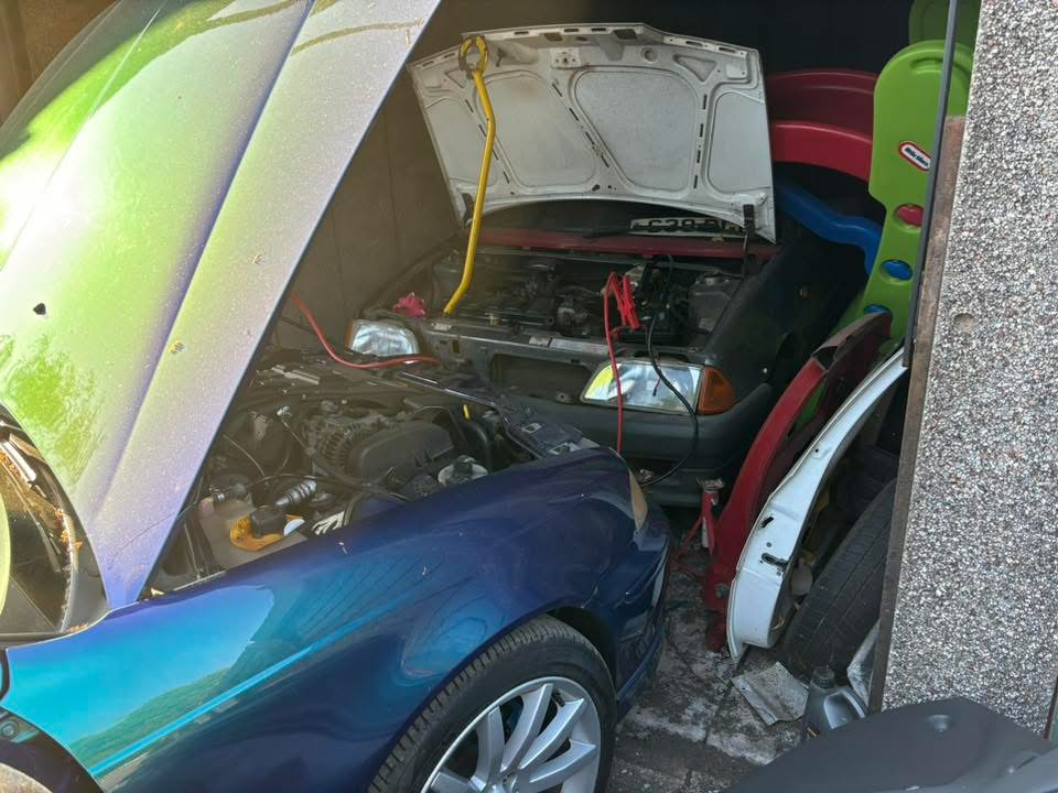

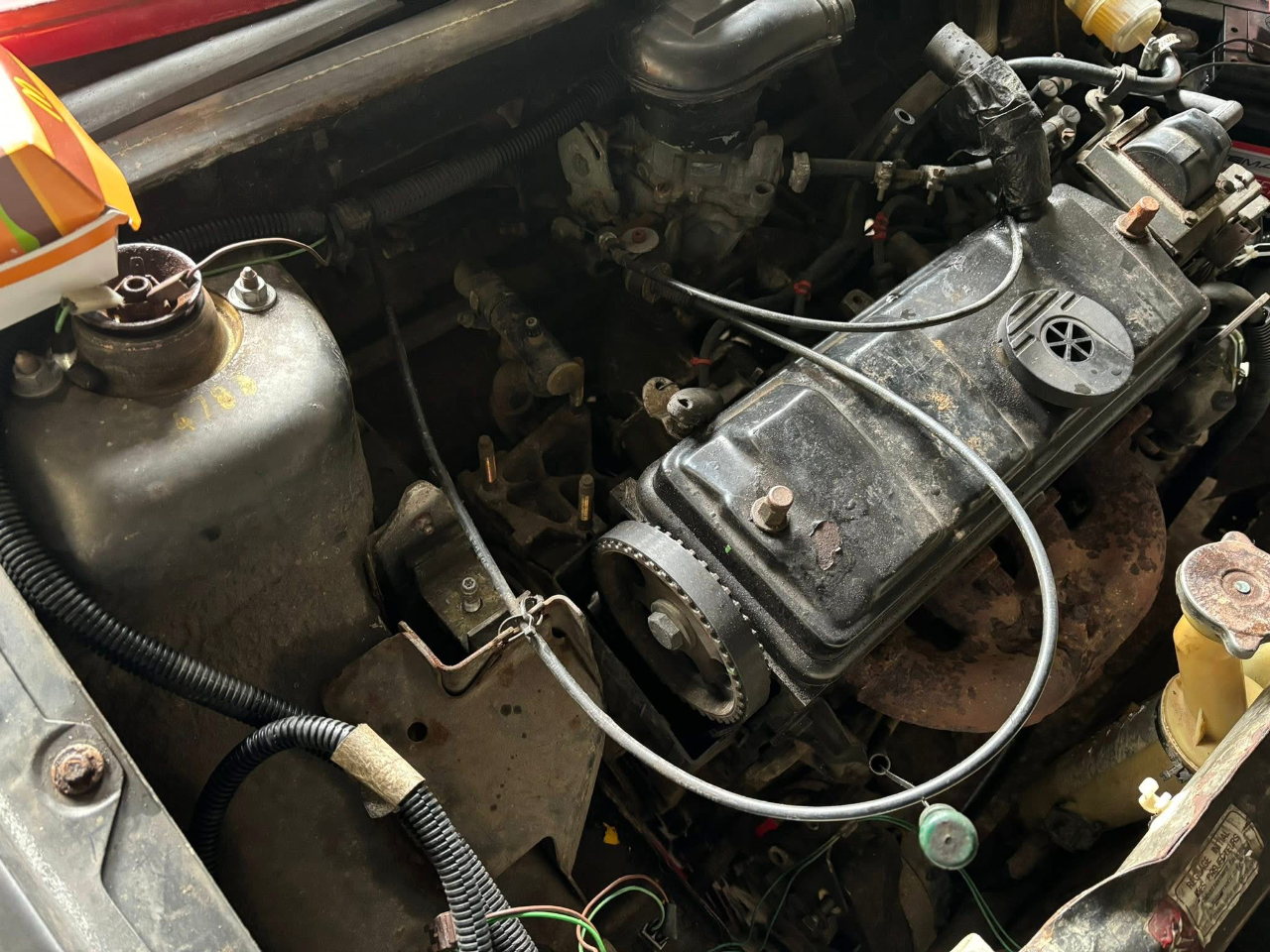

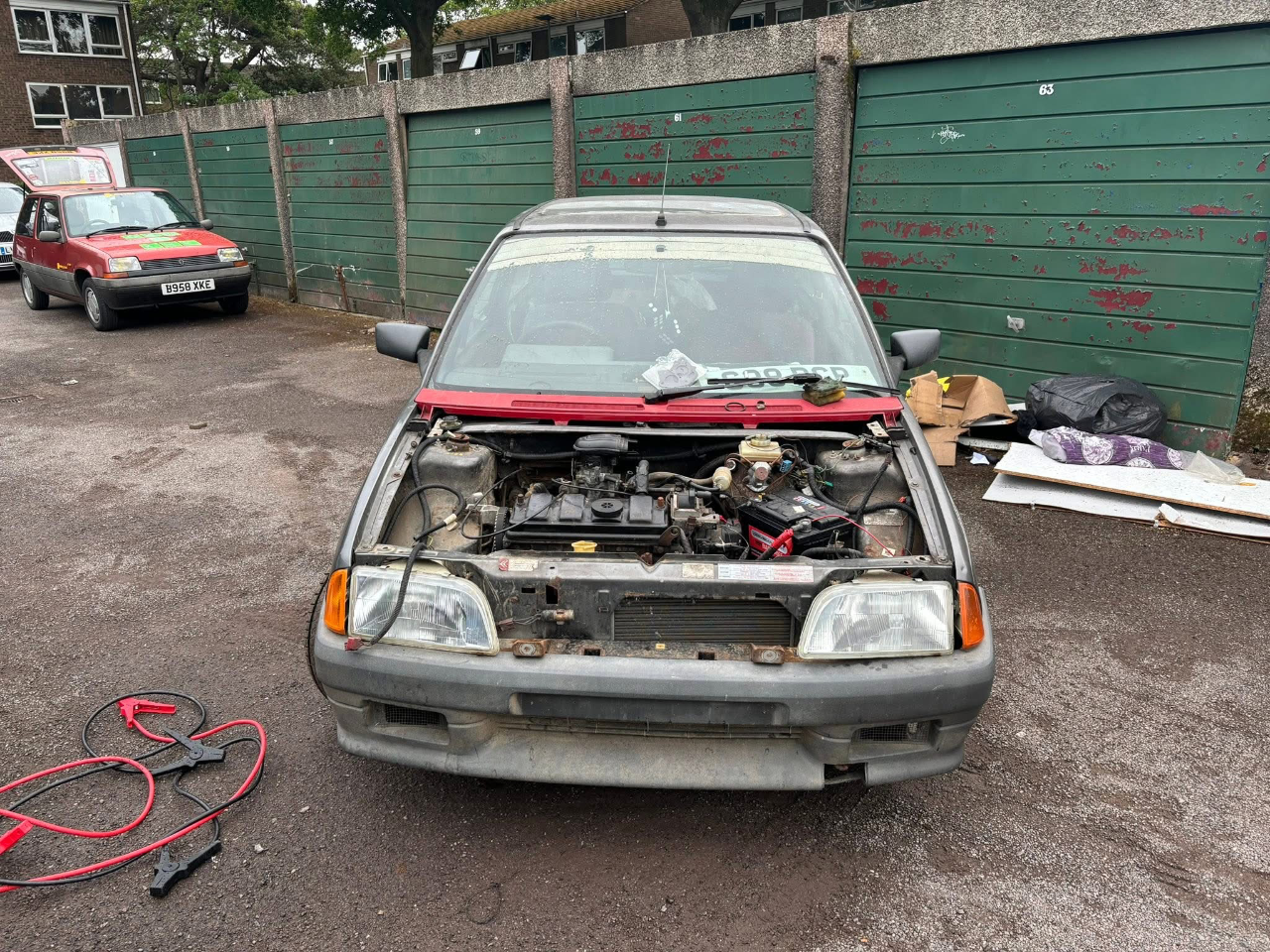

Decided to try and resurrect an old friend today. So I got the trusty MG…
Opened the garage, and moved some stuff and found this lurking under everything:

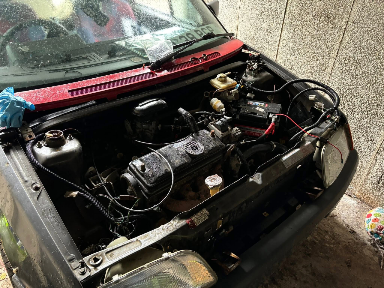

Hasn't been started since 2022. Battery obviously totally flat, so I got the MG and tried to jump it…
Sadly,  no dice. I think it’s something really simple since it happily cranks over but doesn’t fire, like the fact the inline filter in the engine bay is still dry after trying to fire it… Guess I need to buy some petrol.
More on this gripping* saga of a man trying to start a car when I find a fuel can and remember to fill it.
Upside is it’s given me some motivation to actually do something with it so I’m going to tidy the garage, sell some of the bits and bin some of the others so I have room to work on it, and start stripping the thing down a tad.
  • Imhotep changed the title to Imhotep's ever changing fleet - AX GT, MG ZS180 - AX GT is alive!
Got a can of Tescos finest E10 for the AX GT (yes I know it needs E5 but it’s what Tesco had, I only put a couple of litres in anyway).
Took some persuading but it fired up eventually. Still as eager as ever. Now I’ve been discussing welding with somebody who is also mechanically minded, and will assist me with the engine work. The plan is to do the engine work here in Birmingham and have it running and driving properly first, and then we’re dragging it away to another part of the country to do all the welding. After that it’s very simple things (comparatively) - I need to fit the replacement interior and engine loom, have the windscreen replaced, and eventually respray the car, though that’ll be a few years away yet unfortunately. Essentially my plan is to have it patched up to the point it could pass a test by the end of the year with some luck…
