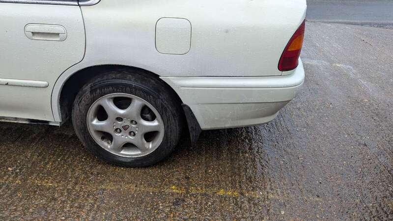

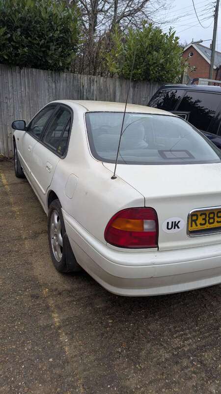

Refitted the rear bumper and to be honest I'm feeling pretty bummed out because it doesn't seem to line up brilliantly against the new arches, the shape of the new panels aren't quite a match.
Bit of a dilemma here, do I just accept it will look shit despite all the work I've put into it, or throw lots of money at getting the body work done professionally to do some panel beating and filler work- as it's quite a bit beyond my own skill level. I'll have to have a think, but it's a bit of a downer at the moment.

I will get a quote for the bodywork, yes it's going to end up exceeding the value of the car but it would be a shame for it to look shit after going to all this effort
I may have been a little harsh on myself, with the car on the ground I don't think it looks too offensive aside from the obvious incorrect colour match and irregular filler work as previously mentioned
Paint match aside, that looks very good, well done !
  • Agree 2
It’s a shit time of year to paint, it’s never going to look good done in a damp cold garage. Get it roadworthy then respray it in the summer.

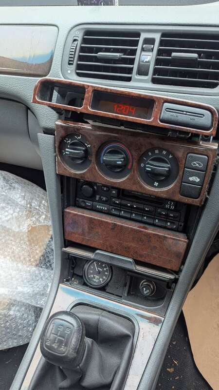

Repaired clock received back from the Rover coupe owners club! Very efficient service, posted off last Monday and received this morning (Saturday) so around a 5-6 day turnaround including the postage both ways.
And the replacement retractable aerial also works a treat! Not sure why the other one had jammed up, I've kept it to investigate later down the line

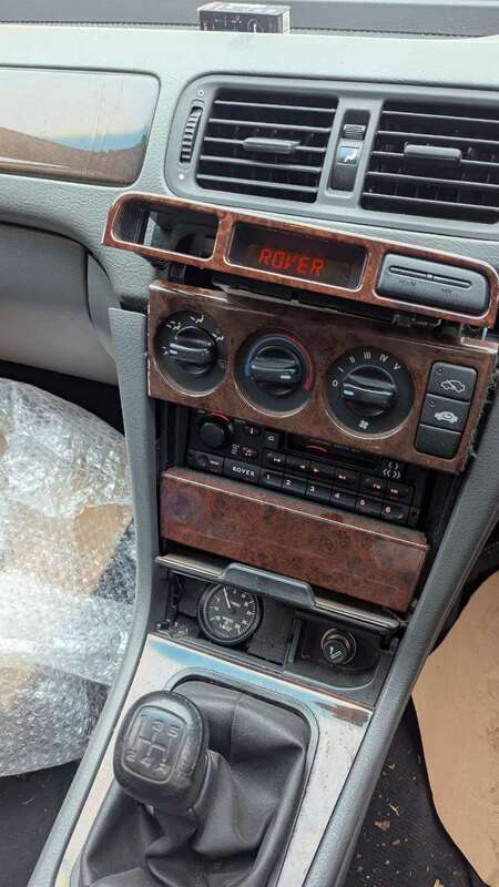

5 minutes ago, motorpunk said:
What’s the gauge set into the ashtray/cubby?
Boost gauge, which works!
Annoyingly, obscured by the gear knob when in fifth gear 😅
Oh, typical Rover strategic design 😂

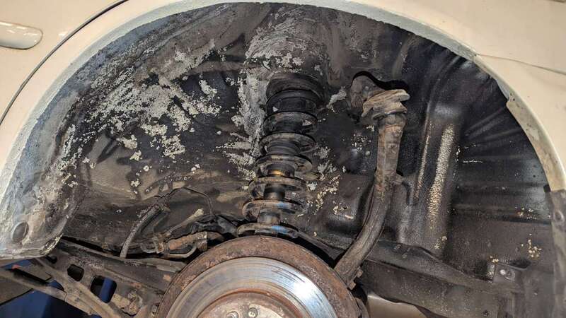

I've given myself a bit of time to clean out the arches and apply a wax treatment before the MOT

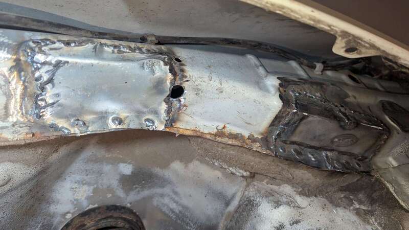

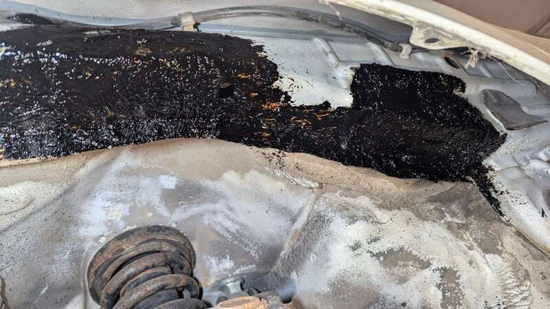

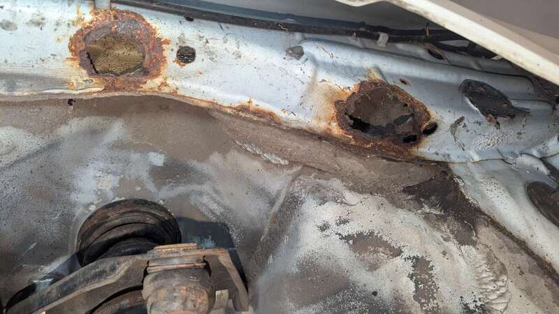

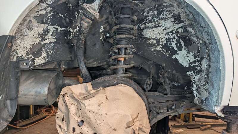

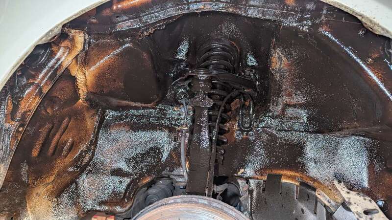

Well, no. I'm expecting a fail. *Somehow* I missed a section of grot on the offside front floor which extends along behind the wheel arch liner, and I think it's just about within 30cm of the front subframe/anti roll bar mounting :(
No time to deal with it before the morning, so I'll present it as is. At least I get (another!) list to work with if it fails, or maybe it's outside the prescribed area and will pass. Not my decision to make. Let's see!

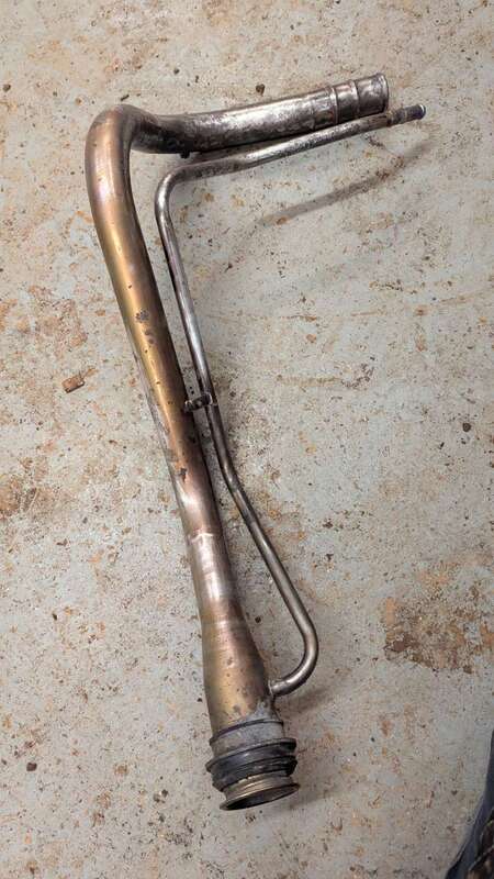

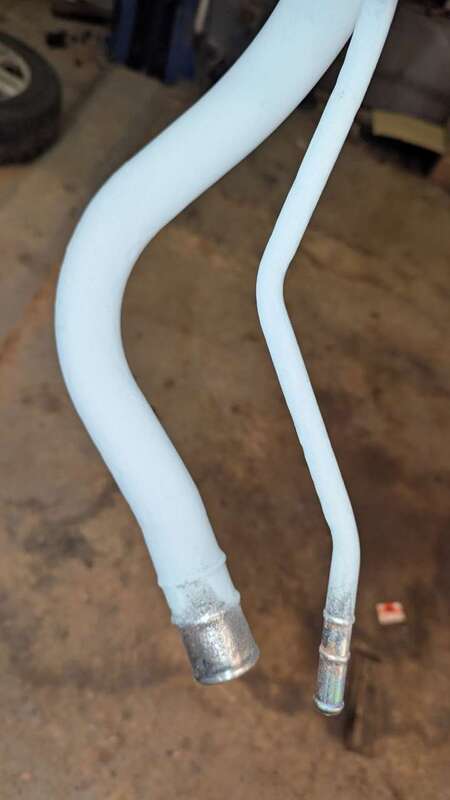

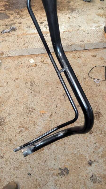

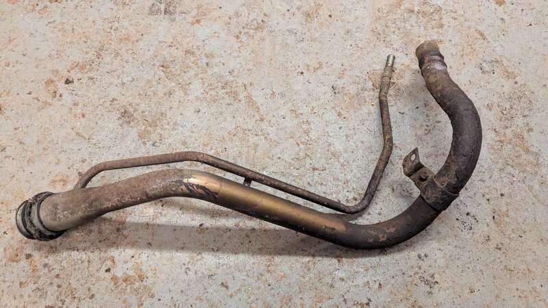

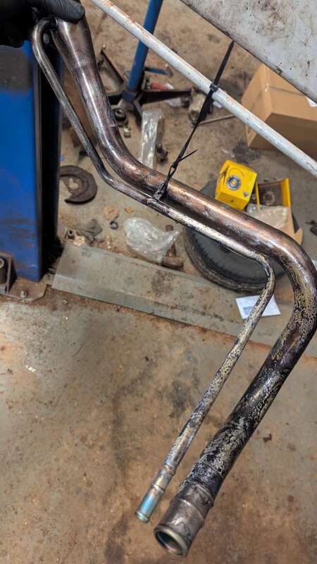

I decided to refurb the fuel filler pipes. Well worth doing in my opinion because they were getting crusty and it won't be easy to get hold of replacement ones in the future:

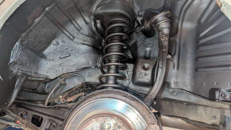

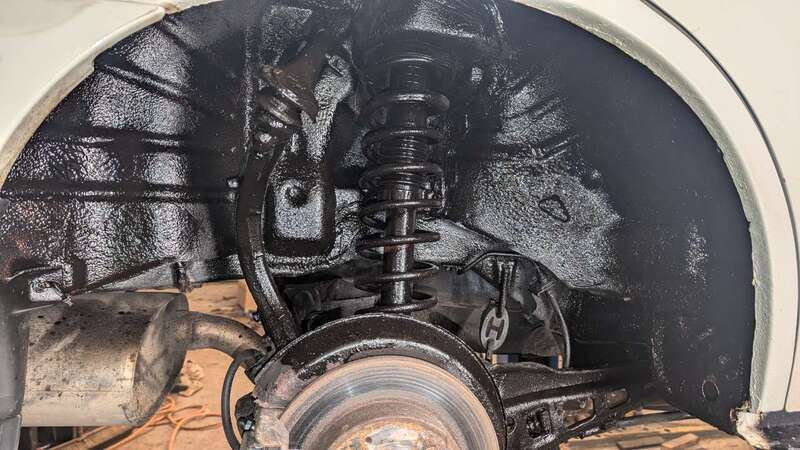

Also jetwashed the inner arches and applied a fresh film of waxoyl. Crucially this type of underseal is oil based, not that horrible thick rubbery stuff which dries and causes further rot (which is what's happened in the offside front area) - I've wiped it off the brake pipes and hoses to allow the MOT tester a full inspection of them.
I then carried out the weld repairs to the nearside front chassis leg:
And finished off with a waxoyl treatment on the front inner arches

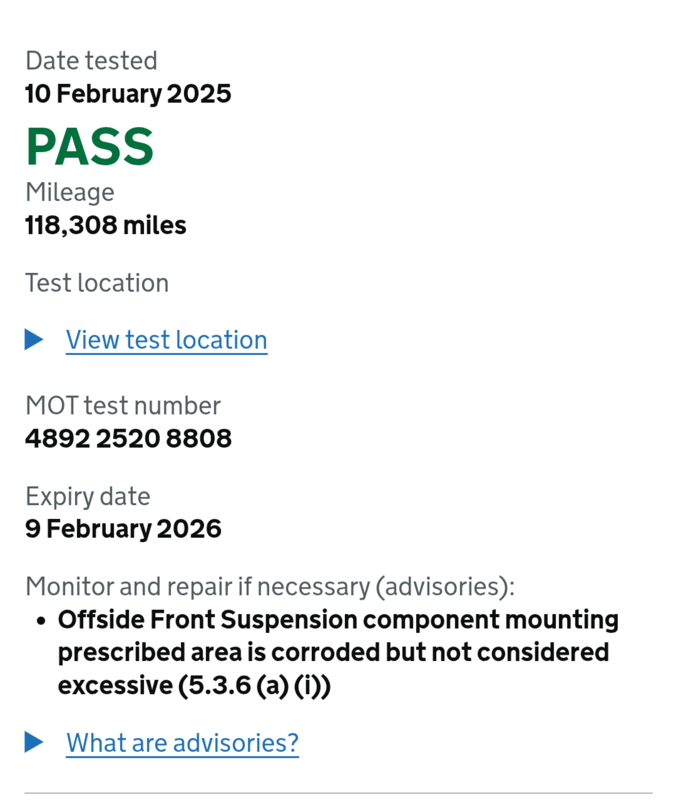

Thank you! I don't mind it failing on the newly discovered rot because I will sort it anyway, but I hope that's all it is, if anything at all 😅
*live excitement*
It's just gone, so looks like it's going on an early slot 😅
