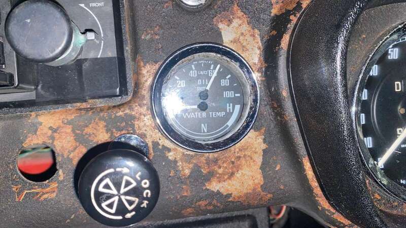

The needle in the oil pressure gauge isn't just stuck on the broken bit of illumination diffuser is it?
As for the dash lighting, I'd be checking the rheostat first, they're usually scratchy as hell at the best of times, never mind if having not been used in years.
Can it be that simple? I haven’t noticed the rogue bit of the diffuser. I shall investigate tomorrow!

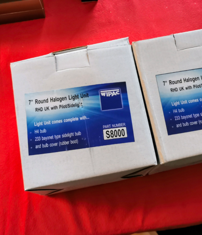

No, not really, but you don't need a window on your replacement SBU.
Chuck the sbu s   and buy a pair of halogen conversion  units  , upgrades to H4 bulb .. and see at night ...  for  just 30 quid. Domed  glass or flat glass available on ebay..
If you fancy getting shot of the sealed beam units these should fit straight in.  These are the ones I recently fitted to the Trabant, though I know a version without the sidelight hole does exist.
They came complete with bulbs for less than a pair of branded H4 bulbs from Halfords!

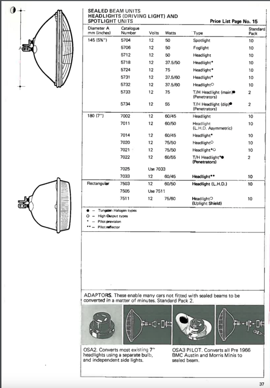

lamp manufactures used to sell adapter kits so you could fit a sealed beam lamp in place of an Lucas 7 inch British Prefocused light unit, here is an excerpt from a 1975 Osram-GEC lamp catalog :)
but given the option if I had to service a car with 7 inch head lamps and could choose between a H4 unit or a proper name brand (Osram, Philips, Sylvania, GE, etc) Halogen Sealed beam lamp, i'd go for the latter for sure

@High Jetter Thank you for the heads up on the light units, I have ordered two from the MG Owners Club.

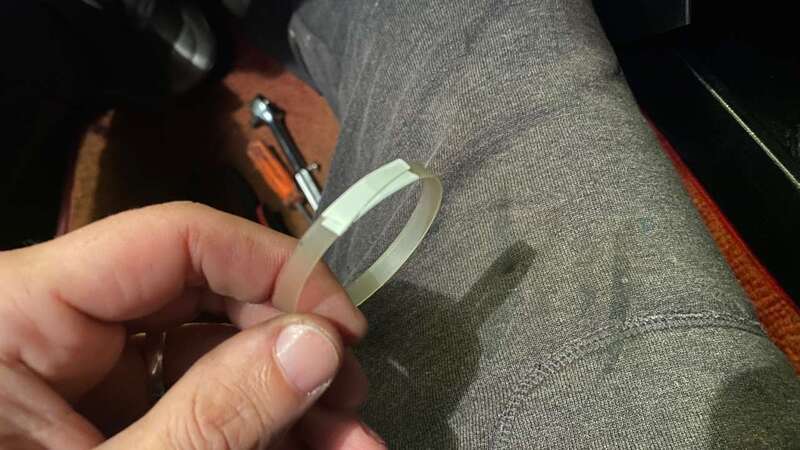

@Zelandeth You, sir, are the big winner today. Thank you for spotting something that was right in front of me!
I removed the bezel and glass from the front of the gauge, taped the offending plastic surround together and put it back where it belongs.
I had to use adhesive to secure the bezel back, hopefully it will stay on.
And the news is.....
We have a working oil pressure gauge!!!!
Whether the gauge is accurate is not for me to say but almost 70 lb / sq inch is a decent reading for a 93k mile B-series, admittedly that's cold with the choke out but hey, who's counting.
I will confirm what readings I am getting next time I drive the MGB.
