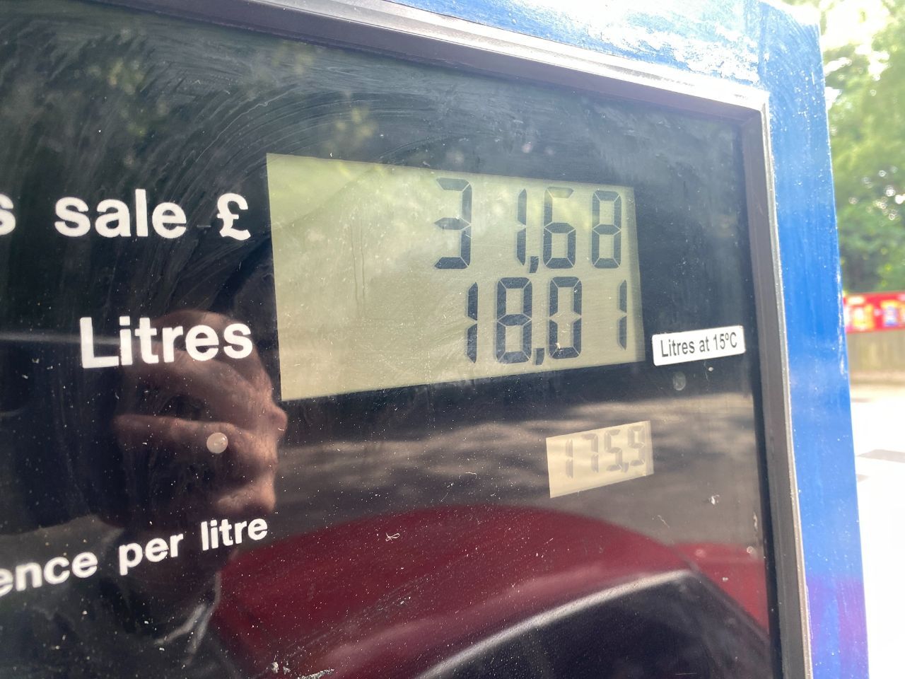

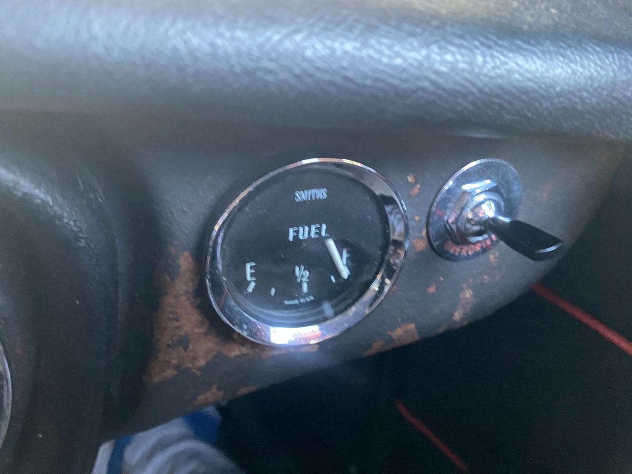

This wild MPG business has been bothering me ever since I did my man maths on Sunday afternoon.

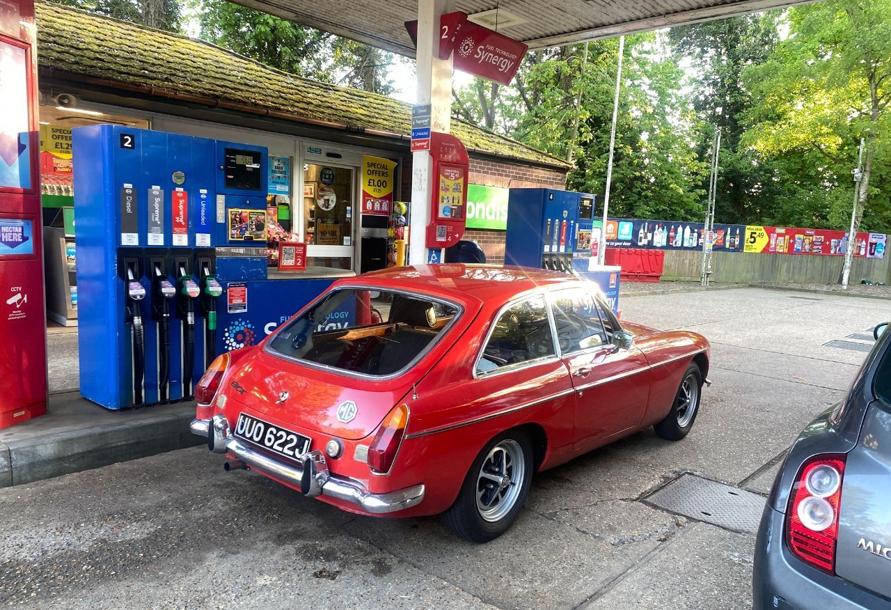

I took the MGB to another local Esso this evening.
Last time my fuel gauge was showing just over half (on Sunday, before my road trip), I managed to squeeze about 25 litres (4.5 gallons) into the tank.
I started to fill the tank today, to the point where fuel starting dribbling over the rear bumper and onto the ground.
And only 14.3 litres (just over 3 gallons) went in.
With the ignition switched on, the fuel gauge confirmed that the tank was full.
@Mr Pastry @LightBulbFun You were both absolutely right, the fuel gauge was telling porkies!
So, if I clocked up approx 100 miles and used approx 3 gallons of fuel, that means that the MGB averaged approx 33MPG. Not 18!
That's a very impressive figure, although it requires further verification as the exact amount of miles that I clocked up and the amount of fuel that I used is unknown.
I have taken a mileage reading and will brim the tank again in approx 100 miles. Let's see what happens.
From the petrol station I went home via one junction of the M40. The engine ran fine but I have a feeling that it has less oomph at lower engine speeds. I might tweak the carb mixtures back up a little tomorrow.
I'm definitely winning.
More soon.

25 litres is not 4.5 gallons, there are just over 4.5 litres to the gallon.
Yup multiply the litres by 0.22, 5.5 Gallons
Yeah, sorry, I meant 5.5 gallons. 100 miles divided by 5.5 gallons equals 18MPG, as reported on Sunday.
how far are you from Beko? he's got one of those suction gauges for balancing carbs that he uses on the vacuums
@beko1987 How far am I from you?
@Peter C you can buy a carb balancing tool cheaply enough - you need one if you’re keeping the MG
If that 33mpg is genuine and it performs well, there isn't much wrong with it.  Leave it well alone, and enjoy it.
Yebbut your rebrimming sums are correct no? 100 miles, 14.29litres/3.2 gallons...  ~31.5mpg...?
12 minutes ago, Christine said:
 /\ whs ...The pump says 25 quid   , not 25 litres
To be fair @Peter C did have a schoolboy moment earlier confabulating his 25 litres w 4.5 gallons, but his sums on the refill look good to me (even if the figures are a tad unrefined as yet)👍🏻

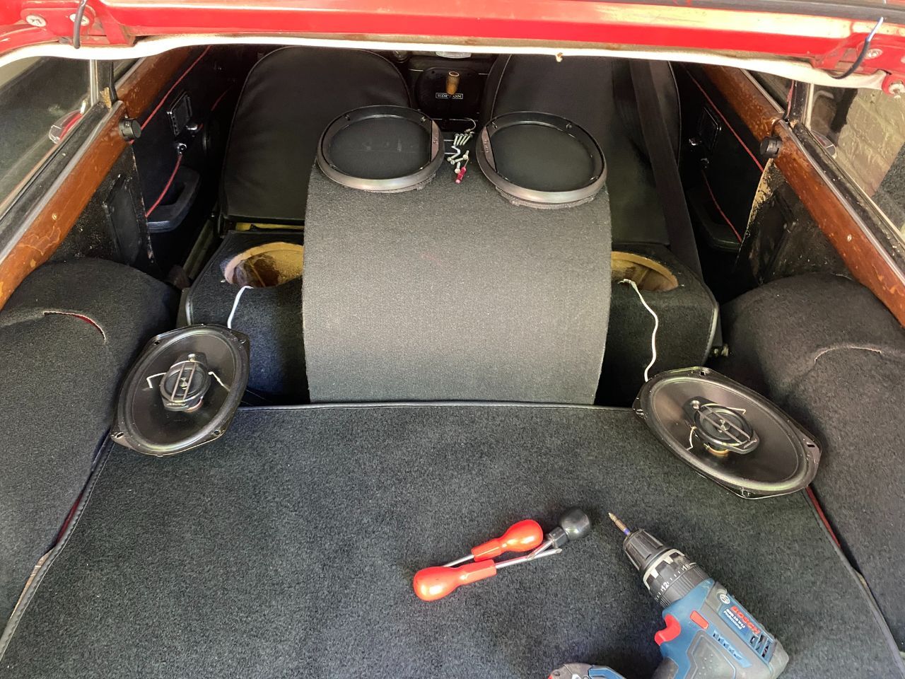

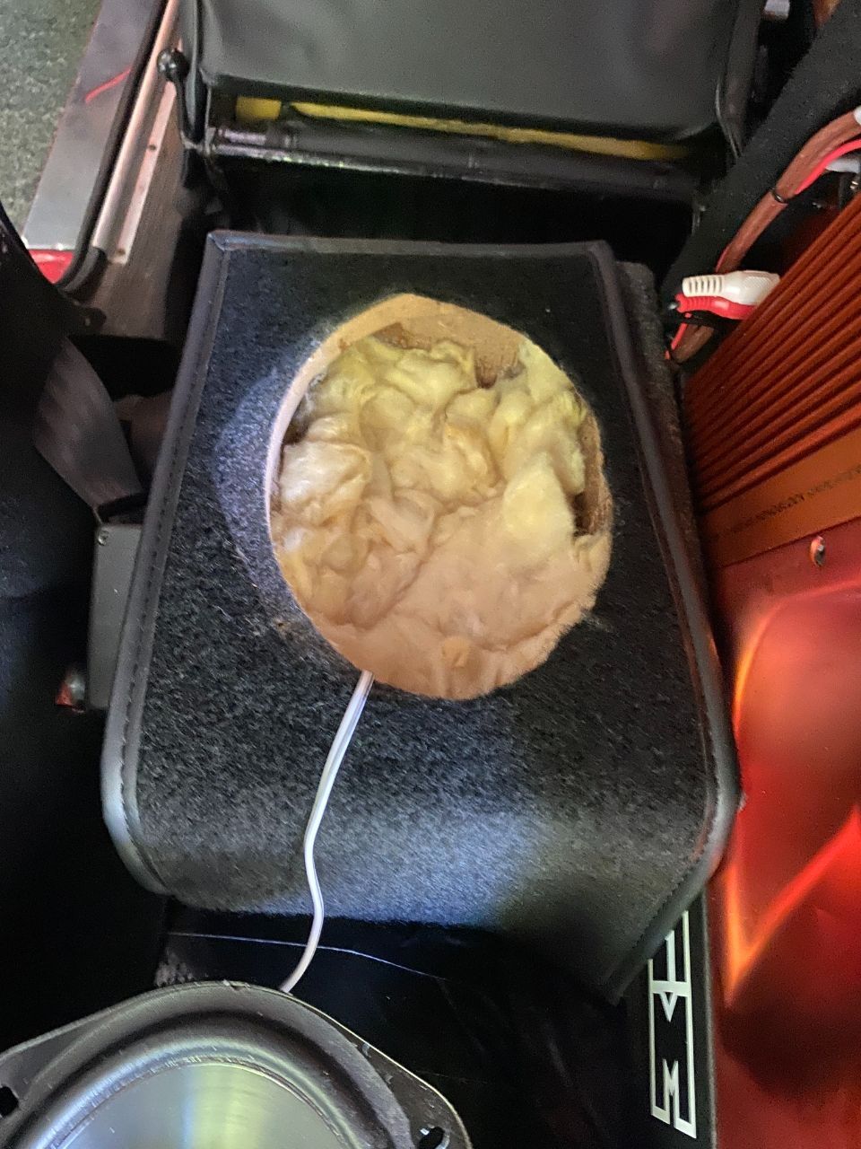

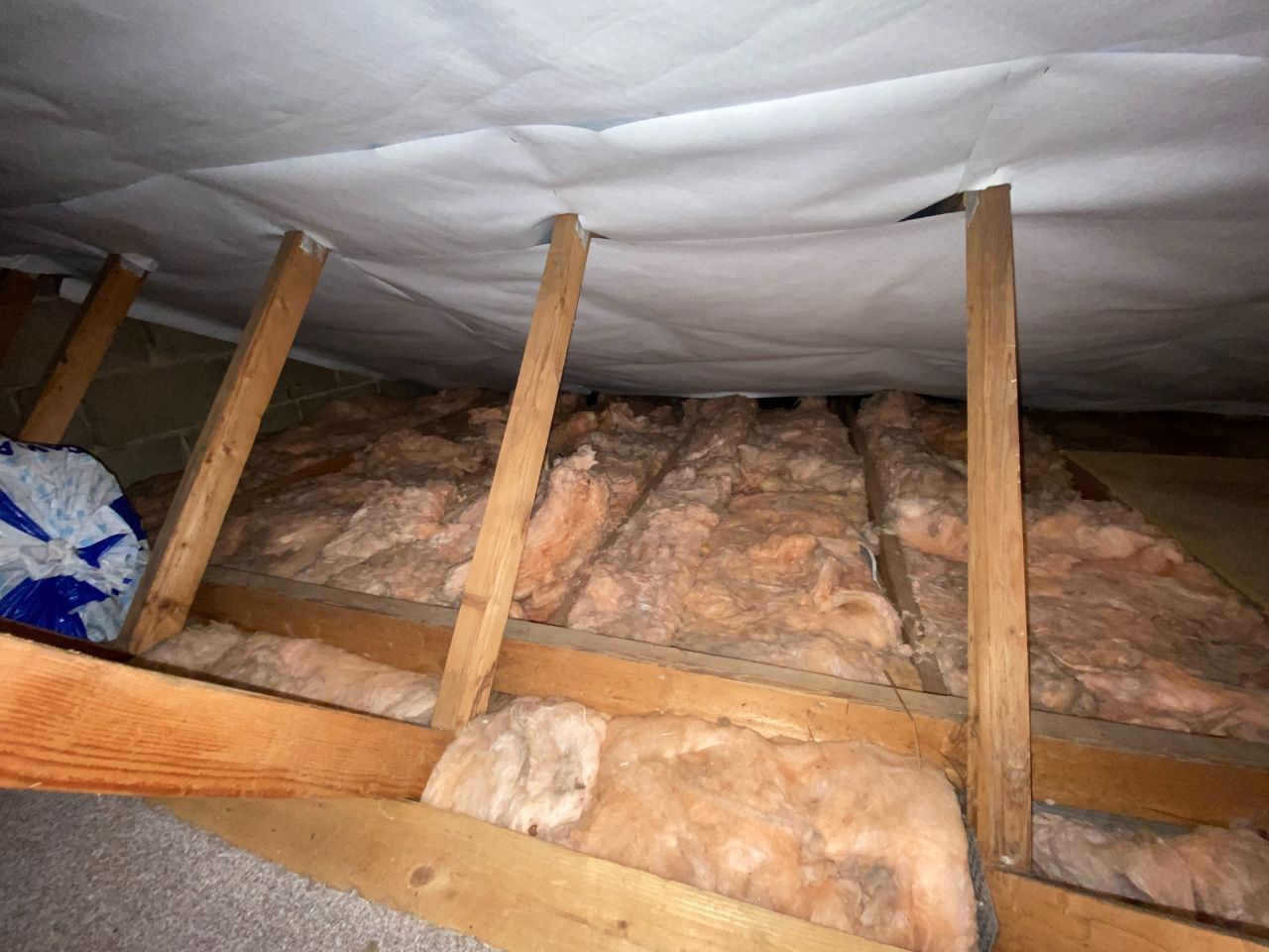

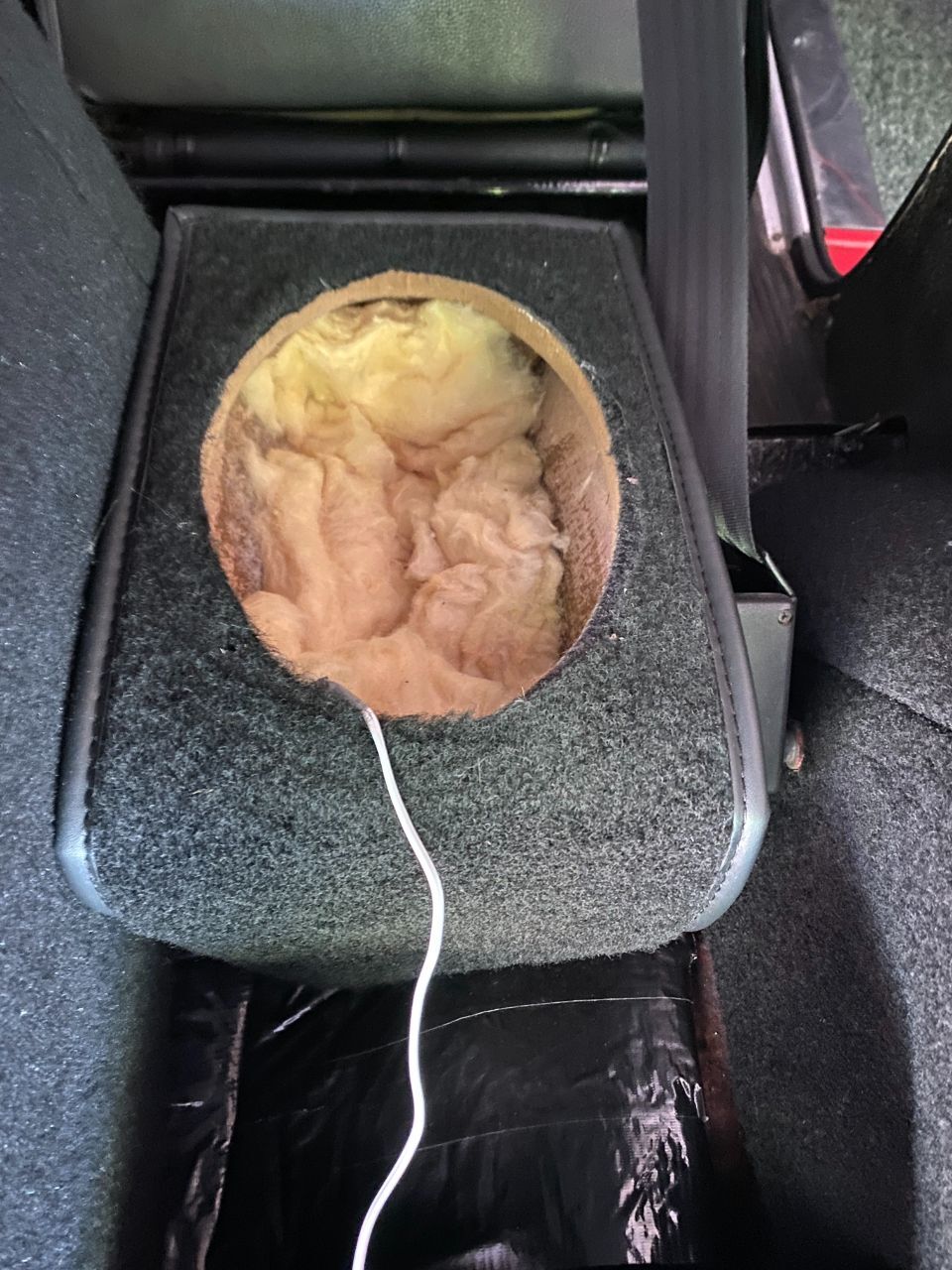

At the Flower Farm soiree, @vtec-e had a good listen to the MGB's new sound system and enquired whether I put any wadding into the 6x9 speaker boxes. I hadn't.
I had an opportunity to correct that today.
I removed the speakers from the boxes, to reveal nothing but two voids.
Rather than buying proper speaker wadding, I popped up into my roof void and nabbed a length of quilt insulation.
Which I stashed into the two speaker boxes.
I re-fitted the speakers, disconnected the other two amplifiers and had a listen to how the 6x9s perform now. It might be my imagination but the sound is significantly softer than before. Win.
Nice, no cost mod.
Thank you @vtec-e
  • Peter C changed the title to 1971 MGB GT - Added wadding - see page 39
