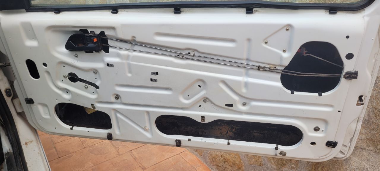

I cleaned down the door panels to remove all the crap & glue. I found the window channel missing in the left side door. Also need to source a couple of clips for the door lock rods.
