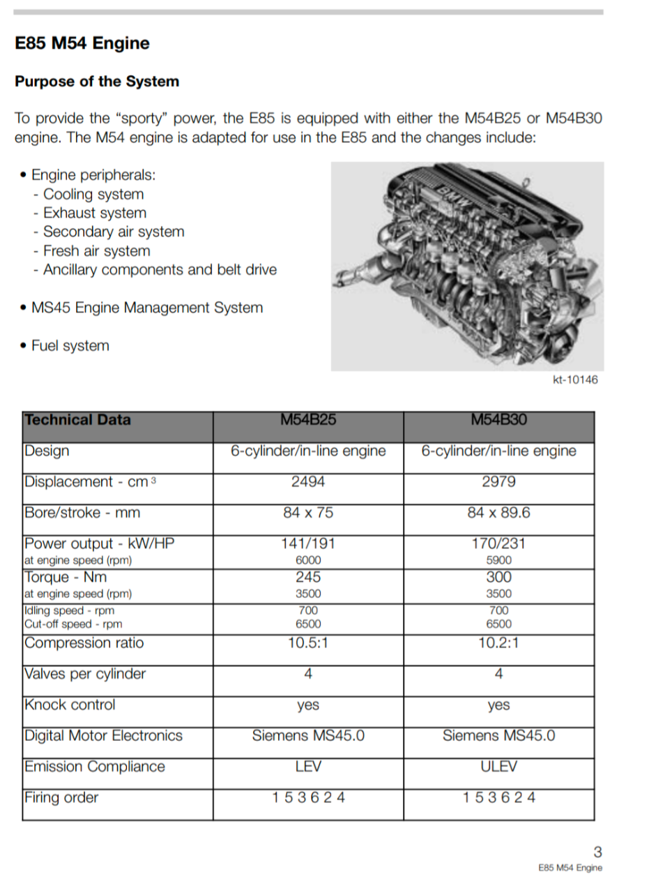

This is for the Z4 M54 but I'd be extremely surprised if these idle specs are any different to any other BMW M54.
My suspicion is that 0w30 is too thin with your idle too low if it's sitting at 500rpm.
These are very smooth engines  - inline 6 is the smoothest config out there, so if all cylinders are firing it's likely to stay smooth even at lower revs.
Also don't rely on the tach for real idle speed. Plug in an OBD tool. Doesn't need to be BMW, a generic OBD2 tool will be fine. While there, check the long term fuel trims - they'll give an indication on an air leak. Likewise disconnecting the MAF should do too.
