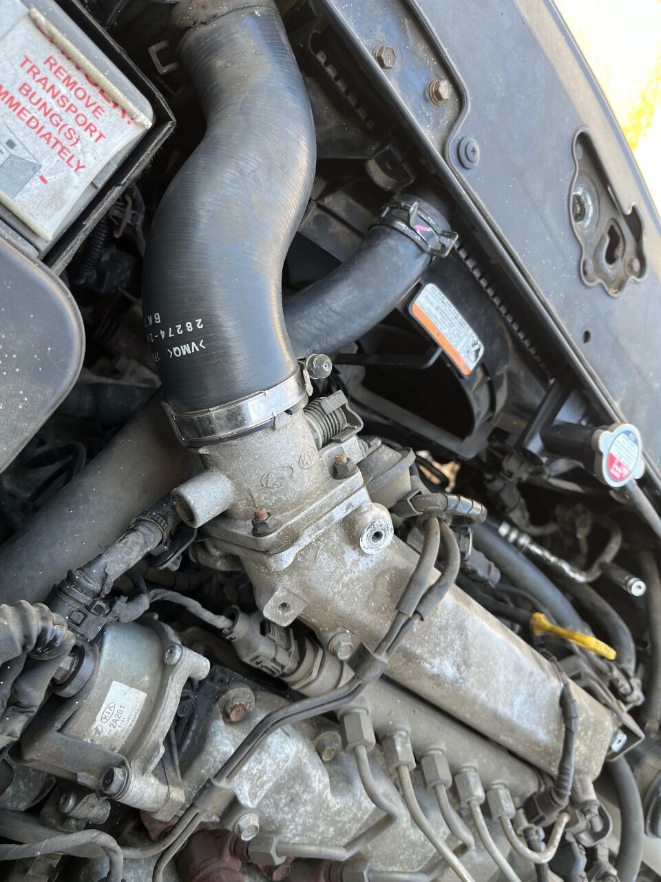

After many swears this morning, and actually having to remove just about everything between the engine and the rad, I managed to get this out of the Kia.

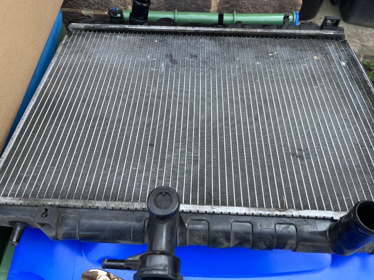

It had 2-3 pinholes in the bottom tank and it also looks like it’s got struck by something in the lower N/S corner on the other side. Which is weird as it sits on top of the subframe which is protected by an undershield.

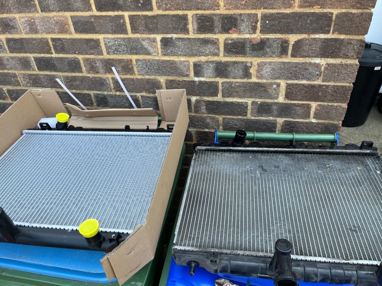

At least ECP’s supplied rad is exactly the same. So I thought. Pipe stubs same places, filler same place and size.
Fan mounts 3mm wider apart on new one.

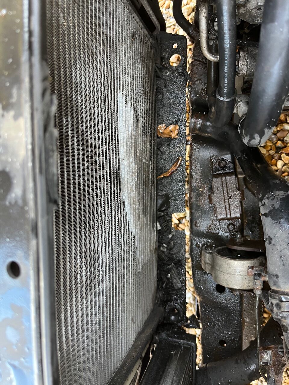

Looking inside the cavity the air con condenser has taken a right hammering. However as the aircon does sort of work I doubt it’s leaking, just needs a recharge.

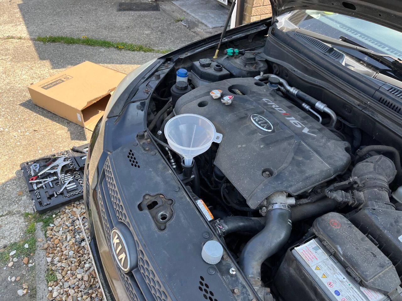

Refitting is blah blah. I spent more time with hose clips that hoiking the old one out and the new one in. I need to get some new mounting bobbins for the top as one is so badly perished it allows the rad to slop.
Filled up with Prestone’s universal stuff. I have no idea what colour was in it before as what came out was pretty much water.
A 20 minute blat around Bognor and all seems good. Heater is toasty hot, and no apparent leaks after the drive so I threw a bucket of water over it. And also the Hyundai.

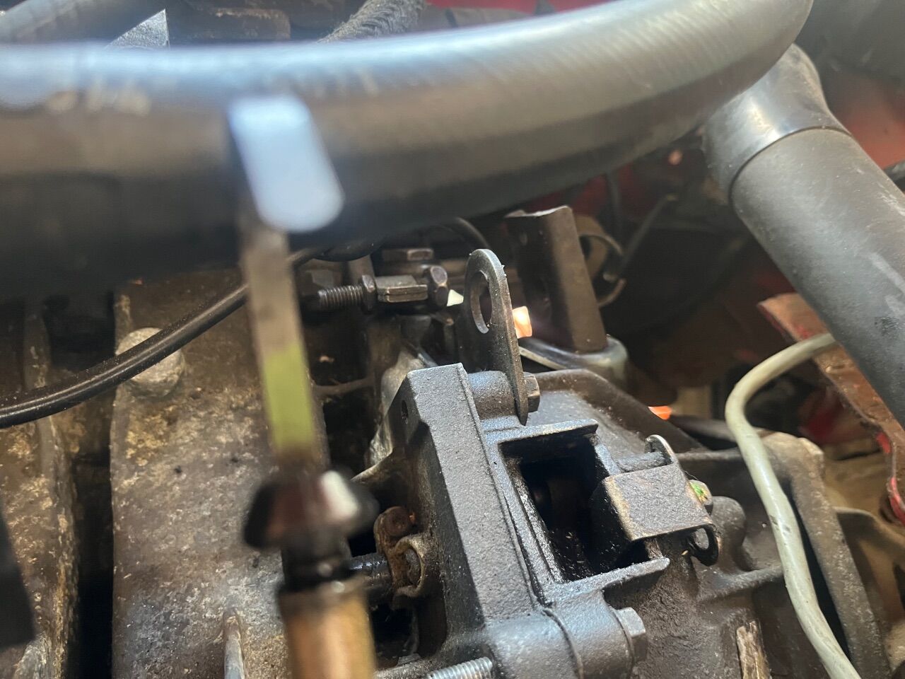

Given the snapped clutch cable earlier this week, my hand has been forced. I was hoping to limp this until payday and get a garage to do the works but I may as well save a few quid.
I have parts and the obligatory book of incorrect proveedings.
Herein lies the main problem and not just a snapped cable.
