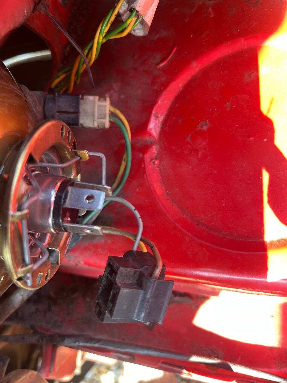

I noticed the headlamp aim on the driver’s headlamp on the 205 was dreadful, so I went about looking at why.
The clip hooks being bent flat against the mounting flange might have had something to do with it. Bulb was, in my late grandfather’s words, slopping around like a turd in a piss-pot.
A pair of pliers and we have a fix. Free fixes are the best.
Bulb is secure, so I reinstalled its rubber gaiter and reconnected the plug. And it works. Pattern looks ok but I may go and get it checked on a beamsetter.

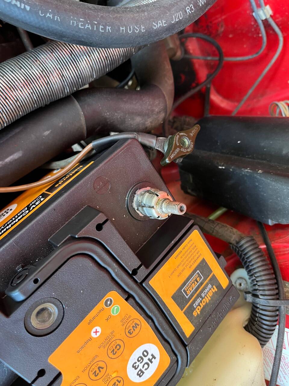

Next I noticed the spin-off negative terminal was loose. Freed off the big wing nut and crimped the spindly onto the battery terminal as best I could with a totally* suitable* pair of pump pliers.
It’s not perfect but it’s no longer loose. I seem to remember there should be a second part which squeezes the 'jaws' into the battery post.

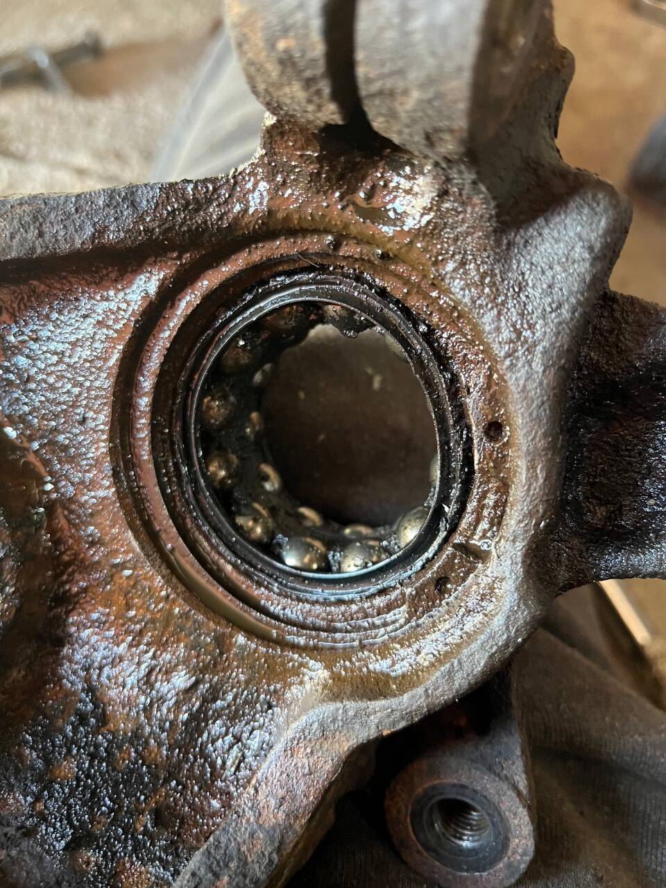

I decided that I would tackle the grumbly wheel bearing today.
Hub came out easily enough but had the inner race attached to it, I should be able to get that off easily enough, even if I have to cut it.
To get the hub carrier off I needed to remove the entire strut. 37 years in place nothing wanted to play ball, thank goodness for plusgas and ugga-dugga gun.
When I managed to get the hub out, the circlip was firmly rusted into place.
Turned it over and all the bearings fell out!
Judicial use of a punch and eventually it pinged out.
Trouble is I’m now left with a seized in place outer race, and my bearing extractor can’t move it. Also the best part of an hour trying to drift it out had no success, so have left it at that for today.
There are a number of engineering firms locally, I’ll see of one of them fancies trying to press it out for a few beer tokens, else I’ll be ordering a new one from Germany for ££££
Found a new hub carrier on eBay for around £40 delivered from Europe. Ordered it but I’ll still see if a garage can press out the old outer race, otherwise I’ll have to cancel the carb tweak booking for the morning.

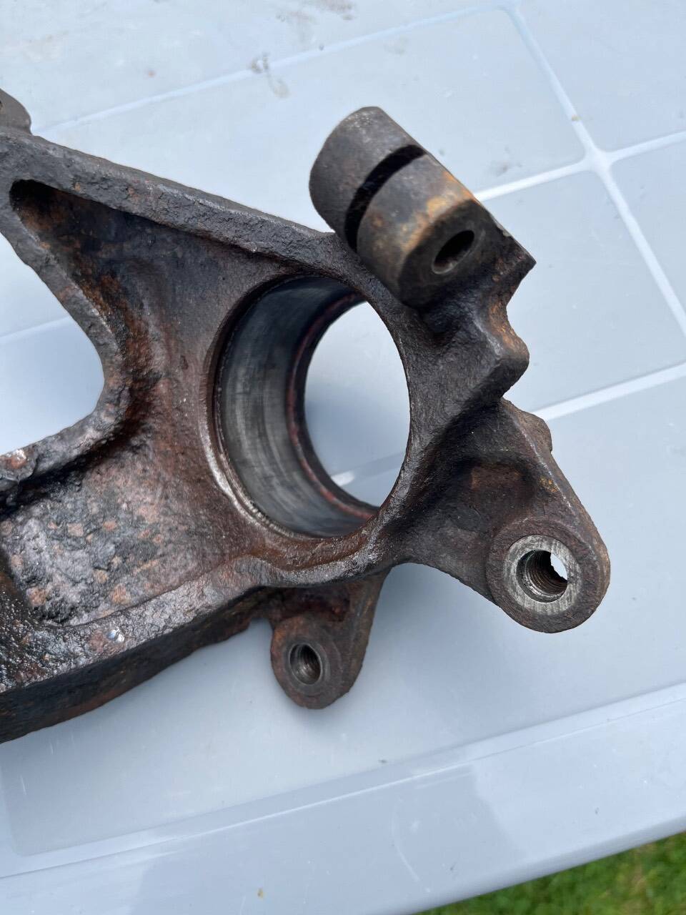

My hub carrier order got cancelled so I took this to the garage where it is booked for a carb tune tomorrow.
nearly 5 tonnes pressure before the old shell gave way. The guys there were appreciative for a little toward their tea fund and a case of beer to share with the footy this afternoon.

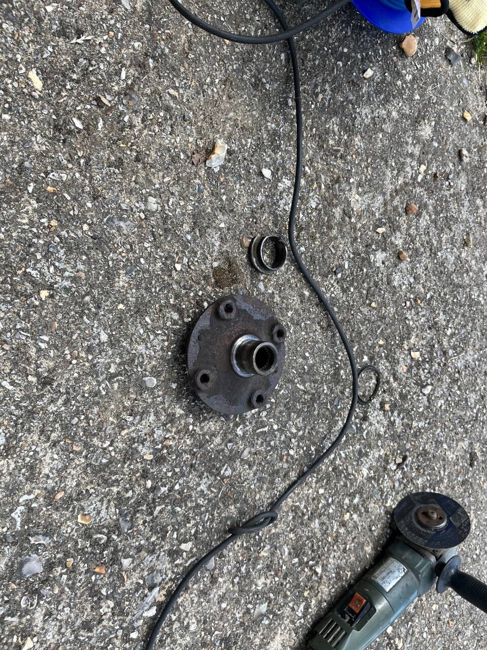

Managed to cut the old inner race off without causing too much damage to the hub.

I really should have bunged the garage an extra few quid to press it in. The roadside face of these carriers isn’t parallel to the road surface, it angles out a bit. Getting the bearing sleeve kit to centre properly was a ballache, and the roller bearing which you drive down on didn’t last a few turns so I mangled a few washers in the process, even using hand tools. I had to gently drive the bearing in with a hammer and one of the plates from the kit to get it started square.

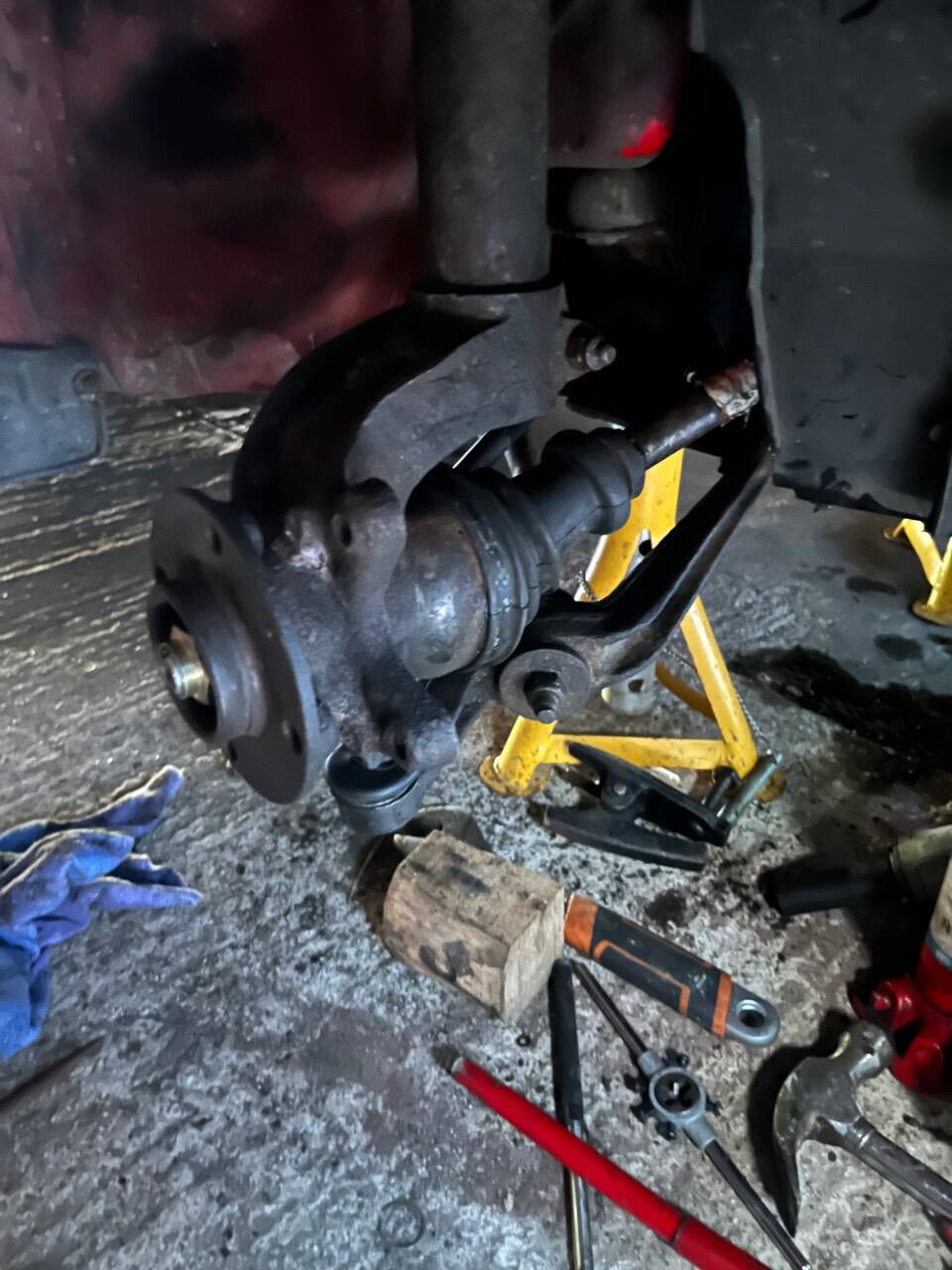

I’ve wrestled for an hour trying to get the bottom ball joint in the hub carrier. Calling it a day at that. Strut is in with the hub carrier attached, driveshaft stub is in and hubnut on loosely. I just cannot make the lower arm drop enough to get the taper in!
Got to pick the Mrs up now so I’ll try and complete this tomorrow. I may need some skilful use of bottle/trolley jack to push the strut up….
I’m absolutely at my wit’s end trying to get this bottom ball joint back in. I’ve managed to mangle the dust cover, and The nut holding the lower arm to the anti roll bar is jammed on, so I can’t even follow the method in the HBOL.
I have a feeling I’ll be dismantling everything again shortly.
  • Sad 2
Not teaching you to suck eggs, but have you got both sides jacked up?  If so, the opposite side suspension should drop, and the ARB will pull the lower arm down.
Good point well made. No the N/S is on the deck. Rather than tempt fate I’ll install the new dust cover for the balljoint before I try again, they won’t be here til this afternoon at the earliest so I will mow the lawn while I wait.
It did come apart that way without too much of a struggle and I have done suspension work just one side at a time with the other wheel on the deck with no trouble getting things back in the past.
New dust boot is on. Getting the retaining rings back into place was a real faff with my huge sausage fingers.
However it doesn’t matter in which configuration I put things back together I cannot get it all assembled as one unit, the bottom joint pin circumnavigates the hole it’s supposed to go in but no amount of whatever will get it back. Hub on the strut or off, I still cannot get the bottom arm low enough to engage.
I’ve got the other side off the deck and both suspension arms are now at the bottom of their travel. The ARB nut won’t undo fully, so I can’t get the bottom arm off no matter what I do. Being an 18mm across-flats nut I don’t have an impact socket for the ugga-dugga machine. I just ordered a set a coil spring compressors from Screwfix, hopefully relieving some of the spring pressure will allow for a bit more room to manoeuvre and get things lined up. I need to do the front springs on the Kia at some point so I’m not getting them just for this job, plus I may need to change the top mounts on this at some point.

While waiting for someone to return home so I can use an car I disconnected the other end of the lower arm. I can get the balljoint a tad lower but not low enough, and the other end fouls against the driveshaft. Still no joy in getting the ARB nut on the lower arm to unwind any further, and being an M11 thread I can’t split it off and wind on a new one, as not a common size and there are no old fashioned ironmongers around any more who would stock such a thing, so would be mail order only and more delays. Could recut down to M10 but that would entail even more ballache.

Update. Bottom pin is in at last. A little spring compression and fannying around with various mounting points, plus the assistance of a long lever got it in.
However in trying to put the track rod end back in the thread has a collapse on it. Also the TRE is seized into the inner.  I can get a whole new inner and outer track rod + bellows for around 40 quid, but Imve had another expensive month and don’t have much spare cash (I get paid mid-month, which has both advantages and disadvantages.
I did try running my M10 die over the taper thread but it jammed and the ball joint just spun round. Popping over to a friend’s as he has a threading file and a thread recutter I can borrow, hoping this will be enough just the get the nut back on.
