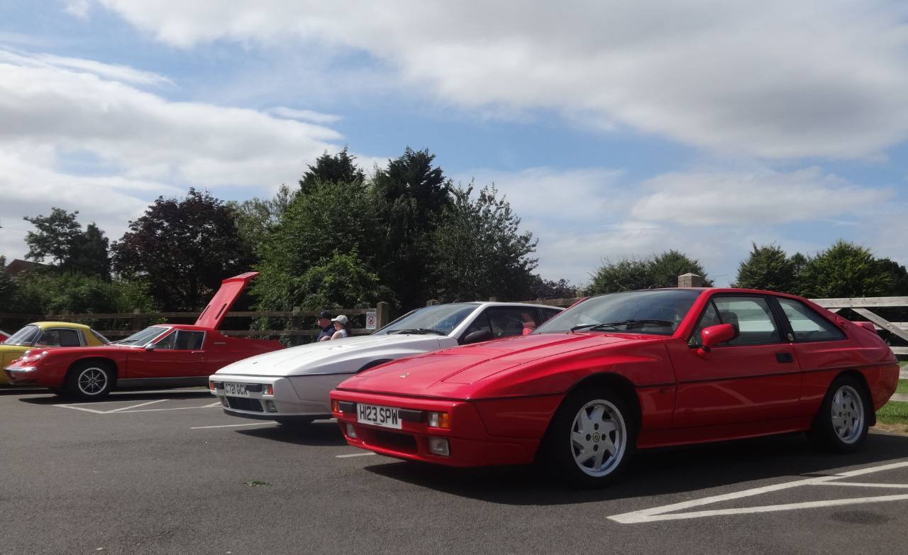

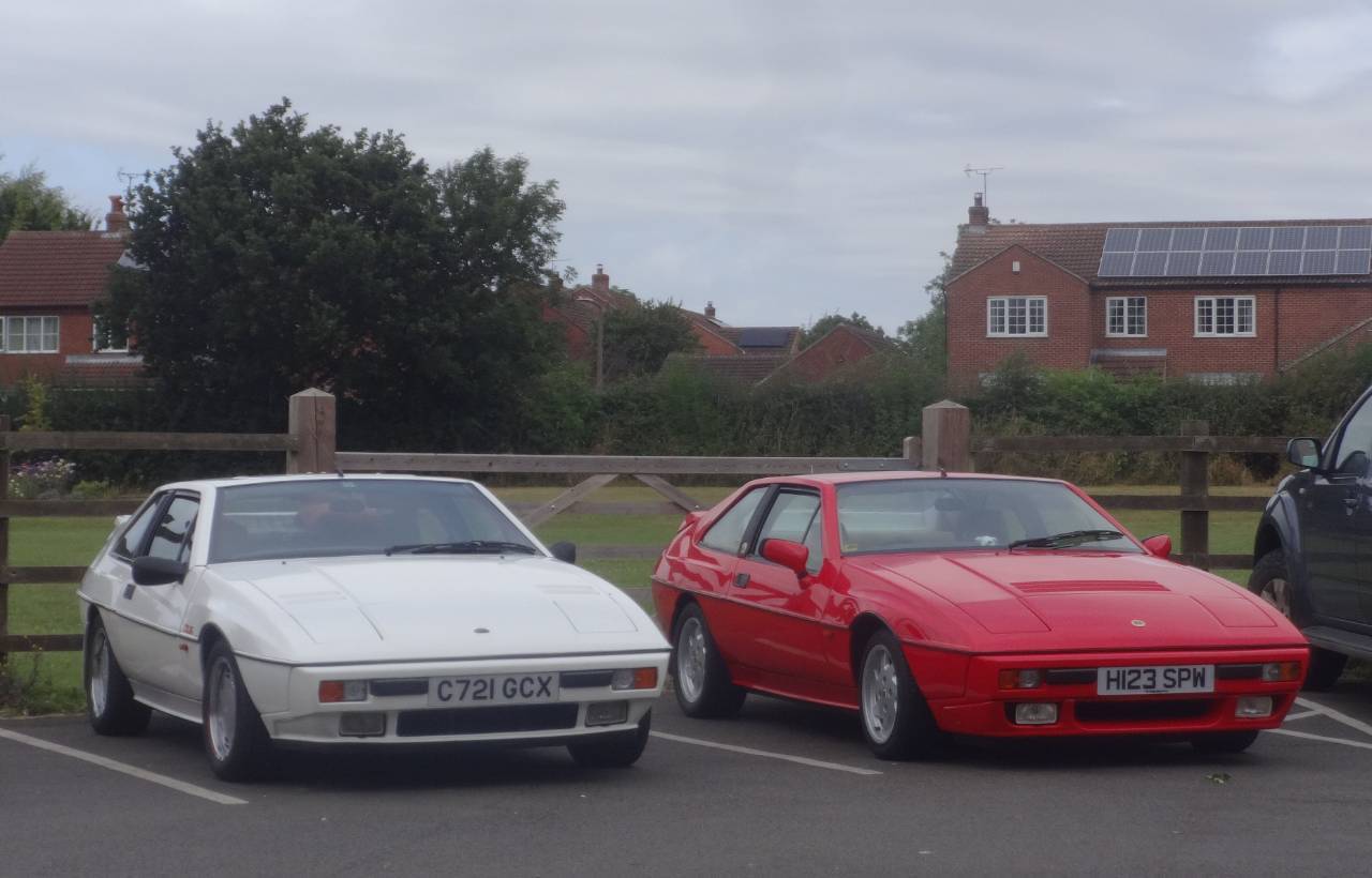

Meanwhile some more whoring/motivational photos from last weekend's meet.
image.jpeg.e5b16beb5640989b631bfd3d2739ad22.jpegimage.jpeg.eea75e4f96f3d102596488edee8e6bae.jpeg
