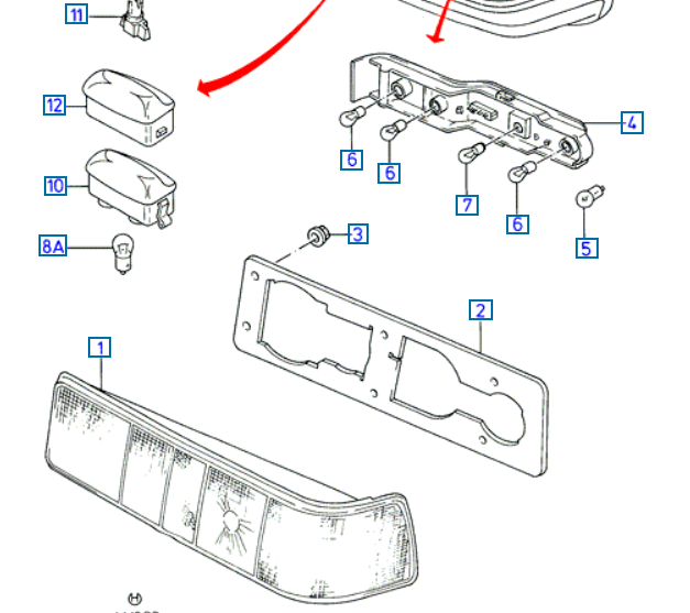

I think the lamp part number is 6157282 as listed here - 4 door saloon, LHS, pre-1990
Now, Classic parts shack has one where they have listed the part number as above - but describe it as hatch. Are they wrong or am I wrong?
https://www.classicpartsshack.co.uk/store/p4223/Ford_Sierra_Mk2_Rear_LHS_Light_Hatchback_Used_Light_Scratches__6157282_87BG-13A603-AA_Genuine_Ford.html
Thank you for looking this up.
I've taken a photo of the part number from my tail light.
That's the same number as the one listed on the advert: 87BG-13A603-AA
However, I wonder whether that number relates to the inner grey coloured element and this part of the number: 6157282 relates to the outer lens, which is different on a hatchback?
Yes, that seems right and explains things - is that grey plastic the bulb holder which appears common to both saloon and hatch then? Part 4 here...

I have had a quick look on Microcat (Fords parts system) the part number I am getting for the outer LH side lens for a sapphire is 6177669, hope that helps.
I think one of the local motorfactors has one on the shelf. He did have a set of hatchback ones which ended up on the bASe a few years ago. I'll make enquiries.
That would be great, thank you.
A search for 6177669 brings up facelift spec tail lights, like these:
Sorry about that you had the right number to start with - 6157282, there are rather more options than I expected, I should have googled the part numbers afterward!

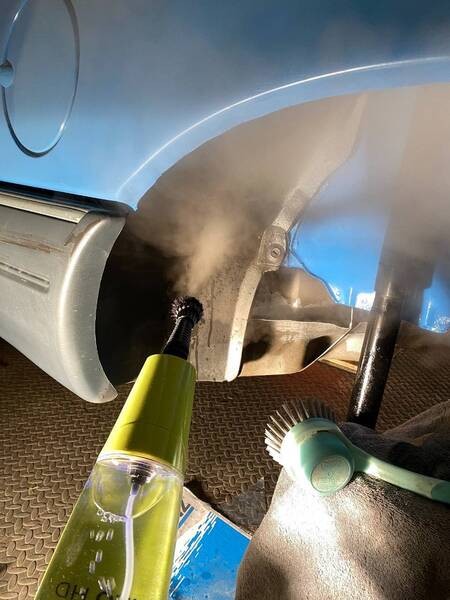

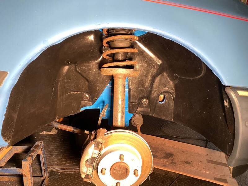

I borrowed my wife's floor steam cleaner, which has a small brush adaptor that is just right for cleaning Sierra wheel arch liners.
Great tool. No noise, no mess, just steam that goes straight onto the desired surface. I could see brown water dripping down the liners, the steam managed to remove 95% of dirt.
The liners were clean but not shiny enough for me, so I gave them a wipe over with a tiny bit of this stuff.
The results speak for themselves.
I can relax now, knowing that when I drive the Sierra down the road, the wheel arch liners that are hidden behind the wheels, which no one will see, are now nice and clean.

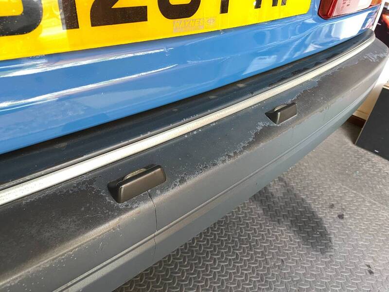

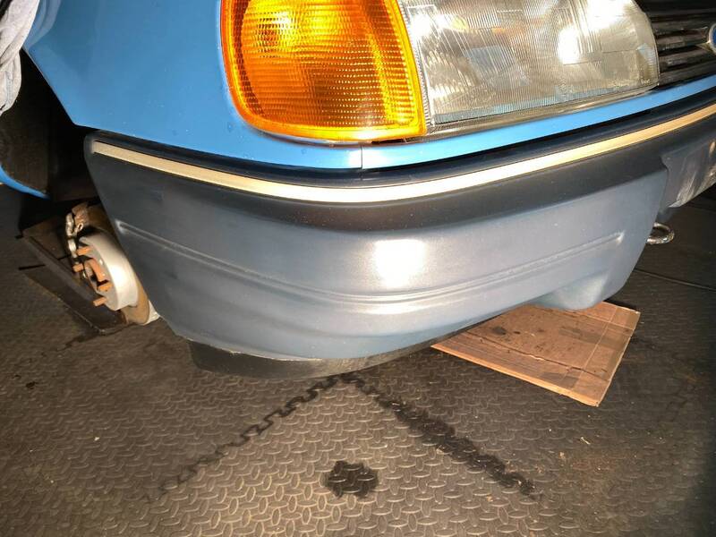

The rear bumper is fucked. The greyish blueish paint coatings are peeling, it has numerous scratches and two vertical cracks in-line with the number plate lights. Some of the scratches are very deep.

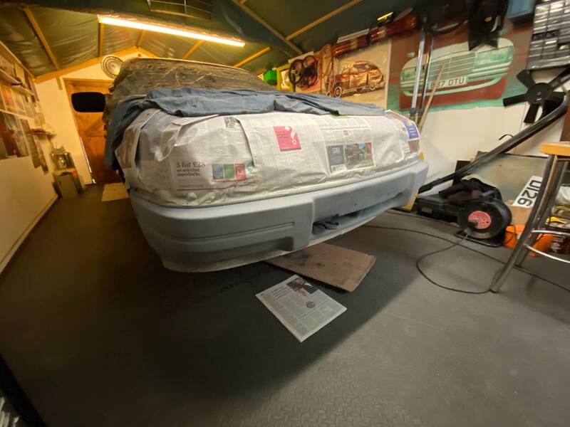

I rubbed the heavily scratched areas with 120 grade paper, in a circular motion, which got rid off the worst imperfections. I prepared and cleaned the bumper and masked it off.
And gave it a coat of primer.

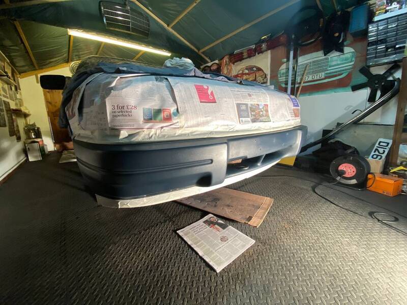

The bumpers are not black and I have acquired an aerosol can of gloss black. On the basis that I have to fix the rear bumper, consequently I also have to do the front one.
I cleaned the front bumper and masked it off. The top section of the bumper is black and mostly ok so it will not be re-sprayed.
I will leave the primer to dry overnight and spray the bumpers black in the morning.

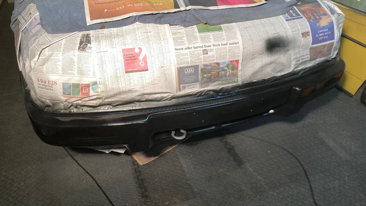

I sprayed the front bumper first. I applied a thin first coat to cover the primer, then a couple more coats for a deeper finish. I was going to give it another coat but already I was pleased with the result.

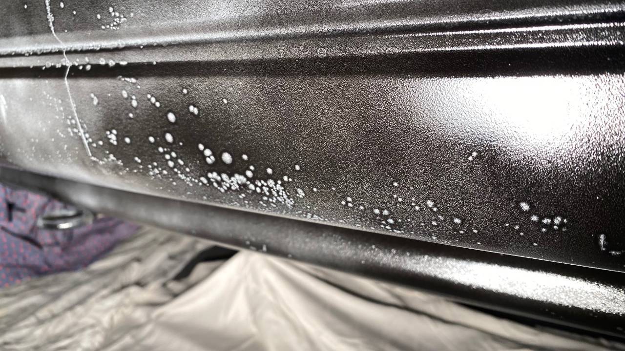

Then I started to do the same on the rear bumper.
And immediately I got this.
Why?
The primer adhered to the bumper just fine, there was no evidence of any incompatibility or contamination issues.
The primer had more time to dry on the rear bumper than the front, by approx two hours.
The primer is acrylic based, so is the paint, both came from Halfords.
The workshop stayed warm and dry since the primer was applied.
Why did the process work on the front bumper but not the rear one?
I've locked the workshop doors for today. I will let the paint dry until I have time to rub down the entire rear bumper, preferably back to plastic and start all over again.
Bugger.
