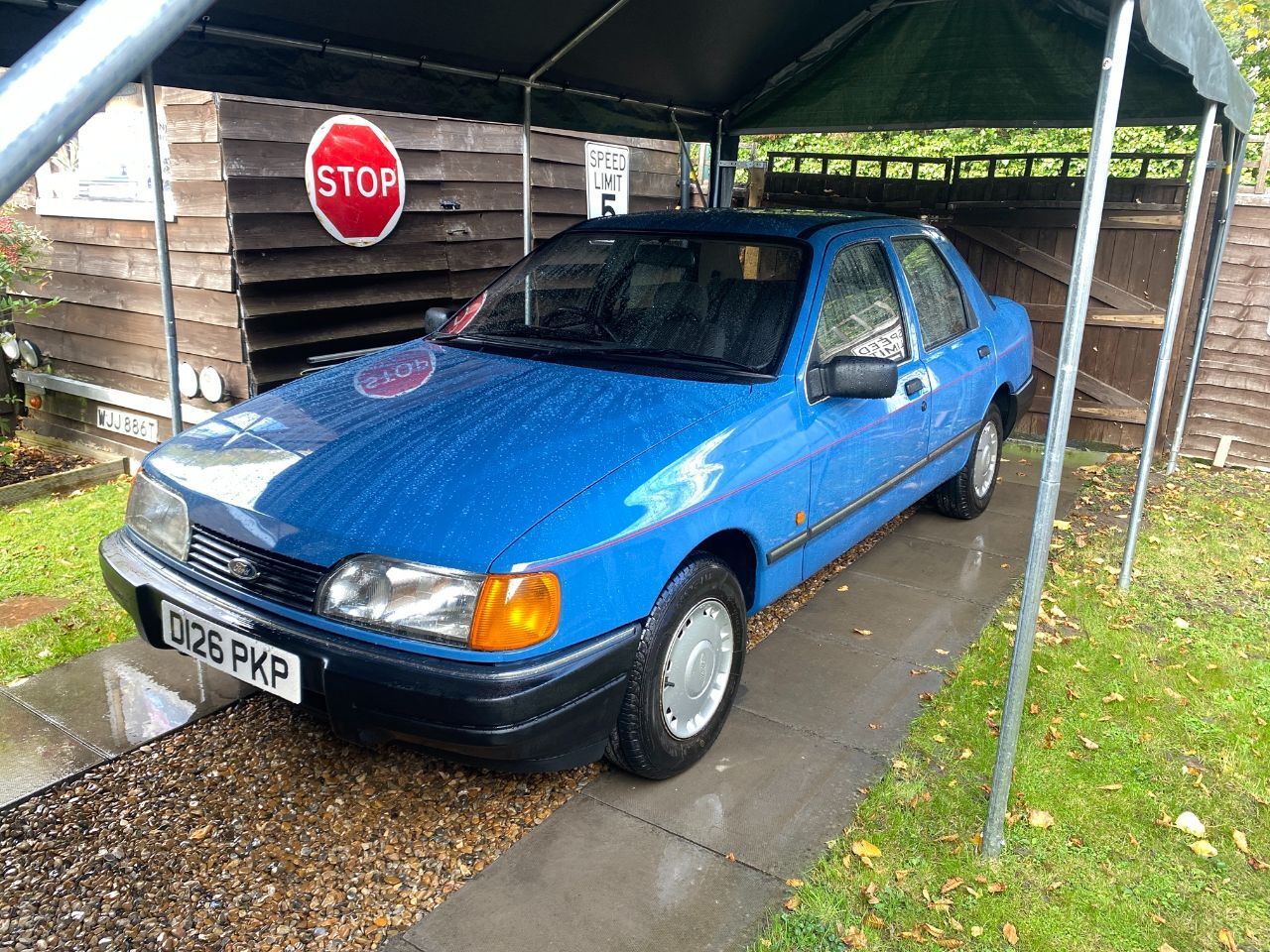

Overdue update on the Sierra. Admittedly, I haven't done anything to it for months and I've only driven it a couple of times.

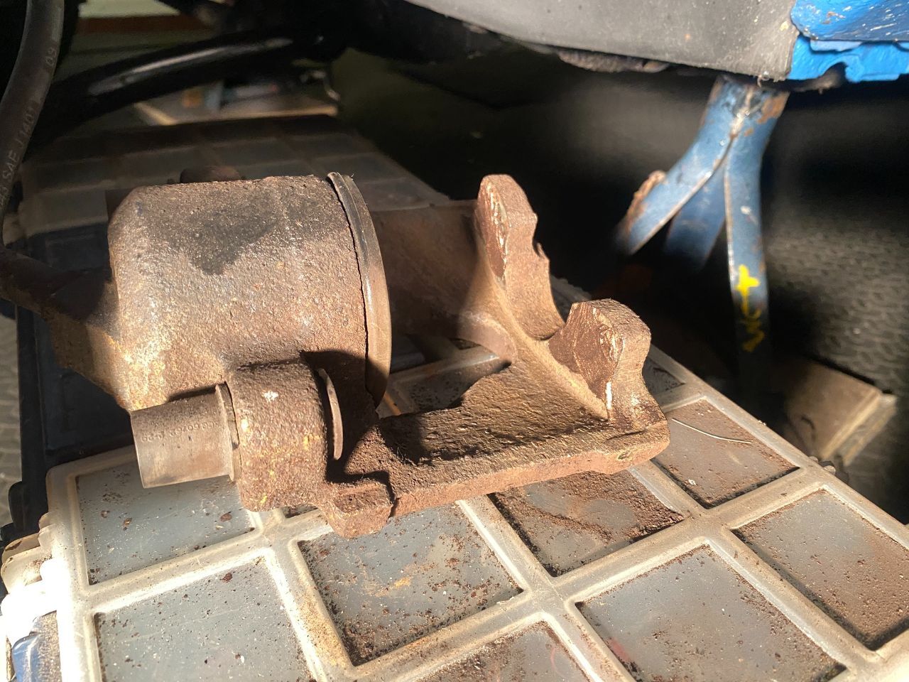

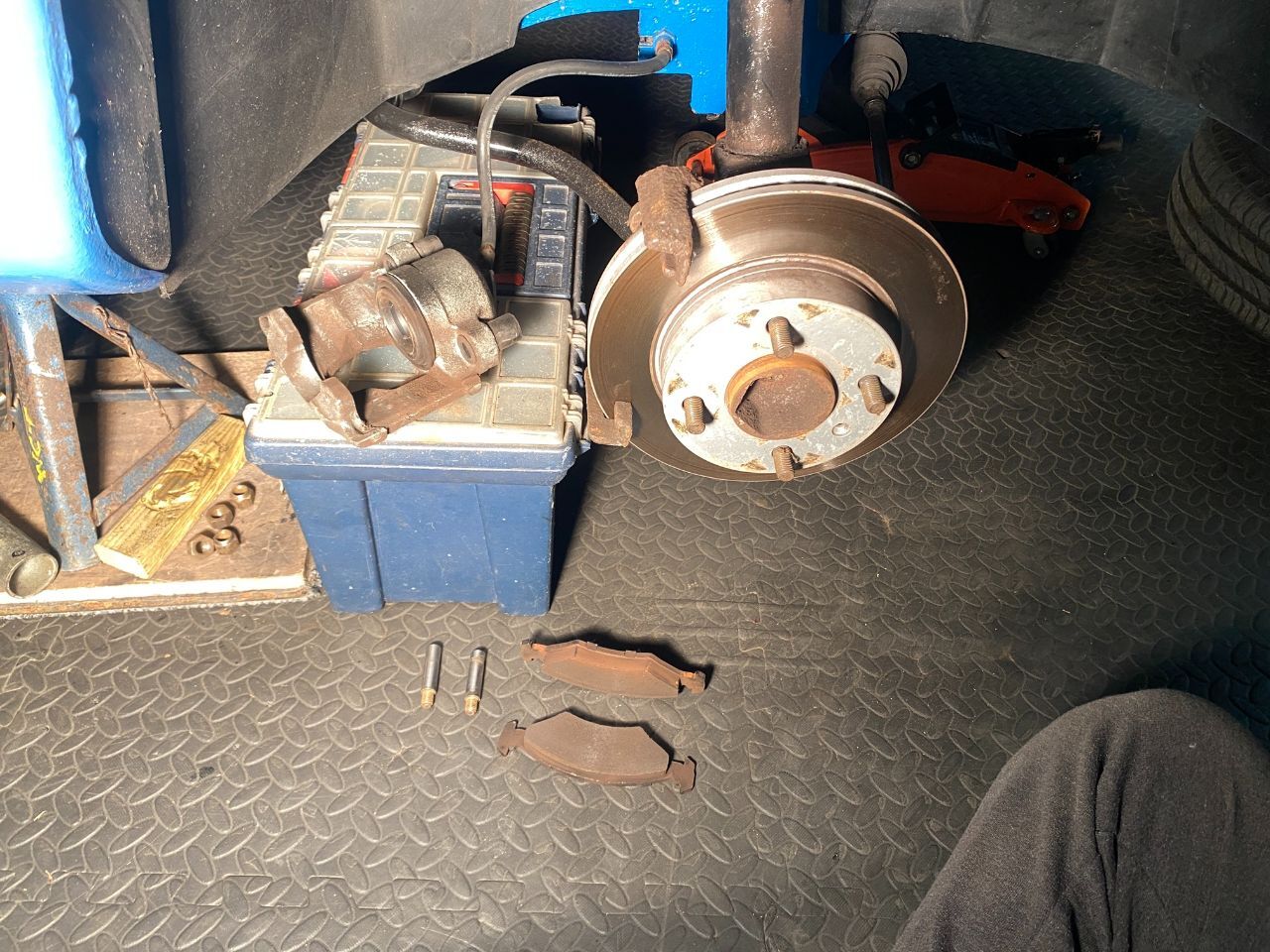

Recently, I've noticed significant brake judder. Lack of use?

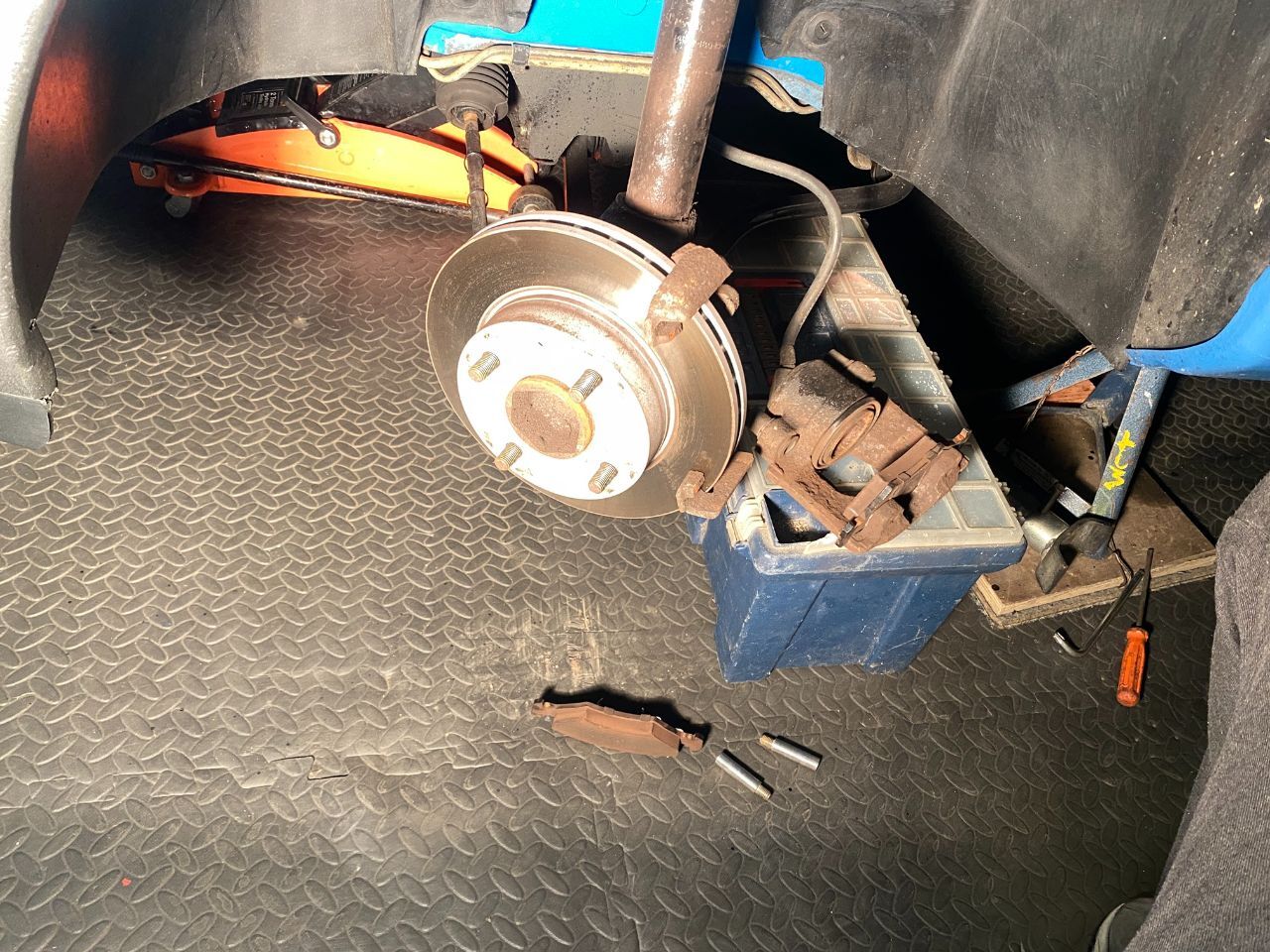

I checked on the front brakes.

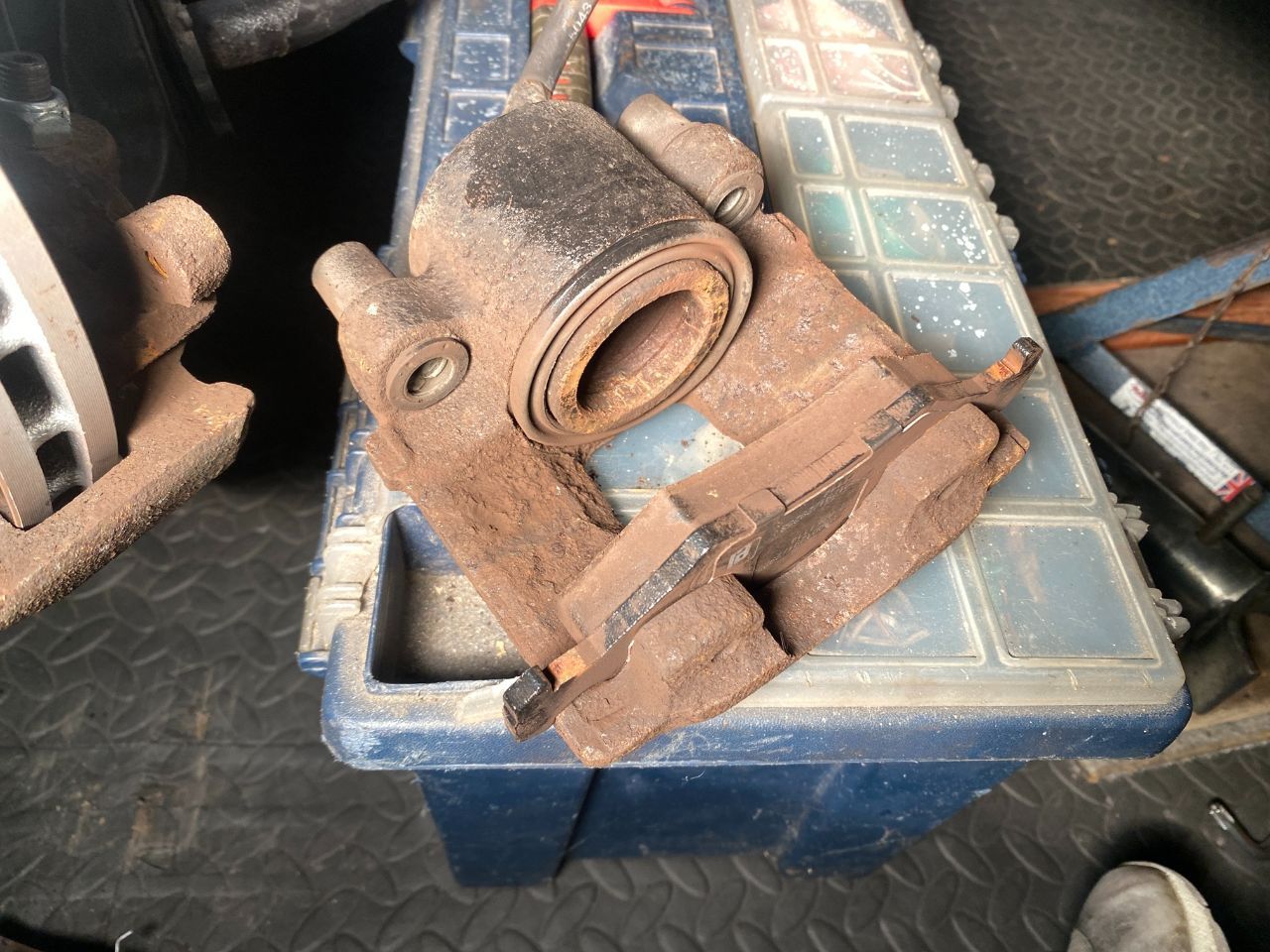

Everything looked on the offside. The disc looks like new, ditto the pads. The caliper looks like it's been refurbished.
On the nearside, things weren't as good.
The disc and pads looked ok....
But the caliper was rusty and the outer pad was stuck solid to the caliper.
I hammered the pad off and cleaned up the caliper. I smeared on plenty of copper grease too.
Has this fixed the problem? Read on.

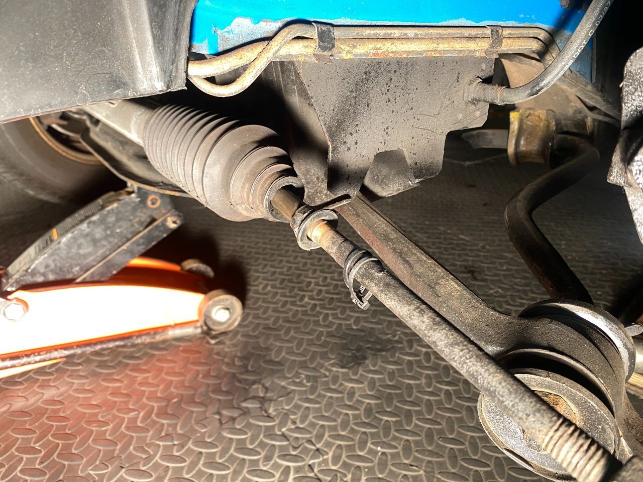

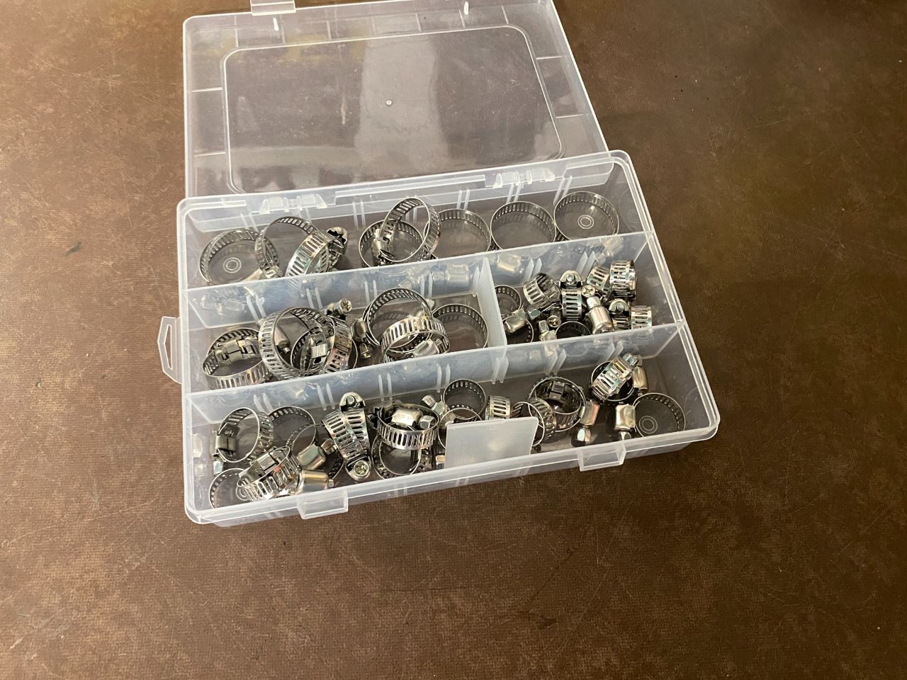

Next, I sorted out the weathered steering rack gaiters. Cable ties weren't doing the job.
My wife bought me a surprise present from Temu, a boxful of jubilee clips, all for £1. They're quality, as you expect.
Job done.

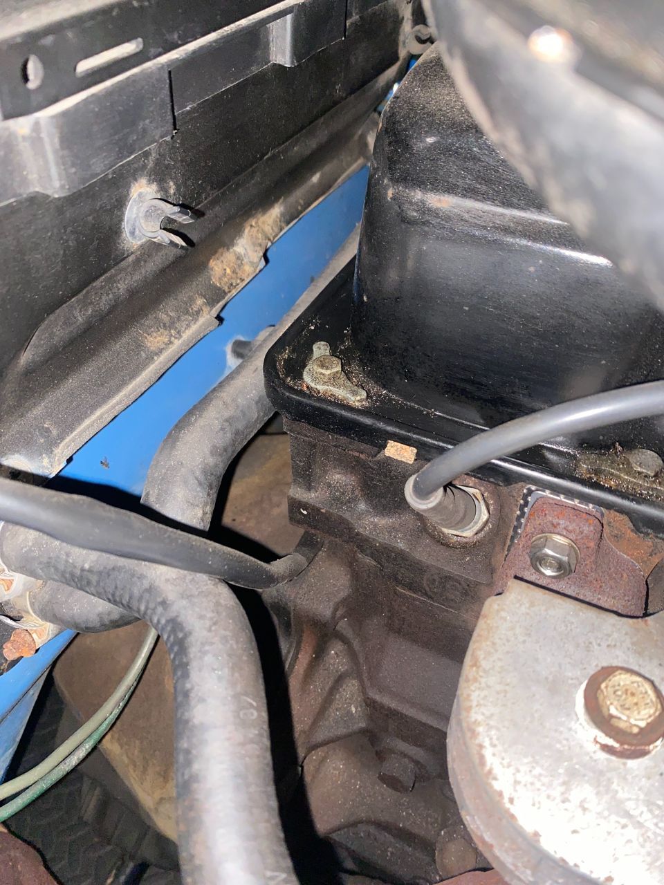

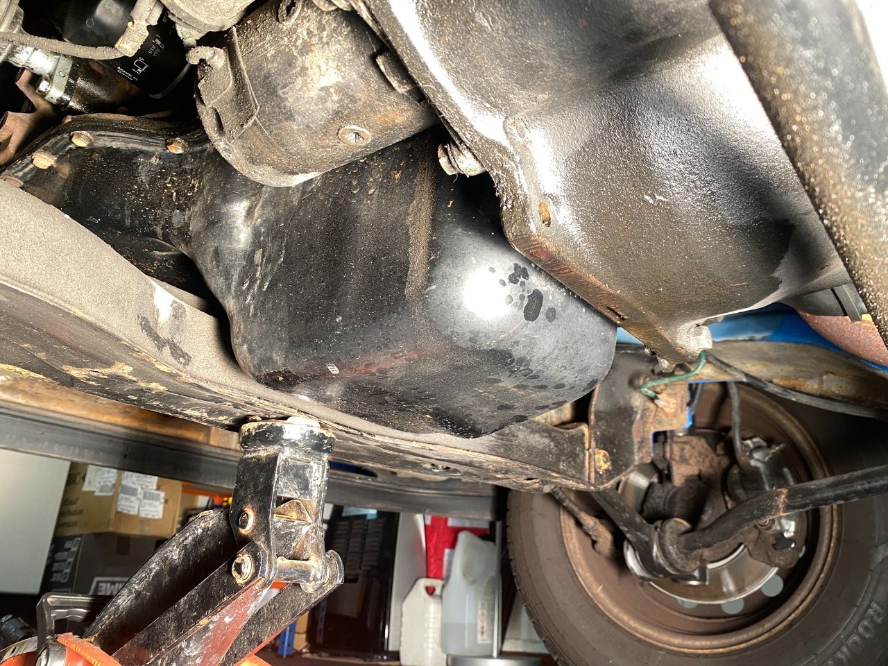

The main issue with the Sierra is a leaking engine rear crank oil seal. Oil is slowly dripping between the engine and bellhousing.
It's all dry above, so it must be the crank seal.
This is a gearbox off job. According to Google, the Type 9 gearbox weights 39kg. When I was much younger, I removed a Sierra's gearbox on my driveway, with nothing more than a mate to help out. I'm not feeling that confident now and need to think twice how to tackle this job.
Ideally, whilst the gearbox is off, I would like to replace the leaking seal, the whole clutch assembly, clean the inside of the bellhousing, clean the gearbox and replace the gearbox oil. I can see a garage charging me £300-£400 for the labour, if I can't do it myself.

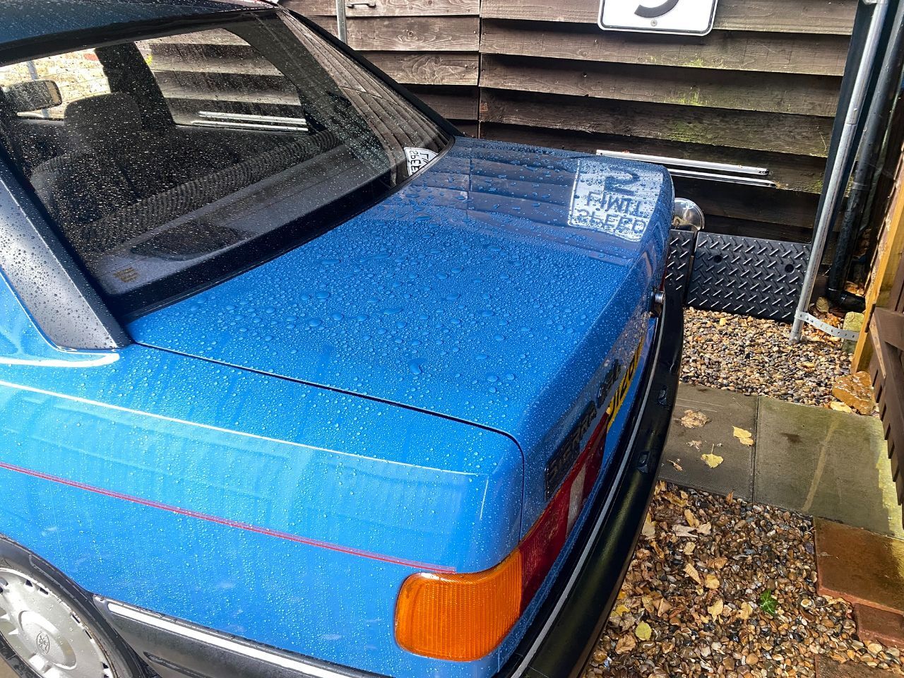

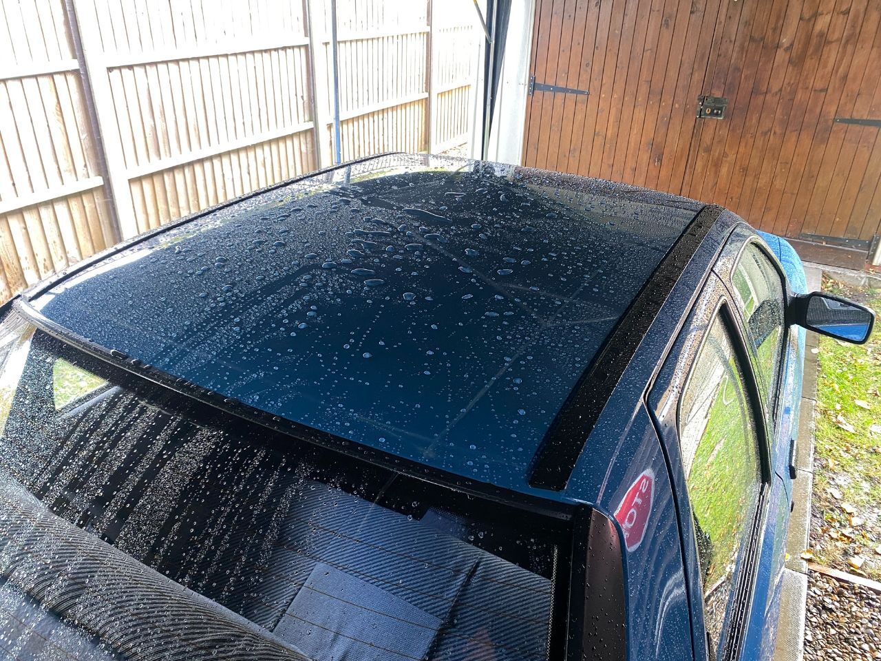

The Sierra was parked in the workshop whilst I was cutting bits of MDF and plywood, which formed part of the MGB's ICE install. Consequently, it got covered with dust and needed a good wash.
Plenty of beading confirms that the Autoglym polishes are doing their job.
Drying off.
And dry, ready for a test drive.
I went for a drive up and down the M40 and on route home tried the brakes properly. No change, I'm still getting judder.
On the basis that a pair of new discs cost peanuts and are piss easy to change, I reckon I should do that first. Anyone got any better ideas?
For now, the Sierra is back in the garage.

Caliper piston sticking? Caliper slider pins sliding freely?
You haven’t lost a balance weight from the front wheels?

Also, is the brake pad actually sitting fully and squarely in its carrier?
I’ve seen that before where the pad was a very tight fit in the carrier which stopped it moving properly. Pretty much uneven pressure against the disc.
Sometimes filing out the dust and rust from the carrier and the thick paint off the contact points of the pad is sufficient to fix it.
On the nearside, the outer pad was stuck to the caliper and needed removing with a hammer. I removed the rust and coated contact points with copper grease but the problem persists.
Crank end seal? TADTS. I’d leave it until the clutch starts juddering badly. Ford seem spectacularly useless at making the seal as it’s been a problem on most Fords over the years
One of my old smiley Transits used to do it. It was ok for a while, then started to contaminate the clutch so pulling away needed a whole lot of flooring !😄
I just ignored it given the effort required to repair it! Eventually sold the van and they did the same thing.

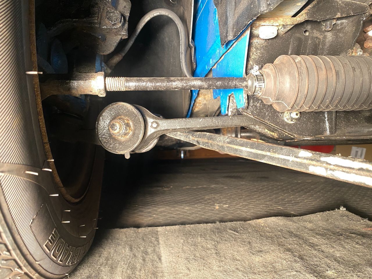

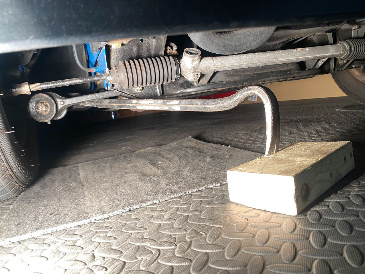

Before lifting the front end, I used a crowbar to assess the condition of the track control arm bushes.
This is with no leverage applied.
This is with leverage applied and a bit of 2x4 wedged under the crowbar, to enable me to take the photograph.

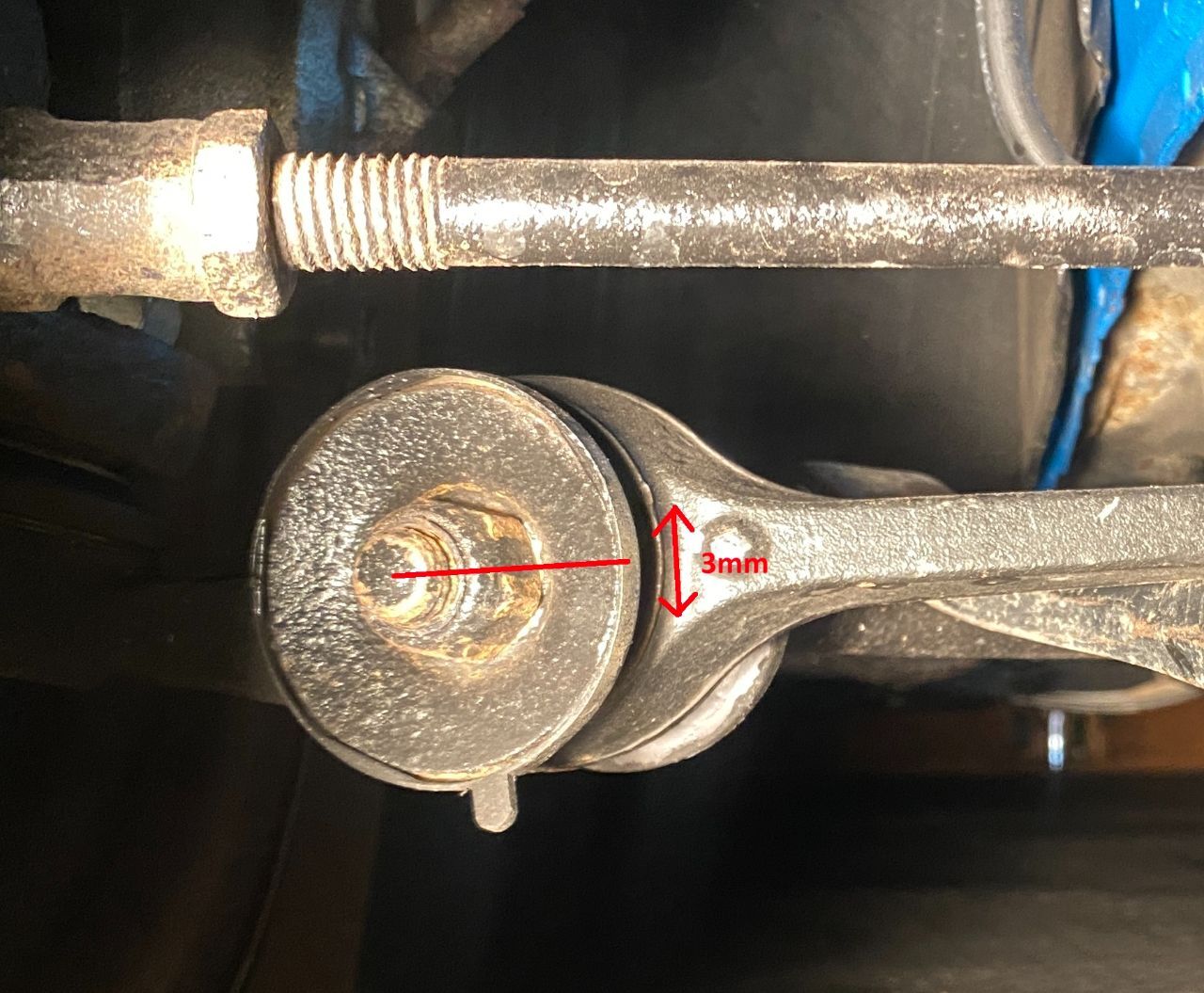

On both sides, with leverage applied, there is approx 3mm of vertical movement within the bush before the track control arm lifts up.
I guess that's bad?
I fitted new track control arms last June but they were cheap eBay, most probably made in China jobbies and chances are they were shit.
A look on eBay revealed that polyurethane bushes are only available for Cosworth and XR models, not a lowly 1.8L.
https://www.ebay.co.uk/sch/i.html?_nkw=sierra+track+control+arms+bushes&_sacat=0&_from=R40&_trksid=m570.l1313&_odkw=sierra+track+control+arms+&_osacat=0
If I opt for rubber bushes, I can either go for complete track control arms or just replacement bushes. I guess replacing the bushes without special tools is going to be a complete nightmare?
@Snipes asked whether I am feeling the judder through the steering wheel or the brake pedal. Am I right that I would be feeling judder via the brake pedal if the brakes were bad and through the steering wheel if there was an issue with the suspension? Or is that too obvious?
Aside from the judder, the brakes work perfectly. They don't bind, pull or squeal and judging by appearances, the discs and pads really do look almost new.
What do I do? Help me out here guys.

I fitted PU bushes to mine and they basically lasted for ever.  I should think that you'd be able to get them from somewhere.   Not sure if they are really different in Cosworths or others, perhaps you'd be best speaking to someone who makes them.
Normal bushes will be easy enough to fit.  The original type just tap in and the so called heavy duty ones are sort of squashed in.
  • Agree 1
1 minute ago, Peter C said:
@lisbon_road
Based on the above, would you say that mine need replacing?
Probably.  I'd take the nut and washer off and see what they look like.
As @lisbon_road said. Whip the nut & washer and see if the rubber is distorted or perished. Some modern rubber is absolutely crap and does fall to bits and fail quickly.
You can get the Polyurethane bush replacements for other Fords that use that style arms (like the Capri) so as long as you find bushes with the right size hole/diameter you should be good.
Some polyurethane bushes are meant for performance and track use though so watch out which grade you buy. The performance ones are much tighter and have much less compliance.
https://www.burtonpower.com/parts-by-category/steering-suspension/bushes-polyurethane/ford-sierra-bushes-polyurethane.html?srsltid=AfmBOooR8s2DeeCxMrWvoXB6YA3QYwn4f5_GmkFy2pelUnkDDOO2Zkoy
Says ‘all Sierra’s including Cosworth’ on that site.
