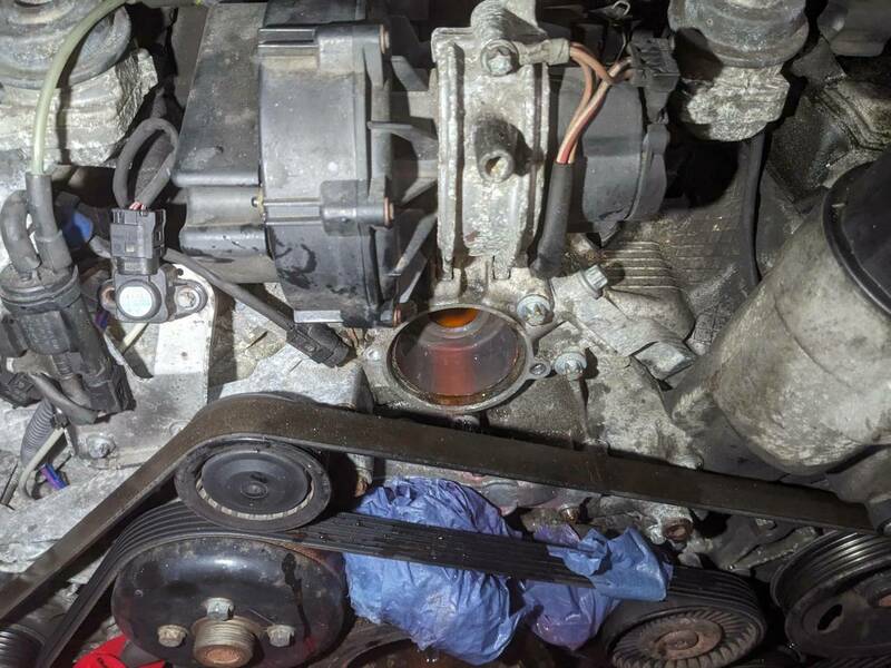

SiC Posted November 7, 2023 Author Posted November 7, 2023 Picked up the thermostat from the local car part shop earlier. Quality is okay. Not fabulous but not terrible. Spotted this fire hazard in the car park. Bit of a heap if I'm honest. Fair play driving that in this mixed weather though. Upon arriving home and parking up, I realised that the TT and E-class are nearly the same colour. I'm bit bored of blue cars but I seem to keep buying them! Hose clamp pliers delivered by one of Bezos finest. Set to work. First off clamping the pipes to minimise loss. Top hose came off without loosing too much. Pushed it out of the way and kept it high to stop the rad draining. The stiff thermostat bolt was pretty filthy. Also had a weird chunk out of the thread. I cleaned this up with a wire brush. Thermostat came off okay. There is a handy flat section on the housing to allow easy prying without risking damaging any machined mating surfaces. Wire brushed the crud off and fitted the new stat + bolts. Hose on Remove clamps and refill Old stat was a bit cruddy but didn't look too bad as they usually do. Mega, mega easy job. Possibly the easiest 'stat change I've ever done. Cookiesouwest, wesacosa, RayMK and 8 others 11

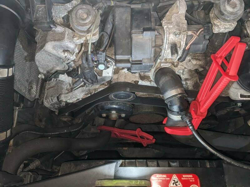

SiC Posted November 7, 2023 Author Posted November 7, 2023 Ran it up to temperature and tried to burp the system. I think these Mercs are good in their design to not get air locks. Certainly didn't notice any major level drops even when up to temperature with the stat open. This is where having a handheld diag tool is invaluable compared to dragging a laptop out. I've got an OBD extender cable somewhere I need to find as this will make bonnet access of the tool even easier. It seemed to peak at around 93 to 94c when revved at which point the engine fan kicked in. Sat there at idle it seemed to sit around 87c to 90c. Gauge is just under the 100c marker now. Went for a test drive on the same route as before. Now not a completely fair test as, even though I had dinner and it cooled off a bit, the car wasn't completely cold as per last time. Also I reset the mpg before setting off this evening as I'd been idling it a long time on the drive. Anyway, unsurprisingly it got far better fuel consumption numbers than before. Engine temperature stayed rock solid on the gauge. Maybe went up or down a notch but barely noticeable. Generally sat as above. Engine temperature on the scantool seemed to be around 87c to 89c which is the stat opening temp. As I was quite warm and comfortable where I was sat, I thought I'd go for a quick spin up and down the motorway. Some of the junctions were shut, so I ended up going much further than initially intended. However it gave a good idea of cruising fuel economy. It was actually hitting 31.8mpg, just I lost a bit when I booted it past a load of bunched up cars/lorries so I could get to the junction exit easily. Considering I got 30.9mpg on the long journey home and certainly never hit 31mpg, I can safely say there is a solid increase in MPG (thankfully). Biggest improvement will hopefully be town/village driving where it should warm up quicker and hold the temperature better. Just need to go on a long run now and see what it really can get. I reckon 35-38mpg is do-able on a 60mph motorway run if I had the patience. Another thing I've found is that the box gear changes are very old fashioned. Most modern gearboxes I'm used to will try kicking up to the highest gear possible at all times. So even at 30mph you find the box in 6th or higher on a modern unit. This however feels like a mechanical unit of old (even though it's fully computer controlled). So at an indicated 30mph cruise it is in 3rd gear and just under 2k rpm). However 31mph (exactly 50kph) it kicks up to 4th gear and 1.1k rpm. It'll stay there until about 27mph and then it'll drop back down again. So certainly careful use of speed when driving should also give quite a boost in fuel economy too. Either way I'm massively happy the consumption has decreased - seems to be a solid 16% decrease for slower speed running. Right now it's not that far off what my very similar bhp Boxster 2.7 6cyl did (albeit that ran on super unleaded and this is regular). If my maths is correct then a 80l full tank fill I'll be saving £19 per tank from the extra range. Basically two tank fulls of non motorway driving will easily pay for that thermostat and the replacement coolant. Cookiesouwest, dome, sdkrc and 18 others 21
purplebargeken Posted November 8, 2023 Posted November 8, 2023 See, told ya it was the thermostat... smug face. SiC and RoverFolkUs 1 1
RoverFolkUs Posted November 8, 2023 Posted November 8, 2023 18 hours ago, SiC said: Ran it up to temperature and tried to burp the system. I think these Mercs are good in their design to not get air locks. Certainly didn't notice any major level drops even when up to temperature with the stat open. This is where having a handheld diag tool is invaluable compared to dragging a laptop out. I've got an OBD extender cable somewhere I need to find as this will make bonnet access of the tool even easier. It seemed to peak at around 93 to 94c when revved at which point the engine fan kicked in. Sat there at idle it seemed to sit around 87c to 90c. Gauge is just under the 100c marker now. Went for a test drive on the same route as before. Now not a completely fair test as, even though I had dinner and it cooled off a bit, the car wasn't completely cold as per last time. Also I reset the mpg before setting off this evening as I'd been idling it a long time on the drive. Anyway, unsurprisingly it got far better fuel consumption numbers than before. Engine temperature stayed rock solid on the gauge. Maybe went up or down a notch but barely noticeable. Generally sat as above. Engine temperature on the scantool seemed to be around 87c to 89c which is the stat opening temp. As I was quite warm and comfortable where I was sat, I thought I'd go for a quick spin up and down the motorway. Some of the junctions were shut, so I ended up going much further than initially intended. However it gave a good idea of cruising fuel economy. It was actually hitting 31.8mpg, just I lost a bit when I booted it past a load of bunched up cars/lorries so I could get to the junction exit easily. Considering I got 30.9mpg on the long journey home and certainly never hit 31mpg, I can safely say there is a solid increase in MPG (thankfully). Biggest improvement will hopefully be town/village driving where it should warm up quicker and hold the temperature better. Just need to go on a long run now and see what it really can get. I reckon 35-38mpg is do-able on a 60mph motorway run if I had the patience. Another thing I've found is that the box gear changes are very old fashioned. Most modern gearboxes I'm used to will try kicking up to the highest gear possible at all times. So even at 30mph you find the box in 6th or higher on a modern unit. This however feels like a mechanical unit of old (even though it's fully computer controlled). So at an indicated 30mph cruise it is in 3rd gear and just under 2k rpm). However 31mph (exactly 50kph) it kicks up to 4th gear and 1.1k rpm. It'll stay there until about 27mph and then it'll drop back down again. So certainly careful use of speed when driving should also give quite a boost in fuel economy too. Either way I'm massively happy the consumption has decreased - seems to be a solid 16% decrease for slower speed running. Right now it's not that far off what my very similar bhp Boxster 2.7 6cyl did (albeit that ran on super unleaded and this is regular). If my maths is correct then a 80l full tank fill I'll be saving £19 per tank from the extra range. Basically two tank fulls of non motorway driving will easily pay for that thermostat and the replacement coolant. Brilliant result, and with the shameless use of hindsight, just what I expected to see 😉 EyesWeldedShut and Twiggy 2
SiC Posted November 8, 2023 Author Posted November 8, 2023 I reckon a good 80% of cars I have bought have required new thermostats not long after buying. From random purchases to even cars I bought off my parents. So much so, Mrs SiC jokes about it. I did want to diagnose it properly with a scantool rather than relying what the gauge was trying to tell me. Most modern temperature gauges like to give an alternative rose tinted view of reality. Which is why I think people always miss that the thermostat is on its way out. Rust Collector 1

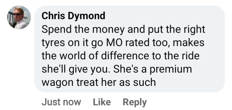

Snake Charmer Posted November 9, 2023 Posted November 9, 2023 I see a debate has started about tyres on Faecesbook! 🤣 Didn’t take long for the MO to be mentioned. SiC 1
SiC Posted November 9, 2023 Author Posted November 9, 2023 For those that aren't on the FB group, I asked if 205/60/16 would fit on my rims as some lower models had them. The current 225/55/16 are harder to get tires for and are a good 30% more expensive over the 205/60/16. I don't even know if MO rated tyres are even still made in this size.
Snake Charmer Posted November 9, 2023 Posted November 9, 2023 Have you looked at prices on Black Circles? Mine came with budget Chinese tyres, luckily fitted in matching pairs on each axle and I was quite surprised at grip levels even in the wet although they would not have been my choice. When they started to get low l fitted the 245/45-18's with a plan on having the 16" wheels refurbished and fitting winter tyres but that went out the window after the accident. I quite liked the Uniroyal Rainsports fitted to our Vectra for the short time before we scrapped it, @Talbot had those off me for his S210.
SiC Posted November 9, 2023 Author Posted November 9, 2023 27 minutes ago, Snake Charmer said: Have you looked at prices on Black Circles? Mine came with budget Chinese tyres, luckily fitted in matching pairs on each axle and I was quite surprised at grip levels even in the wet although they would not have been my choice. When they started to get low l fitted the 245/45-18's with a plan on having the 16" wheels refurbished and fitting winter tyres but that went out the window after the accident. I quite liked the Uniroyal Rainsports fitted to our Vectra for the short time before we scrapped it, @Talbot had those off me for his S210. Blackcircles are my usual go to source for tyres as easy. In February this year I put 4 Uniroyal Rainsports on the TT - 225/40/18 and they were £91.50 a corner (Kwik fit mobile as they were the cheapest). Currently £95.15 a corner on black circles. 225/55/16 in Uniroyal Rainsports on black circles is £119.58 a corner. So these tyres are over £25 more expensive for 16s than the 18s on the TT! 205/60/16 is a more respectable £100.50 a corner. But they're narrower and not sure if they'll fit on my rims. The 17s in 245/45/17 are £143.94 a corner... Tyres seem spectacularly expensive and not a lot of selection for this car. Tomket in 225/55/16 is £73.50 a corner. While they have good reviews on blackcircles from E-class owners, I'm not sure I want to go with a potential Chinese death ring. If I have to suck it up to get decent tyres then I will have to. Just wanted to hunt around first to see if there was a cheaper, safe alternative.

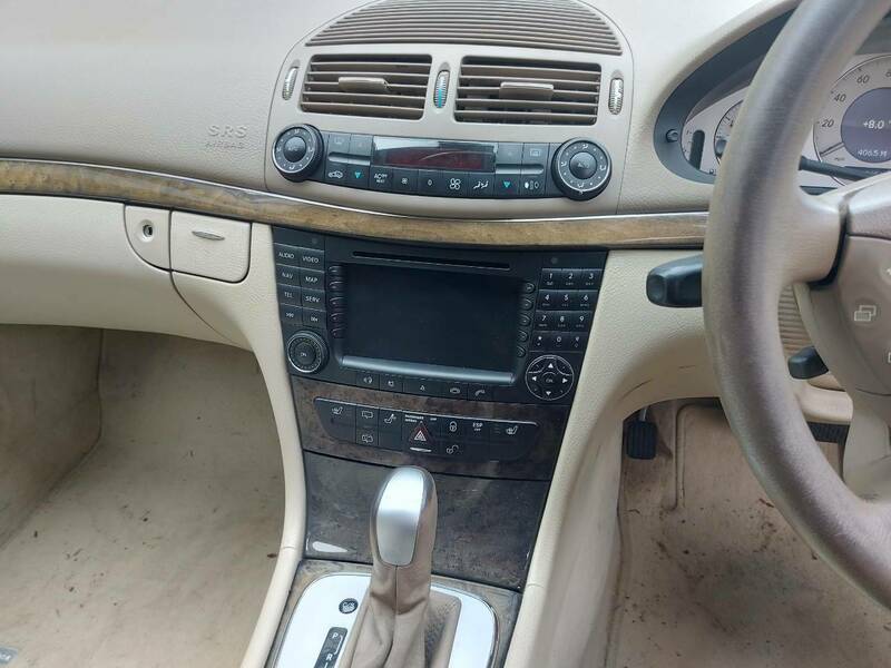

Snake Charmer Posted November 10, 2023 Posted November 10, 2023 Have you used the Satnav in anger yet? I had a look and struggled with it, could not find my work address. I think the disc is 2015.
SiC Posted November 10, 2023 Author Posted November 10, 2023 5 minutes ago, Snake Charmer said: Have you used the Satnav in anger yet? I had a look and struggled with it, could not find my work address. I think the disc is 2015. Haven't even bothered to be honest. There is a firmware disc kicking around labeled 2006, so presumably it's incredibly out of date. I'll have to try it around Bristol and Cabot Circus as that was radically changed by 2008 when it was built. Is there a disc for the satnav system or is it loaded internally in its memory? I haven't looked too hard but I've not seen any additional cd units for the satnav. I did notice the video button allows you to play DVDs! So you can be driving along watching a DVD and holding the inbuilt car phone to your ear. How times have changed - feels as alien to do that as not wearing a seatbelt! I'm tempted to potentially fit one of the many android based carplay/etc units in. Just I know it's going to require a lot of faff getting looms from the front all the way into the boot. Rust Collector and Snake Charmer 2

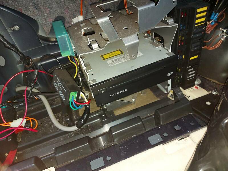

Snake Charmer Posted November 10, 2023 Posted November 10, 2023 Left hand side of the load area next to the rear SAM hides the Nav unit. Disc I have, not very up to date. I may have a solution here. 😉 Beige, I think the same as yours? 🫣 I have an A-Sure Android unit in the other car bought from @Jazoli a while back. Sound quality is not up there with the original unit and can be a bit temperamental but Waze works well and the screen is huge. All the fitting was in dash, nothing in the boot but no Nav on that car. SiC 1
SiC Posted November 10, 2023 Author Posted November 10, 2023 Full nav is a MOST fibre optic setup iirc. Thus kits tap into the boot CAN to avoid having to work over that. To be honest the FM radio reception on the stock unit is fabulous. I can pick up local stations that my other cars can't. Just wished it could easily have Bluetooth hands free retrofitted without spending hundreds. There is MOST Bluetooth modules on eBay but I'm not sure if they can be connected in easily and made work. Possibly though if these NTG2 COMAND units were used when that module existed. I did see the hookie update discs for sale at around the £30 price point. Seems expensive to me for paying someone else to download and burn a dodgy copy. That said, I'm not one for bittorrenting/Usenet/etc anymore. I'll probably let it be for now.
Snake Charmer Posted November 13, 2023 Posted November 13, 2023 I was thinking of Benzninja for a map update but having looked at the system again the latest update seems to be 2019. I will try the A-Sure Android unit first.
