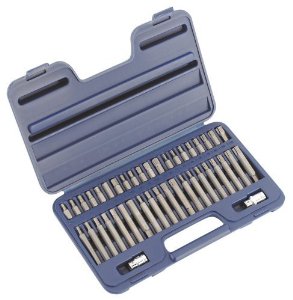

the cheap (£15 ish ) sealey torx/allen/ spline bit kit is great for beating into rounded allen bolts / torxs etc . Cheap enough to be disposable but good enough to do the job . Also can be used to get broken ka spark plugs out too.
Interesting, might need to get some as the Halfords advanced ones I have are crap, I've broken 3 of them.
Pictures / photo please, Shirley .... :)

The sealey torx bits are guaranteed for life as well (apart from one)
