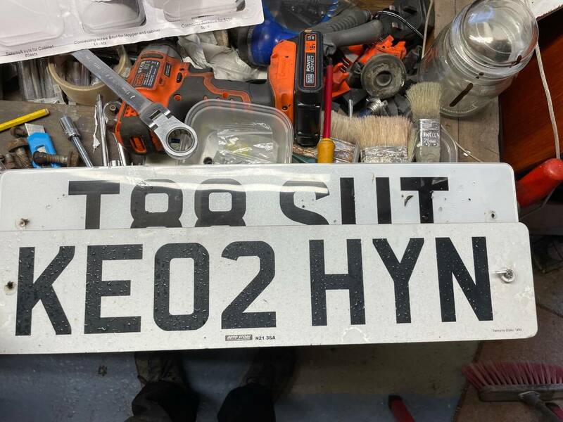

I’ve finally bitten the bullet and got my private reggo on.
Front was screwed AND siliconed on. Good effort.
unbelievably the number plate I took off the Audi has screw holes that aren’t far off!
And a blob of no nails 👌
lovely 😊
pulled the shabby rear off. But can’t find any screw holes other than 2 empty holes. Nor can I find any double sided tape. Weather is horrendous. Attempted no nails, it slid off.
