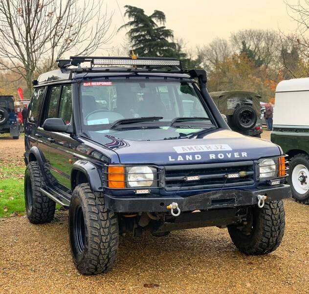

Today I did a thing.
out with the old (farts n all)
in with the new.
just needs a darn good cleanin. Hopefully get another 187k out of that.
I used discovery2spares, who sent a bag of sweets (I’m diabetic) and a pen light (non working).
ahhh it’s great to have a Landy again
I also have a working centre interior light now too! Great stuff.

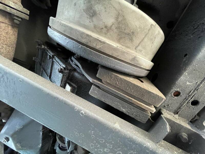

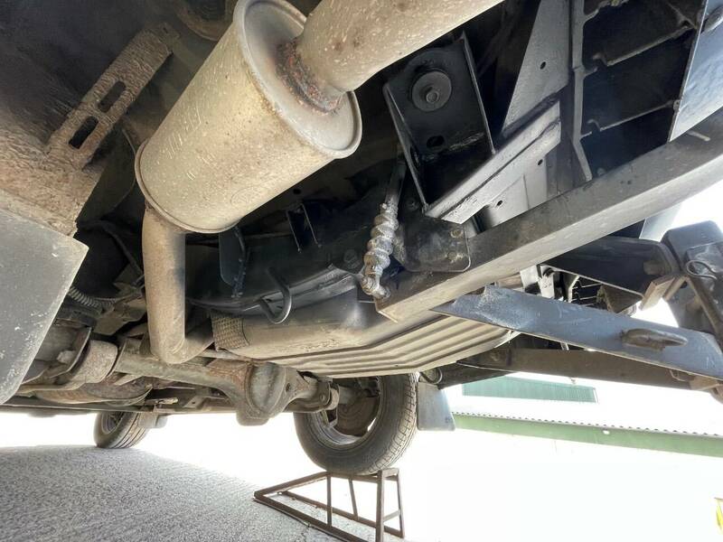

So there’s been an anoying rattle/screechy sound while driving. Sounded awful. PO said it was the exhaust.
I finally got under it, to find some kind of balance block? on the transmission brake. No idea what it’s for.
but these two bolts holding it on were loose.
tightened them up, and it’s a different machine altogether.

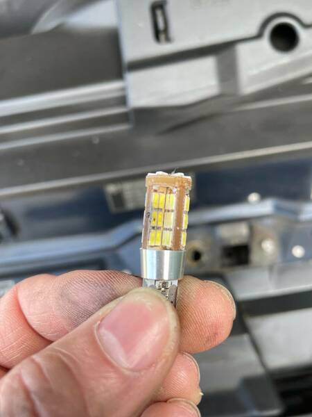

One of the LED side lips failed. Typical. I’ve not fitted them to anything since the early 2000s because they only last 4 minutes, 5 if you’re lucky.
burnt out.
fitted standard 5w capless in place. Probably dull now, because of the covers, but I broke of those by accident. Bugger.

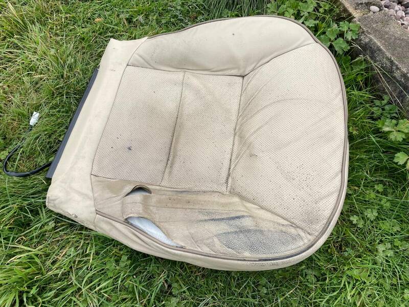

Is a few minor lighting faults and a knackered seat the only things you've had go wrong with it? I asked about these recently and got the impression if I bought one it would eat my wallet, my house and my children and still be nothing but an immobile pile of rust in the corner.
You're giving me fresh hope!! 😛
Expand
It’s all tit bits.
I think the previous owner emptied his earnings into it. Props are new, airbags are new. Front diff is new. I’ve receipts for new cylinder head and much more from a few years ago.
With 187k up it, I’ll be happy if it gets to 200k with no big issues.

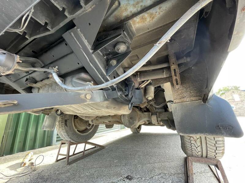

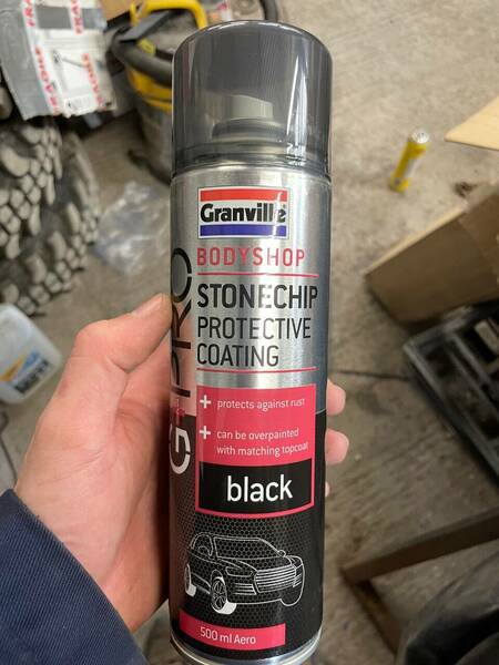

Today I R been mostly,
winter preppin
Cleaned up as much as possible with the grinder and a wire wheel
its not tooooo bad.
applied this first
then once dry, applied this. Violent stuff!
I got covered.
so I then fired up the compressor, warmed up some waxoil and sprayed as much in as possible

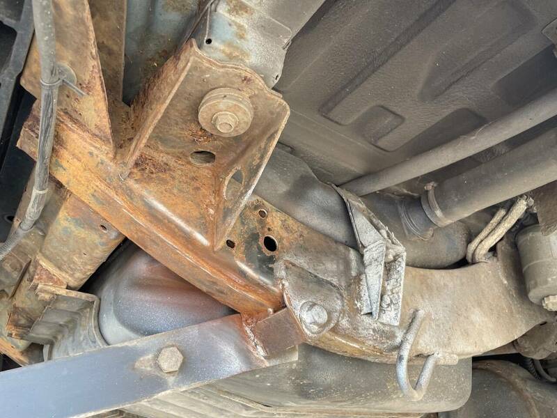

It's amazing.  There is chassis there!  My D2, which was sent for breaking about 3 years ago now, had quite a bit of fresh air where yours still has original chassis.
I assume you're familiar with how these chassis were designed and fabricated?  The internal corner stiffening on these is the worst rust trap I've seen in a fair while.  You need to park it in a swimming pool of waxoyl every night.

don’t get me wrong, I recon in a few years it’ll need minor rust correction surgery, as the bulkhead on passenger side and inner wing had to be repaired, but that’s it so far.

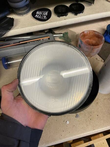

I took one of the safari lamps off today, as they’re cloudy. Now, they’re glass. Glass doesn’t tend to go cloudy.
using some paint renovator and some glass polish…..
ahh well. It was worth a try. It’s probably cloudy on the inside….
bugger.

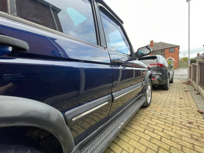

Gave this bad boy a polish last week,
then the other day the father in law decided to paint his fence panels with a pump up spray bottle. The right side of the discovery got covered. Including bonnet roof and tailgate. You can just see it in the mirror.
spent the afternoon with tar and glue remover. Luckily it’s come off pretty easy. Next doors washing wasn’t so lucky.

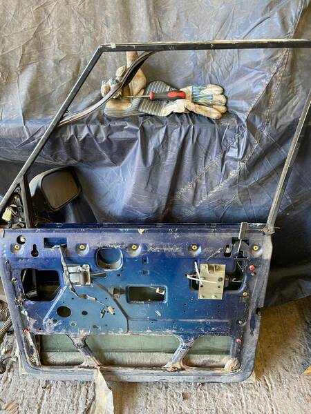

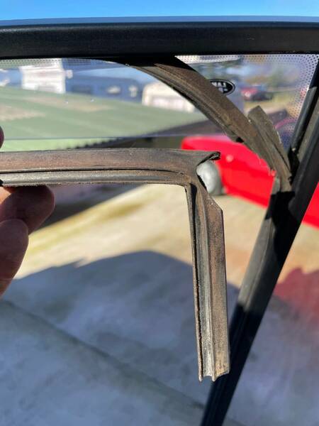

drivers side window runner seal was completely borked in the corner. I have a D1 front door to scrap and noticed it was similar. It’s actually identical.
So I started ripping the door to bits to get it out. 45 minutes in I decided against it. the entire door needs stripping to get the window out and I lost interest.
here you see the seal is good on this one.
so I did the right thing and cut a section out.
and slotted it in to the gap on the D2.
works a treat and saves 16 days work. Result!

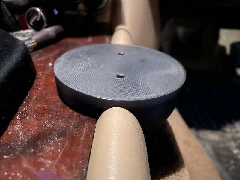

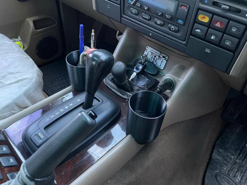

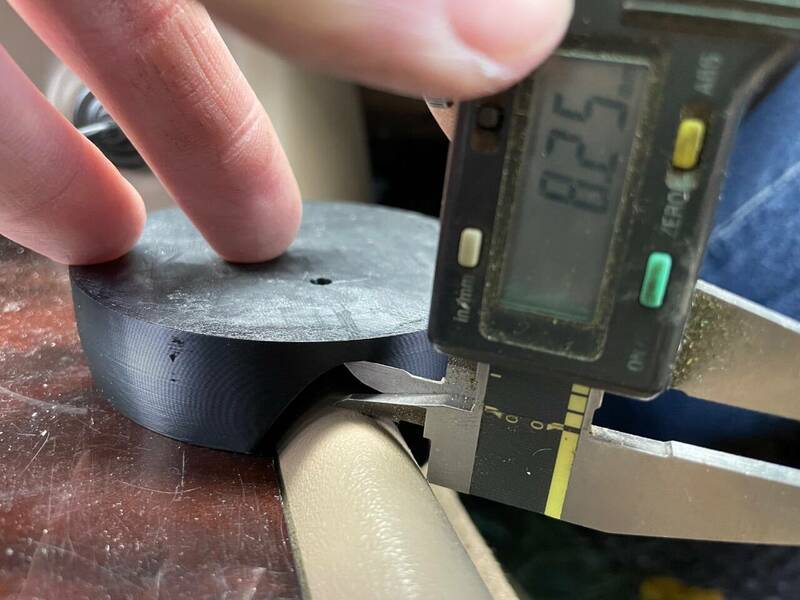

fitted better cup holders to the centre console. The original cup holder was a poor design, even for the D1. You can really tell how many fucks were given designing the D2 that they used the same shitty design. (Also see sunroof failures). The original design is ok for a 330ml can, that’s it. But even still, once selected beverage is in the holder, the heater controls are impossible to use.
These new cup holders were made by @warninglight who did a groovy AS discount. I also assisted his venture by purchasing the only D2 with wooden effect trim, rendering his original design useless due to the additional height it gives. The original was sent back with instructions of how much to reduce the height of the base by.
and once the redeveloped base arrived, they were fitted.
suitable for anything. Pens, adapters, leathermans, isolators.
perfect 💪
