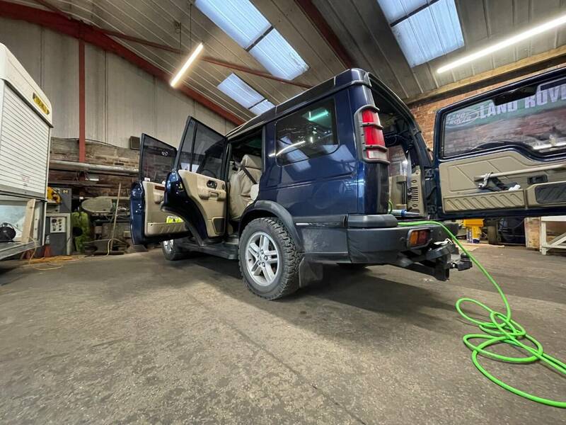

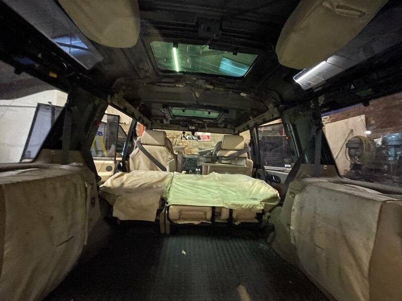

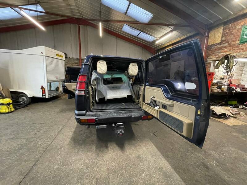

I payed a man to remove the headlining, fix all the water leaks and refit a new headlining.
there were a few leaks, front sunroof had a loose bolt that the riv nut was spinning. The sunroof was removed. I repaired the riv nut for him the truckers way and it was resealed and refitted.
there was a leak from the front nearside roof channel drain, that’d been sealed. And the rear of the roof has a bung for an additional aerial which was loose. The rear sunroof and roof rails were loose, all retightened.
the new headlining was refitted, and the interior lights upgraded while it was there.

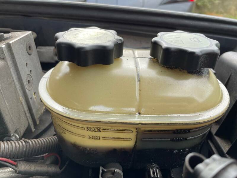

Noticed the other day that the power steering fluid was going down. Couldn’t see any leaks. The reason? Some c**ts swapped the cap over with the ACE cap.
So it’s the ACE system that’s leaking.. great. If these run out of fluid the pump sets on fire. Lovely!

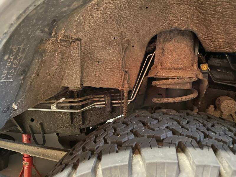

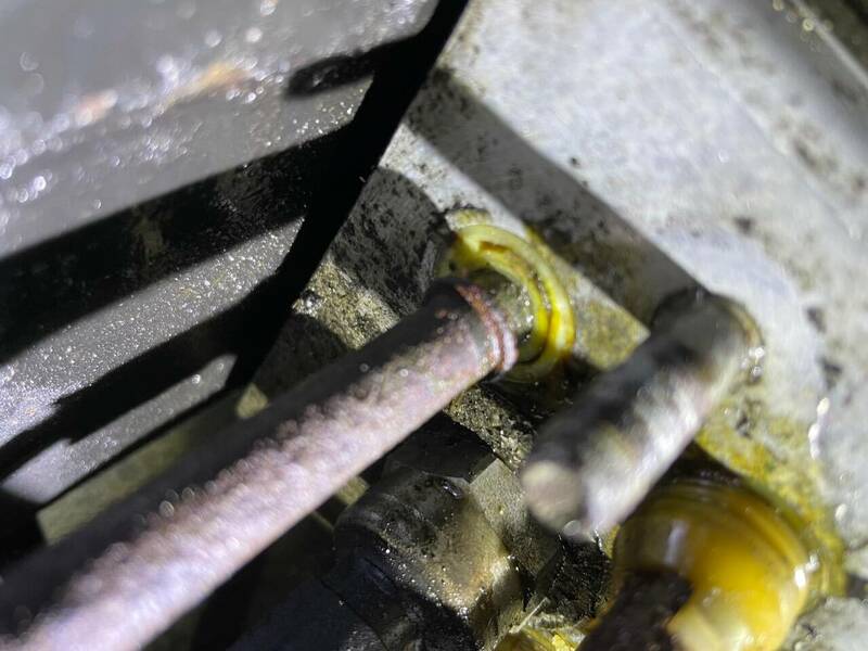

Here’s the leak
bottom pipe connection is leaking only when engine is running though.
Bottom pipe is rusty but hopefully not leaking itself. I’ll be replacing the seal in the block on Thursday.
My worst fears hit me yesterday. The pipe is split. it’s also stuck in the valve block, which is going to take some getting out without damaging the block.
ordered two new metal pipes, pointless doing one and not the other as it looks like it’s leaking too. This job is going to cost me just over £250 so far and that’s doing it myself.

This is the current scene of destruction. One pipe off, one to go.

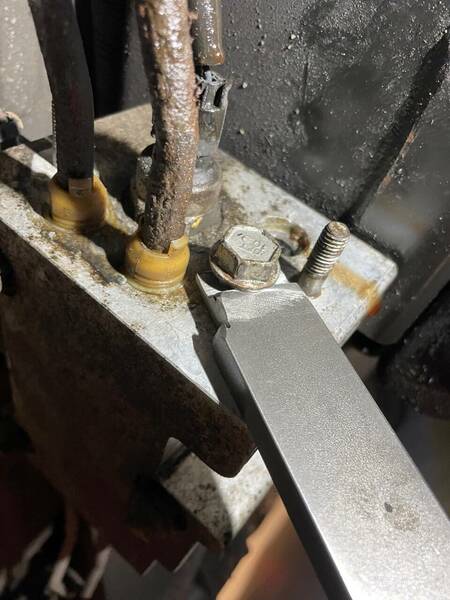

Pipes took some getting out. Luckily I made two tools for the assistance of the extraction process. First was made from 3mm side guard lamp bracket, which bent immediately. The second was made from an 8mm thick shift rod out of a truck gearbox. That one didn’t mess about.
the seals were extracted by running an m10 bolt into it and using the same extraction tool to remove.
Well. It’s temporarily fixed.

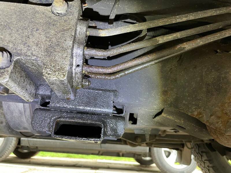

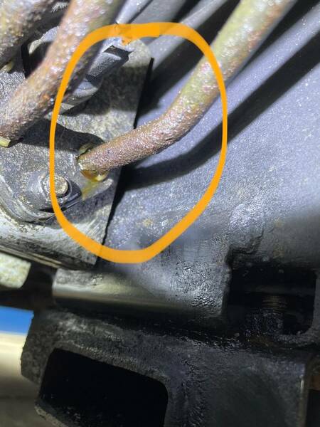

Both high/low pipes have been changed, however the front ram pipes are leaking. Ok, not as much as the others were, but still leaking. Can’t afford to replace them so it’ll have to leak ever so slightly until I can.
gave the new pipes some temp bitumen coating until I can do the others. IMG_9797.thumb.jpeg.8f3e80b2be86f0245e1fe9768f681618.jpeg

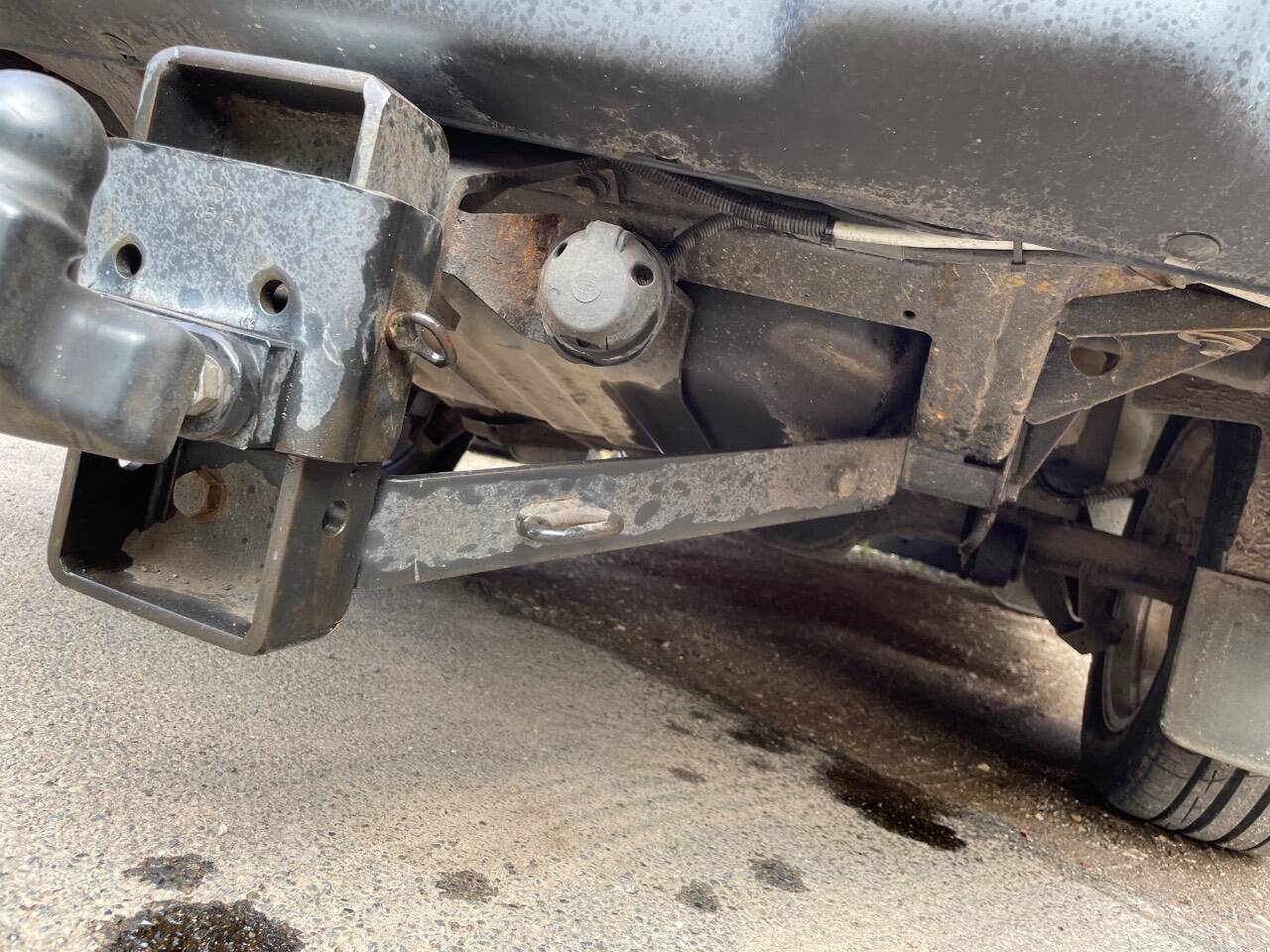

I’ve not used the disco since last weekend. Today went to get two new tyres for the rear. Then went up to my unit to pick some stuff up. From my unit I went to a Landrover parts shop about 10 miles away to pick up another ball joint for the front. While I was discussing the impending doom of owning a Landrover with the shop owner, I noticed a dark pool under the rear of the disco. Knowing full well that MANY landrovers park here, it must be someone else from earlier. Only to my disappointment as I walked back to it that the rear of the disco was covered top to bottom in fuel. And it was pouring out with the engine running. Pipe must have ruptured on my way from my unit to the shop, as it was dry when I left.
unfortunate? Yes. Rang the AA, who turned up 15 minutes later. The shop owner, fluent in discovery ailments said it’ll be the fuel pipe from tank to filter. And sold me the pipe. AA man didn’t want to drop the tank in the car park, which is FULL, so a bloke turned up and offered to replace it in the workshop on Sunday. Took the big yellow taxi home.
