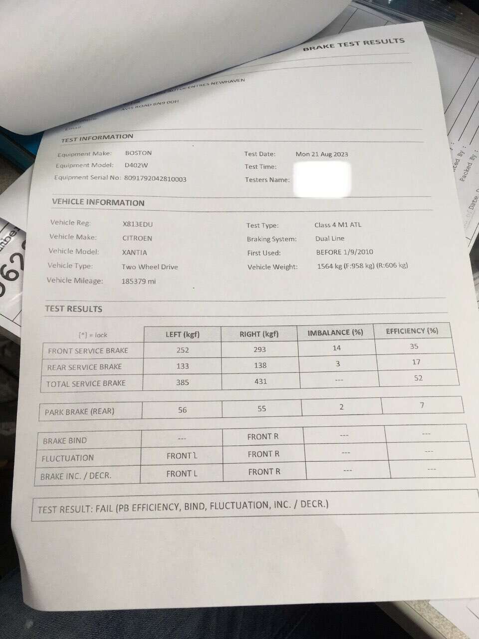

And brakes whilst we’re here:

Looks like they did the wrong axles for the handbrake if Xantia is front. Tbf they're getting rare now and if a young tester may have no idea it was front handbrake.

Surely they couldn't have recorded any park brake efficiency if they tested the wrong axle?
The report looks like their tester only has the option for rear axle parking brake so is it just reported as the wrong axle?
I was wondering that. I don't know what a KGF is equivalent to but 50 odd of them sounds like something's going on.

I had a fail on the handbrake for the same reason one year... Quick retest later and yes it did have a perfectly working handbrake!
kgf I think just means kilograms of force, although a kilogram is a mass not a force 1kg would exert a force of (m * g) 9.81N on yer foot, so this is another way of saying how much braking force there is.
I assume its used along with the weight of the car to work out an efficiency? So if it weighs 1 ton and has 500kgf braking force per axle it's 100% efficient? Summat like that anyway.
assuming its same as an xm....  if they did do the correct axle the two brake cables usually meet the one to the handbrake lever in a little bracket under drivers footwell.  if they have been loosened or messed with at the calliper end they can pop out of the bracket.  Or the lever on calliper could be full or crap.
Sounds like they need to revisit this, at least for the recording of the emissions and handbrake or am I just confused.

If the handbrake is still poor on the front I'd have a look at the cables first. They go through some fairly sharp bends, and the plastic sheath of them splits, letting water into the cable and causing seizing. Luckily, the bit that's most prone to doing that is very visible with the wheels off, as it's the first few inches back from where it hooks onto the caliper, so there is some possibilities to unseize them.
As the service brake on the front isn't very strong the pads may be seized in a bit or the caliper sliders  or the caliper itself may be sticky.

50kgf found on the rear is probably just a bind, seeing the parking brake test being done on the rear axle did make me chuckle 😆
Slightly strange usage of the "single line braking system" dangerous RfR, but I suppose being a hydro Citroen they don't have true dual circuit brakes iirc. It's not single line though, but I think the tester could be forgiven in that regard
