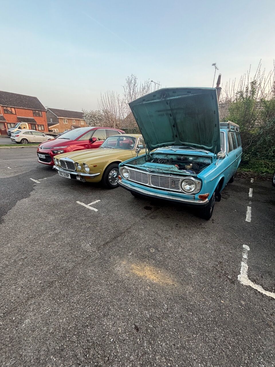

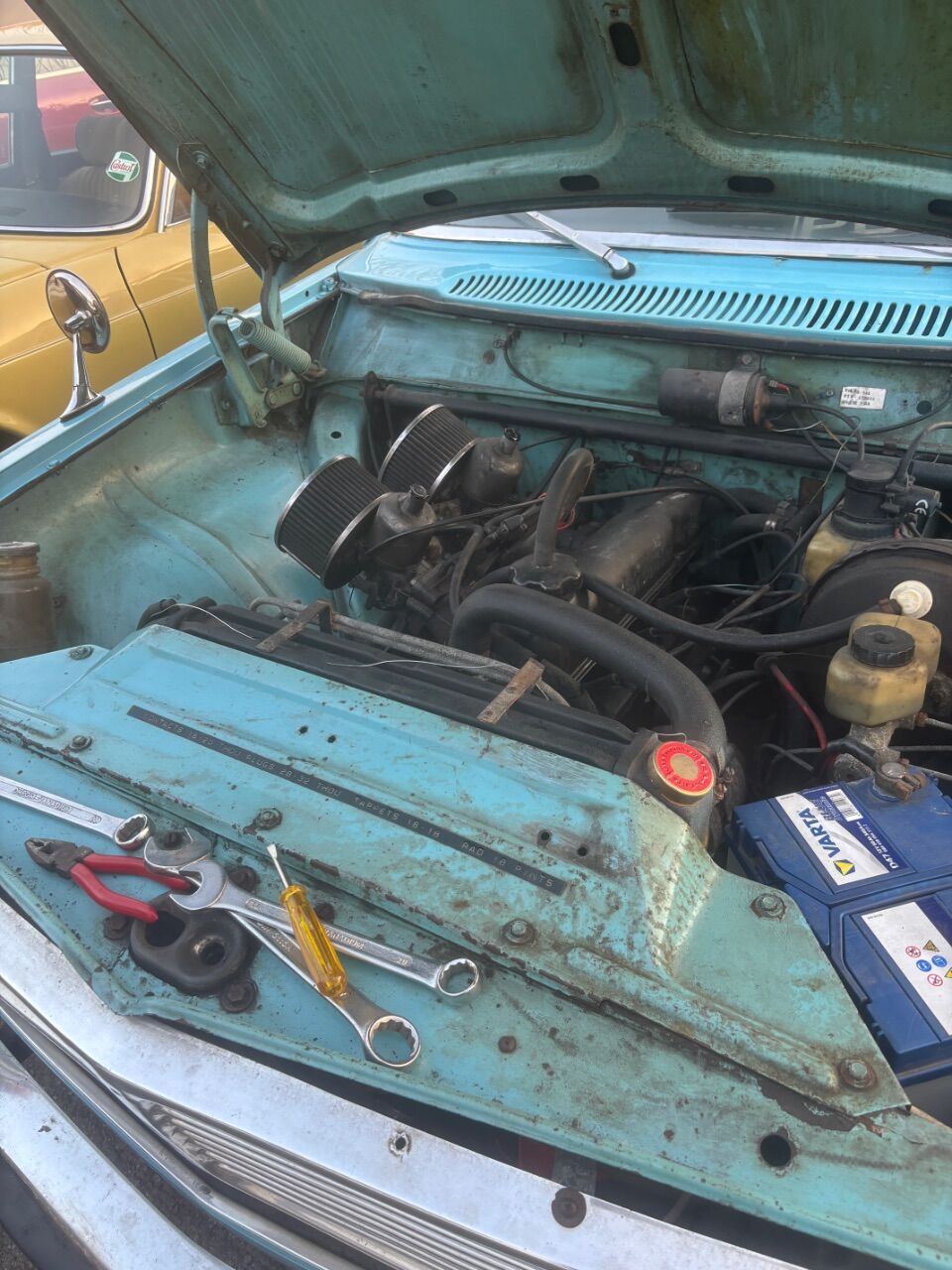

So my friends Ovlov got delivered today, thanks to @Marshall2810 again, he’s really smitten with it, such a utilitarian old bus, the doors shut with such a reassuring thud and everything just seems so well built,  we did have a little go at getting life out of the old girl, we had her firing a couple of times but after that nothing, further examination of the points tells us they’re sticking, sometimes open sometimes shut so a good clean of all the parts are in order, or even an electronic ignition kit maybe? More progress hopefully tomorrow
  • Weird Car changed the title to Weird Car’s weird cars! ‘Ovlov action’
  On 24/03/2025 at 19:21, Weird Car said:
So my friends Ovlov got delivered today, thanks to @Marshall2810 again, he’s really smitten with it, such a utilitarian old bus, the doors shut with such a reassuring thud and everything just seems so well build,  we did have a little go at getting life out of the old girl, we had her firing a couple of times but after that nothing, further examination of the points tells us they’re sticking, sometimes open sometimes shut so a good clean of all the parts are in order, or even an electronic ignition kit maybe? More progress hopefully tomorrow
Expand
Pleased to see it arrived safely and you're both getting stuck in straight away! Agree on the lack of spark theory, it certainly smelled like it was getting fuel so reckon you're on the right track

Volvo update, we have life! Mark sent me this video this morning he’s got it going after cleaning the carbs and the connectors to the coil, it’s running lumpy though so I assume the carbs want balancing which he’s supposedly doing later on
