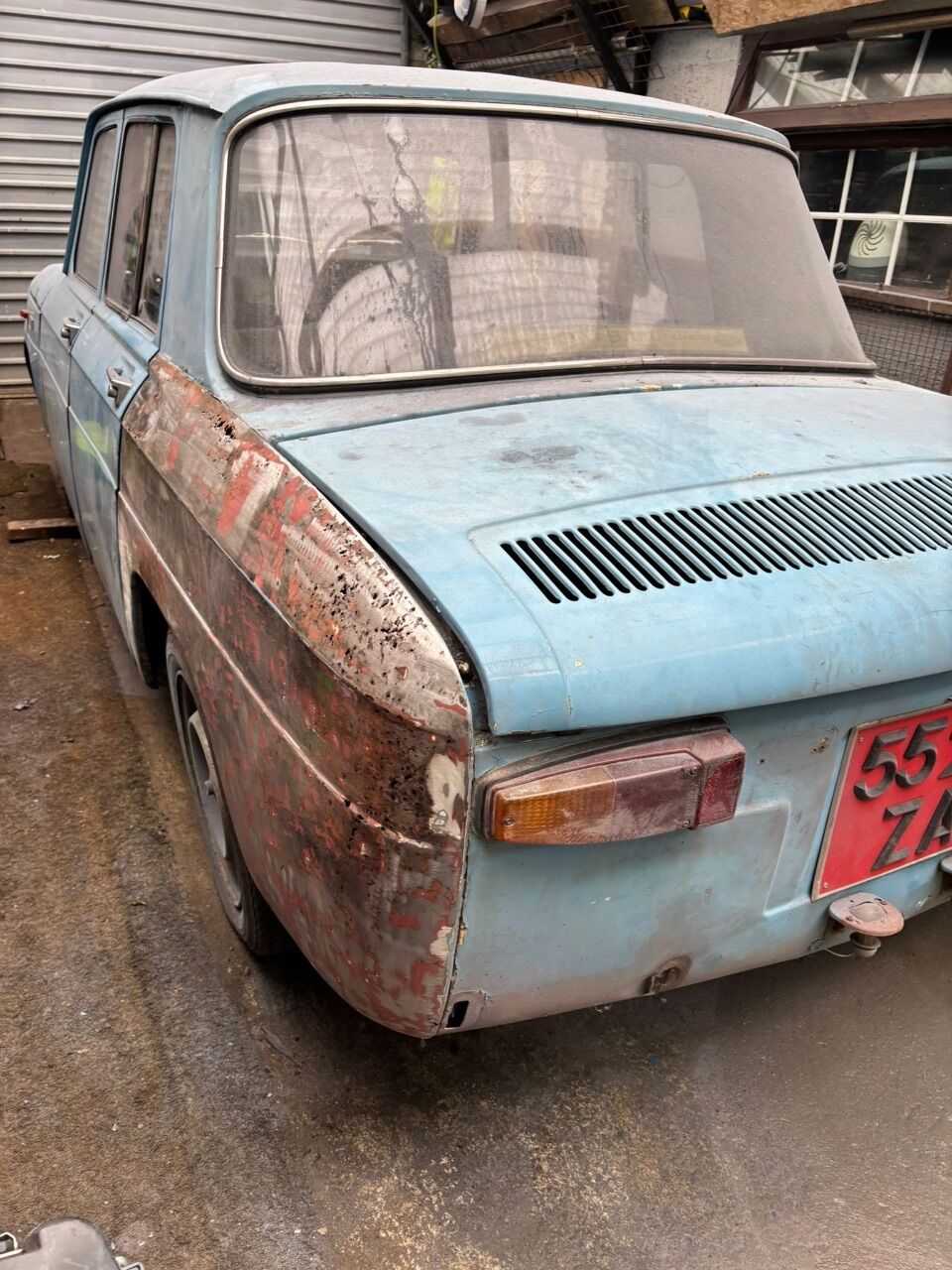

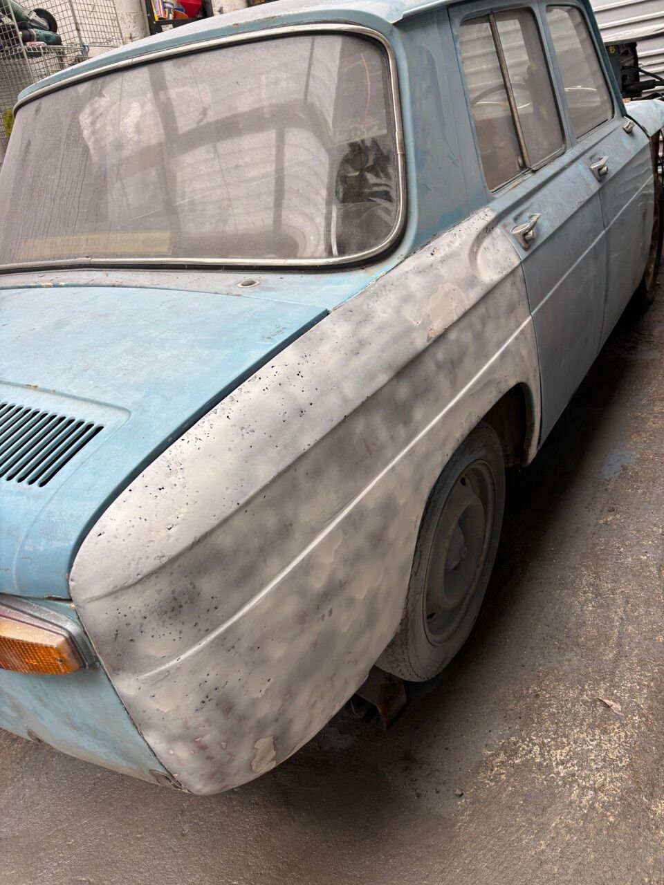

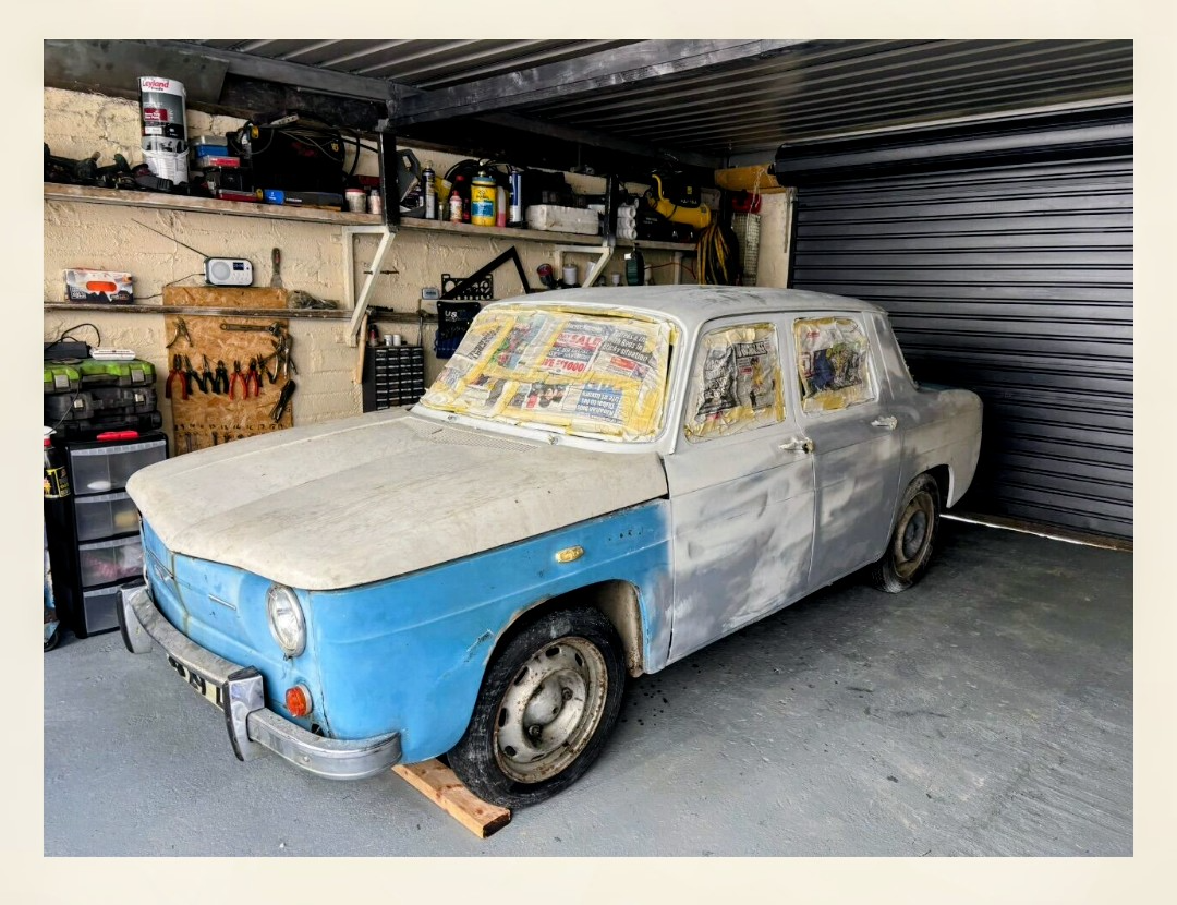

Some progress on the bodywork. The rear left wing is the worst of things so far, lots of little pin holes. The rest of it is really quite good:

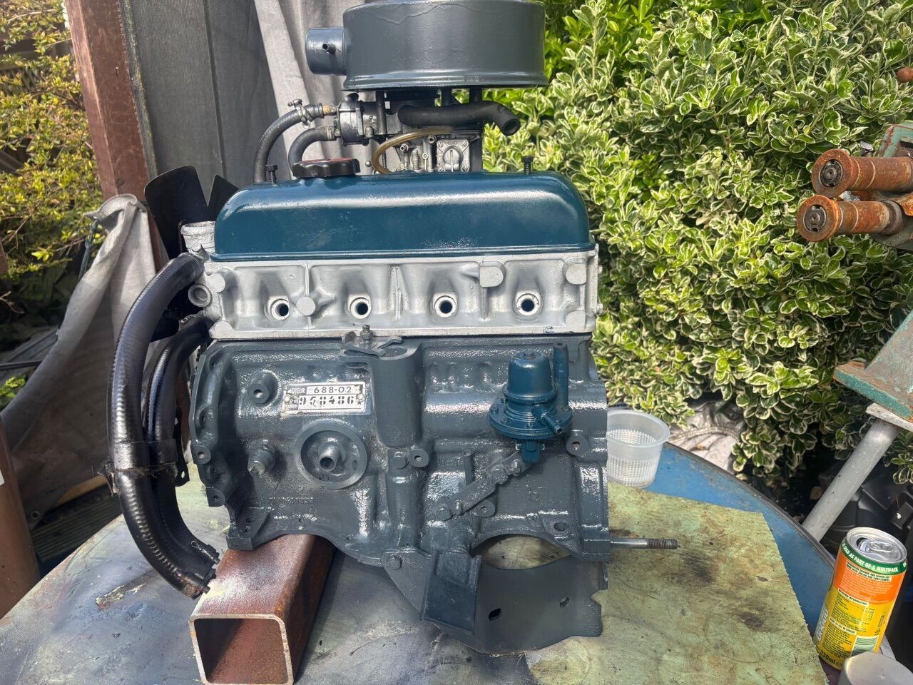

The engine parts arrived today and my dad has wasted very little time this week
He’s a great man for this stuff. He’s more excited/determined to hear it running that I am!

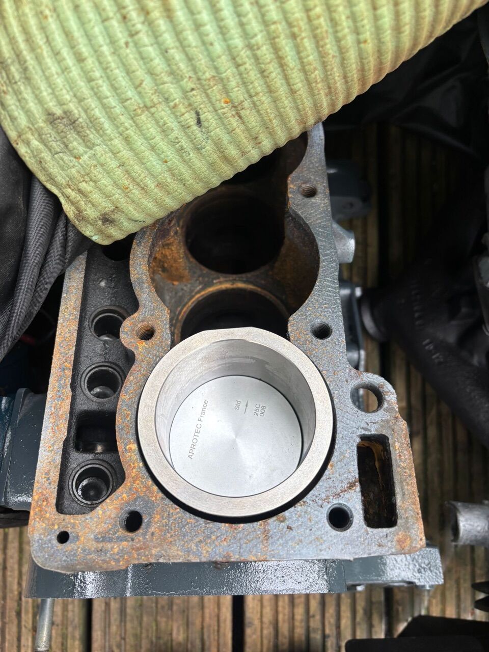

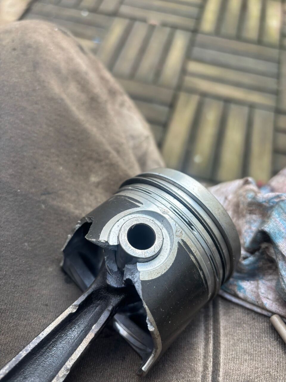

Too much pressure pressing the pin in..
I can’t find one singular piston for sale anywhere. Emailed the place I bought from last week…no reply yet but fingers crossed 🙁
If these are the type that are an interference fit, shouldn't the small end of the rod be heated first?
So x4 new pistons on their way for the second time...I only need 1 but nowhere seems to sell them single!

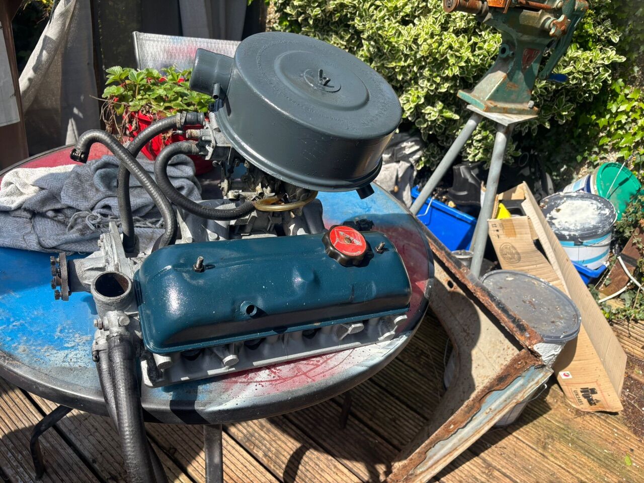

Top end looking goodWhatsAppImage2026-04-22at14_59_07.jpeg.b9b1084b5044719494d844548a8756b4.jpeg in the meantime

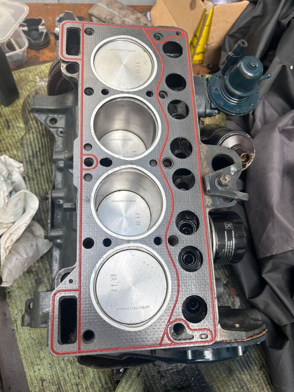

eeerrrmmm, isn't the bottom piston  in the picture in wrong way round ? 🤔
Were it not for your eagle eye I’d never have even noticed that! I said it to him (my dad) and he was adamant that it wasn’t a problem anyway..

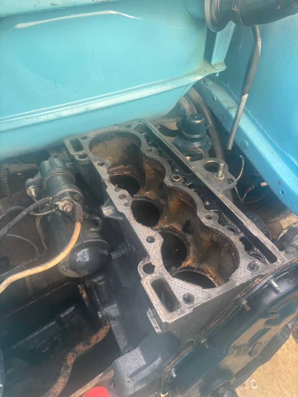

Engine went back in this morning and…
It’s in pieces again. Too tight for the starter to turn 🥴
Yes it is, that is why the pistons are marked.  The gudgeon pin is offset towards the thrust side.
  • Agree 2
@The Vicar Your dad is doing a grand job of attending to an engine that was in a very poor state.  Whilst it is still somewhat disassembled it may be prudent to do everything possible to ensure the wet liner sealing surfaces in the block are spotless before they go back in and, subject to Renault practices being different from my wet liner experience on Reliants, check that the liner stands proud of the block by the specified amount so that the head will apply the required sealing force top and bottom when tightened down.  It's a messy job if they leak.  I have found that when appearing to offer advice to an enthusiastic  dad, it is wise to have an escape route planned 😀.
"Yes it is, that is why the pistons are marked.  The gudgeon pin is offset towards the thrust side."  @Mr Pastry

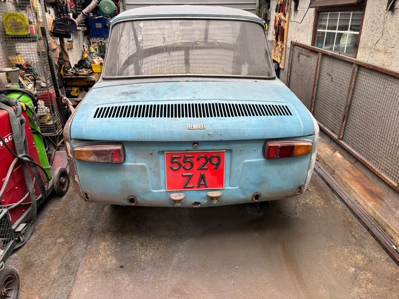

So, I applied for a new logbook for this (I need to stop buying cars with no paperwork), filled out forms and sent everything off etc last month, and I received notice today that they have no record of the registration and VIN number combination that I provided. The registration number is live, which is a good thing, so it just means I got the VIN wrong. I sent them the full sequence from the oval plate below (R1 132…), and that’s obviously not it. Is it possible that the 5 digit number on the diamond plate is my VIN? I don’t want to get it wrong twice, so I want to confirm first, but I can’t find much online..
Hmm, I pulled the VIN number from its vehicle record, and im afraid it does not match any of those numbers at all, and the vehicle comes back as white...

The car was indeed originally white, I only noticed this recently after looking back at pictures taken when I first viewed it:
Thank goodness for that! For a moment I thought you’d bought a ringer😬
